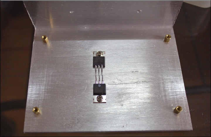

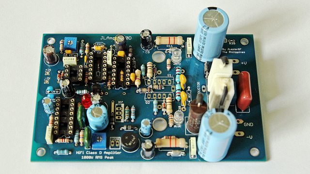

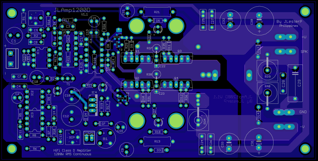

Actually, I am holding out for the 2 pair version, which I think is pictured below. I have a question about it:
Question: Do the output devices mount below the board (assuming we are looking at the top surface in the image above) and are bent over at 90 degrees and screwed down to a heatsink that everything is mounted on? I assume that is what the four largish holes in the PCB are for - to tighten the screws that fasten the transistors to the heat sink. If this is not correct, then how are the devices mounted to the heat sink?

Yes the mosfets will be mounted under the board.

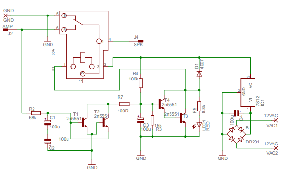

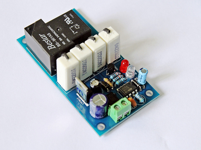

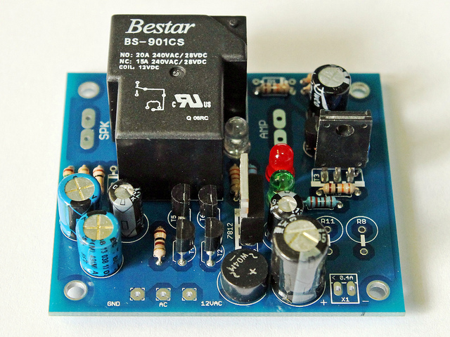

Simple mono speaker protect for my amplifier.
Uses 30A relay.
Hi JPLester,
In this schematic of yours, I see that amp output connector is connected to ground (not speaker) by default via the relay. Is it also true with the actual relay by default, or the opposite?
Could you teach us how this circuit works?
Thanks.
D
Deleted member 148505
Thanks for pointing out, I mistakenly uploaded the wrong files... here's the correct one.
Simple explanation:
At startup, C3 will charge up.. When it's already charged, T4 and T3 will turn on, thereby turning on the relay. (Turn on delay depends on RC time constant of C3 and R4)
T1 (or T2 if the signal is negative) will turn on depending on the RC time constant of R2, C1, C2.
If T1 or T2 turns on, it shorts the C3 to the ground, thereby turning off the T4 and T3, so the relay will turn off..
Simple explanation:

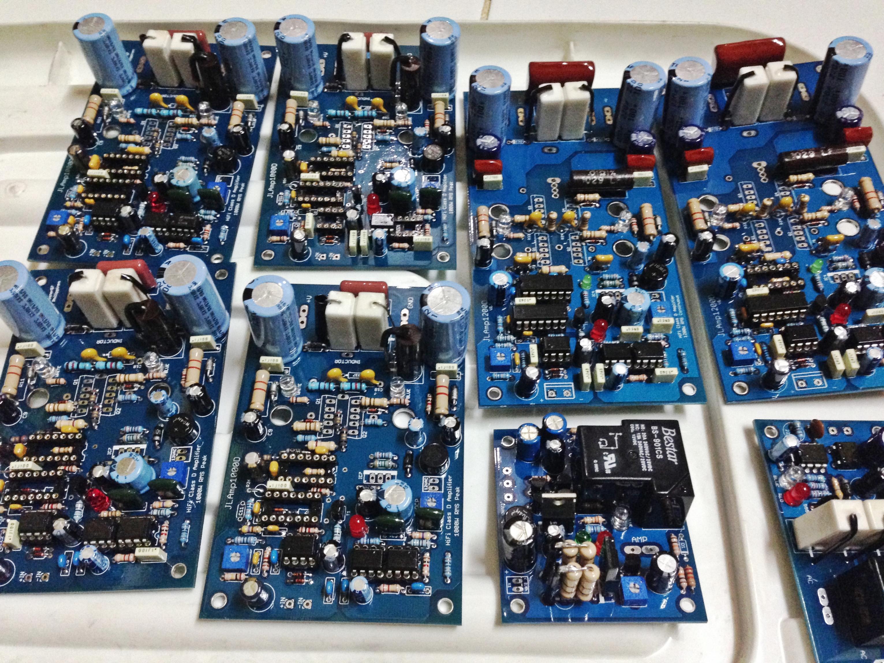

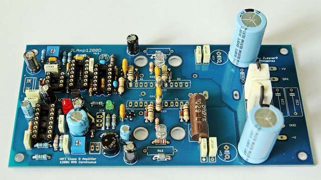

Assembling the JLAmp1000D and JLAmp1200D. Once I finished it (it may take a month or so due to my busy sched), I'll post the scope measurements.
Stay tuned 🙂

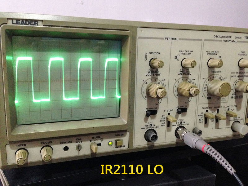

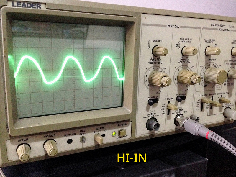

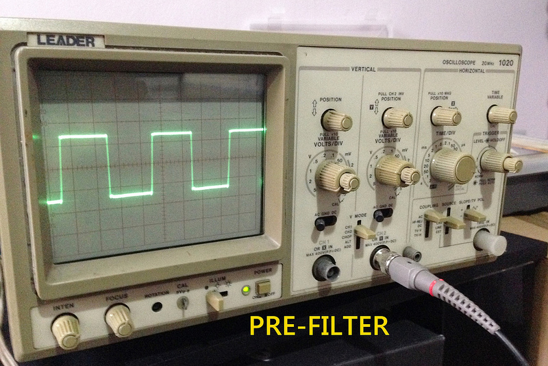

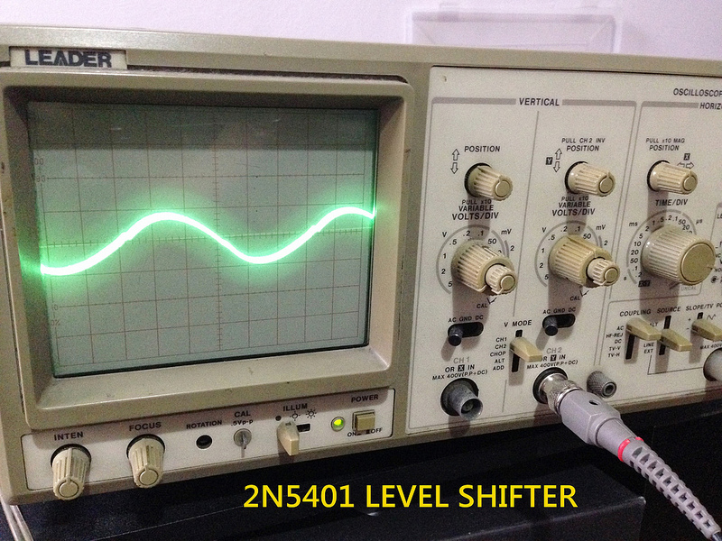

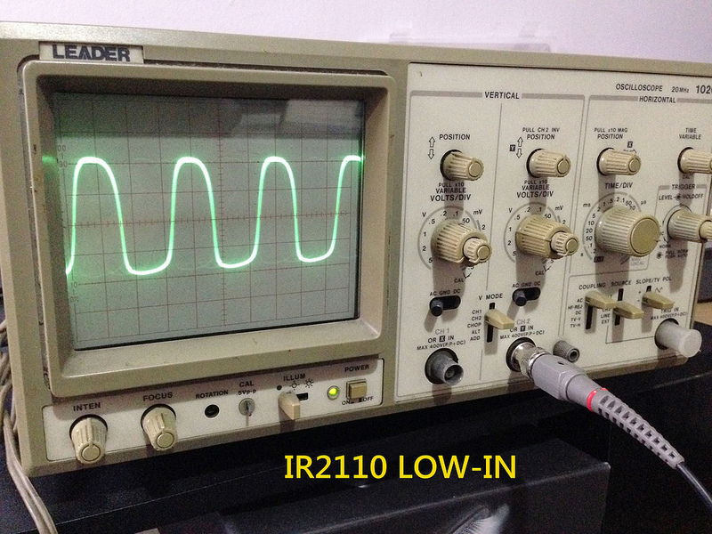

I can you please make 2 measurements with the oscilloscope, to make a comparison of forms of waves that do not seem quite right?

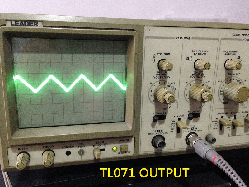

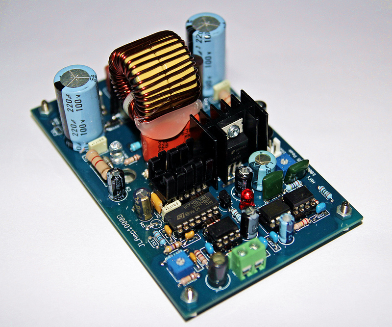

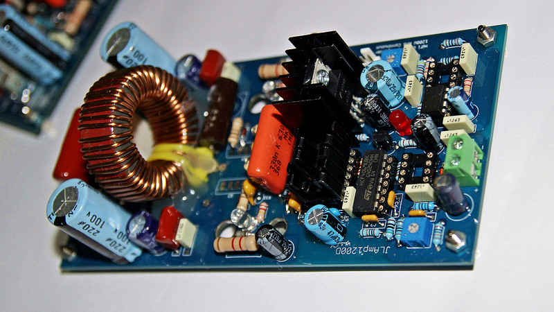

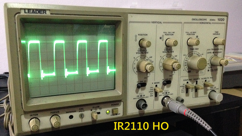

Finished assembling JLAmp1200D, worked at first power up. Here are some scope measurements. The amp is running at 333kHz idle with 4 ohms dummy load connected to it.
Sound is clear, punchy bass, highs are just right and no sibilance. (I'll upload a youtube video lol)

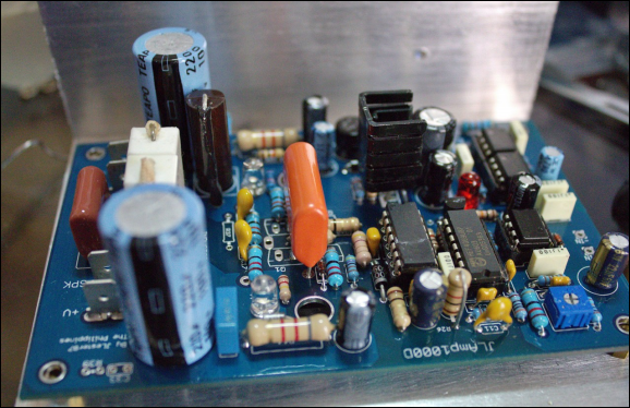

Hi Jlester
greetings just want to ask why IR2110 has heatsink on it try FAN7392 IC
nice boards
