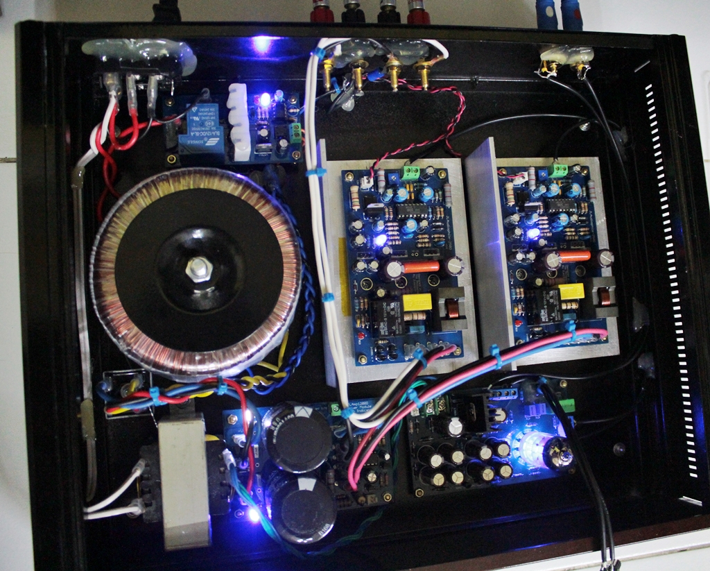

Thanks! Here's the completed amp.
Will be selling unsoldered kit soon 🙂
I just ordered ICs and mosfets from mouser, inductors from coilcraft USA. Capacitors are from RS Phils.

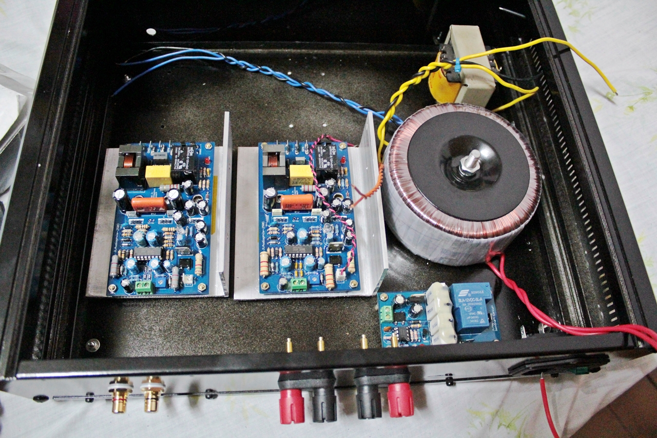

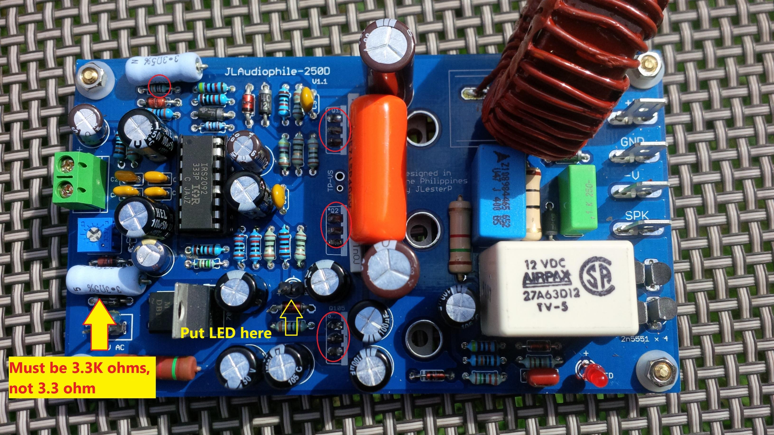

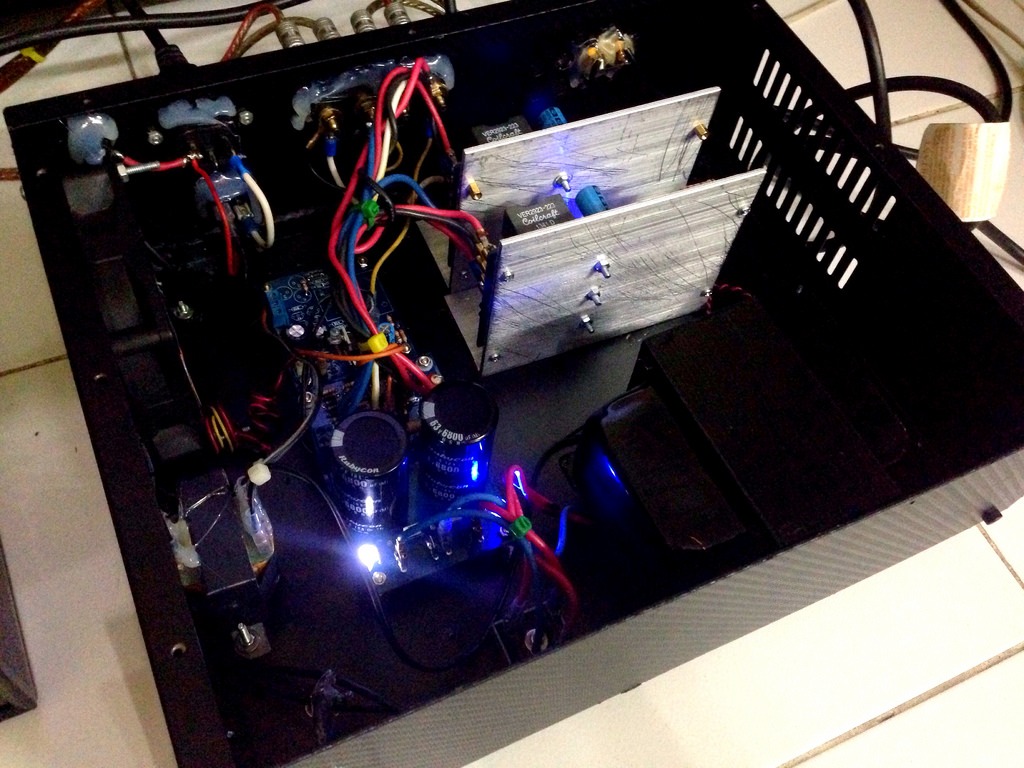

Issue on 1st power up (JLAudiophile-250D)
Hi Lester
I've just completed the 1st JLAudiophile-250D board and I've connected power for the 1st time (using a bulb current-limiter in series).
The 12v relay seems to operate fine, however there seems to be a short when I connect the +/-45v (voltage and polarity verified). I've checked the polarity of all of the caps and diodes. Do you have any suggestions on what I should be looking for?
I know the SM caps look pathetic (it's my 1st time soldering such small SM components). I tested for shorts though.
Also, do you prefer me contacting you via email for support or is this forum okay?
Thanks,
Darp
Hi Lester
Thanks,
Darp
D
Deleted member 148505
Hi Darp,
Please check for shorts in the following components:
1. Output mosfets
2. TIP31C
3. +V, -V, GND
4. Across SMD Caps under the PCB.
Please check the value of feedback resistor, it must be 120k, 1/4W. I can't clearly see the value in the picture.
The resistor for 5v6 zener must be 3.3k and not 3.3 ohm. Also check if zener is already shorted
Also, you must put the LED directly in the PCB (as shown in the picture). It detects low side gate drive, it might pick up noise if you extend wire into it.
Lester
1. Output mosfets
2. TIP31C
3. +V, -V, GND
Lester
1. Output mosfets
2. TIP31C
3. +V, -V, GND
No shorts found here and yes, FB resistor is 120k, 1/4W
The zener's not shorted... I was hoping that Digi-key messed up and sent me the wrong value but I checked my order and sure enough, the mistake was my own
I'll get some 3.3k resistors ASAP... Could the incorrect value of the resistor for the 5v6 zeners be causing the rails to short to GND?
Gotcha. I was planning to wire it to the front of the enclosure. I guess that was a bad idea.
Thanks again,
Darp
Hi again Lester,
I found some 3k48r, 1/4W resistors and threw them in temporarily with the current limiter, just to check... The blue light began to glow, beautifully 🙂 I'll wait for the correct value before I try further testing.
I really appreciate your help and your prompt reply. I also purchased some of your 1200D boards. I look forward to building them once this project is completed.
D
D
D
That's good to hear. 🙂
If you are using +/- 45V DC supply, acceptable resistor values for VAA/VSS zener regulators are 3k to 4.3K (2 to 3W).
Next time that you'll test it, don't power it for too long if the VCC regulator (TIP31c) is not attached to heatsink.

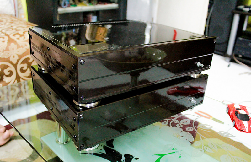

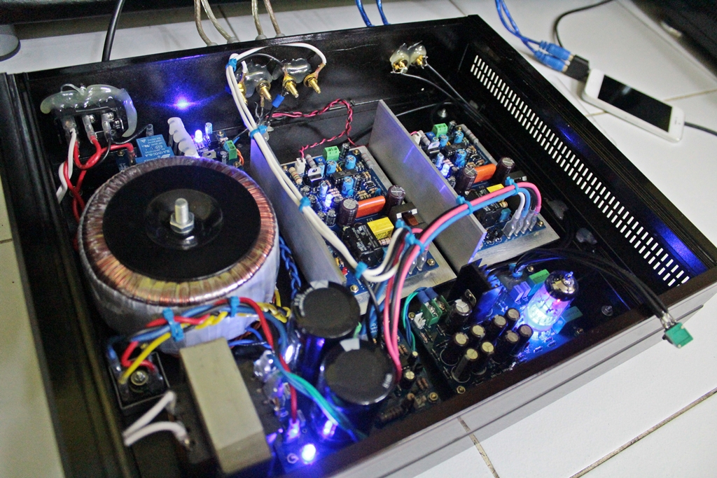

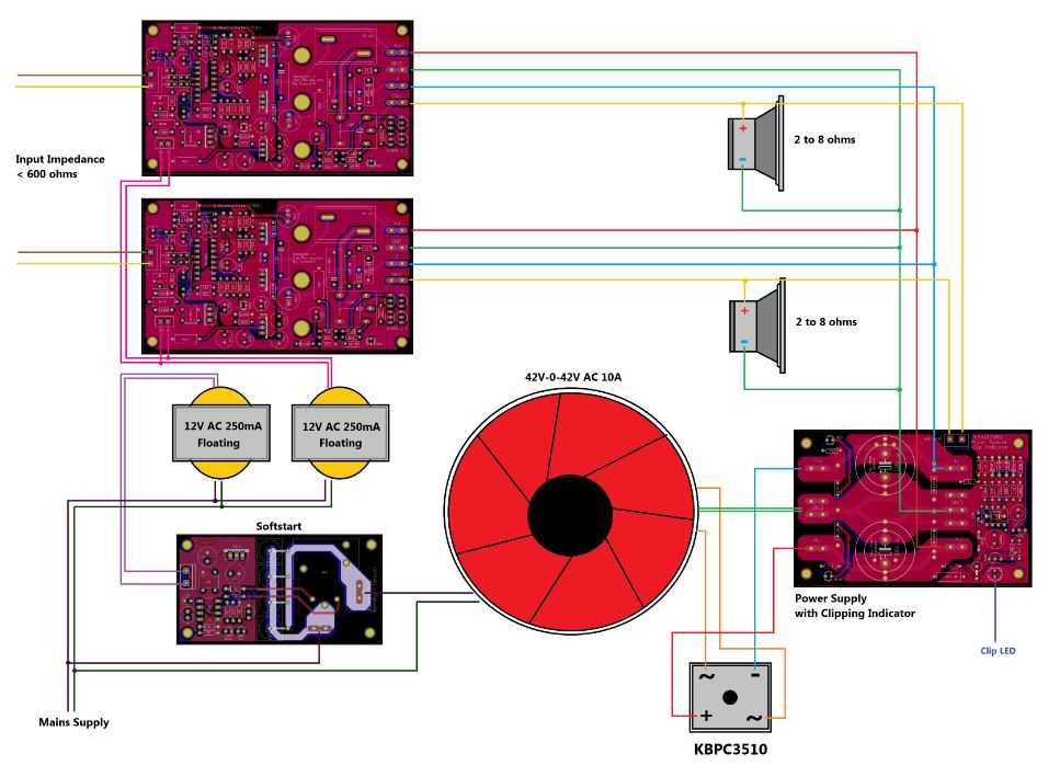

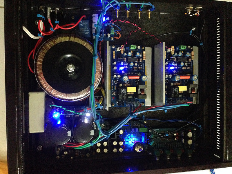

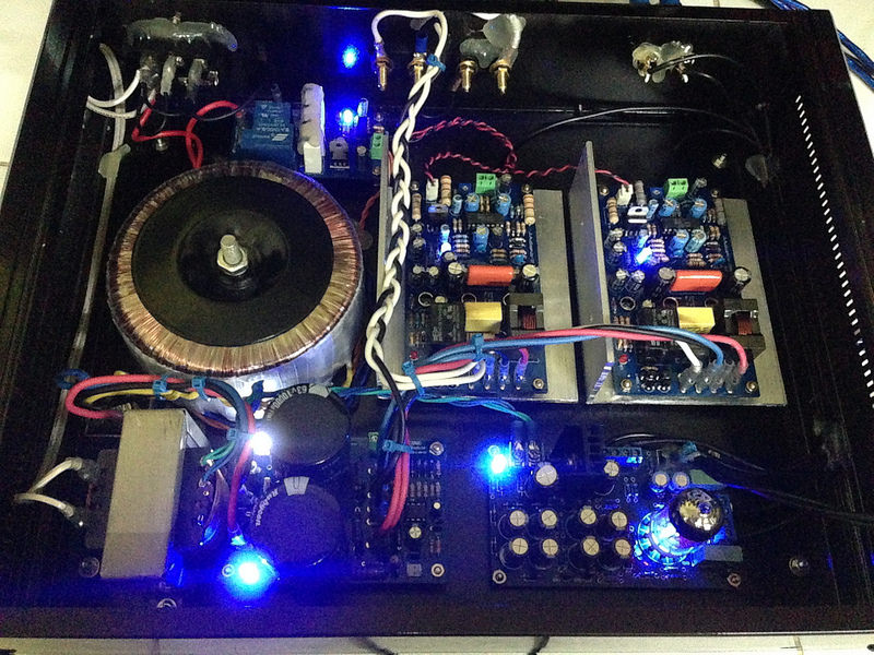

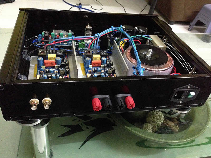

Stereo sound test of JLAudiophile-250D 🙂
Total system idle power consumption without tube buffer: 17W
With tube buffer: 28W
Uses softstart module, psu w/ clip indicator module, and jlaudiophile-250d modules.
The only alien module is the tube buffer.
Sound is superb.
Sound is superb.

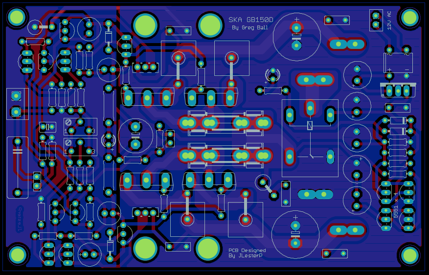

Unmodded SKA GB150D with dual source resistors and speaker protection. 🙂
Size: 3" x 4.9"
Nice! Will you be selling these? If so, approx how much will it be for a pair of boards?
