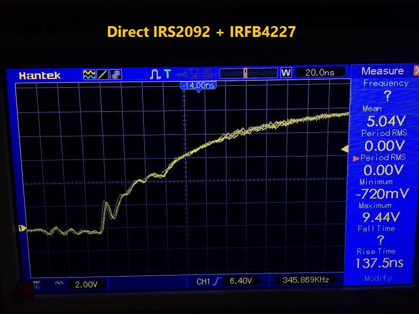

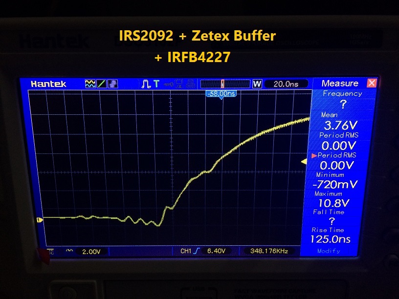

Low side gate waveforms for
1. IRS2092 with zetex 3003 driving IRFB4227 (left)
2. IRS2092 directly driving IRFB4227 (right)
Setup:
+/-53V DC rails
350khz operating frequency
Probe is in gate of lowside IRFB4227 and -V rail
Gate drive current consumption for irs2092 with zetex buffer is 3mA higher than direct irs2092.
irs2092 with zetex buffer is 6 deg celsius cooler than unbuffered irs2092 IC
Can't see advantage of buffered module aside from cooler IC.

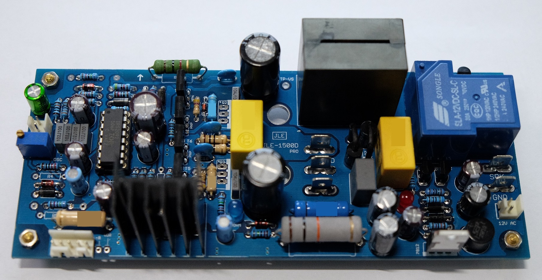

Difference is added low pass filter in feedback section, weeds out high frequency spectrum to avoid TIM distortion in the error amplifier. Also has external VAA/VSS supply for better efficiency (and better sound according to some). Added buffered gate drive.
For high power version (+/- 70V to 80V): I use IRFB4127 + 1D31A inductor.
For low power "audiophile" (+/- 45V to 55V): IPD530N15N3 + VER2923-223KL
JLE-1500D width is smaller 2.6 inch, but length is longer 6.5 inch.
Both don't have an onboard preamp or input buffer for unadulterated sound.

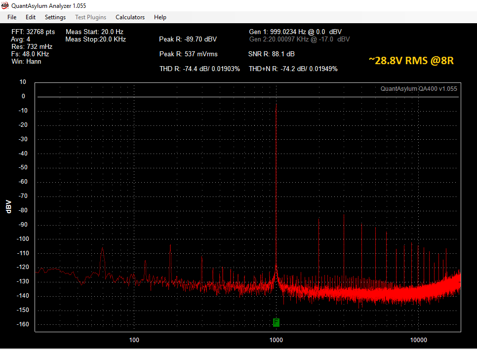

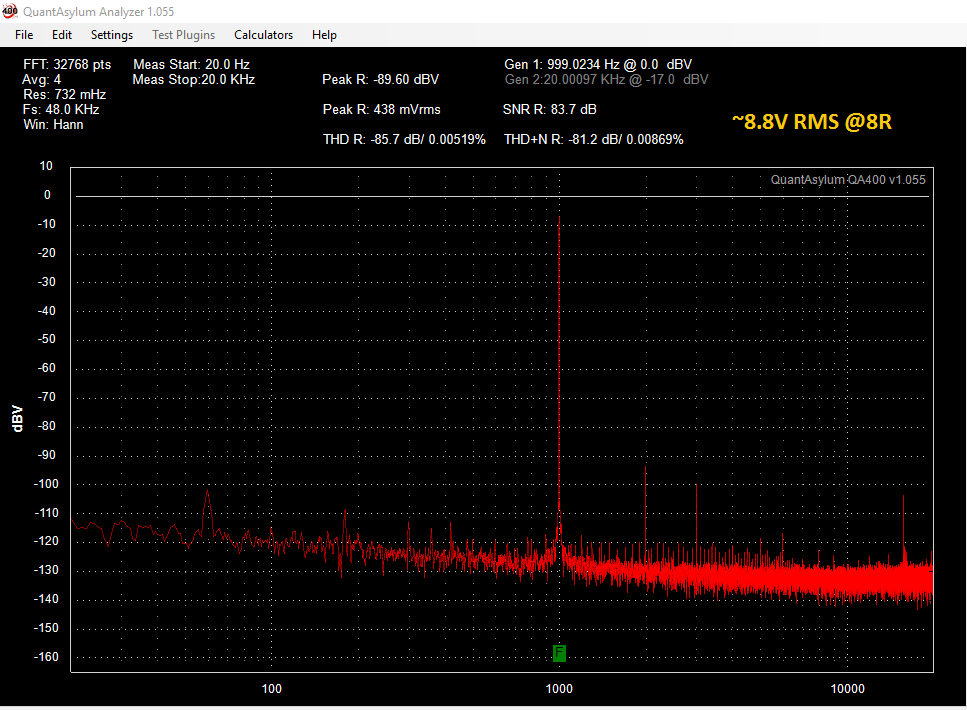

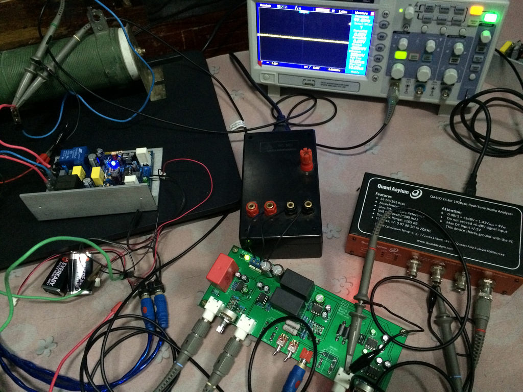

Some quick THD spectrum measurements for JLE-800D.
Here are the setup.
JLE-800D
Gain: 36
Deadtime: DT3
Speaker protect is powered by battery (reason: i don't have other power supply)
Power Supply: +/-53V abletec SMPS
JLE Interface setup
Power supply: 7812/7912 12-0-12 transformer mains supply 220VAC (reason: i don't have extra batteries)
Ground of qa400 and DUT is connected
DIV10 switch is turned on, THAT1206 is used so additional -6db attenuation.
For 28.8V RMS @8R measurement, baxandall active volume control is used to attenuate signal to 537mvrms. (28.8 DIV10 = 2.88 then reduced further)
Oscilloscope is turned on and laptop power supply is connected.
Just ignore 16khz hash, it is not there when only JLE interface is connected.
I'll make cleaner measurements soon when I acquire good cables and battery for the JLE Interface.
