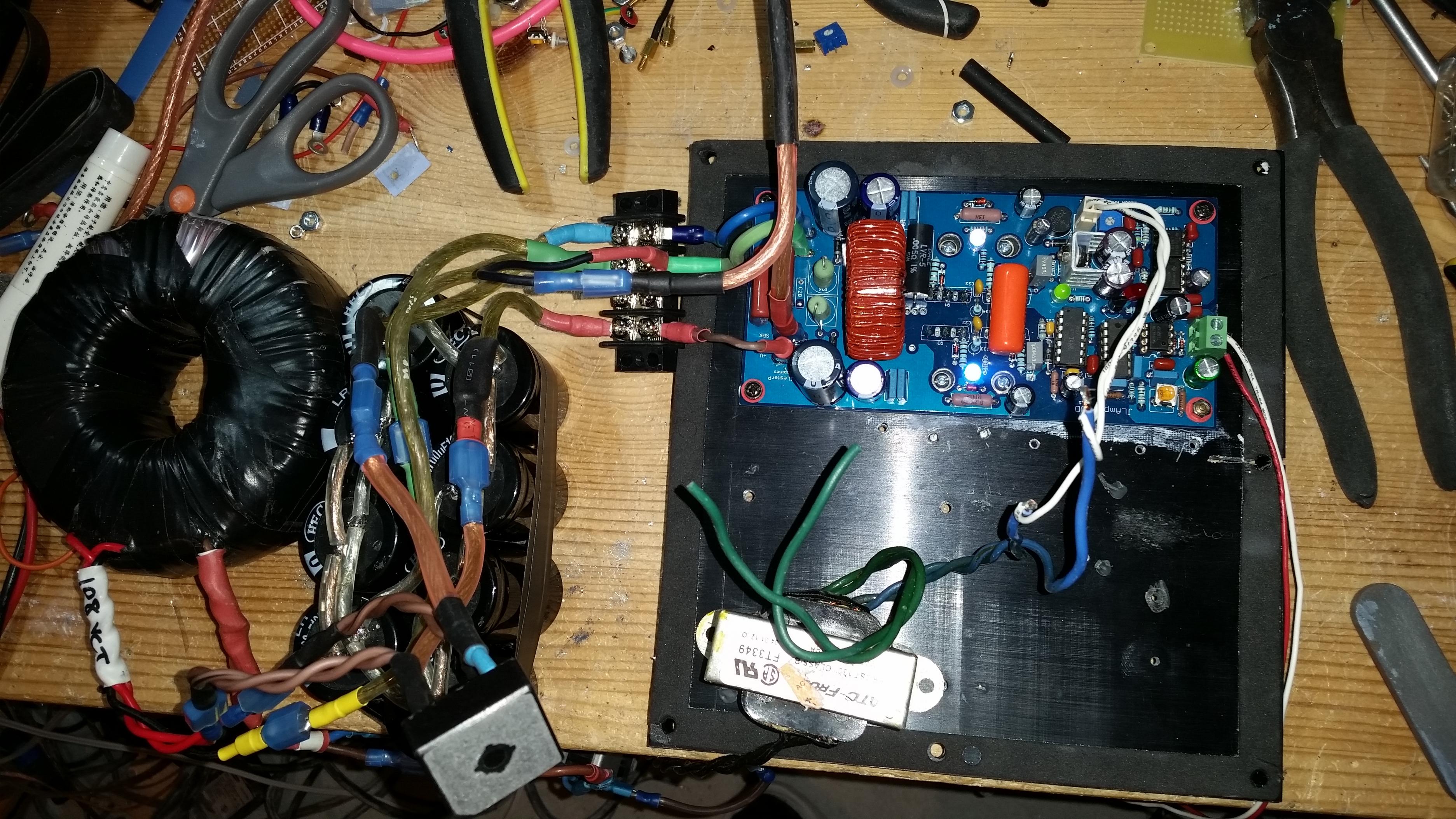

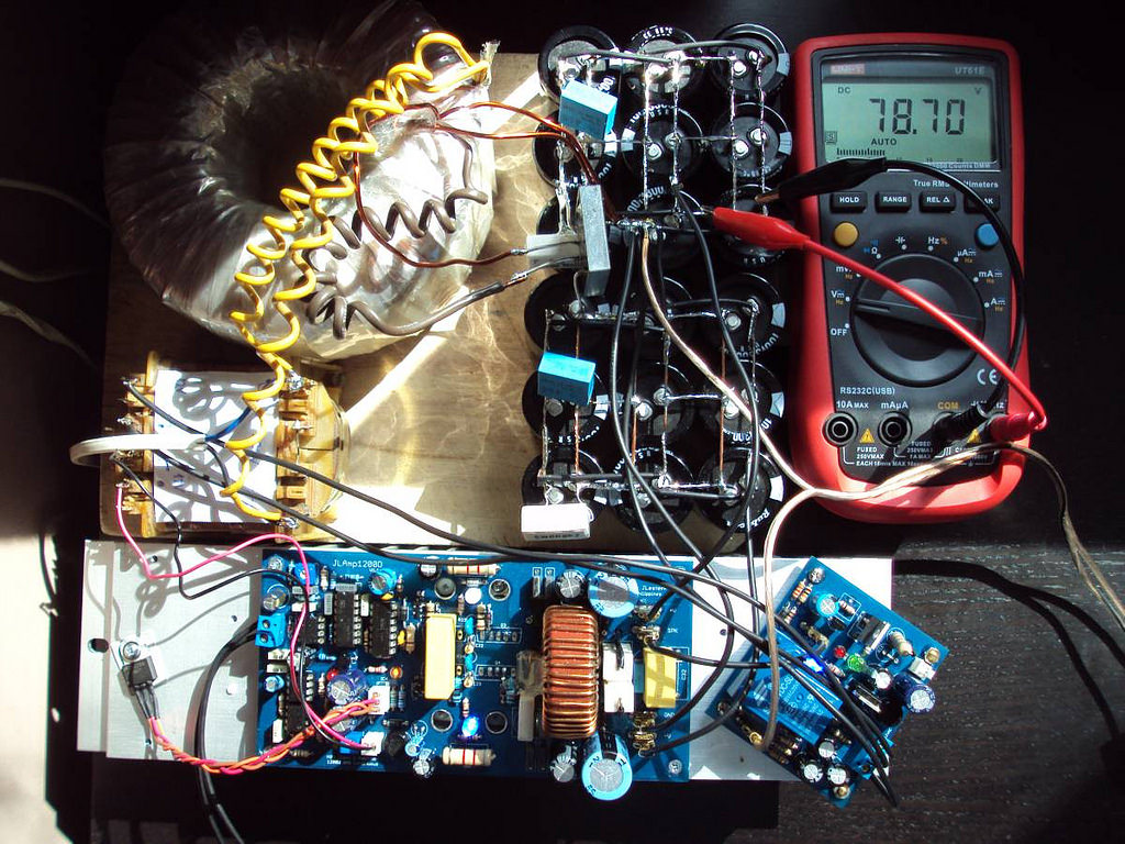

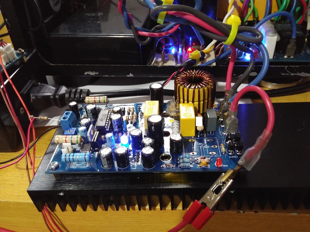

Finally assembled JLAmp1200D with safe +-78VDC power supply. Everything works great. Only have to be careful with gain, it really have A LOT of power.
Best Regards Everyone
http://ifotos.pl/z/wwehnxh
http://ifotos.pl/z/wwehnnh

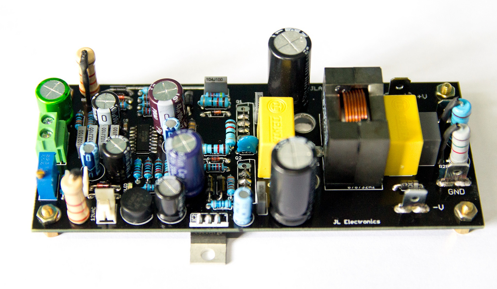

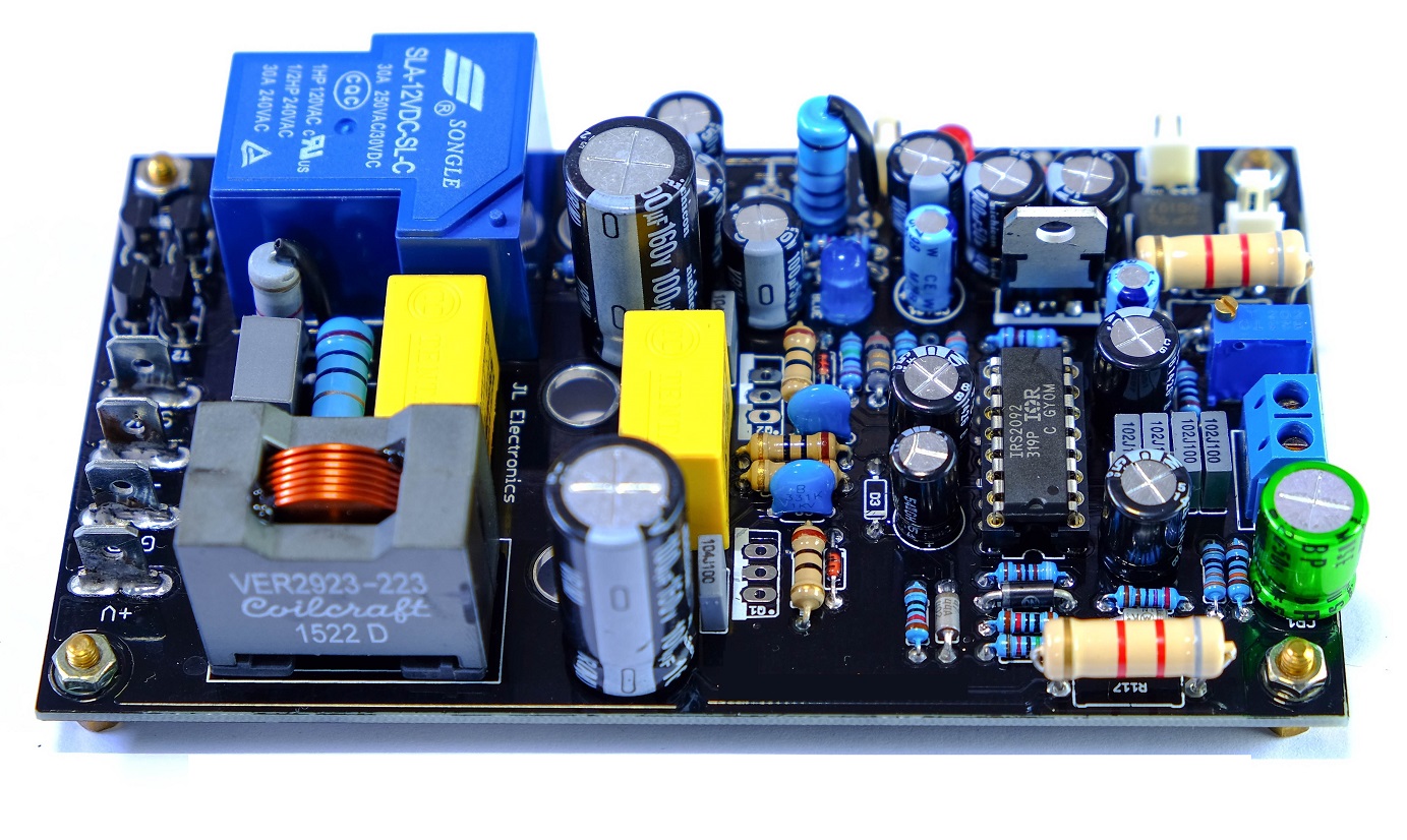

JLAudiophile-900D

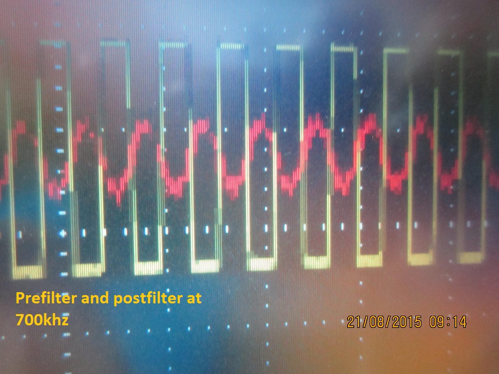

IRAUDAMP7 based class-d with totem pole buffer for high oscillation frequency (~700kHz), ~50ns deadtime setting. More analogue sound.
Uses IRFB4615 and VER2923-223 inductor for higher current capability.
Can also be configured for 900W version using 1pair IRFB4127 and T157-2 inductor and some resistor values adjustment.

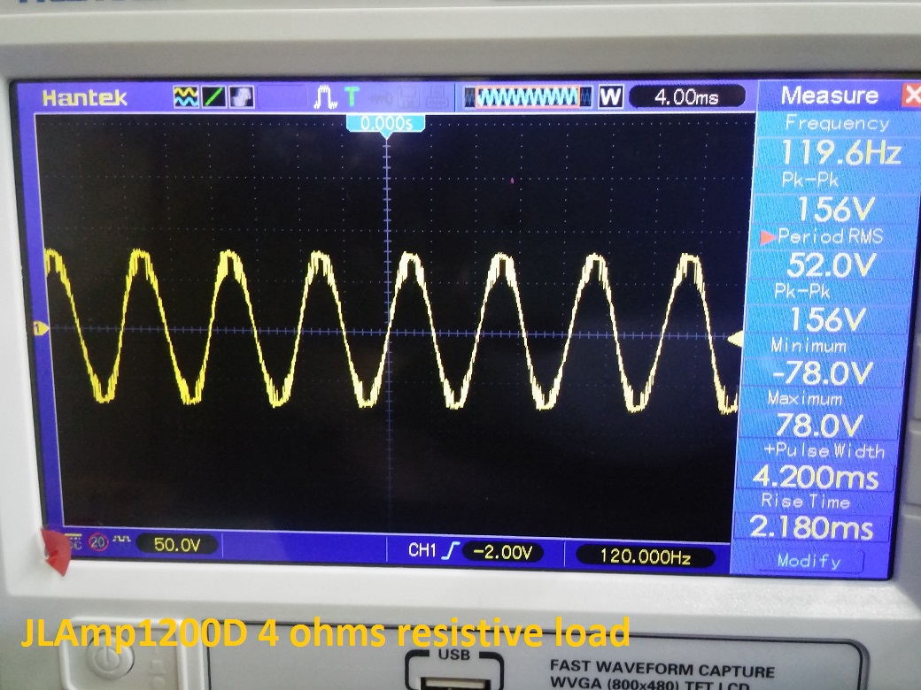

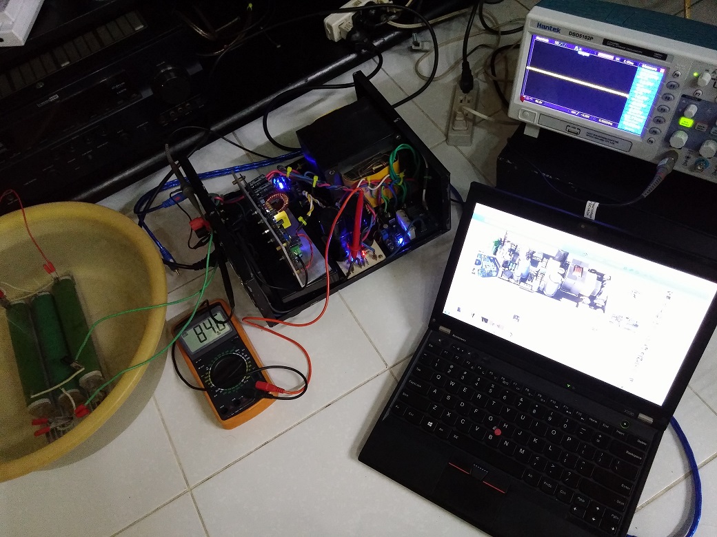

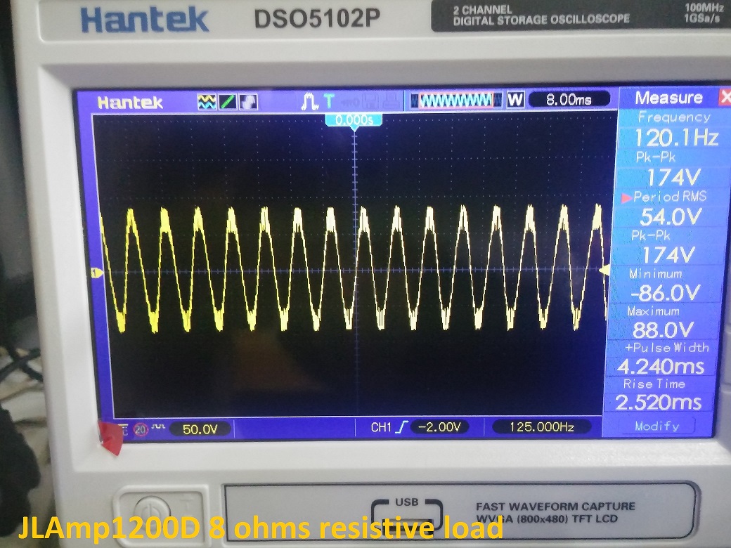

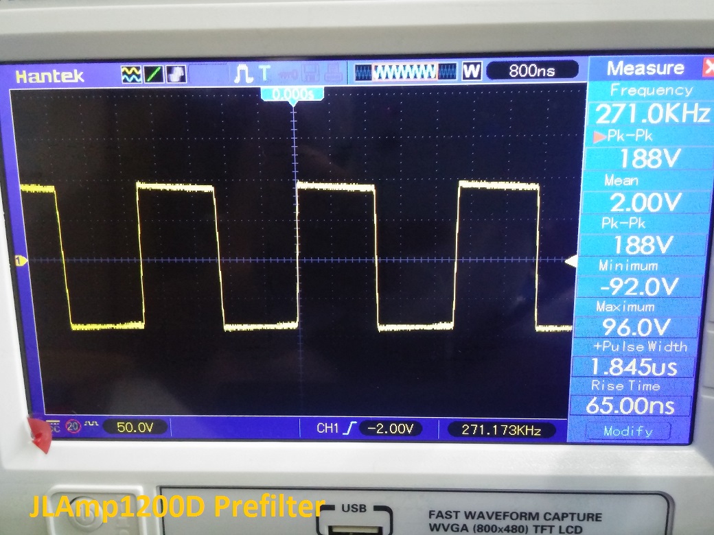

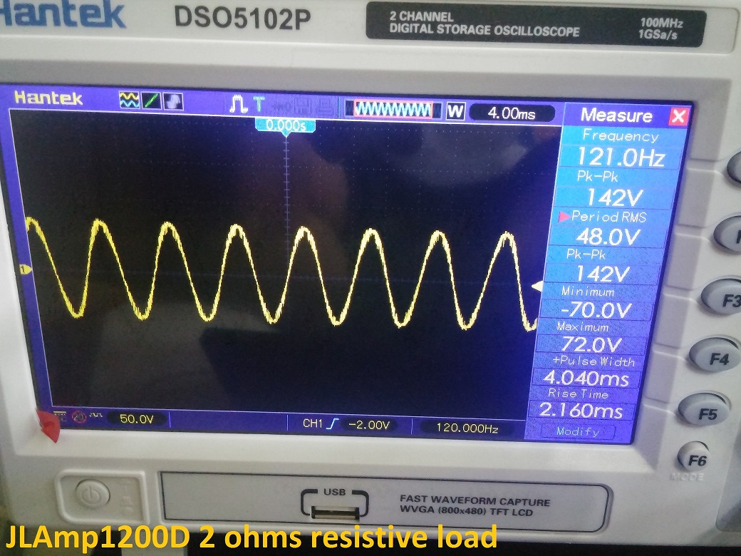

Power measurements for JLAmp1200D
2 pairs IRFB4127, T157-2 18uH inductor
+/-84VDC Rail supply
270kHz idle oscillating frequency
Output Power Results
120hz 54V RMS at 8 ohms
364.5W at 8 ohms
84V dropped to 79VDC
120hz 52V RMS at 4 ohms
676W at 4 ohms
84VDC dropped to 73VDC
120hz 48V rms at 2 ohms
1152W at 2 ohms
84VDC dropped to 65VDC
Power measurement is only done in 10 seconds, will upload FTC power measurements using 1/3 rated power in 15 minutes on youtube.

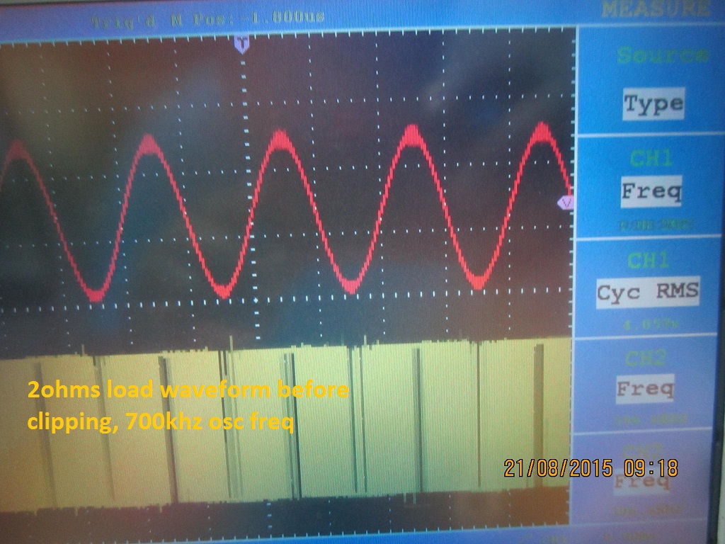

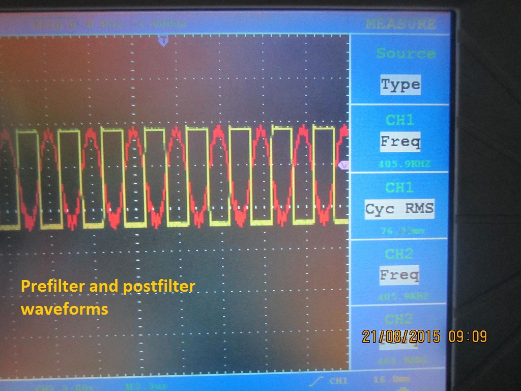

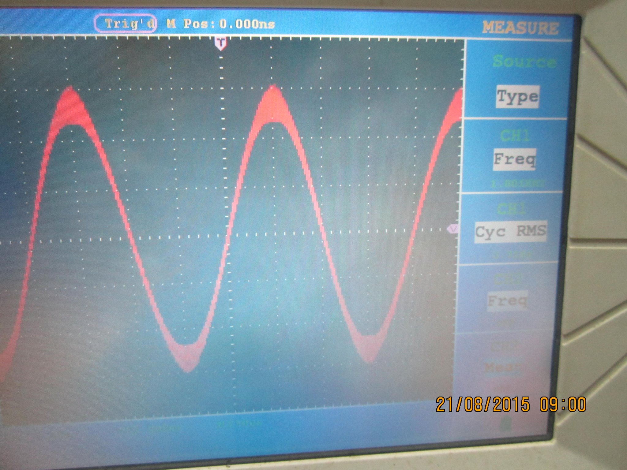

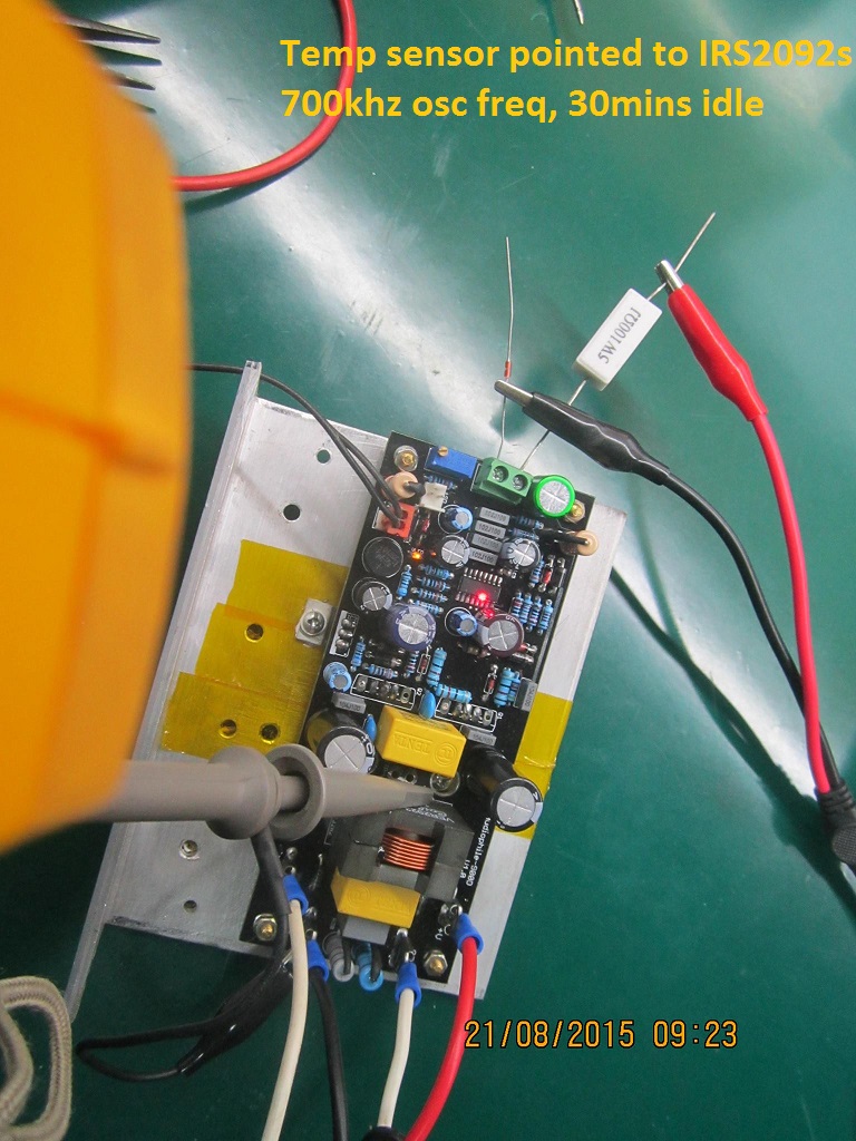

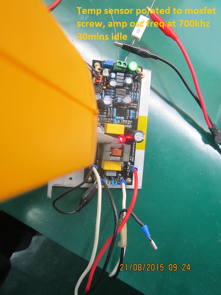

Some measurements for JLAudiophile-900D
1pair IRFB4615, Ver2923-153 inductor
Credits to my friend Efren (from cebu) for doing the measurements

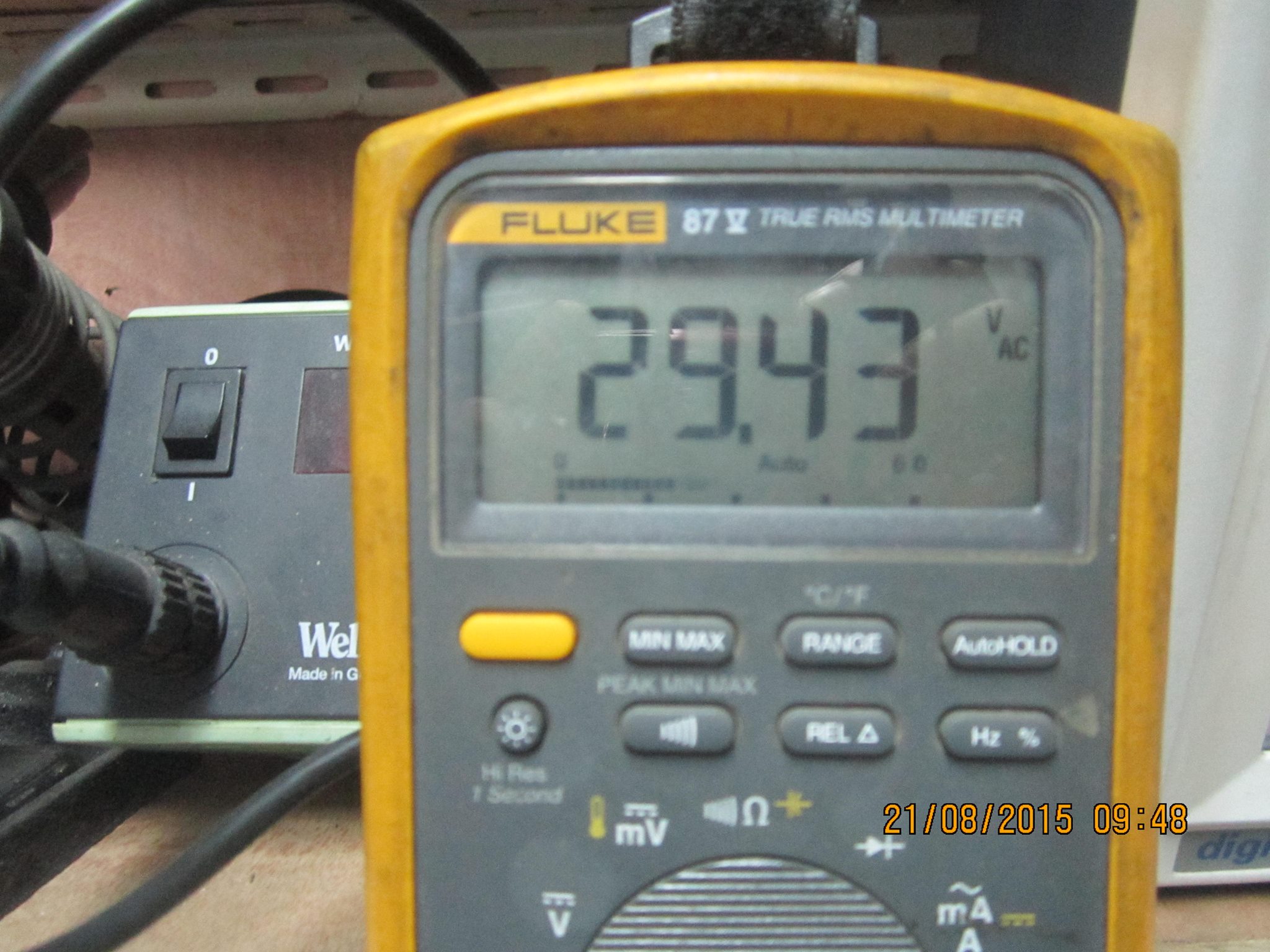

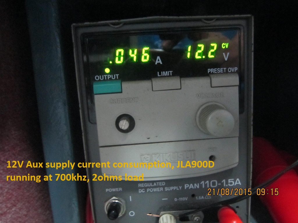

Test conditions
+/-65VDC Rail voltage
700kHz oscillating frequency
1khz sinewave input.
Results:
38.11VAC at 8 ohms load
181W at 8ohms load
29.43VAC at 2 ohms load
433W at 2 ohms load

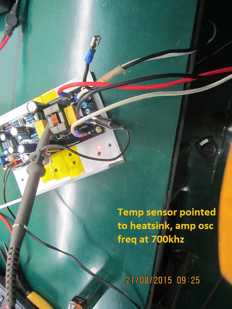

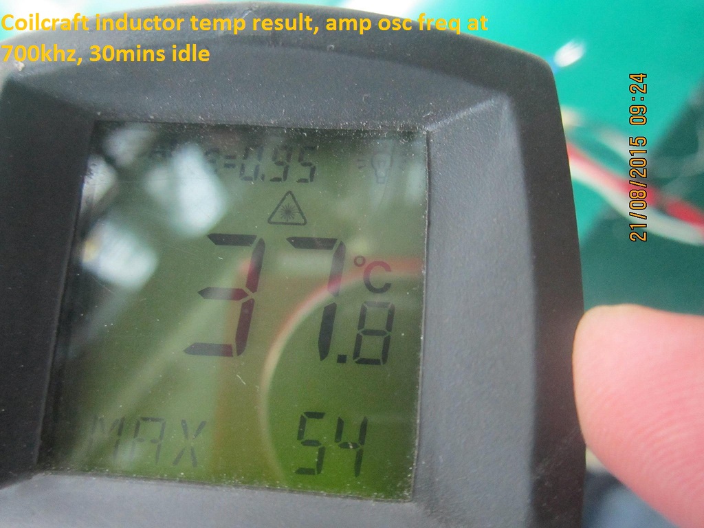

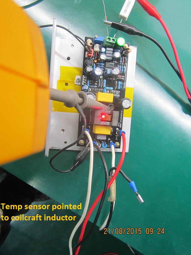

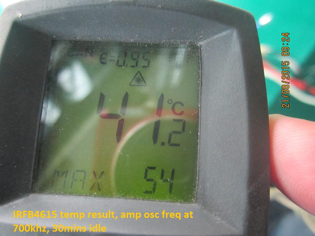

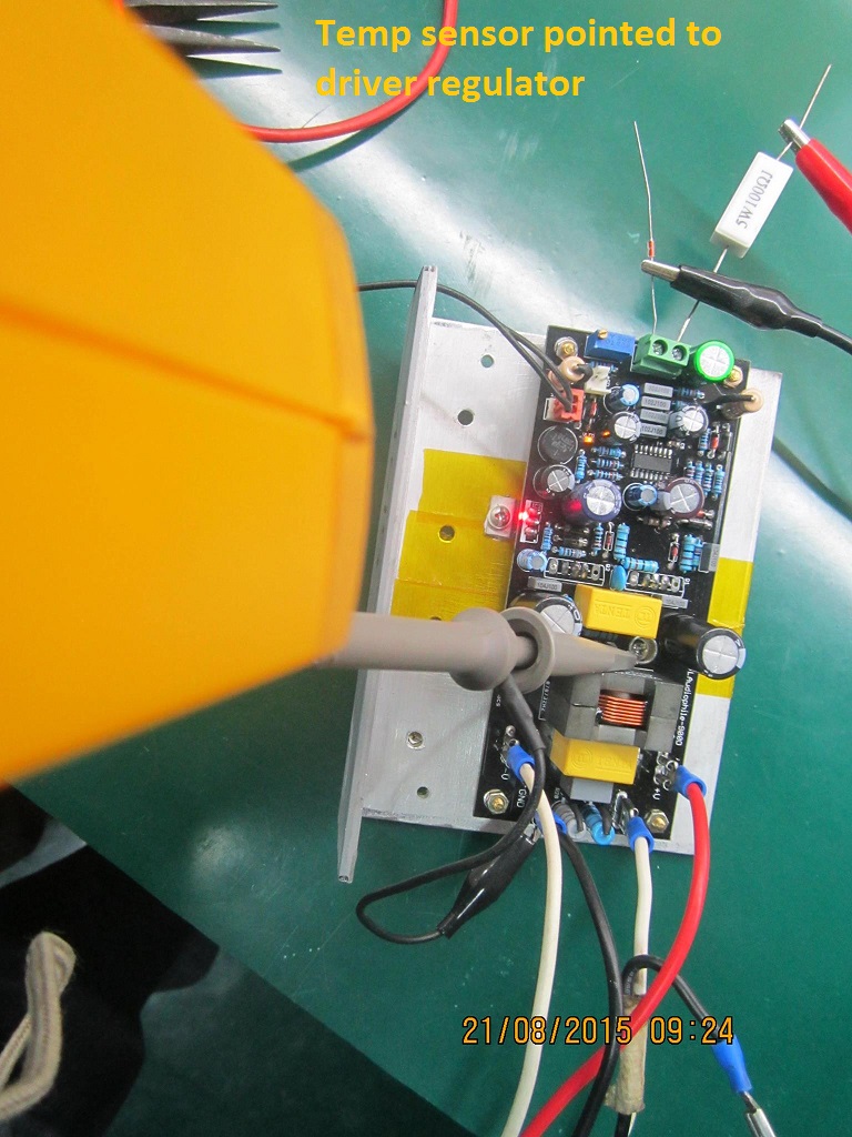

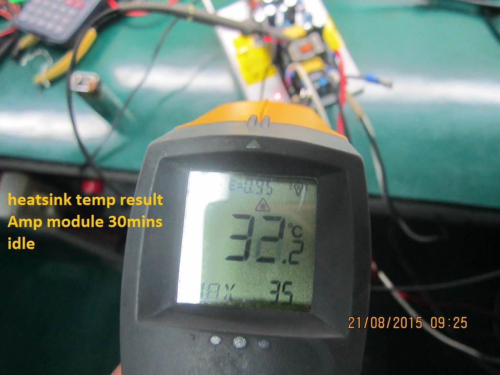

Temp measurements, amp is idle for 30mins 700khz osc freq.
IRS2092 = 48deg C
IRFB4615 = 41deg C
Inductor = 37deg C
LM350 = 42deg C
Heatsink = 32deg C
Test conditions
Results:
181W at 8ohms load
433W at 2 ohms load
IRS2092 = 48deg C
IRFB4615 = 41deg C
Inductor = 37deg C
LM350 = 42deg C
Heatsink = 32deg C

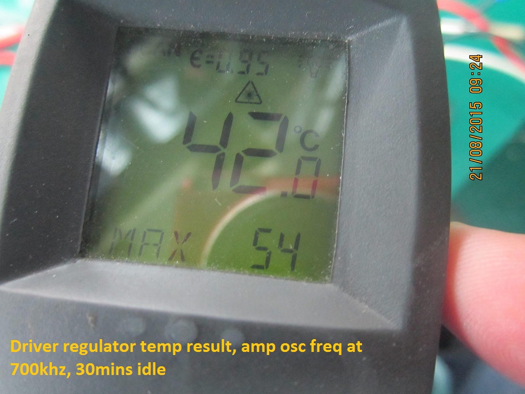

IRS2092 = 48deg C
IRFB4615 = 41deg C
Inductor = 37deg C
LM350 = 42deg C
Heatsink = 32deg C
IRS2092 = 48deg C
IRFB4615 = 41deg C
Inductor = 37deg C
LM350 = 42deg C
Heatsink = 32deg C

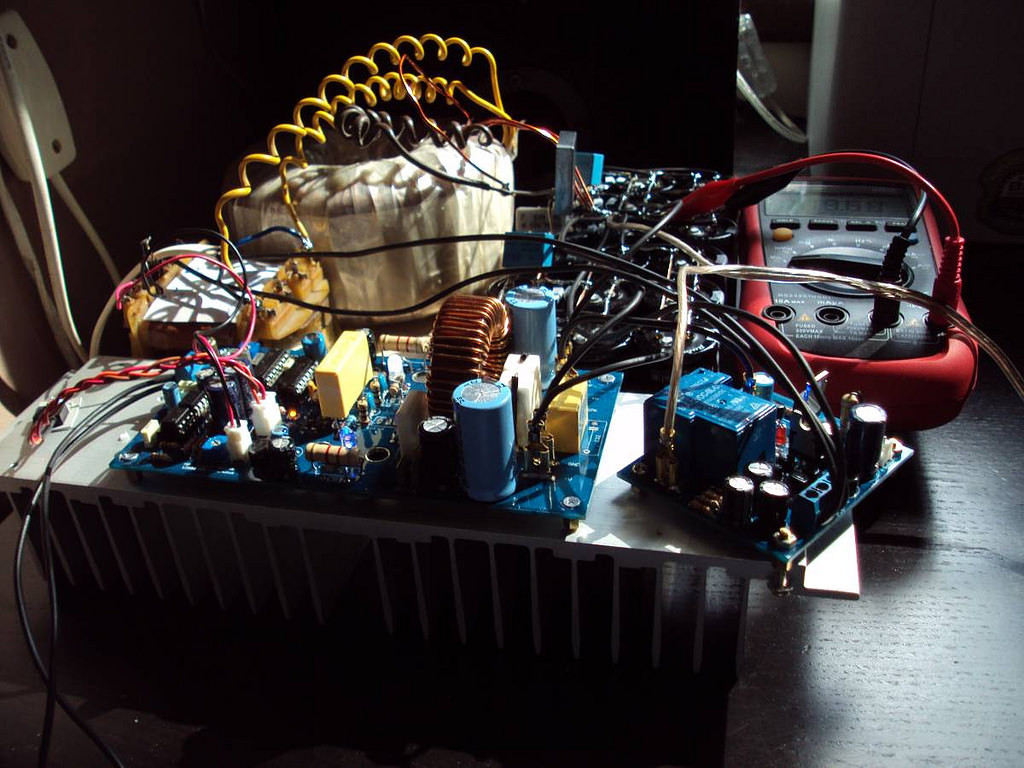

Dancal6 inspired me to get mine built. Running at +/-84v... Only tested on an 8" woofer, free air so far but looks promising 🙂
Thanks for posting your setup, I thought you didn't build the module because you haven't contacted me for help. Anyways nice build 🙂

JLAudiophile-900D running on single supply.
Test conditions:
First video: <click here> clipping performance 1khz output 8ohms load with single supply.
Second video: <click here> sound check, PSU ground still disconnected
Didn't encounter problems probably because:
Input source is floating and is not referenced to -B.
Input signal is 1khz, according to AN-1164 Effect of floating ground fluctuation will be pronounced under low frequency signal.
Sound is crystal clear and no audible distortion probably because of very good power supply. (Load ground fluctuation is minimal)
Note: Do not replicate!, this test only shows that single supply operation as described on AN-1164 is doable 🙂

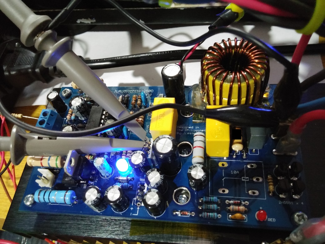

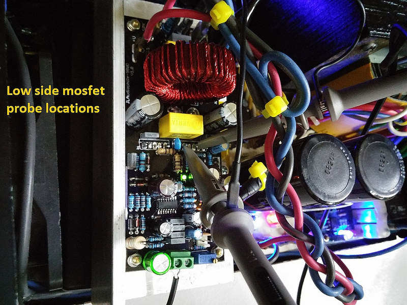

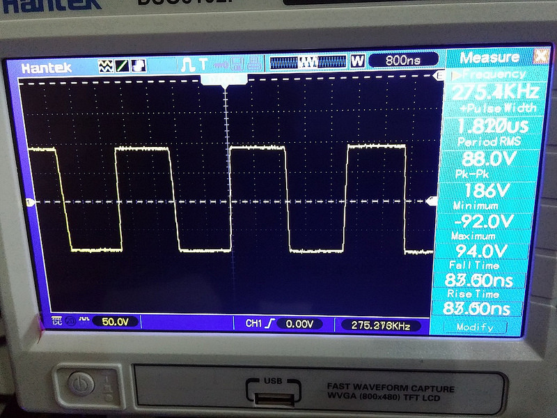

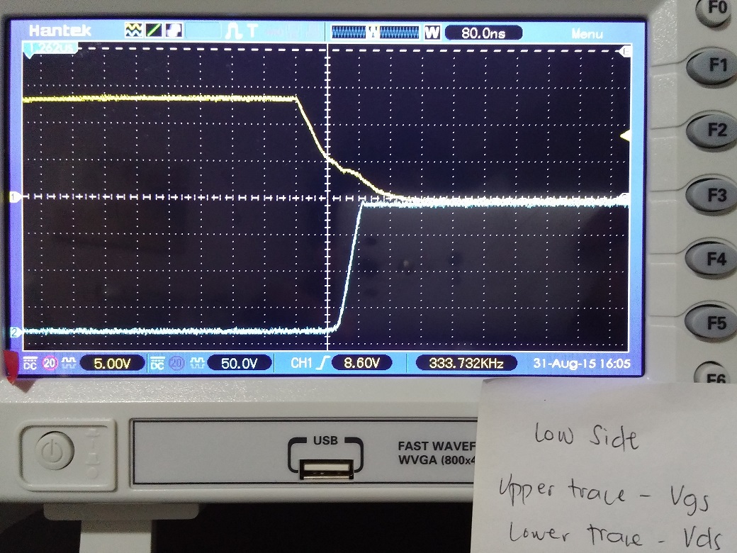

JLAudiophile-900D Scope shots
Buffered IRAUDAMP7
1 pair IRFP90N20D
+/-84V DC Rails
275khz idle
Buffered IRAUDAMP7
1 pair IRFP90N20D
+/-84V DC Rails
275khz idle

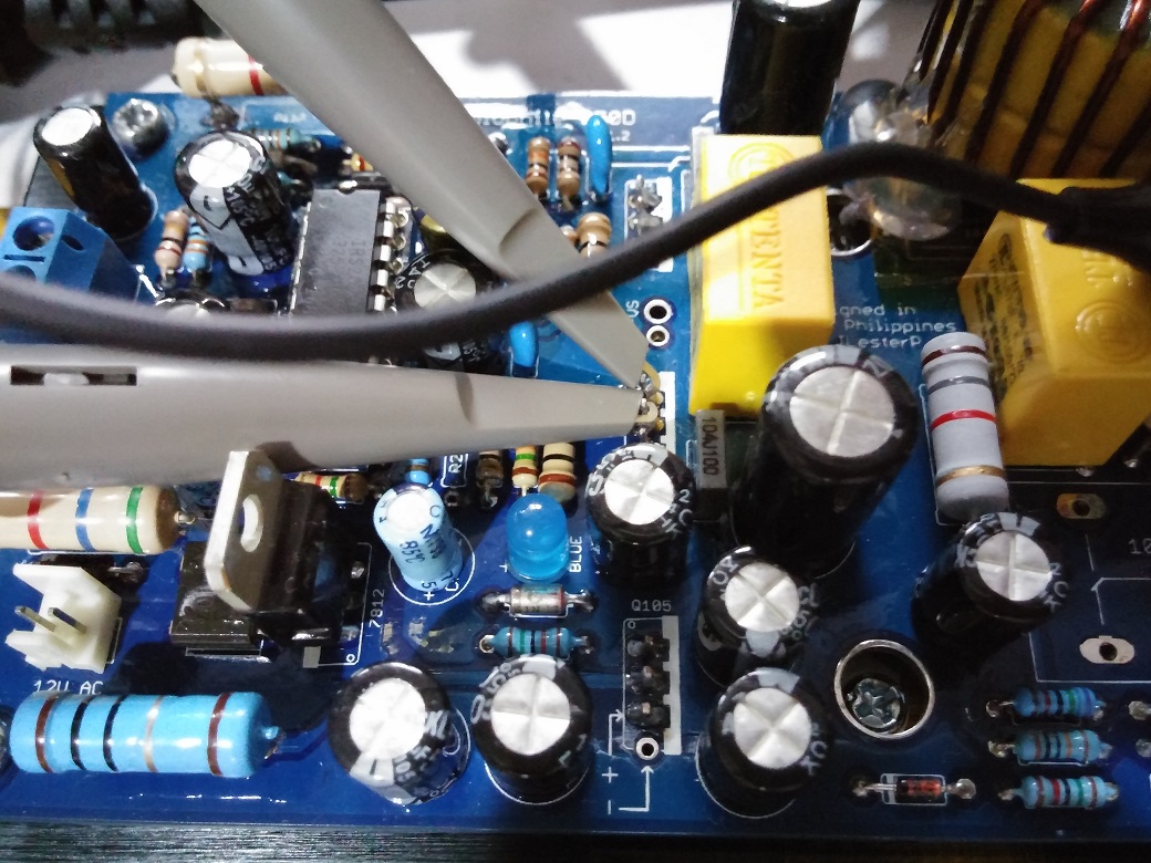

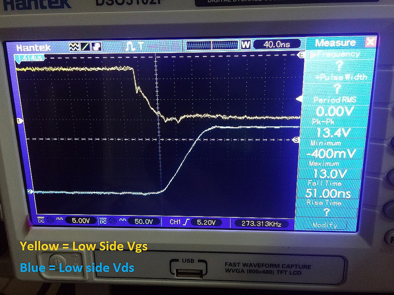

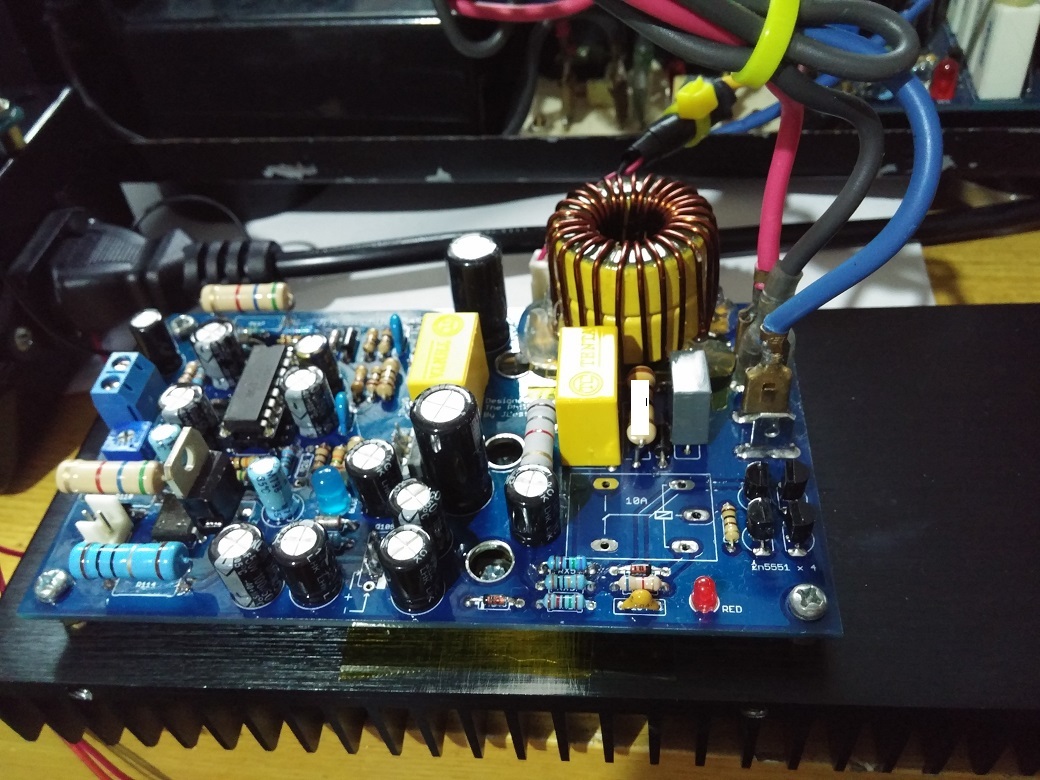

JLAudiophile-250D with IRFB4227
Output mosfets directly driven by IRS2092 😀
+/-84V DC Rails supply
330khz oscillating frequency
Output results (120hz input) (RMS)
8 ohms 380W output (10 secs)
4 ohms 650W output (10 secs)
2 ohms 1050W output (3 seconds)
speaker protect relay is removed because it can't handle 2 ohms output.

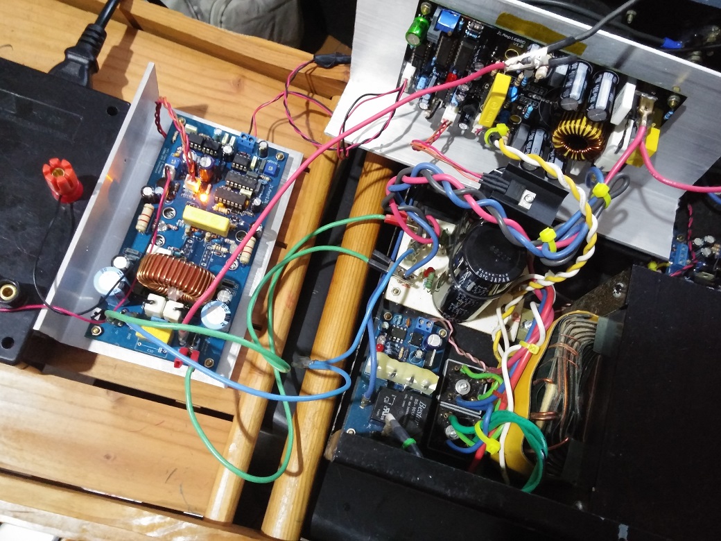

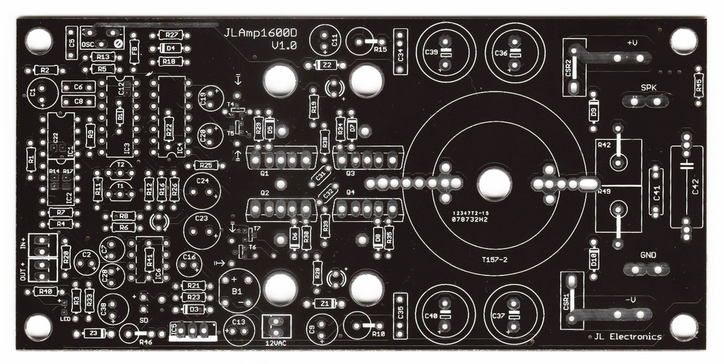

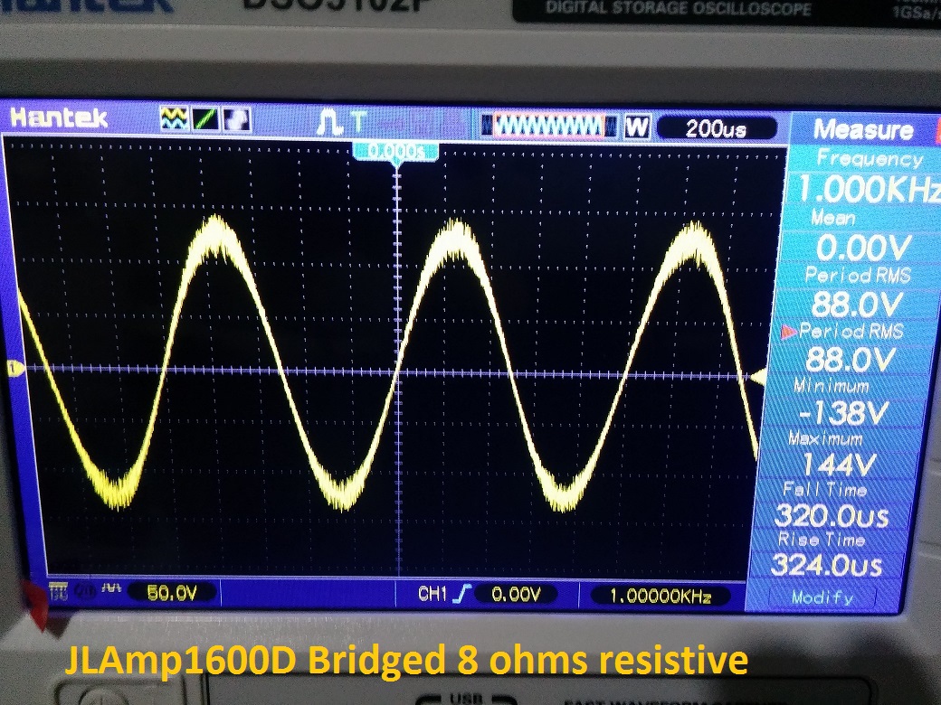

Testing the built-in bridge adapter of JLAmp1600D, paired with JLAmp1200D (identical gain).
Test setup:
Supply +/-85V DC (dropped to +/-70V @ full power)
Dummy Load: 8 ohms resistive (4 ohms test to follow)
Result:
88V RMS (below clipping)
968W @8ohms
Thick part of sinewave is the carrier frequency (330khz)
Test setup:
Result:
968W @8ohms

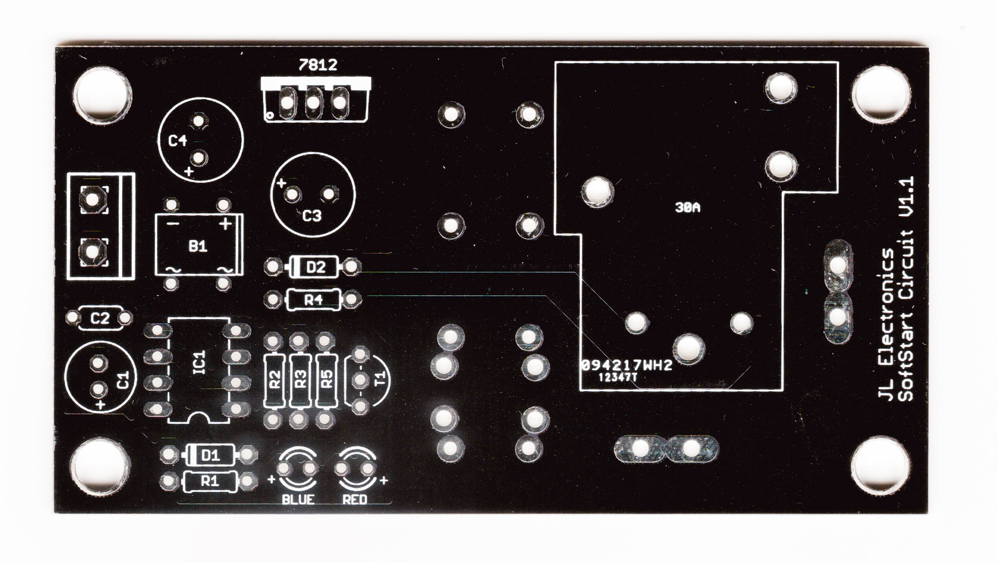

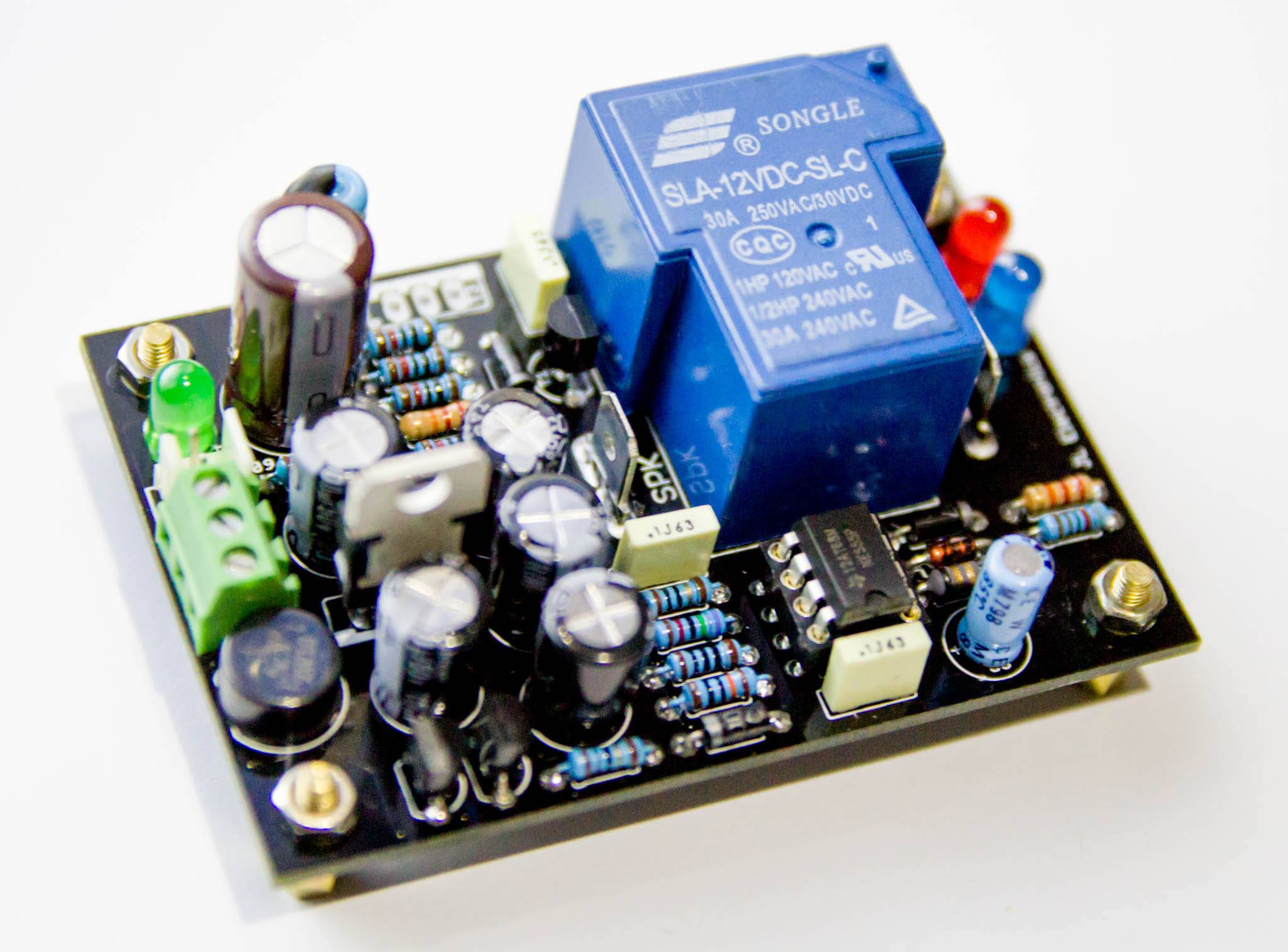

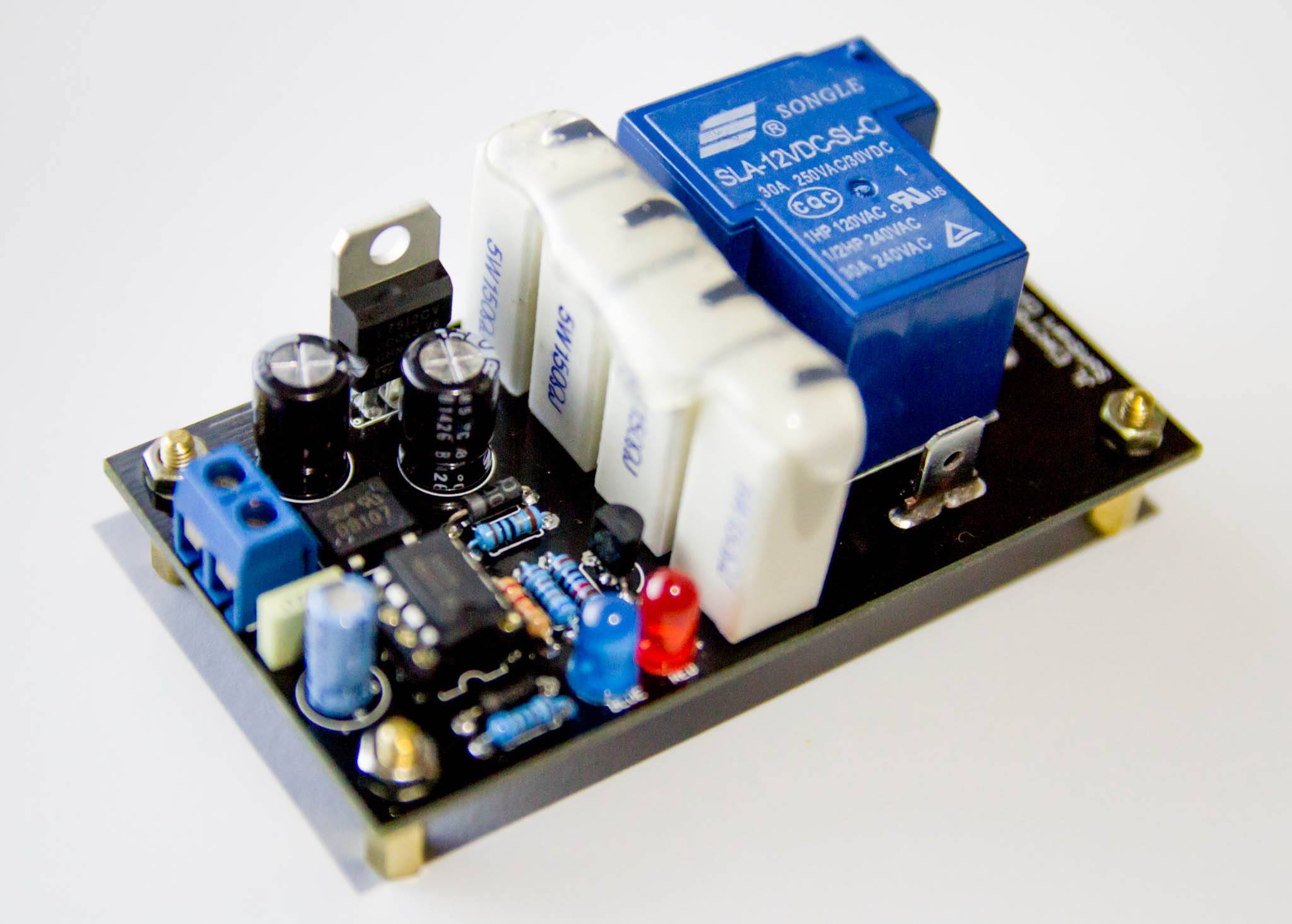

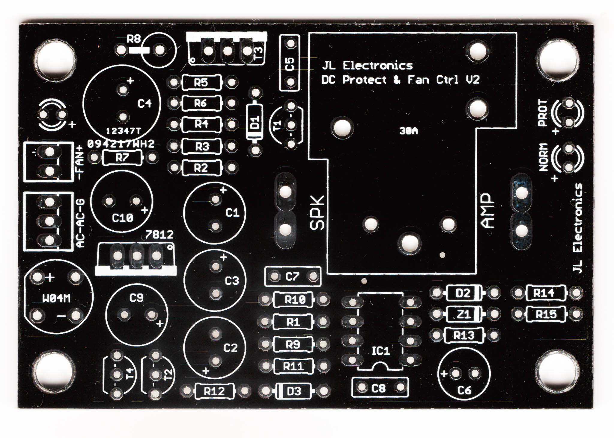

New version Softstart and Speaker Protect
New version of softstart and speaker protect. Fixes minor shortcomings of previous releases. (no pcb errors)
- Simple design, easy to assemble, gets the job done.
- Low footprint, saves chassis space

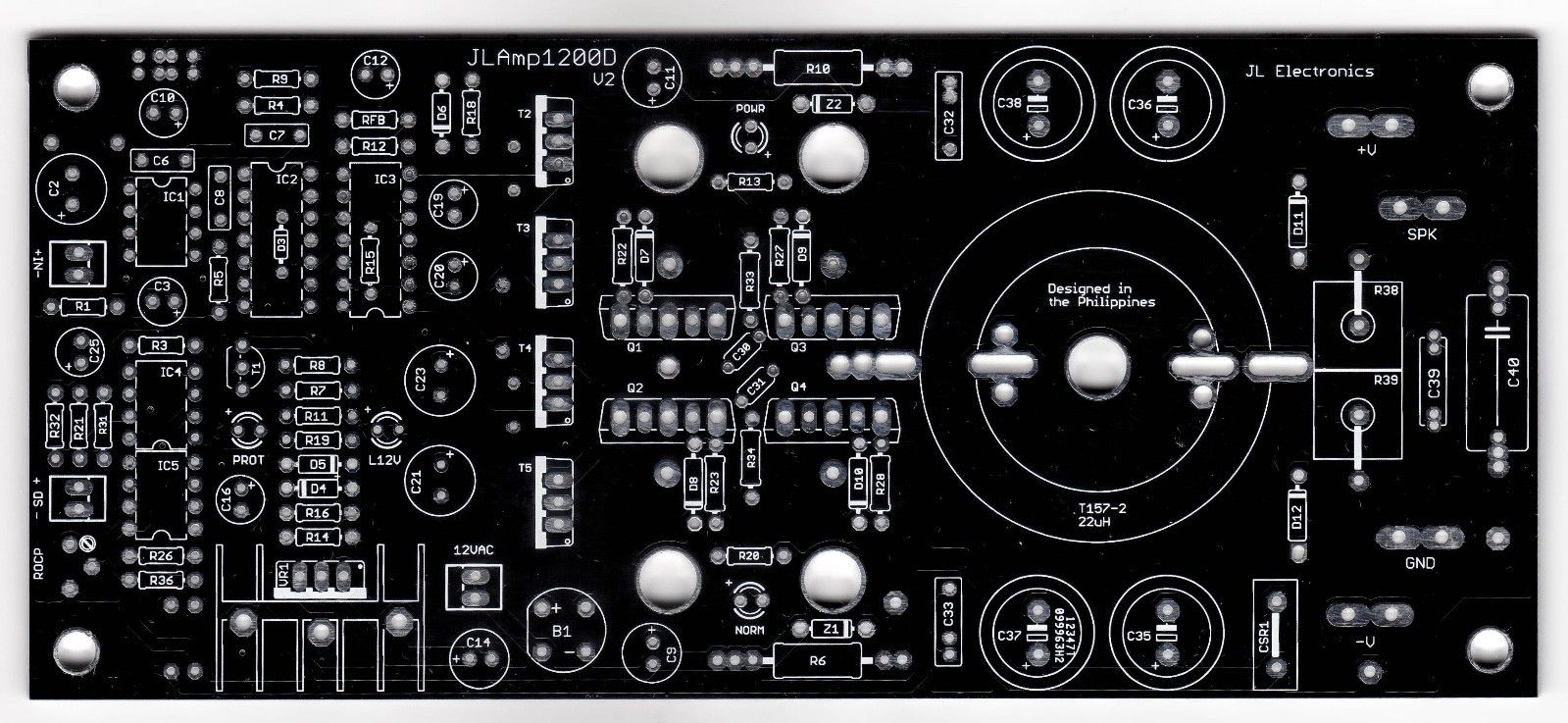

New Products
JLAmp1200D V2 PCB
- IR2110 driver
- For +/-100V DC rails
- Easier to assemble than previous version, no errors
- PCB size: 3" x 6.9"
- Thickness: 2mm
JLA-2092D L.E (JLA-250D V2)
- IRS2092 DIP16 driver
- For +/-75V DC rails
- 3 ohms to 8 ohms load
- PCB size: 2.8" x 5"
- Built in 20A speaker protect
- 2 modules can be bridged to get 900W @8ohms
JLAmp1200D V2 PCB
- IR2110 driver
- Thickness: 2mm
