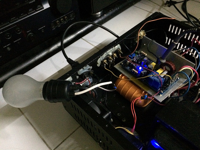

Mono JLAudiophile-1200D 2.66 ohms load video.
The amp didn't even heat up according to owner 🙂

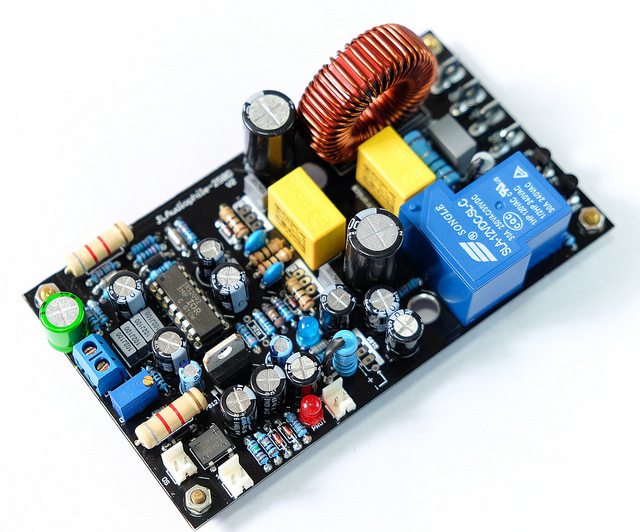

Stock IRAUDAMP7 with minor modifications.
- irfb4227
- reverse switching diode for fast gate turn off
- bleeder resistor on mosfet G-S
- 10 ohms gate resistors
- 10 ohms R114
- 100ns deadtime setting
- added speaker protect circuit.
No totem poles and other modifications, can get 1kw into 2 ohms, it's all in the layout 🙂

This is very interesting, have you finalized the modifications? this fits all my requirements for load flexability, power and physical size. is this avaliable as a prebuilt or just pcb . GregStock IRAUDAMP7 with minor modifications.

No, IC is heating up. Just decided to use IRFB4615/5620. 45ns DT, 400 kHz. Sound is better than most iraudamp7 implementations out there. Sounds like high powered LM1875
Will release version with zetex 3003 buffers. IRFB4227, 75ns DT, 400khz fsw.
Compatible inductors 7G31A, T130-2, ver2923-223, .

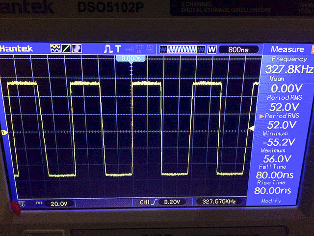

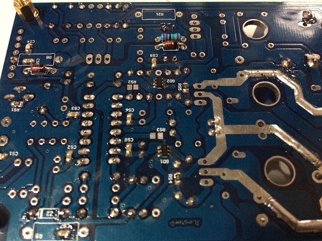

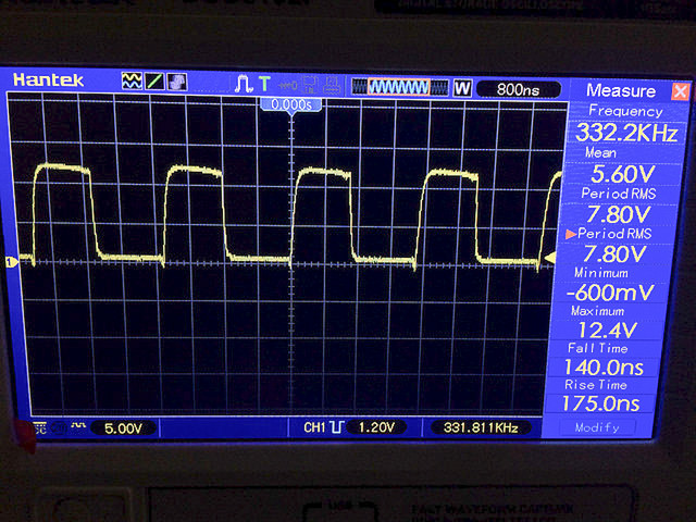

Final modifications for IRFB4227 build. (Also applicable to other IRAUDAMP7 builds without buffer)
- Heatsink for IRS2092
- 4.7R 1/2W gate resistors with reverse schottky
- 100 ohms 1W R114
- 12V zener Z1, Z102
- 320 kHz fsw
- omit R26 for DT 105ns
- 33 uH output inductor.
Main concern is the heat output of IRS2092. IRFB4227 and inductor is cool in this config.

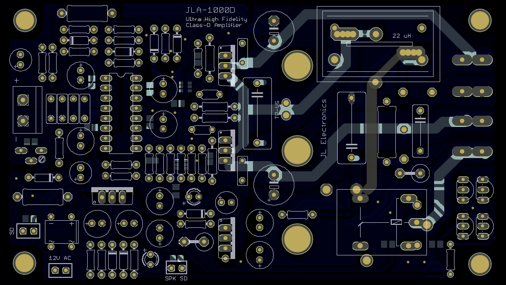

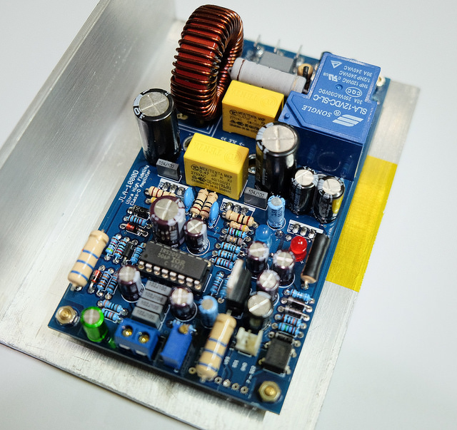

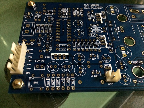

JLA-1000D
2 ohms stable, up to +/-85V DC Rails.
IRFB4227, 3003 Zetex buffer,
Can be used with T130-2, 7G31A, VER2923-223
Yes JL, it's done !
It's possible to configure itself with IRFB4615 ?
Dead Time range ?
PWM Frequency range ?
Dead Time range ?
D
Deleted member 148505
Yes JL, it's done !
Dead Time range ?
Yes, we can use IRFB4615 with DT 45ns 400khz to 600khz with this buffered IRFB4615.
