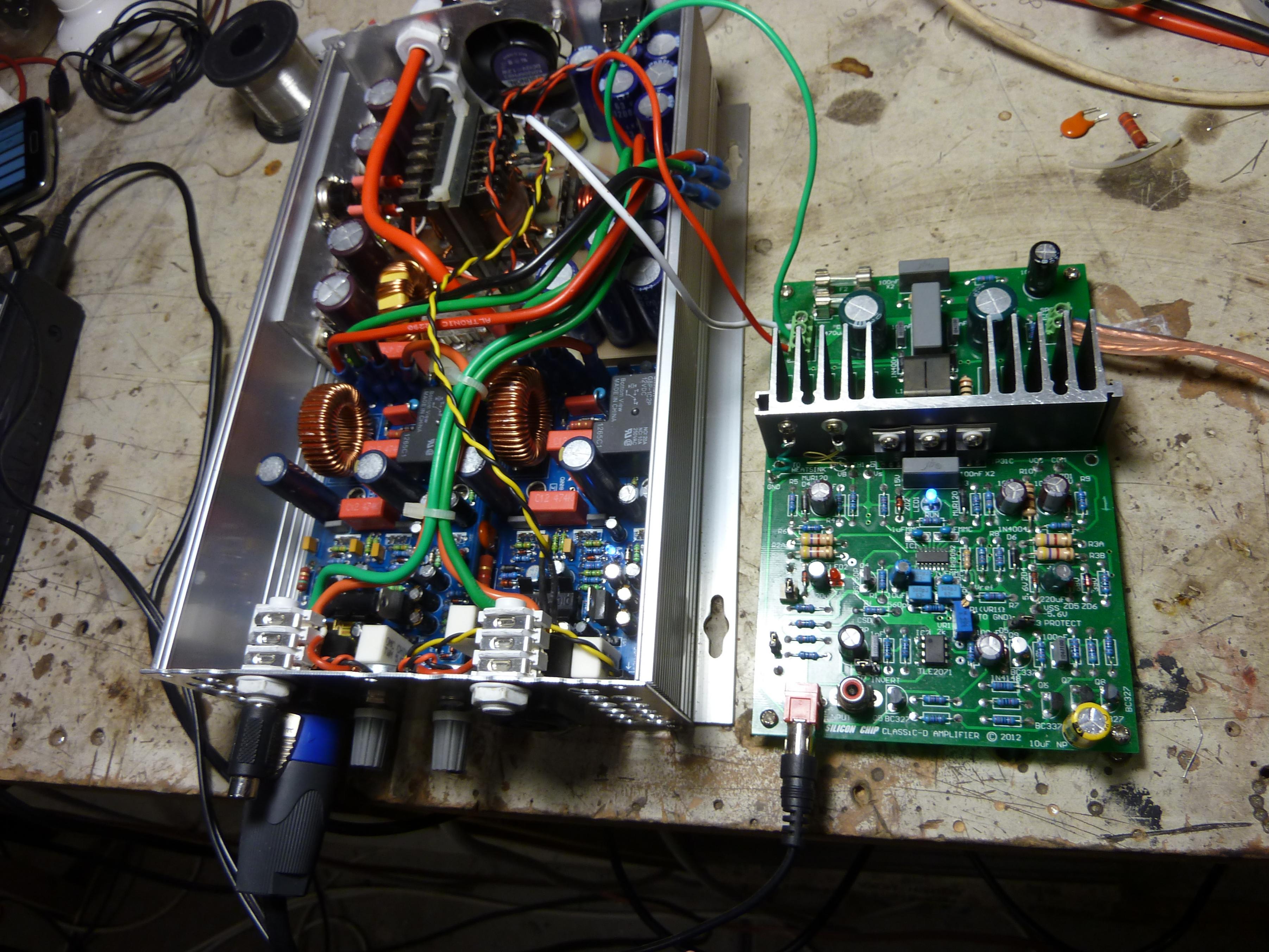

Hi Lester, Its been a slow build due to waiting for parts to arrive, anyway i had no problems with either board both sound really nice and detailed and not bright or harsh, credit to you for a quality design. my rails are +-60v and im getting about 130w at 8r with a 100hz sine wave at just below clipping. Greg

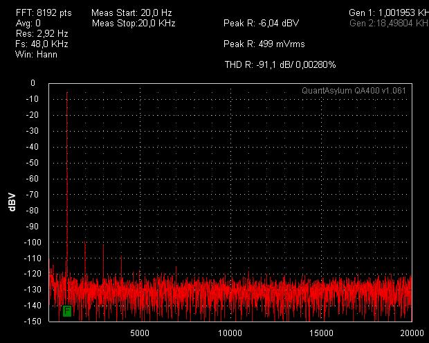

I think your "quality made" module associate to the pre-filter schema of chocoholic can make a magic result .
I read the post of the SystemD LiteAmp, impress by the result without "quality components" @ 10W/4R: -91.1 dB / 0.0028% THD
Comparing to your measurement of the JLA250/800 it is the same (normally at 8R => less THD than 4R), but it's just measurement, can't replace serious listening !
It is expected to have lower THD because of post filter feedback topology and it has lower deadtime setting (25ns), mine has 75ns setting.

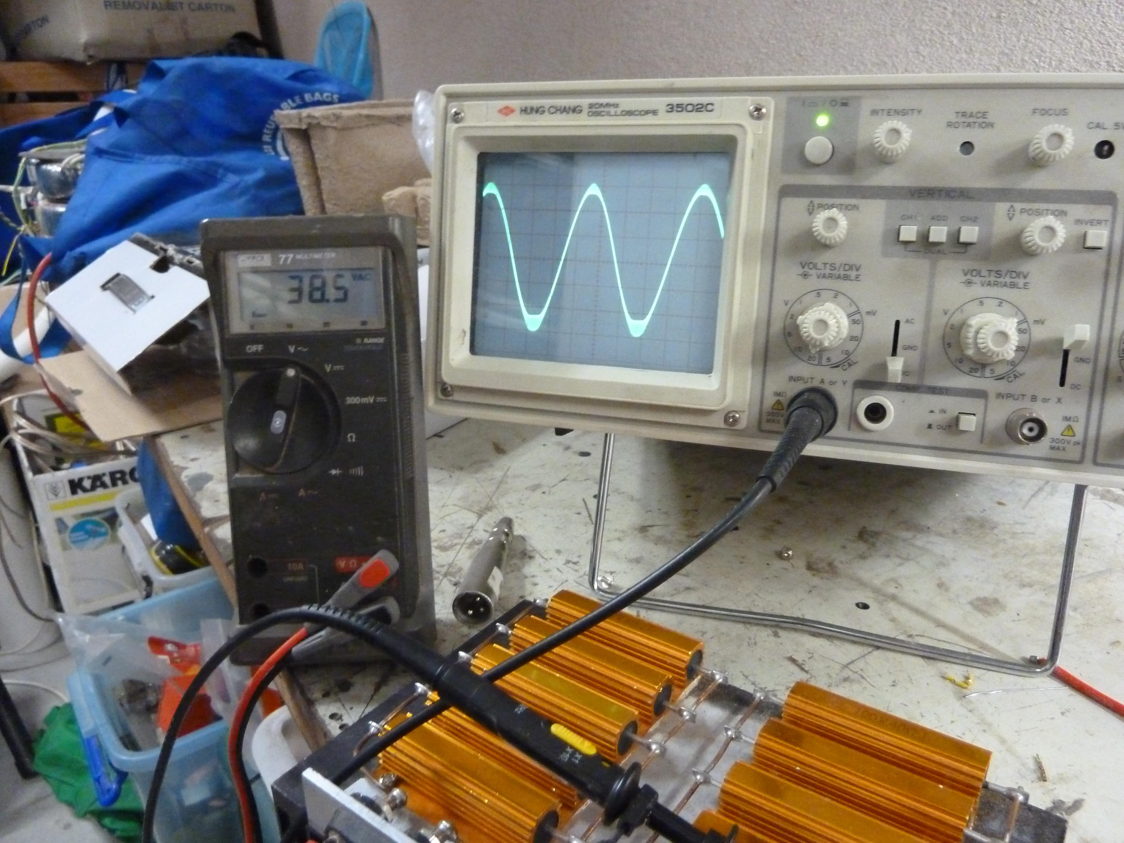

Hi, my power supply is a smps, and i did measure rail voltage at clipping and there was no sag. what areas should i look at to work out what going on? i was expecting 150w or slightly more at 60v rails. i was very impressed with the sound quality though. thanks Greg
photos to follow
I double checked my smps and connected another irs2092 class d board i have and managed 38vrms into 8r vs the best i could get from the jle800 was 34vrms just below clipping. one thing i noticed was the carrier signal of the jle800. at idle with input grounded and 8r dummy load i had 3.5vpp carrier on the output. my other amp had only 1vpp. Would the output filter need adjusting to suit the lower frequency of the 4227 build?
photos to follow
Is the load you're using resistive? You should use high power resistor (not speaker) so that the resistance is not changing at different test frequencies, also when the resistor heats up, the resistance slightly changes so you should measure it too.
Also check if your multimeter RMS reading is changing depending on frequency used. Usually they are accurate at 60hz.
The sine wave generator - output voltage steps should also be smooth,... maybe the step between clipping and below clipping is big, putting it in-between is hard (like in stepped attenuator)
Stiff +/-60V DC rails should produce clean 160W below clipping. And 220W at visible clipping.
If you have wattmeter, you will see the whole power consumption of the system at specific output power. For SMPS + class-d combo, usual efficiency at full power is around 80% to 85% so you will have a picture of the actual output power.
thanks Greg
What is the carrier frequency of your other class-d? Did you assemble the IRFB4227 build? Can you adjust the carrier frequency higher? When the carrier frequency is low, the carrier residual will be higher because the output filtering is better at higher frequencies (designed for 400khz).
Also when you are measuring output power, find the "averaging" menu on your oscilloscope to see the real signal, because you might mistaken the carrier residual at the peaks of the sinewave as "clipping point"
Lester
Yes my 8r dummy load is a bank of 5x100w 40r resistors in parallel. my mm is a fluke and i see no major change in voltage vs freq upto 1k. my signal is running through a mixer not a stepped attenuator. Greg
My other amp is magazine kit called a classic d from silicon chip mag, its frequency is 500khz. my scope is an old analogue 20meg crt unit, there is no averaging feature. clipping is clearly visible though, i will post up some pictures of my test setup tomorrow night. thanks Greg

Hi Greg, I received your email, can you repeat and compare your measurements with matched carrier residual amplitude with the other amp?
Because I think your multimeter is not including the carrier that is riding in the output signal in its measurements.
Example is your picture below. The clipping point is already touching the rails (oscilloscope setting is 20V/div), power supply is +/- 60V DC.

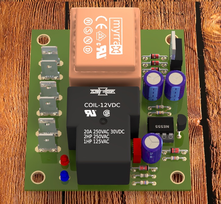

Updated products for 2017
Softstart (PCB size 2.5" x 2.85")
- Resistors are removed, and should be mounted on chassis so that you can use large resistors like 50W
- PCB mounted transformer
Speaker protect (PCB size 2" x 2.6")
- just smaller

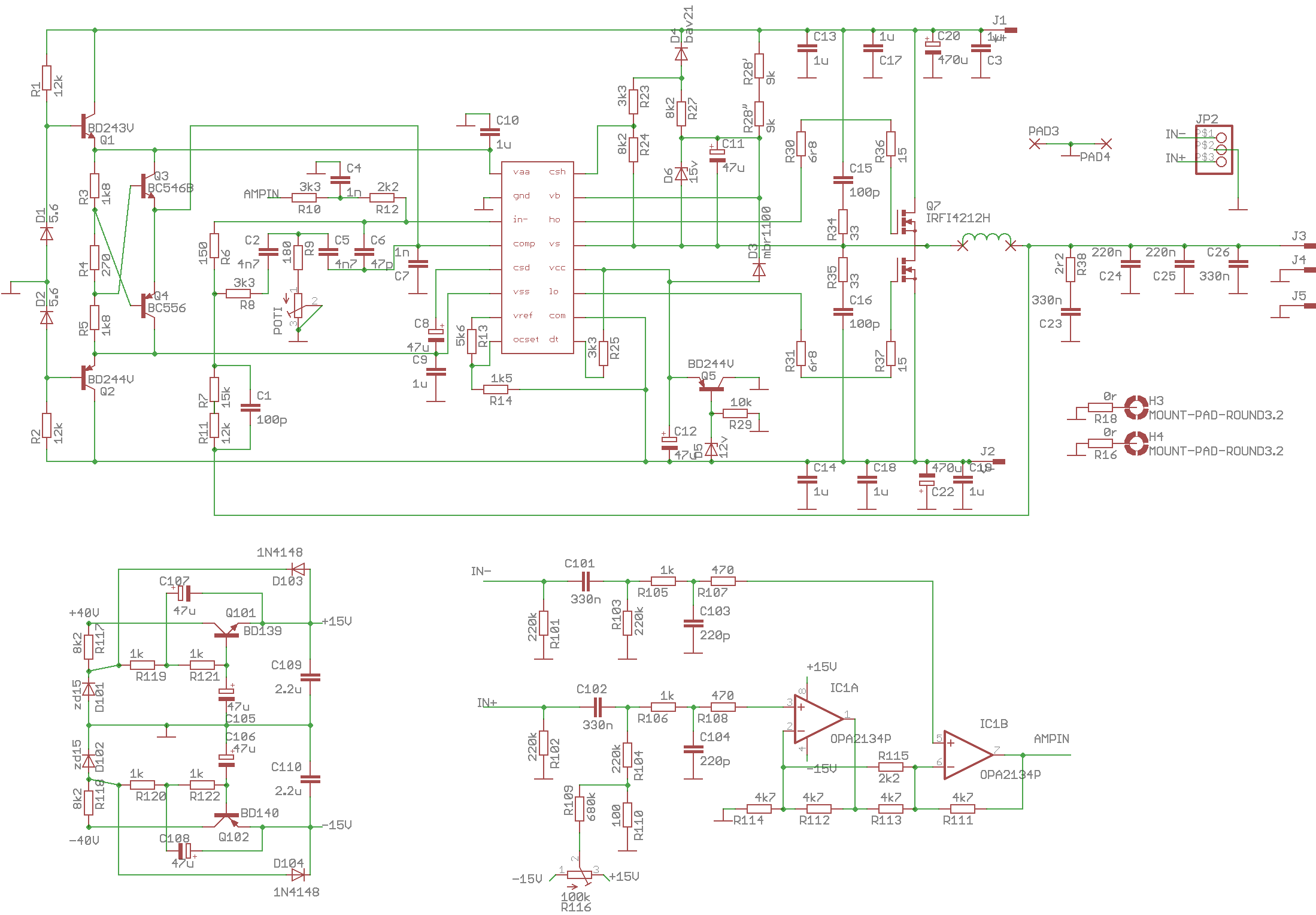

Cool Lester !
This is the Chocolic SystemD schematic :
Yup, almost the same except that my prototype has gate drive buffers so that it can be partnered with any mosfets. The front end I used is single ended. I have a separate balanced receiver board which uses THAT1206 that I will partner with it.
Like all my class-d boards the heatsink is L-type mounting so that it can be attached to a larger heatsink. Mosfets are attached on the underside of the board. PCB is only 3.4" x 3.9" so 4 x 4 inch L bar heatsink will fit which is common in my place hehe.
My prototype also has a different power supply requirements. It needs +/- 15V to 24V external supply for the opamp. Then +15V to 24V external VDR supply referenced to -V. It also has a DC detect with an open collector output similar to nFatal pin of NC400. So SMPS600 or similar SMPS will be compatible to it.
