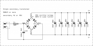

power dissipated in rectifier bridge

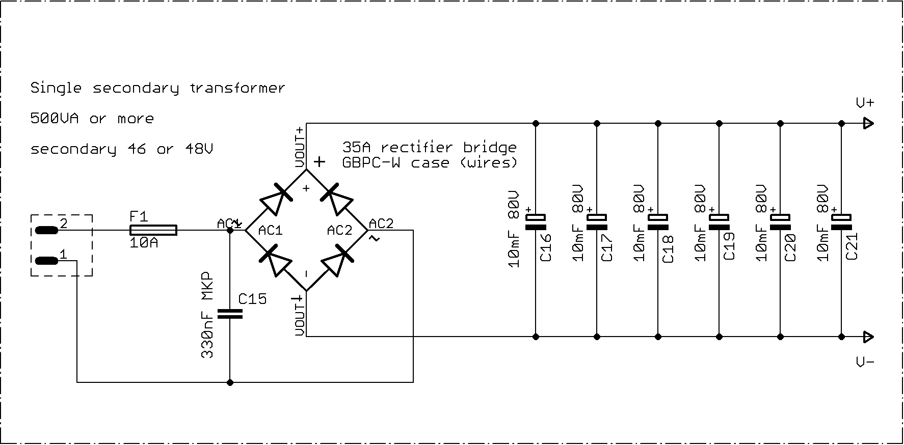

I found an another datasheet on that bridge rectifier which takes the ambiguity out, more or less, on how they express the characteristics. That other datasheet does state the thermal resistance as "junction to case", for the same value, so I guess that is what they all mean. Plus that one also provides the forward drop of 1.1V being for the bridge and not per diode.
So I suppose one diode does have a drop of 0.55V and not 1.1V.
Taking the rms current needed for the 2ohms load, we're at 11watts to dissipate in that bridge, so with the 1.5K/W resistance, we have a temperature rise of 17.6 degrees, which would make the bridge a little warm at full power, but not too much to worry about.
Tell me if I'm wrong, but this issue doesn't seem to be something to bother with. A small heatsink can still be slapped on top of that bridge eventually, for the wary of overheating...😀

You don't need to suppose. Just download the datasheet for the diode you are looking at and consult the Vf vs I graph to see the variation of Vf with respect to passing current. To add to your knowledge look at the Vf vs temperature........So I suppose one diode does have a drop of 0.55V and not 1.1V............

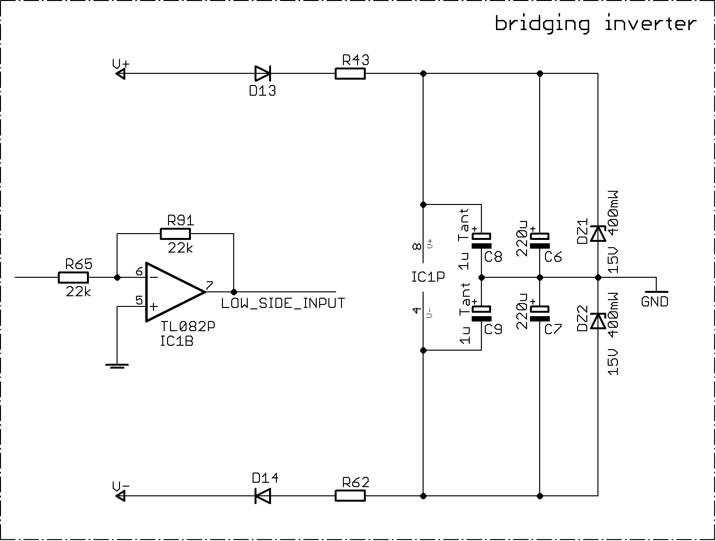

Actually, you can. Use a simple shunt regulator using zeners and dropping resistors. Bypass the zeners with 220 uf caps tied to ground. Remember the issue you were wondering about with the small signal rail filters? This is how to use it to your advantage. The caps will store the charge as the rails fly, and keep it clamped at +/-15V.
I have, but I just was having trouble with the 1.1V "per bridge" and that "junction to lead" info, so when I compared with a different datasheet, I realize the 1.1V must've been for 2 diodes and not just one.
The graph shows 35A for that bridge up to 50 degrees ambiant, so I did see anything about heatsinking there, and I assume this must also be the case temperature.

That sounds simple enough for a power supply, however what happens when the rails are very close to the ground? They can't get too close because of some Vcesat and little details like that, but they can come much closer than 15V.

The rails never stay close to 0 for very long. They move at the audio rate. When it drops below 15V, the cap across the zener will stop charging and supply current to the load (op amp or whatever). When rail voltage returns, the cap will re-charge. With any loading at all, there will always be some ripple but it doesn't really seem to be a problem.

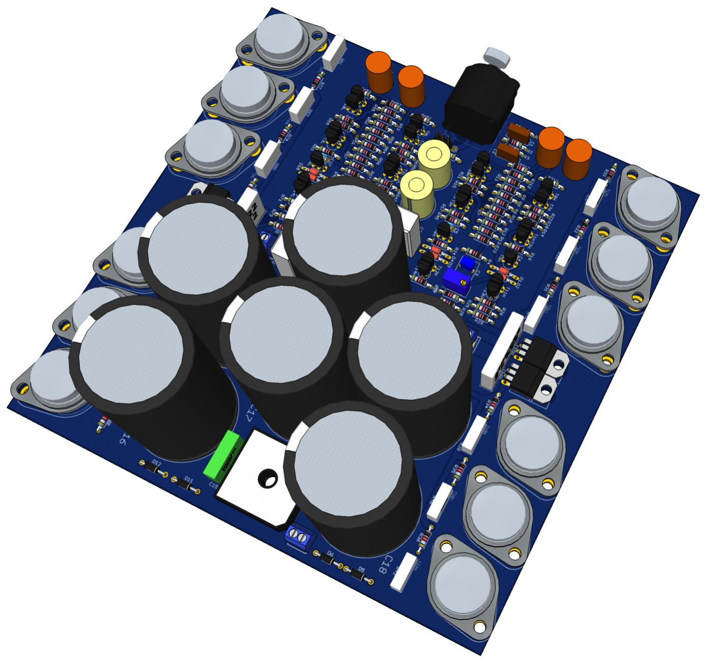

In the mean time, here's some 3D outputs as a preview of the work still in progress. It's not perfect and the layout will change further with the addition of the bridging circuitry. The routing is partial and that too will change greatly.
This is just to get a feel of how it will be.

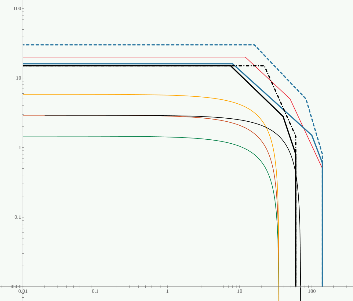

On this protection subject, I raised this issue earlier, because while looking at the SOA situation, I was wondering if having 3 pairs, being under such low rail voltage, would be able to withstand the short and no need any protection circuit. The load to handle is aimed at 2 ohms, because if the bridge is loaded with 4 ohms, that's what we have to handle.
The SOA graphs that I tried putting together were showing that a 2 ohms load (resistive) was quite inside the SOA. I was having issues figuring out how to correctly plot the load line for a reactive load. I may have gotten it right, but maybe not, so that's a point on which I need input.
The SOA plot is at post #74 and it has load lines for 8, 4 and 2 ohms. But that plot only has the resistive load curves.
I'm attaching a plot with my attempt at a reactive load line. This may be wrong, most likely.
On that plot, I added for comparison the SOA curves for the 2N3773 and the MJ15003. The 3055's SOA is in black, the 3773 in blue and the MJ in red.
I also added in dotted lines the 100ms curve for the 3773 and the 1ms for the 3055, which I have in the datasheets. There are no curves on those sheets for 10ms.
The load lines are 8ohms in green, 4ohms in red and 2ohms in yellow. That's for one transistor from the 3 pairs of course.
The thin black load line is the one that I'm not sure about. It would exceed the 3055's SOA in Vce, but that's 100% reactive, which doesn't really happen that bad. Can anyone double check my data and correct me if I'm wrong?
In case of a full short on the output, we have full rails on the transistors, the rails would sag the most, maybe even below 30V, and the current would go quite high, but a fuse could blow maybe before the heat becomes an issue. That reminds me that I haven't inserted any fuses on the pcb, but I think there should be only one and it can be on the secondary before the rectifier bridge. It would probably not be wise to have 2 fuses, one on each rail on such a setup...

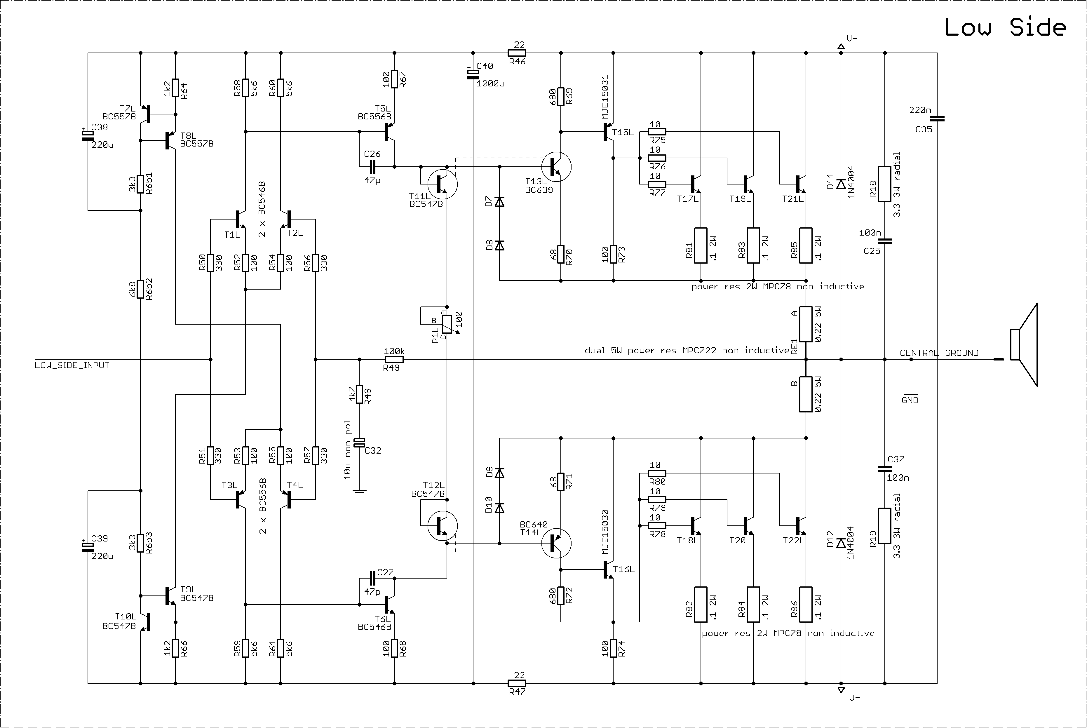

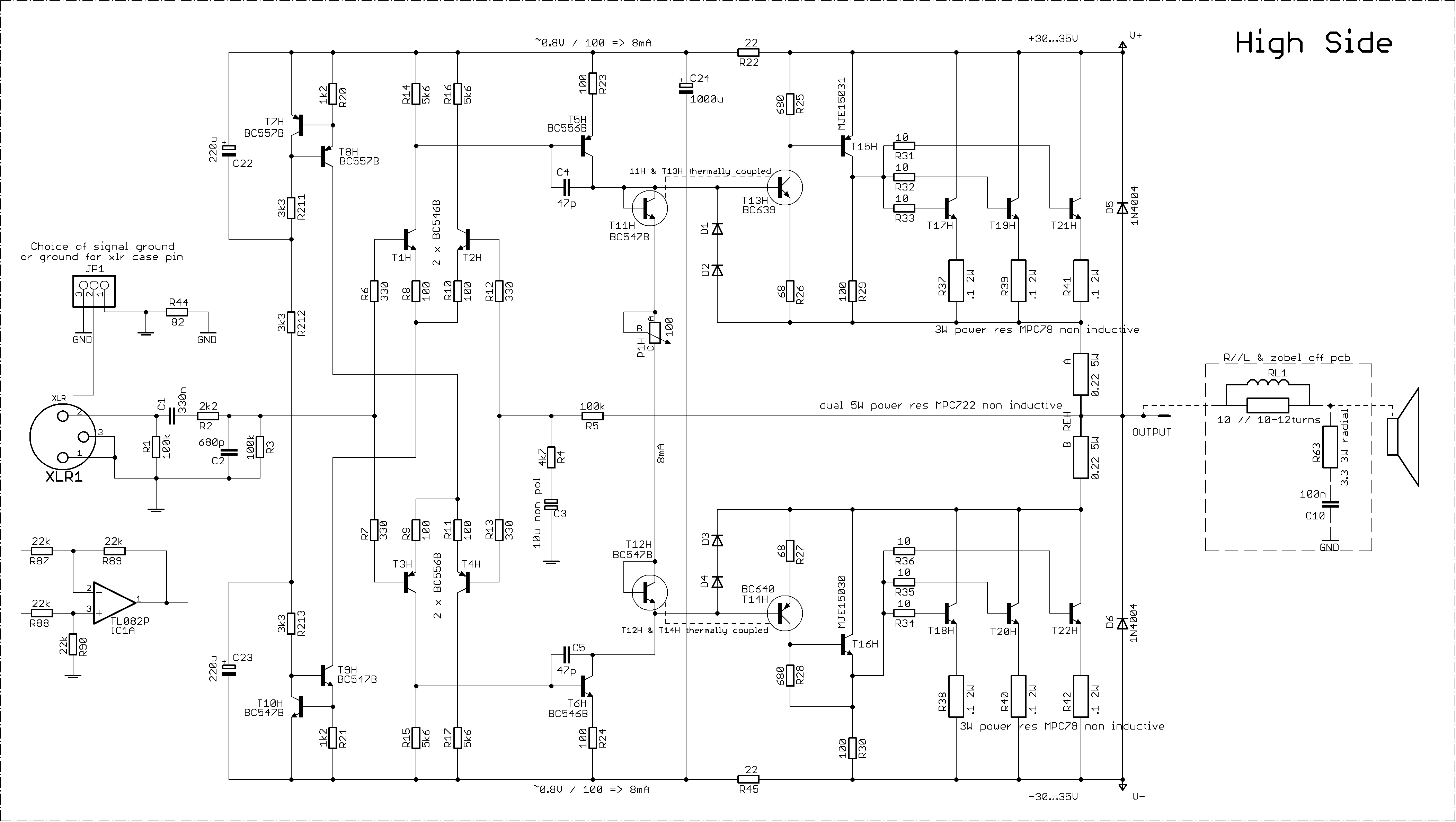

Here are the latest schematics.
Using a dual opamp, with one opamp to make a balanced input on the xlr, and the other should suffice for the bridging inverter.
I am wondering about the balanced input config that I made, because I wanted unity gain and this setup must be inverting, and we can't make a unity gain if non inverting.
The bridging inverter should work fine this way.
I think perhaps if using that balanced input opamp, that we can dispense of using R1, and maybe even simplify a bit this input filter, while making C1 much bigger.
One other thing is we can't use the output directly from the high side to plug into the unity gain inverter. First the input sensitivity of the low side won't match, but we will also overload the opamp's input in the process.

And lastly, I am having trouble figuring out how to properly calculate that dropping resistor for the zener, since the rail will swing like crazy, all the way to far below the zener voltage, so although I inserted a diode to prevent the caps from discharging back into the main rails, there is an issue with that dropping resistor, which must be able to dissipate a lot and the zener would also need to be of higher power to handle this. Maybe I'm going about it the wrong way, so I need someone to clear this up for me.

Yes, the dropping resistor will need to handle a bunch of power. You'll probably want 5 or 10 watters. As drawn, your low side amp cannot amplify. It needs to be an inverting (not noninverting) configuration or it simply doesn't work. Note the loop around your feedback - there is no voltage source. If you use a separate bridging adapter, make both amps inverting. Tie the high side + input to GND, the low side to a voltage divider from the rails. Or make the high side noninverting and the low side inverting.

And I'm not sure how to properly calculate it, I found a resistor value down to about 66ohms, and a bunch of power, plus the zener would need to be very beefy too.
WOW!! I didn't even realize this.
You're quite right, I need to rework that aspect.
I think the best way would be to make the high side inverting, because I think that balanced input opamp, with unity gain, is inverting, and that would re-establish it. Then we need to make the low side non inverting.
The thing, is I'm not certain which is which at the moment. I'm assuming the regular setup is non inverting, so the high side must be that way now, isn't it?

Now that I think of it, the default amp setup must be inverting, because the output signal comes back to one side of the diff amp and the input coming in on the other must be the opposite, so it's a matter of point of view, but as I see it, the signal on the amp's output is inverted compared to its input.
So that means that low side needs changing so it won't invert. But then what to make of the bridging opamp? a follower?
