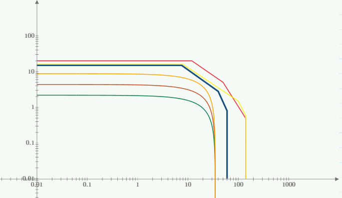

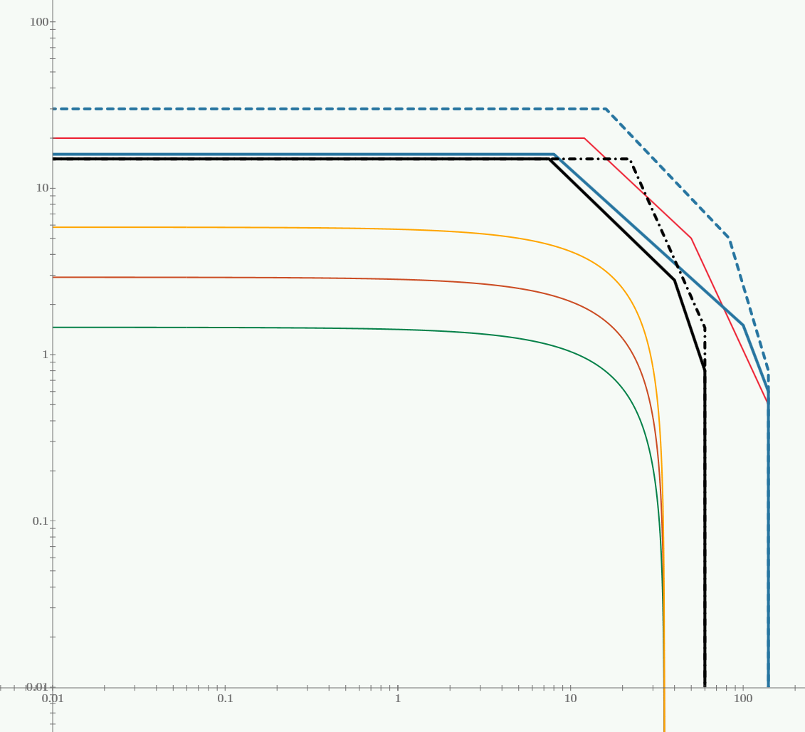

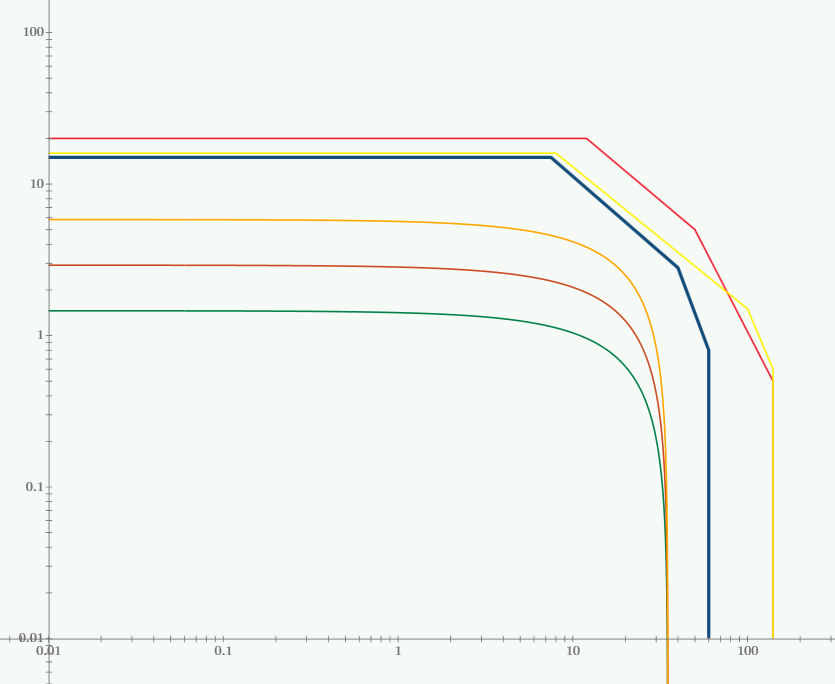

I plotted SOA graphs, with 35V rails in mind, for 2 and 3 pairs and loads of 8, 4 and 2ohms. Just for kicks, I put the SOA for the MJ15003 and 2N3773 for comparison, but I guess anyone could go that route if they wanted to use other trannies besides the venerable 2N3055.
The first graph is for 2 pairs and the second for 3. Only 35V rails and resistive loads of 2, 4 and 8ohms (orange, red and green respectively). The 2N3055 SOA is the thick dark blue one, MJ15003 is the red and the other 2N3773.
If someone wanted to switch to the 2N3773 to increase rails, that looks quite feasible.
To me it looks like we have tons of headroom, although I didn't plot reactive loads. I'd love some help in using the proper equations for plotting the reactive loads...

I wanted to see what it would do with the pulse SOA. I used only the DC SOA curves earlier, so I added the 100ms pulse for the 2N3773 and the 1ms for the 2N3055. I don't have other curves on the MJ15003 datasheet and the 2N3055 datasheet that I have shows the 1ms and shorter pulses but nothing longer than 1ms besides the DC curve.
In pulse conditions, we have even more headroom. That 3055 is a toughy! Too bad its Vce0 is only 60V.
In any case, the area of concern in the SOA is that median one which should be somewhere near the half power usage of the amp. At near or full power, the current can be high and the Vce has dropped. With the 3 pairs, we have 45amps possible in short pulses, or in the output short condition, perhaps enough to handle it without using protections (big heatsink).

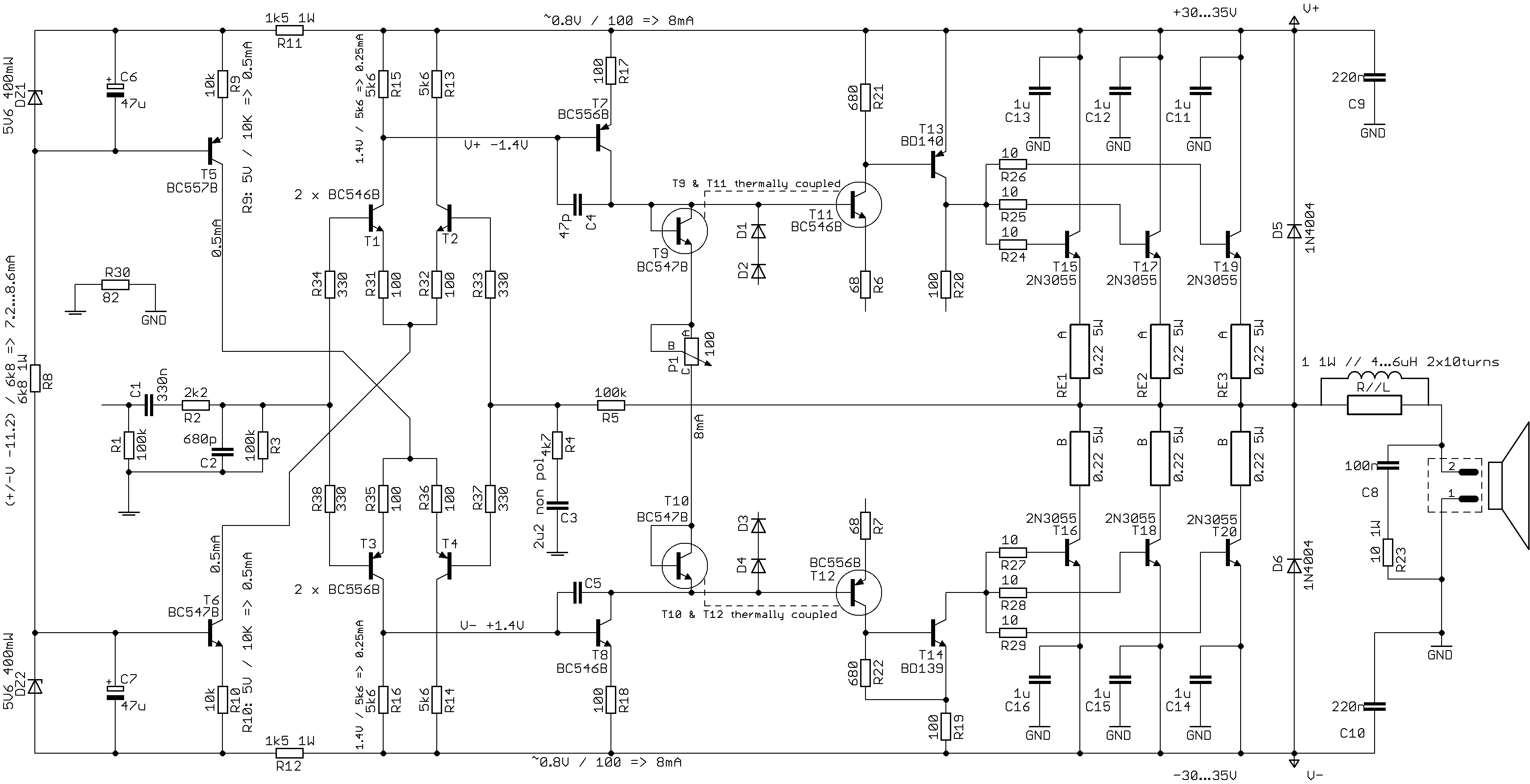

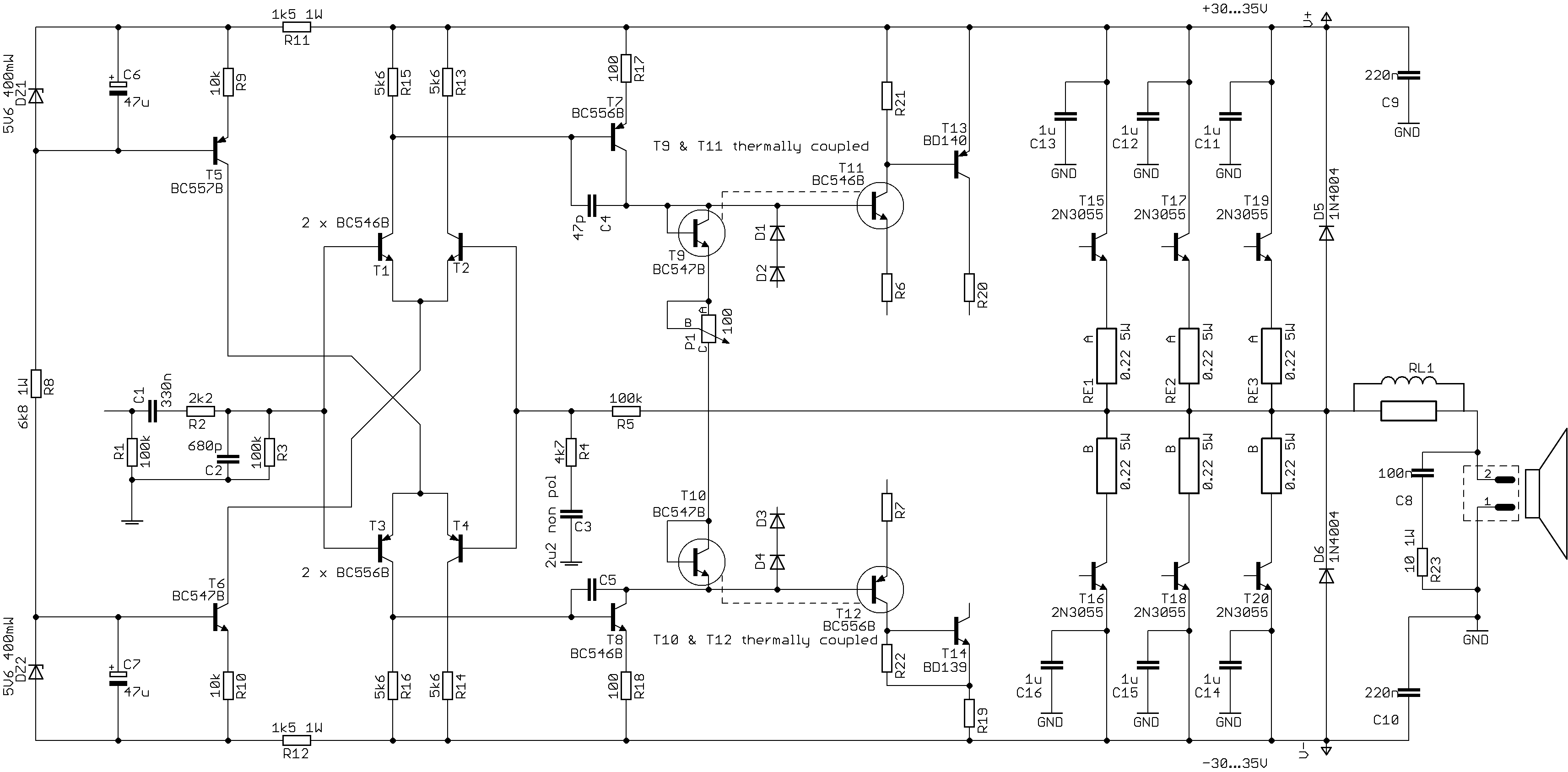

It seems that Elektor amp can be a good start for this little project.
Those who built it mostly are reporting a stable, robust and good sounding amp. Plus I like that symetry, which would be nice to preserve as much as possible.
I started drawing up the schematic and made a few changes: adding decoupling caps on each output power transistor, moving the zobel to the speaker side of the output R//L, adding diodes on the output, making the 3 parallel caps on the grounded side of the feedback in only one non polarized cap (2.2uF instead of the 3 x 820nF).
I looked at the R11 and R12 and thought I should verify for wattage, and sure enough, an ordinary 1/4 or 1/2watt resistor would be heating too much, so I put 1W resistors there.
I think it might not be luxury to add decoupling caps as well on the other sides of R11 & R12 on the current sources, that is in addition to those 47u filters on the zeners.
There is a fair number of transistors, however most of them are TO92 cases, and they're cheap, so that shouldn't be a cause for concern on cost, and the power transistors can all be fitted on one big heatsink, TO3s and TO126s.
Elektor mentions thermally coupling T9 to T11 and T10 to T12, which I indicated on the sch. If this works, it's much easier than trying to thermally couple 2 TO92s to the main heatsink.
Now I left out the connections between the transistors in the 3 last stages, since I provided for 3 pairs of 3055s, those need to be connected in the right way and if possible let's try to keep it as symetric as possible.
So can anyone pitch in and help finish those connections?
Any comments on what's been done so far?
Then we'll have to look at making this a "high side" of a grounded bridge, by making a "low side" properly. Which may be a bit different from the high side.
It will be tricky to make a proper pcb layout with 6 pairs of TO3s on one heatsink, and try to avoid any wiring. I think in view of the potential extra complexity in the grounded bridge setup, a diy module should be as bullet proof as possible and avoid as much wiring as possible.
I'd like to arrive at something that can be assembled just like any diy kit, and that it would work the first time without any difficulty. A bit of a tall order!
Making a double-sided plated through pcb that can be made by a board house, although perhaps a little more pricy, can make for a solid base that can be easily built fast even by a diy beginner.
Schematic attached, please help...
Here is a sch update. I documented some things, completed it a little more and also made a few changes that I think are improvements. Go ahead with comments on that.
Having made those changes, it changes the gain on the input stage and I think some calculations are in order to make sure the main feedback is correct.
One other thing I'm wondering about, is that input filter's cut off frequency and if it really needs to be that complicated. It seems to be to have been made for a steeper roll off. Does it really need this? Couldn't we just simplify this with a single cap and res??
The input filter looks fine...
Feedback capacitor is a bit low at 2.2uF. It cuts into the low frequency response.
I would drop the zeners+caps in the input ccs in favor of just leds. Save a bit of space and works just as well.
+1. You do not want to waste a 5V drop in the CCS if you end up using this amp in a grounded bridge. I would simply use the 2-transistor CCS which works down to 2Vbe. Remember, the rails will be moving, and the diff pairs need to common-mode all the way to the rail or as close to it as possible. For this reason, the traditional diff pair input is not preferred. Not saying it won't work, but you will pay a couple volts penalty in output swing that you don't absolutely have to. You would get better results if the input stage runs off its own stabilized supply that is referenced to the artificial ground produced by the low side amp. The QSC circuit does this for its op amps.
Elektor's initial value was 3 caps of 820n each, so using 2.2uF did make the value a little lower, but not that much. I tried calculating the frequency using R*C=1/(2 Pi fc) and found a -3db around 15Hz. Am I using the right formula? Using R4 for R and C3 for C.
If we go to 10uF, I calculate this at a bit less than 3.5Hz, if I'm calculating it right. Would that work better?
That's a little superfluous, but if space becomes an issue during layout, that could be considered. Although it may remove a zener and cap, it still requires a resistor to set the current and that current would be a little higher than with the zeners I think, which may even require a bigger resistor than the current 1W.
No comments on using those base and emitter resistors on the diff amp?
What about those base resistors on all the 3055s??
The BD139/140 may have a tougher job driving so many 3055s, especially when on a 2ohms load.
