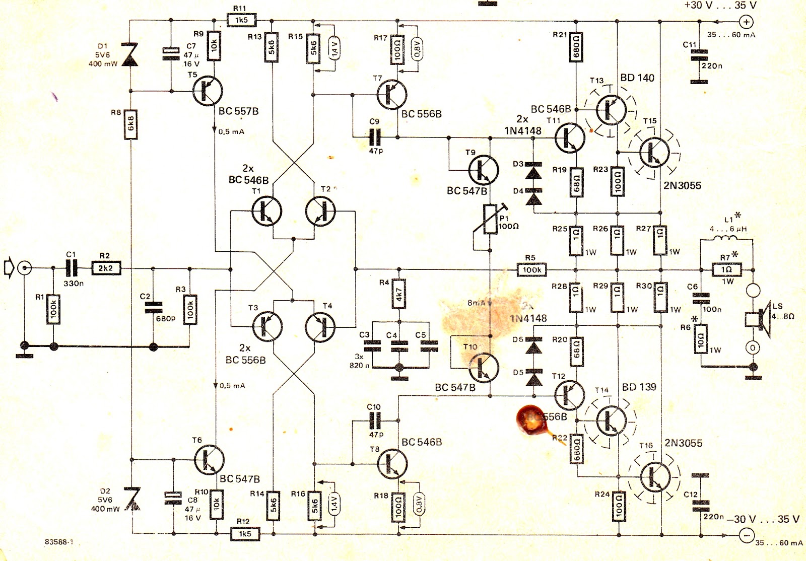

I don't think so. A 2N3055 is a 60V part, a Phase 400 runs on 170V p-p.
Try MJ410
You could use them in this circuit just swap the tip36's with the 2n3055's and swap r14, r,18 (both oops), r16, r19,19 to keep them on the emitters and you'd have fairly standard Sziklai pair amp.
Probably get you 100 watts or so.
You may want to add a pot of about 30k at r5 to gain some offset control, and a 220n cap between q9,q10 bases. The mjf15031 are a bit dated but it's what I had, any similar device could be used.

I noticed some others who went the 3 4 route put a diode in the pre-driver stage. Would this help get rid of the crossover distortion in this design? Like maybe between r13 and q12 base or should it go between the FB and r13? I am not fully versed on the triple quad so I'm not sure how to improve this other than shooting in the dark.
hello everybody,I found the attached cct somewhere in internet. looks like an Elektor baby. anybody have PCB layout for this?
