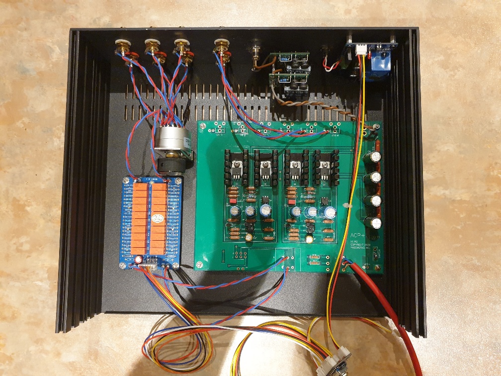

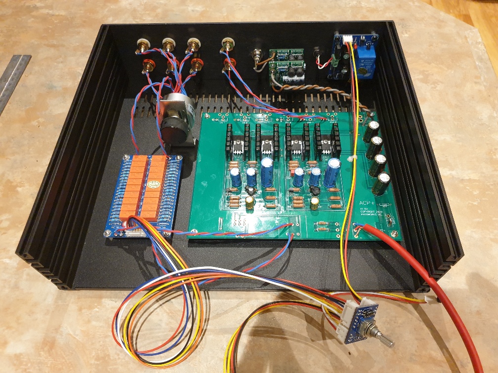

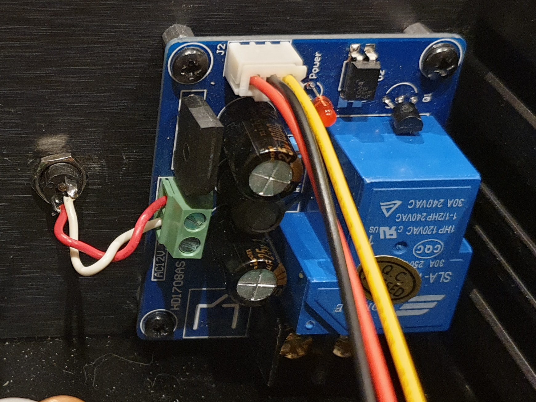

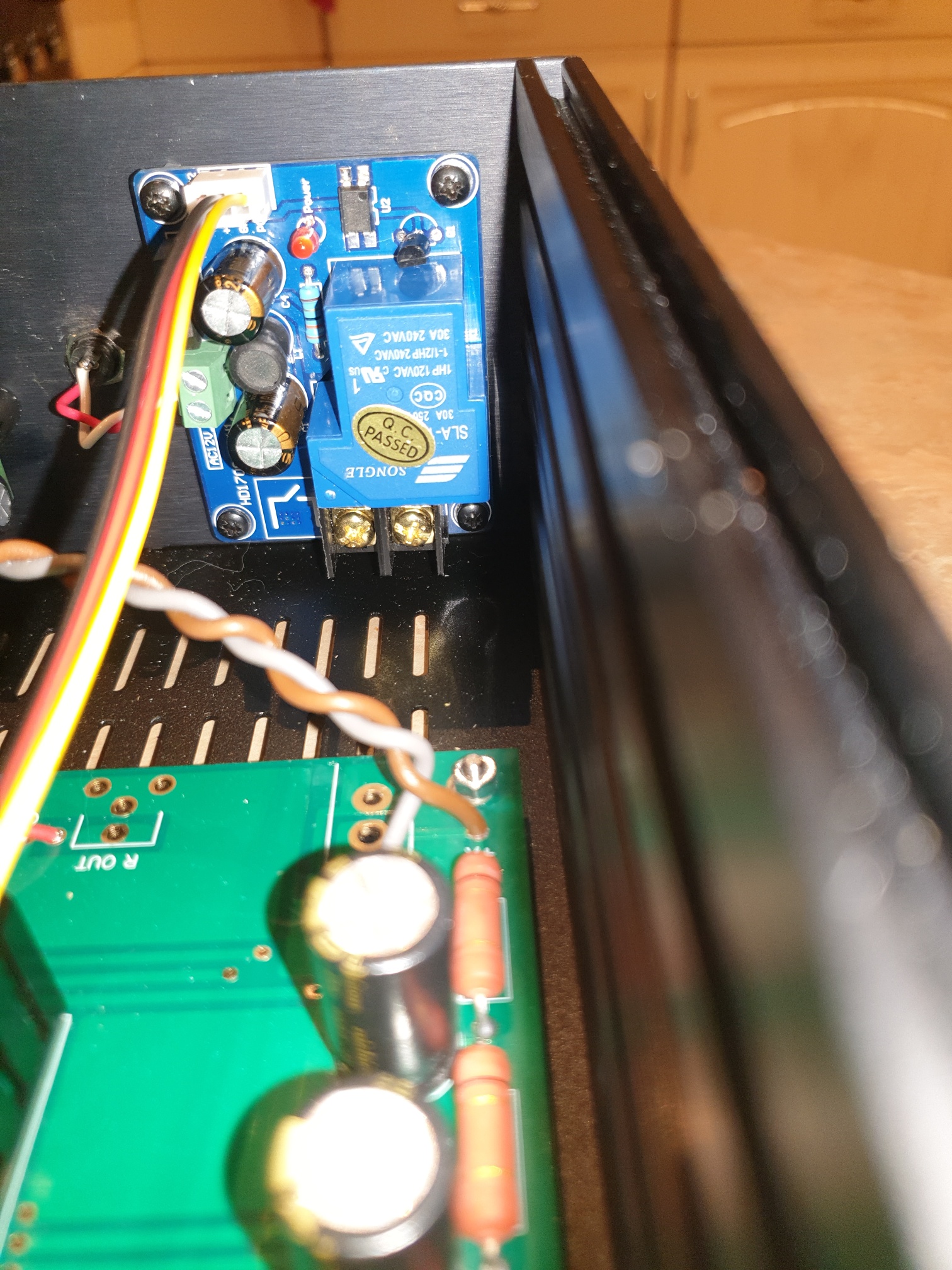

My ACP+ is mostly completed now. I’ve used a relay based potentiometer and the amount of detail is exceptional. I checked everything worked before putting it in the case and it was absolutely silent with a Meanwell SMPS. Now I have it in the case, I have noticed a faint mum that increases as the volume goes up.
I have tracked it down to the ‘digital’ earth of the relay control section of the pre-amp. It reads 11.9V ac and approximately 9μA ac. I can ‘cure’ the hum by connecting the ‘digital’ earth directly to the case but I prefer prevention rather than cure. Does have anyone have experience of a similar problem?
The only AC in the case is the red and white wires on the right hand rear corner from a separate 12Vac wall wart which is there to supply the volume control section. After that it is rectified to 5Vdc.
Pictures will follow shortly.

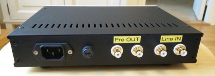

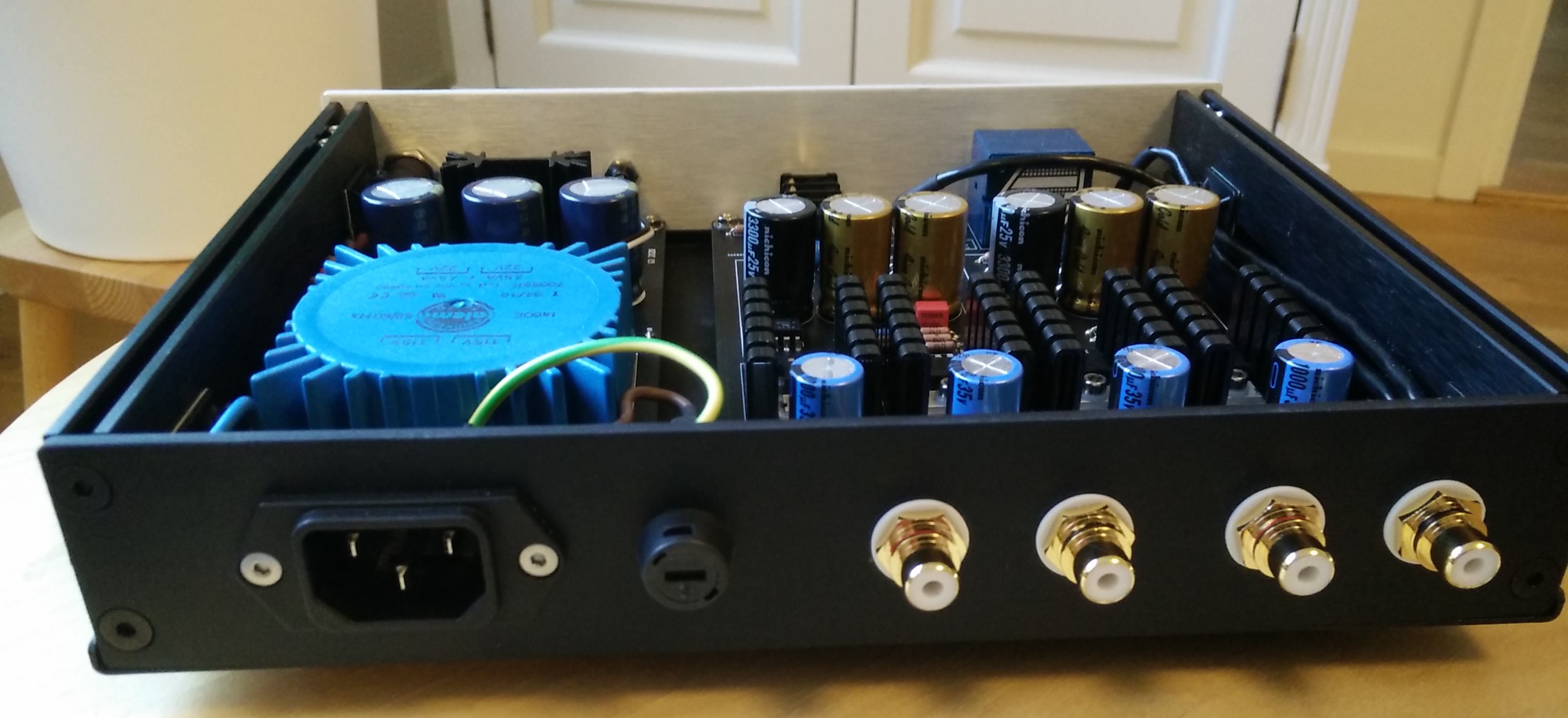

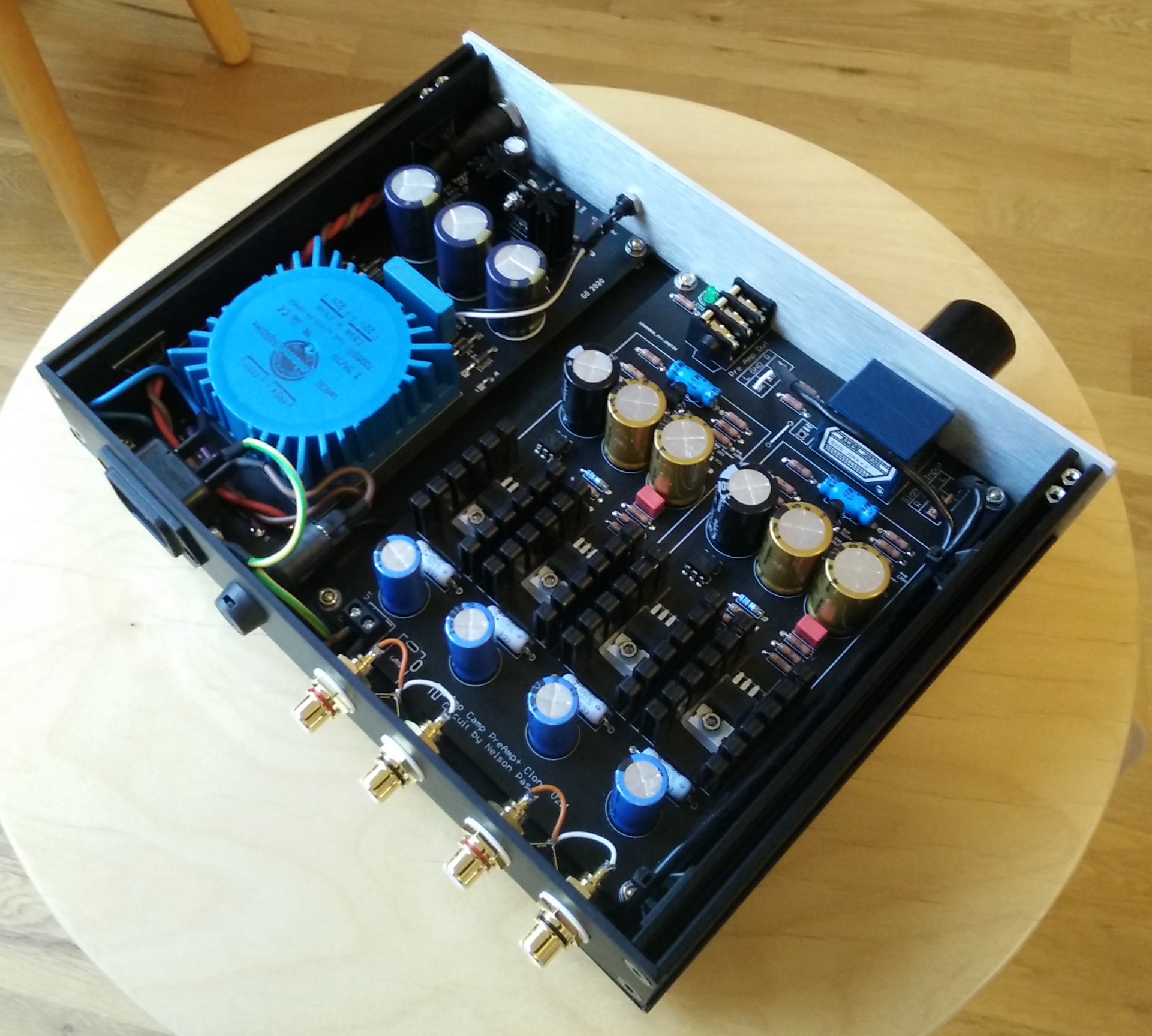

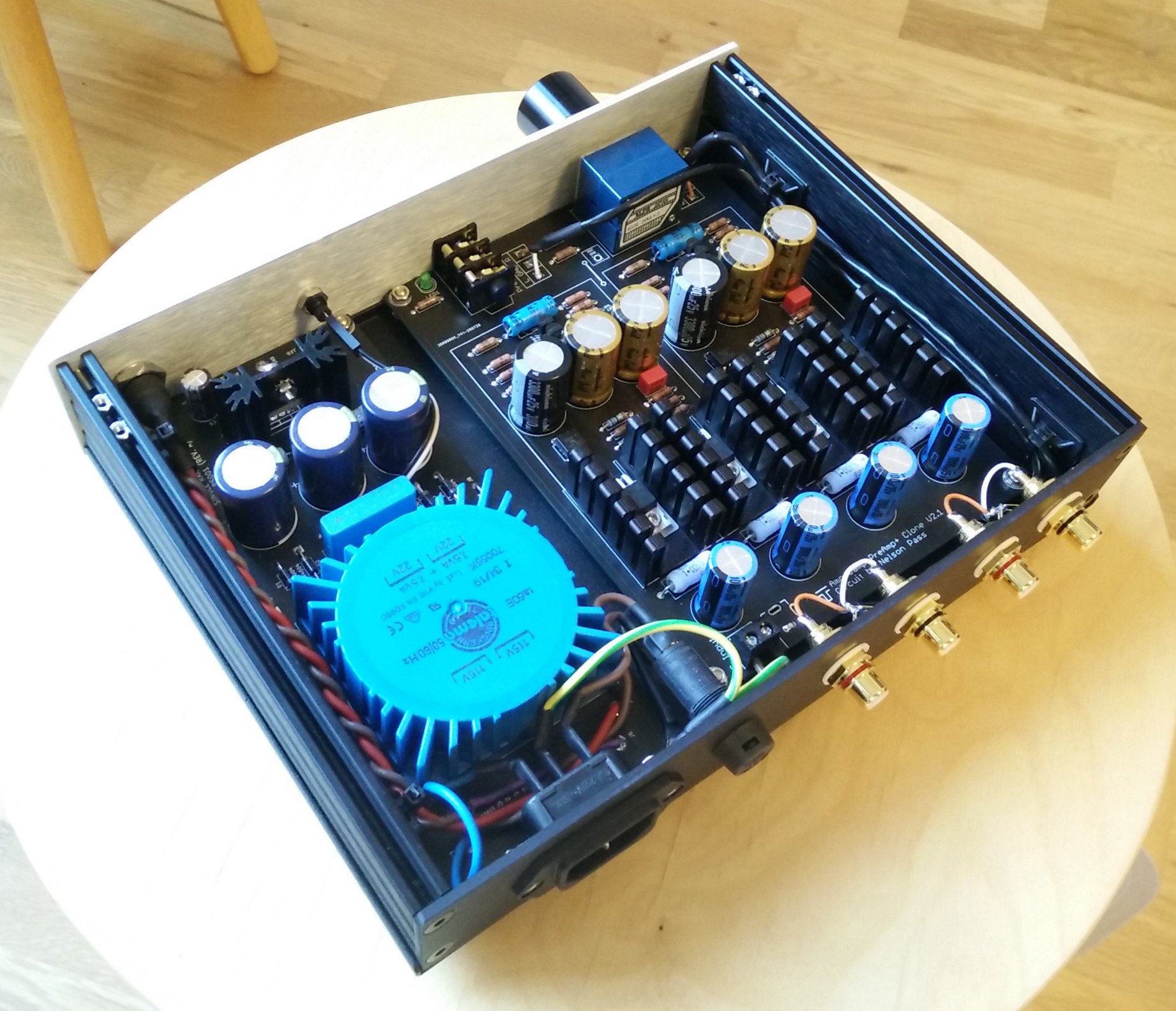

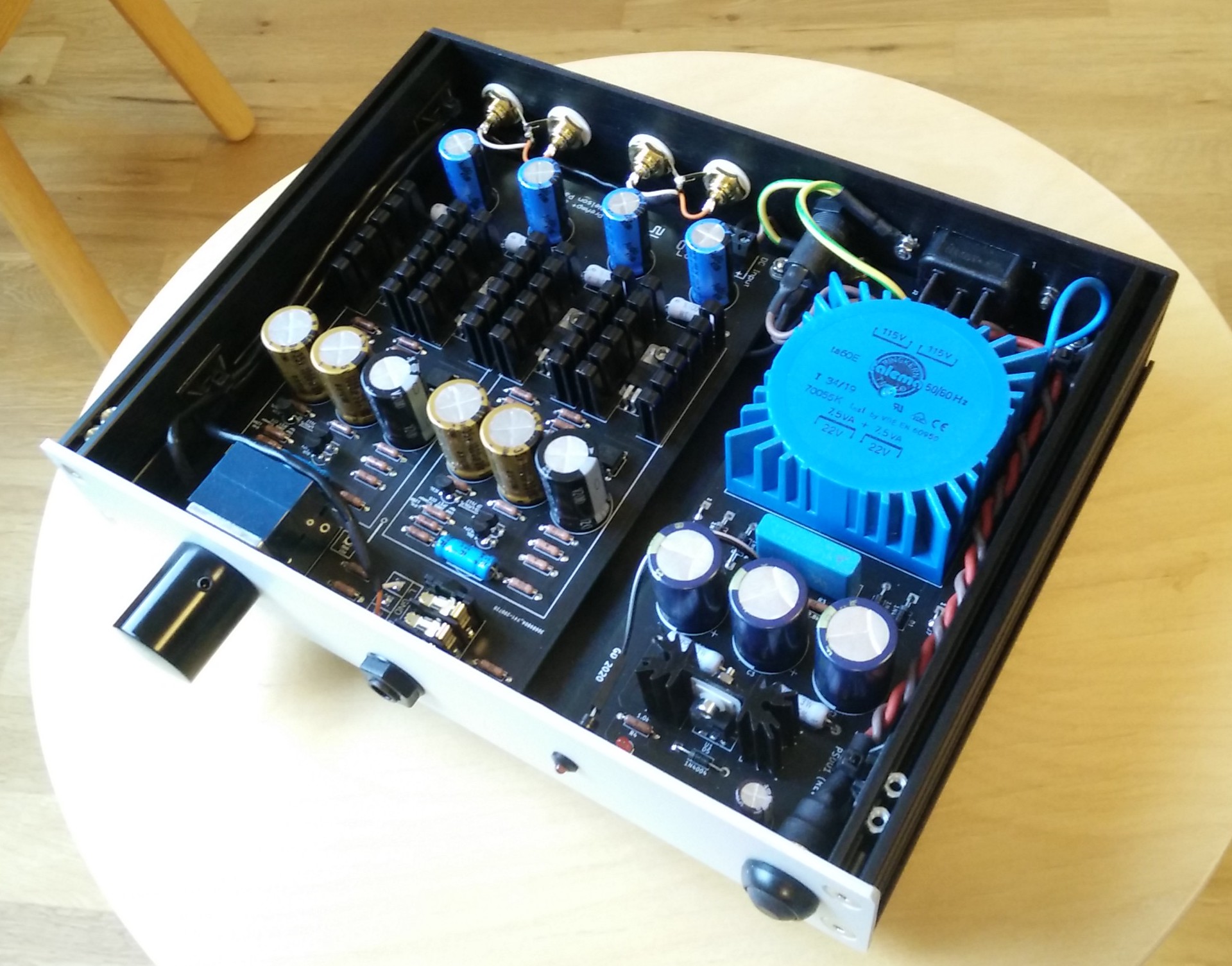

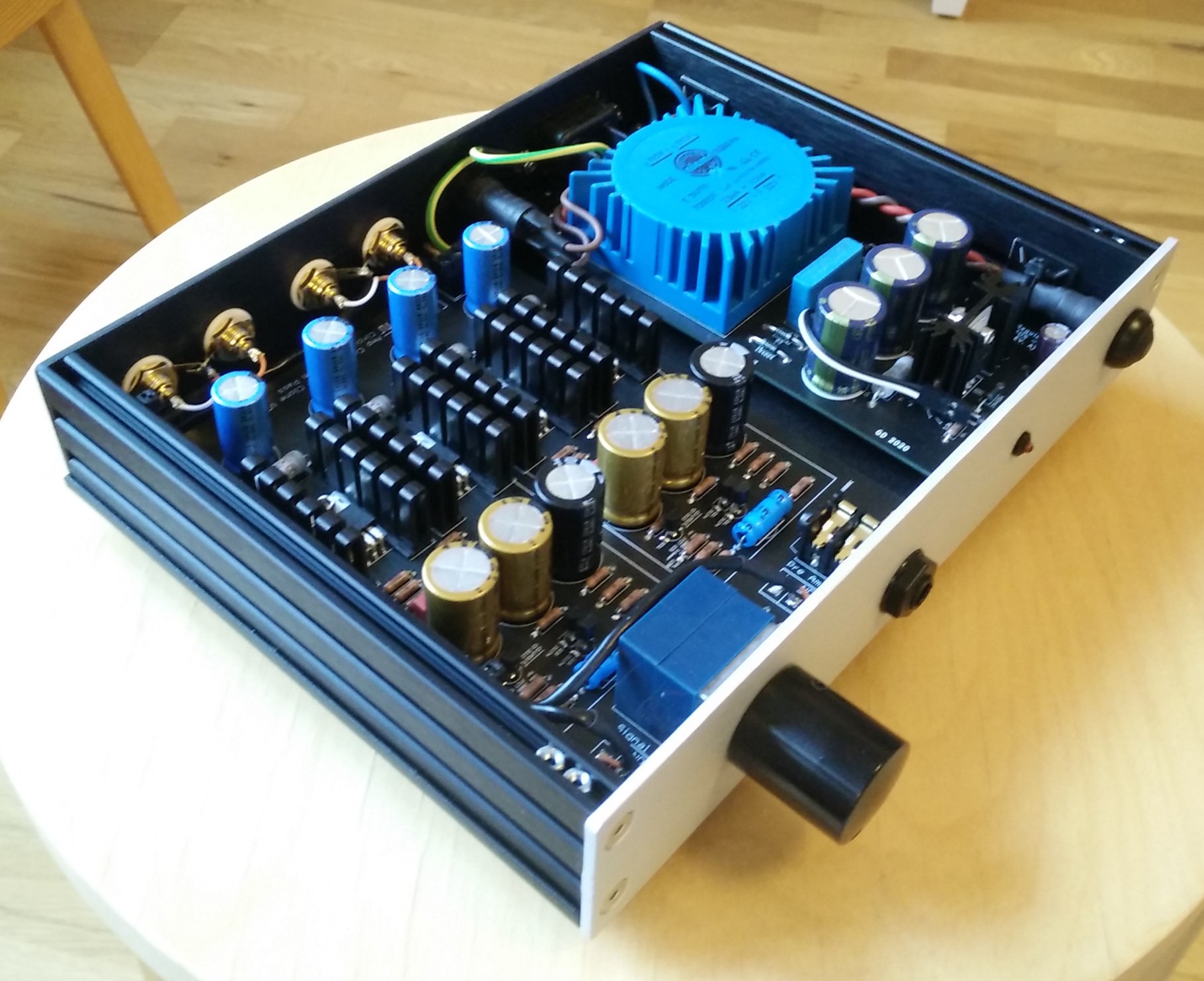

I guess I need to post few pictures to thank Nelson and everyone here to let me start over (after ~10 years missing from these pages) with such a nice project.
Bad pictures I know... I invested in this project rather than in a new phone with a better camera. 🙂
The PCB design is by withmatt (post #341) and I got it from iamwhoiam (post #397). I used axial capacitor in C1 and the LM317L as current source as for withmatt suggestion since I couldn't find a match with the J113/resistors I got. The PCB has space for a trimmer in the R4 position and maybe I will play with it in the future.
PCB for PSU is by Gaz2613 but it is the older version of the one you see in post #949.
A big thanks everyone!

Peppe and SuppersReady -
Beautiful builds. Love the personally chosen tweaks and mods to each. Congratulations!
Thanks ItsAllInMyHead.
Pepper, nice work with yours. Very impressed with how tidy it is.

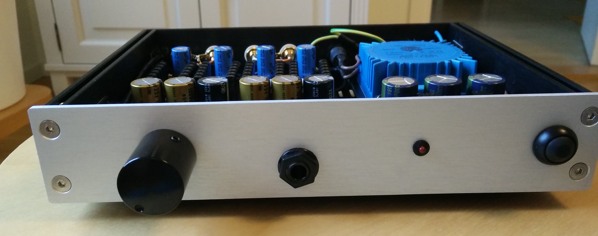

The interconnections for the relay controls will be trimmed to fit once the case is fully finished. The selector switch will get an extension rod too. The extra benefit of this potentiometer kit is that volume is also remote controlled. If I can solve the hum issue I'll be much happier.
Pictures as promised.

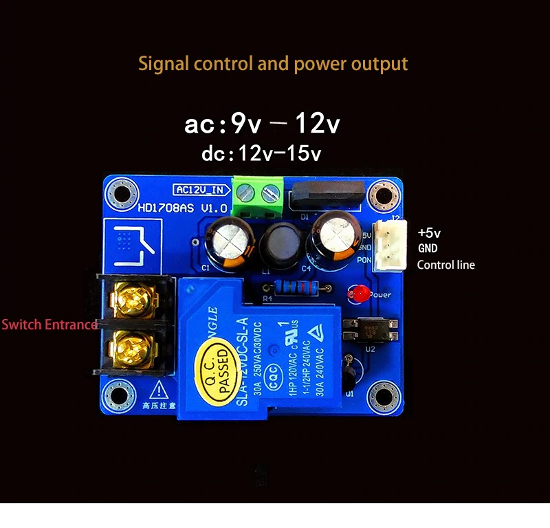

Is your relay PSU using a virtual ground or some other arrangement to produce a bipolar supply? If so, it may be an issue if the barrel connector jack is not isolated from the chassis. Or at least this has been something I’ve dealt with in the past.
Agreed. An easy check would be to remove the volume control power input connector from the chassis and just let it dangle outside. Power up everything and see if hum is gone.

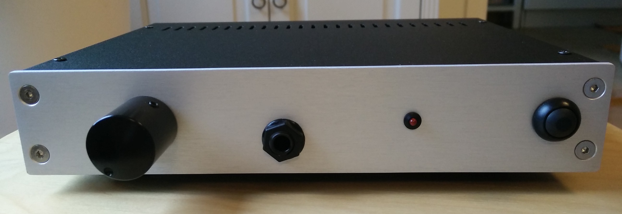

Thanks for the nice words. 😱
This was a "dense" build since I want to easily carry it around for headphone use. If there will be a new build I shall go with more features as in SuppersReady example since I found out how good it is as pre. 😱
Cisco and codyt,
I've used a plastic bodied connector for ac line but kept a metal bodied one for the dc line.

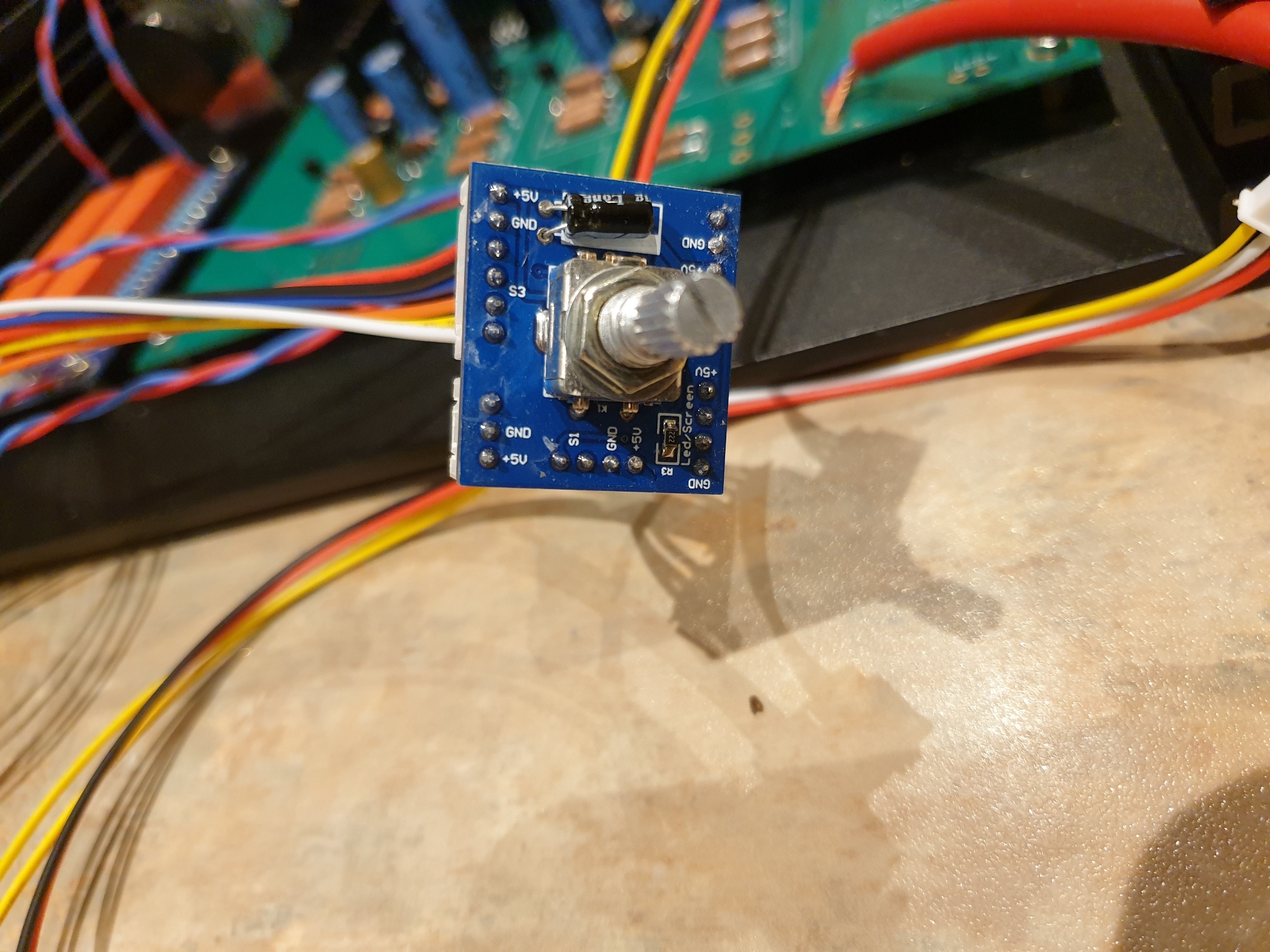

Hmm... On that potentiometer relay board, do they have the relay ground tied to the audio ground? The relay coil is isolated from the relay contacts, in the relay itself. It's the next thing to look at.
... Now I have it in the case, I have noticed a faint mum that increases as the volume goes up.
I found this pic of that input module. Could feed it with 12 VDC, that would quiet the ground. You might have to experiment with the polarity depending on how they connected grounds.
