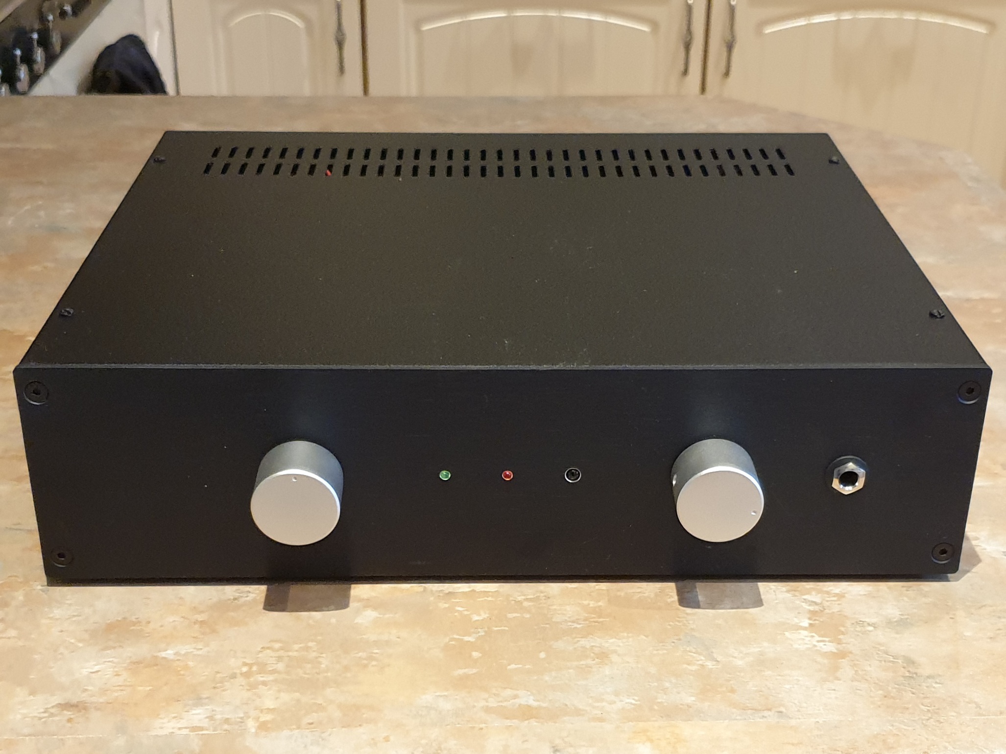

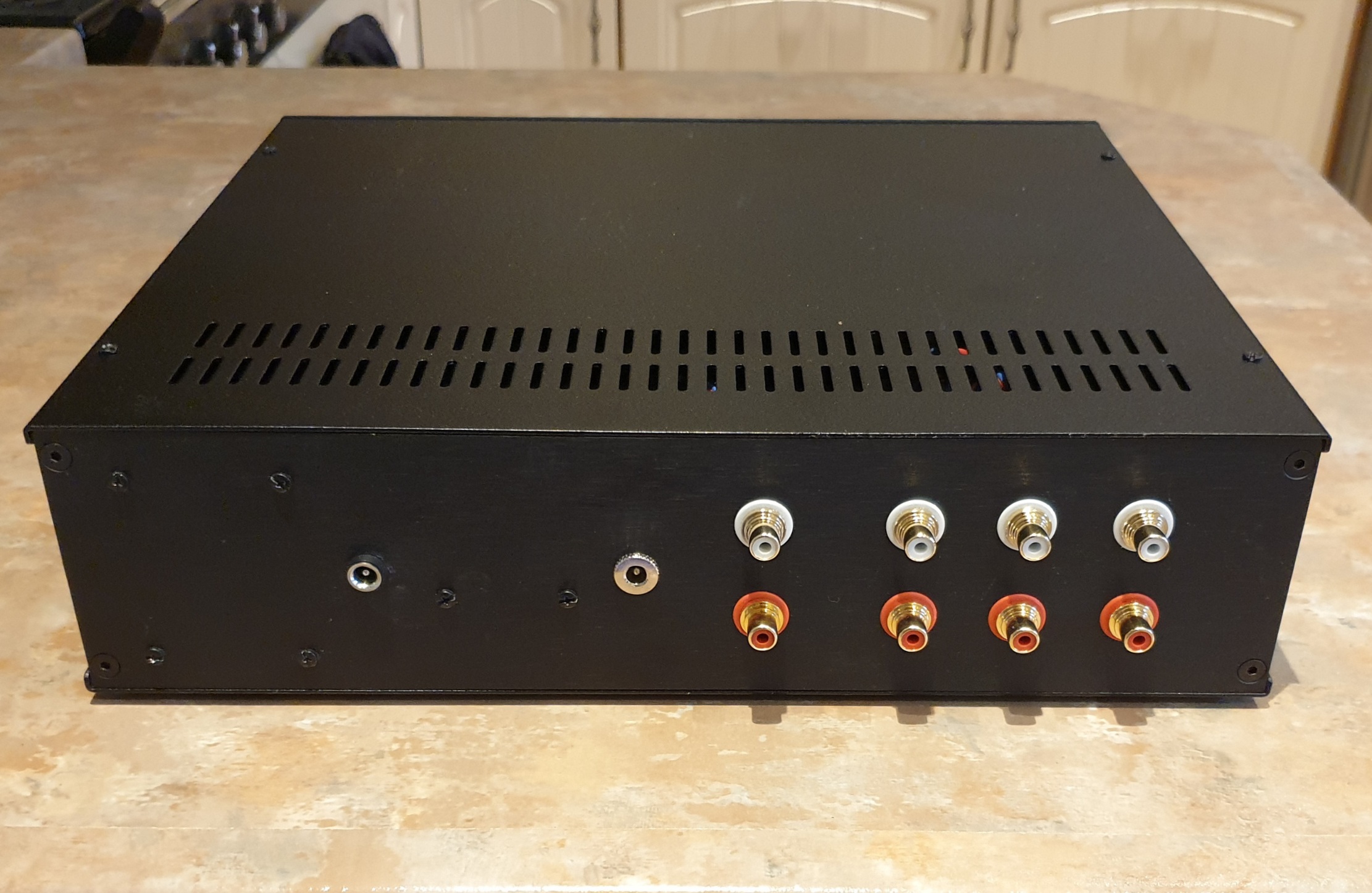

Another completed ACP+.
I posted some internal photos a page or two back. I've used an eBay sourced relay based potentiometer. At just over £50 it was worth taking a chance. It even has remote volume control. The chassis is a Hifi2000 unit. I haven't got the gear for milling recesses in the 10mm front panels, so I settled for the 3mm front instead. Not quite as classy but not too bad.
I know I'm preaching to the choir here but the amount of detail from this device is incredible. I've been using it as a headphone amp mostly but tried it in the office setup earlier today. In both applications I can turn the volume up without any sense of stress or distortion in the sound.
