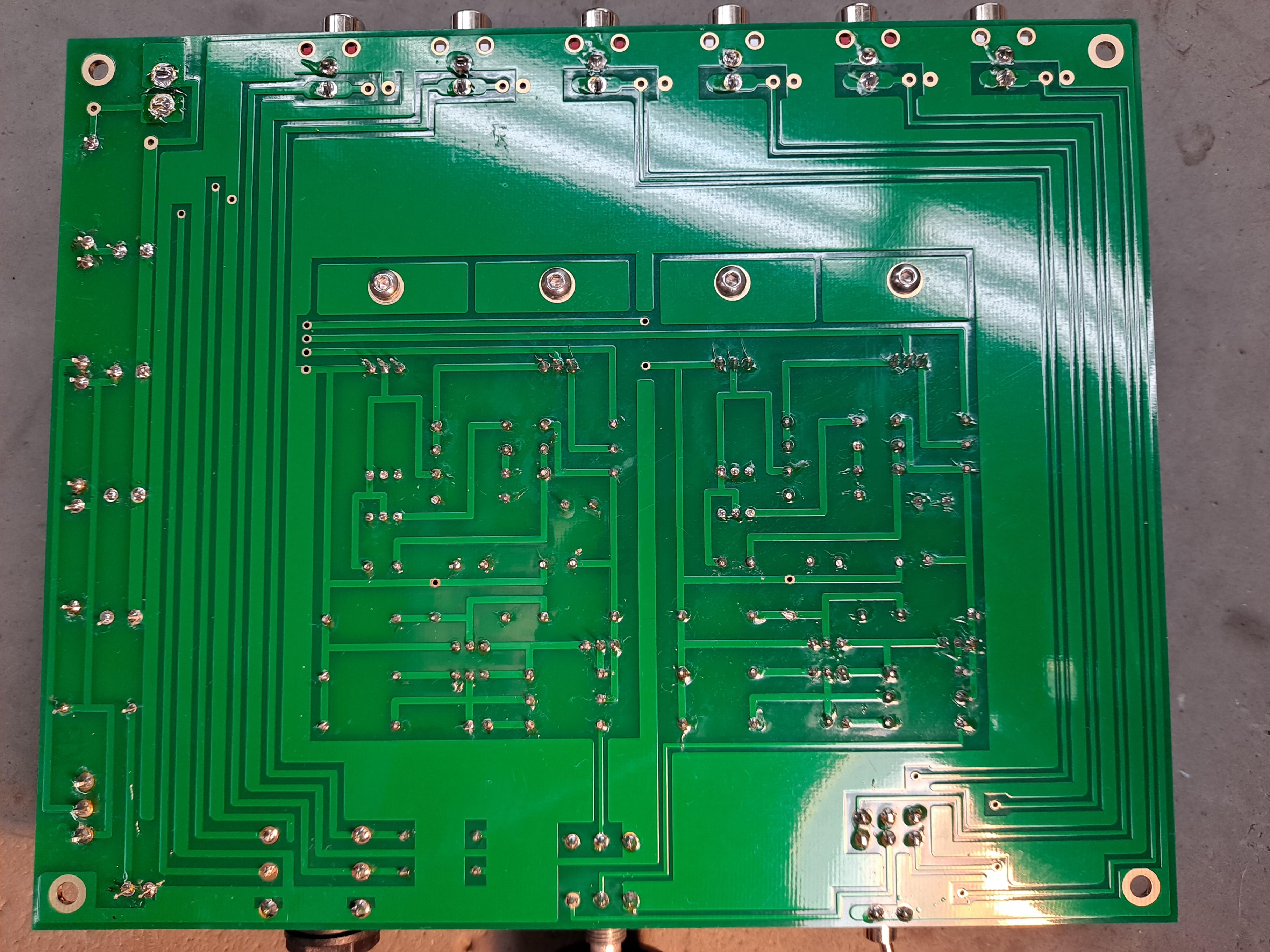

Could you post a picture of the bottom side of the board. I am wondering if there are bad solder joints.
When soldering the components in place, especially the Mosfets (Q5, Q6) and JFETs (Q1, Q2) did you apply heat for a long period of time? I am wondering whether they might have been damaged during soldering.

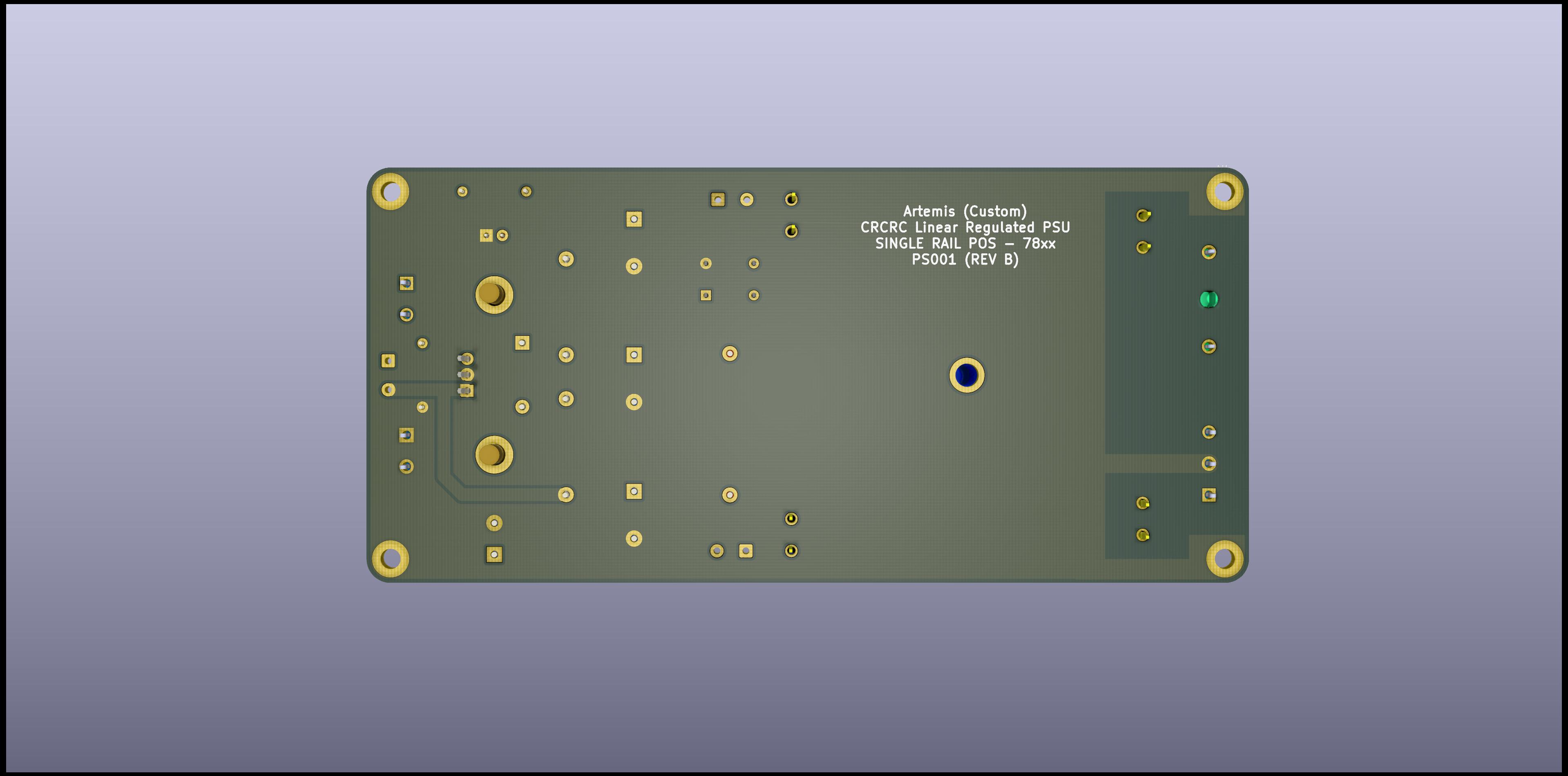

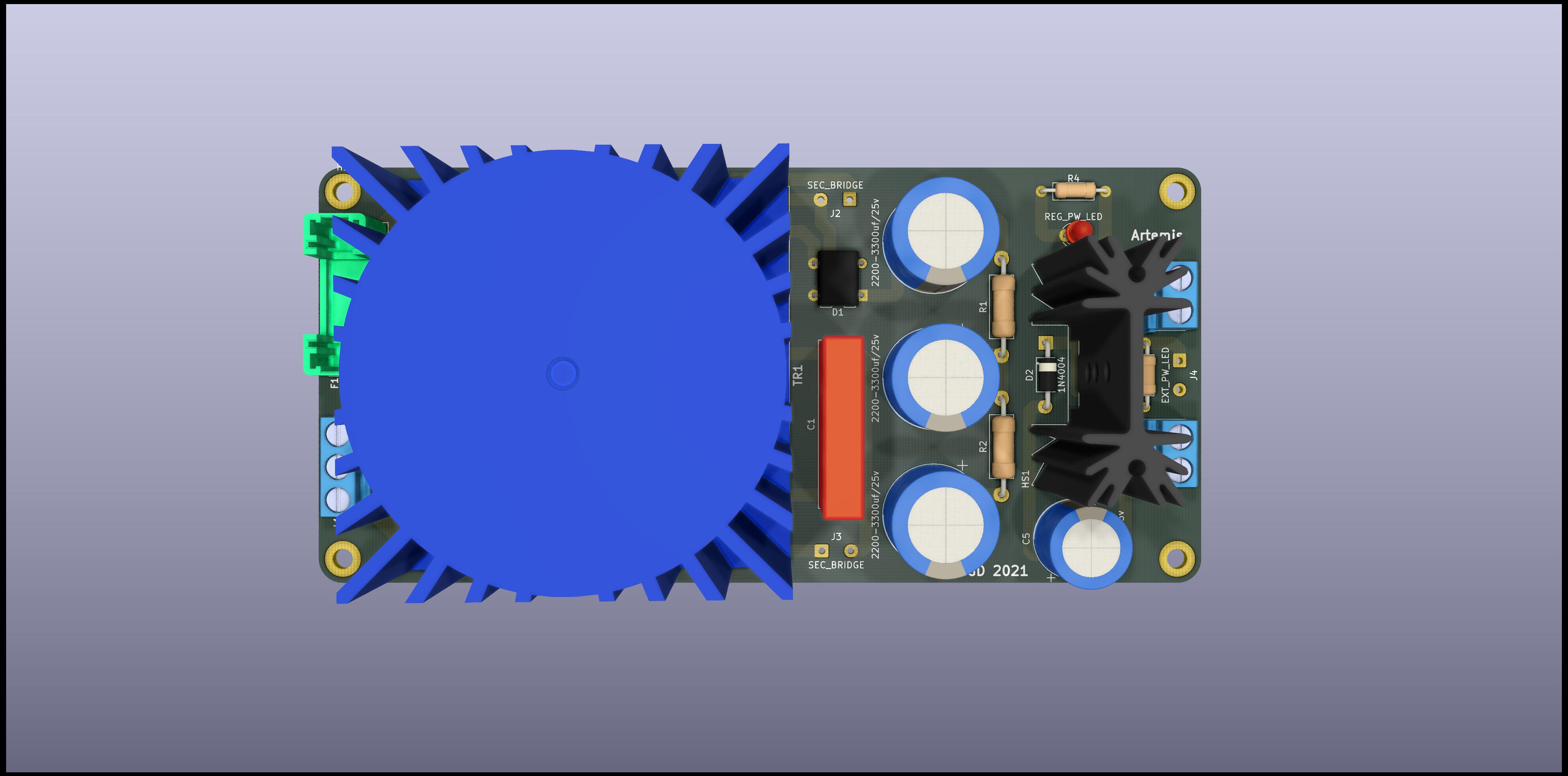

I have been reading through the thread and noticed some people were looking to use linear power supplies to power their ACP+ and so I thought it would be a good time to share an updated design of my original single rail PSU which is called Artemis.
The pics are of a custom version that I was asked to design which is also the basis for my REV B boards. This one is 220V only but the normal version will feature voltage jumpers just like on the Helios Bi-Polar design.
Dimensions are 140mm x 66mm.
Let me know what you think.

Ok, I've attached photos of the bottom of the board. I want to say that I did not dwell for long with the heat but...
I'll order Q5, Q6, and JFETs Q1, Q2, and be VERY careful installing them!

Don't replace everything at once. It may be that only the Mosfets are an issue. Issues in one part of the circuit can often adversely affect other parts. The Mosfet section is definitely malfunctioning so address that first. The JFETs are pricey. Don't mess with them yet. Replace the IRF610 first.
What I usually do when I order parts for a project is that I order extras of the transistors and integrated circuits such as the 4N35 optocoupler, especially if they are not expensive, as the IRF610 and 4N35 are both less than $1 apiece. The same goes for the J113. That way I have spares available and don't have to pay for shipping on a small order. The LSJ74 though is a limited supply item so it is expensive. Or you can order them and keep them for a future project if they are not needed for this one.
Looking at the back of your board, and it is hard to tell from the photograph, there are a few areas that look like there are trails of excess solder that may have bridge some traces. You should have a close look at all of the solder joints and check for excess solder bridging to traces. Also doesn't hurt to clean the soldered area with alcohol to remove flux.

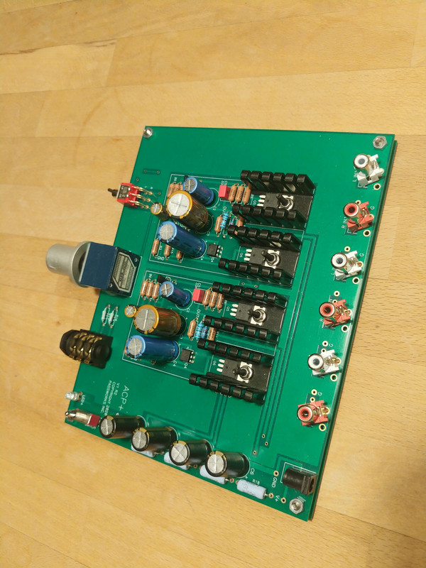

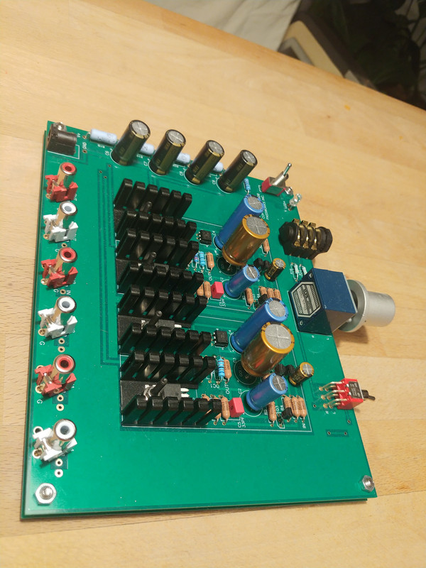

Hi people,
I have once asked what I could do about the ACP+ being harsh in the upper frequencies and was asked if I may just listen too loudly and not be used to the flat frequency response all the way up. Now even though this might be true, I have played around with my ACA mono blocks a little and found that if I connect them directly to my Dragonfly, this harshness is NOT present. So now I am asking myself and especially you again: how can this be? So now for me it's clear, that the ACP+ is emphasizing higher frequencies somehow. Could I have made a mistake assembling it? I have all my tools here now and am happy to perform any measurings as long as anyone can guide me as I am a newbie to the DIY biz. Thanks to y'all and have a great day. Stay safe.
Hi people,
Could you provide a larger image of your build? I went back and found the one you shared earlier, but it was way to small to do any zooming.
I don’t see any big issues on the board, though I’m no expert. Seems you went with an alternative way of mounting the RCA jacks. Might be worth verifying they’re hooked up correctly. For instance, a few of the ‘G’s’ (ground) in the silkscreen were inadvertently bumped down when the artwork was sent off (or at least I assume that was the case).

I notice that you seem to be using Nichicon “Gold” caps for both input and output coupling duties. I did the same, and had the same issue. Swapping the input cap for an Elna Silmic II solved this issue for me, though it’s a tad too smooth for my liking now. I’ll have to see how the sound changes as the cap burns in. Not that I believed in capacitors changing the sound or capacitor burning in until now, but I guess I was wrong.
