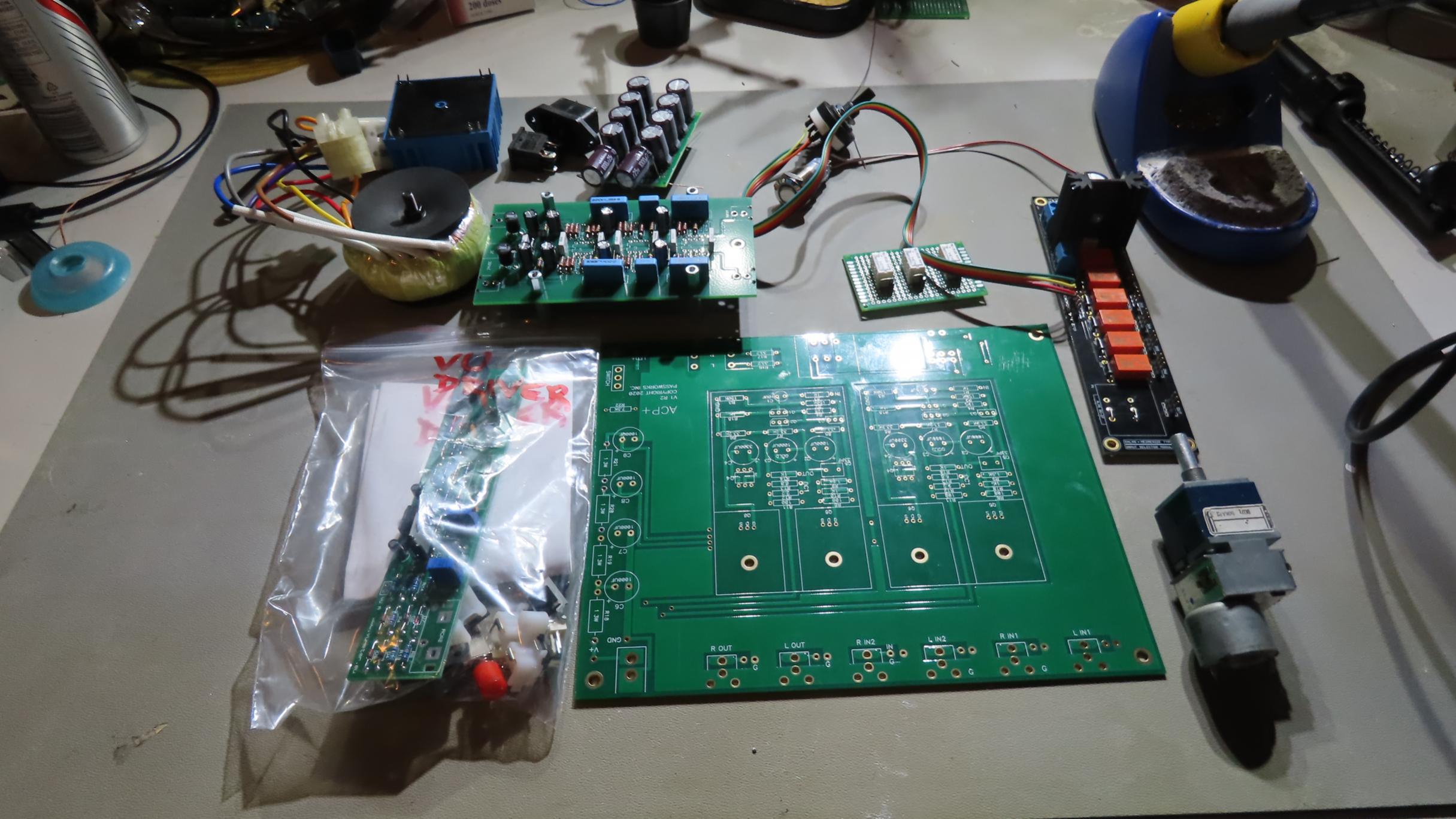

Sounds cool...what are you using for remote volume? Is it remote input selection as well? Looks like maybe not, I think I see a manual rotary switch there.
What phono stage?
In the future I'd like to do a maxed-out full-featured preamp with remote-controlled volume and input selection, tone controls, and possibly phono...not sure about phone though, I may want to keep that in a separate chassis. I'll need to find a turnkey remote kit though because that is way over my head.
Oooo and is that one bag labelled "VU Driver"? Does that come as a kit too? Cause that's also something I'd love to implement in my dream DIY pre but don't have the knowledge to design on my own.
What phono stage?

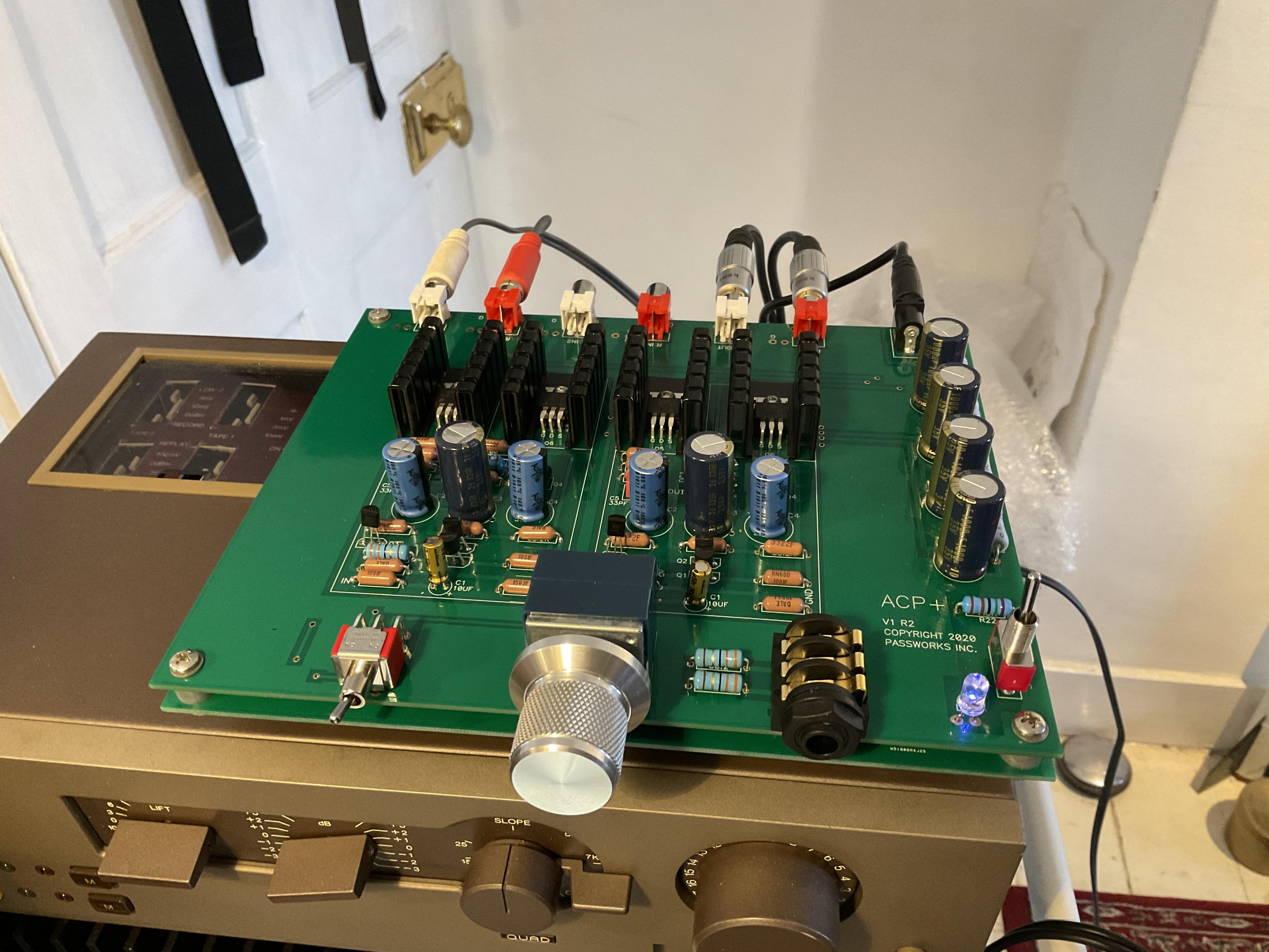

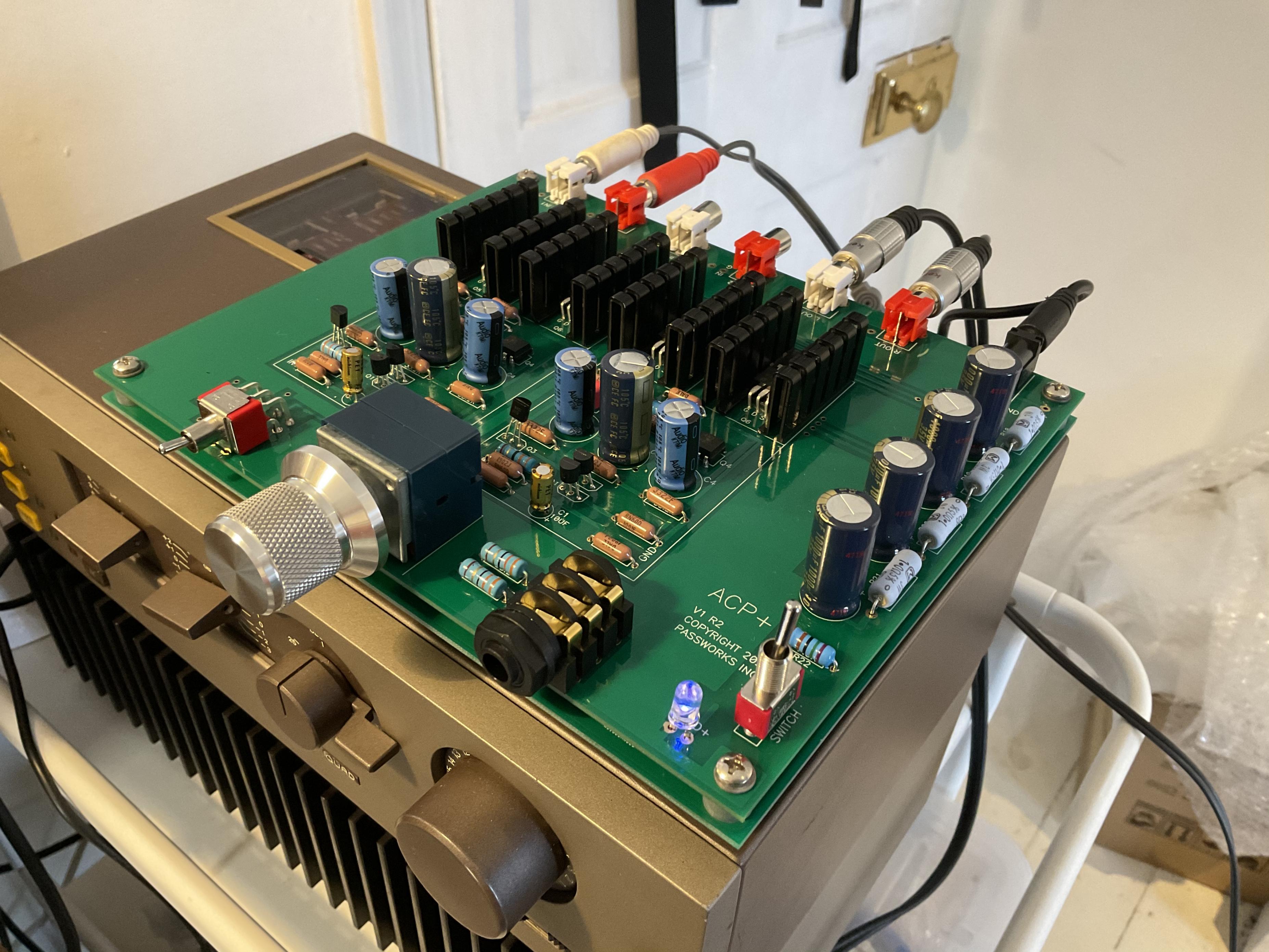

Finished my ACP build
I built the ACA way back in 2012 as one of the first projects I ever did (recuperating from serious illness) and after some time away from diy saw Nelson had created a matching preamp. I’d recently dug out the ACA from its hibernation to perform as office/spare bedroom duties as I’ve spent the better part of the last year working in there. The build went well once I’d got the parts together...pretty straightforward. The trickiest bit as I only had a couple of J113’s was playing around with r4 values in circuit to get 10ma per channel. After some experimentation with a dvm and breaking out the calculator I ended up with 33r getting me just a shade over 10ma. All check out voltages were bang on straight off the bat which was a relief. It’s sounding very promising from the get go but I haven’t spent long enough listening (like half an hour) to properly evaluate. The naked form factor matches my ACA which for me was part of the appeal. I couldn’t find any nichicon gold in the right values so went for Panasonic’s which I’m sure are just as good or better. My favourite bit is the knurled volume knob which was like a fiver from China (ebay). The only thing to do is pick up a better power supply as I just used a cheapo I had to hand. Anyway that’s it another triumph of perseverence over knowledge :0). Thanks to Nelson for the design and the forum for the boards and fets. PS no idea why the one photo is rotated on upload.
Well done! I wouldn’t feel obligated to go all out on a power supply. There’s a good amount of filtering on the board to accommodate simple wall wart switchers.

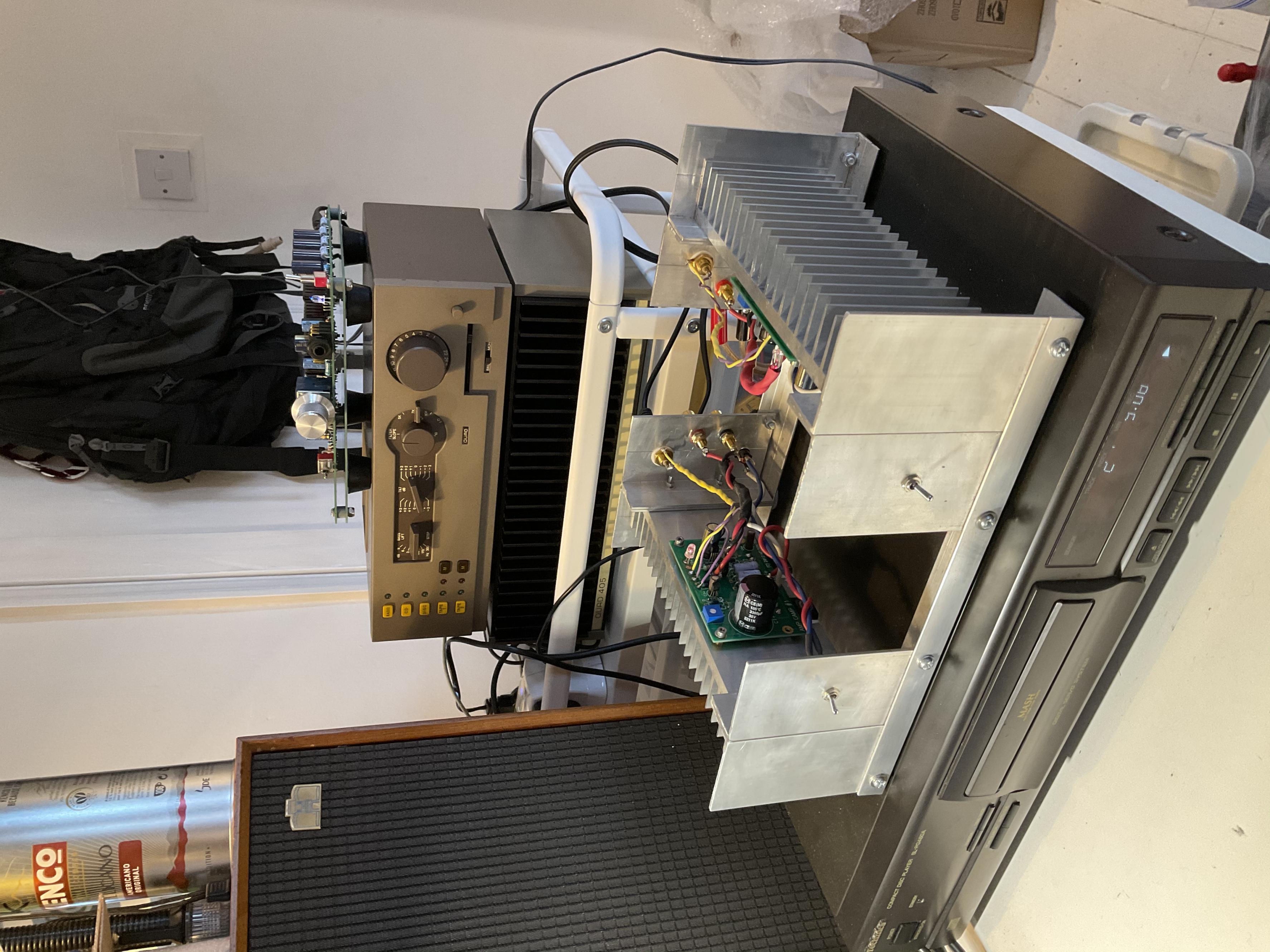

to Waarn68
Hello Waarn68,
nice work on the ACP+! And I am sure - nice sound....
Do I see a Quad - pre-/poweramp - combo in the back of the pic?
Cheers!
Dirk
Thanks guys....yes it’s a cliche but I was already “hearing things I hadn’t” when using my previous preamp on the couple of test tracks I ran through it. The ACA wasn’t really warmed up though and I have to get the room ready for visitors.
Dirk yes ... quad but both in need of some Work...look nice though!
