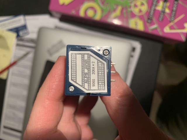

What's the difference between Alps model 516G and 906G? I can't find the info on the web. I ask since parts express is sold out of the 516G, but Parts Connection has a 20kohmx2 audio taper that is part 906G. I can't seem to find the differences, even on Alps site. I imagine the differences are tolerance-related, or body size, or something similar. I imagine the 906G will work just fine, but I'm curious about the details. Thoughts?
The RK27 is the only potentiometer that fits directly on the PCB.
Buy the 50K, It’s in stock, will work perfectly.
Jim, I have the 906g part left over from a tube ampwhere I used something else. I got it from either Parts Connection or Hifi Collective. PC calls it an audio/log taper (in contrast to what @LUX35 writes above) and it fits PM’s breakout board. I’m guessing that it is in the RK27 family. The back of the part calls out 20kx2. I’m trying to understand the specs differences since I’m being cheap by using what I have on hand if possible. That is, assuming baby ever let’s me solder again. Thanks
Can you post a photo? I cant find anything on the datasheet that says 906g to verify if it’s appropriate or not. Photos show that code on the back of what are certainly RK27s, so it seems like it’s right, but a quick photo will verify.
The ALPS RK27 potentiometer that I have is a 630N. Its a RK271/ 50KAX2
I had a 906 G which was linear so antilog.
But maybe other 906G are logarithmic...

Like I said, the supplier calls it log/ audio taper. While my experience is somewhat limited, I’ve never seen a base 10 potentiometer. Does 10^x even make sense? In any case, I’m still guessing the number defines some thing about the parts such as tolerance or shaft length or whether it has a split shaft or something similar. Thoughts, or links to specification sheets, are appreciated. Thanks,
