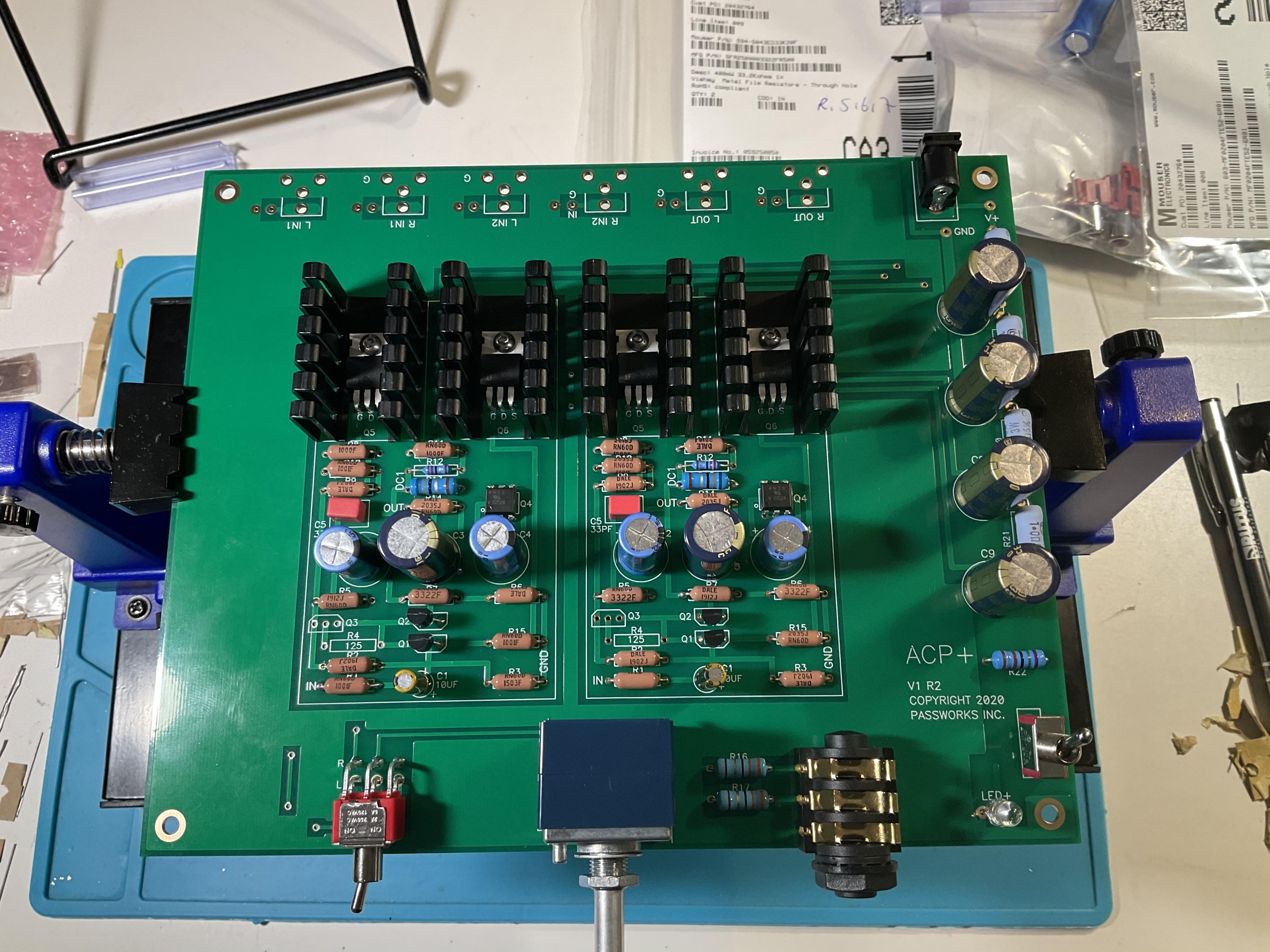

6L6 built a prototype from the BOM we posted a little while back and found an error in the RCA jacks that were specified, so I've updated the BOM and you can find that below.
What was the error in the RCA jacks that were specified previously?
I have already used your previous BOM as a starting point for my component order (I got most of the components already...).

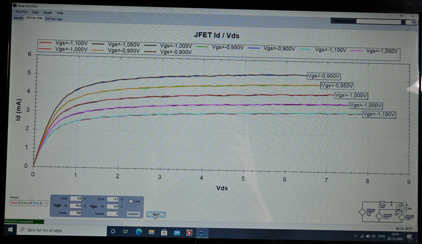

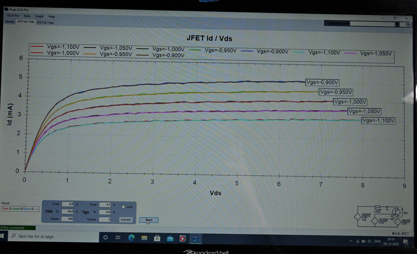

The DCR75pro can.
The two images shows two pairs I checked after matching Vgs/Ids at Ids = 3mA (for M2X IPS#6 boards).
The two J113 in each pair follows more of less the same curve.
So it is a two step procedure. First I measure like 50-100 J113 and write down at which Vgs I measure 3mA (at the higest Vds possible with the tool which was a bit lower than the real working condition). 3mA is the working condition for the J113 in IPS#6 boards. After this I group the J113 after Vgs and I find some pairs that could be a candidate for at "real" pair. The candidates I check making a curve trace to see how close they follows each other.
For the Ids = 3mA measurement I use the Ids vs Vgs curve (it is good to set like 100 test points and have the Vgs range as close as possible to where the device has Ids = 3mA to get a good Vgs value where Ids is 3mA. This range can change from device to device.
The correct range for Vgs has to be set and there is also a possibility to lock the range setting etc. There is a small learning curve for using the tool.

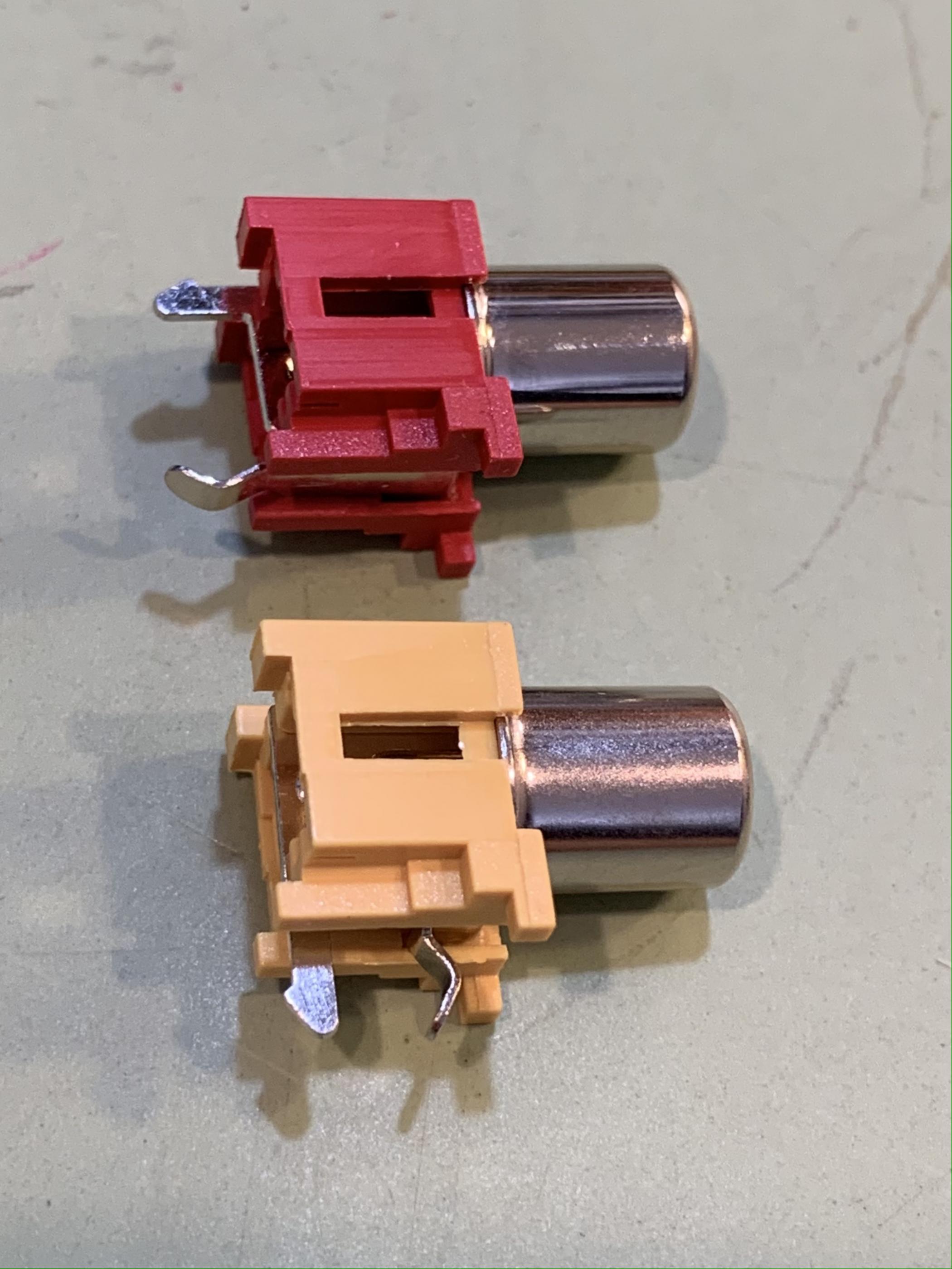

Zachik - the BOM originally had the PCB mount RCA jacks with the terminals in the wrong location.
In the photo the red one has the solder tabs in the back, this is wrong, the yellow has the tabs on the bottom, which is proper.
CUI RCJ-04x series will fit the board. The final digit “x” defines the color.

6L6 - Got it. Thanks.
ZM - I DID make my own BOM, but used the BOM posted here as a starting point / reference. I replaced several components, and the RCAs in my case are panel mounted (used the ones recommended by 6L6 on a separate PM, to match those of the ACA kit...)
The DCR75pro can.

For anyone in the UK that ordered the wrong rca connectors and doesn’t have a large order for digikey etc to qualify for free shipping (it’s £12 for £6 worth of parts) I found some equivalents on eBay that come in at £1 each when I ordered 6. The item number is 193161229522...they come in red and white. The pins are in line but at 4.5mm spacing look like they will fit the holes on the board.
