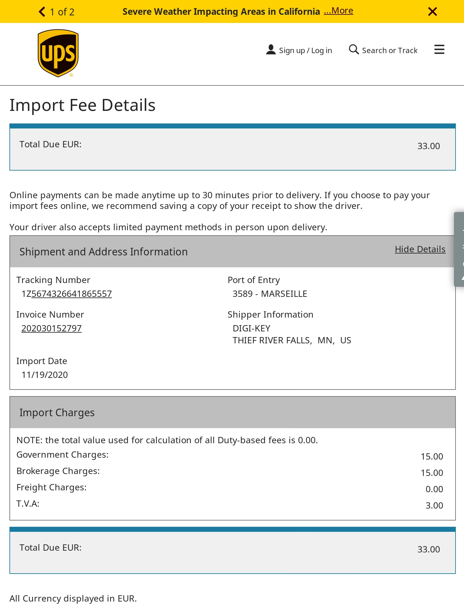

@ SuppersReady
For the first time received last days components from DigiKey > 50 € shipping is free,
but bad surprise, I need pay 33 € = importation taxes and custom duties so 57+33= 90 € :rolleyes:
Mouser total price is only with +taxes and without custom duties.
Conclusion for Diyers in Europe buying components from Digi-Key is pricey.

Well i buy at Digi-Key.fr french version of the web page.
I have not possibilitys to buy with prepaid duty and customs option.
Free shipping was included beacause components cost 57€.
On the page only message was : be prepared to pay more for taxes and importation fees.
At Mouser i always can see total price with taxes included ( prepaid ) so not bad surprise.
I think is not Digi-Key or geographical French issue is a UPS company who abuse IMO.
We in French need pay importation custom fees if goods values is >150€.

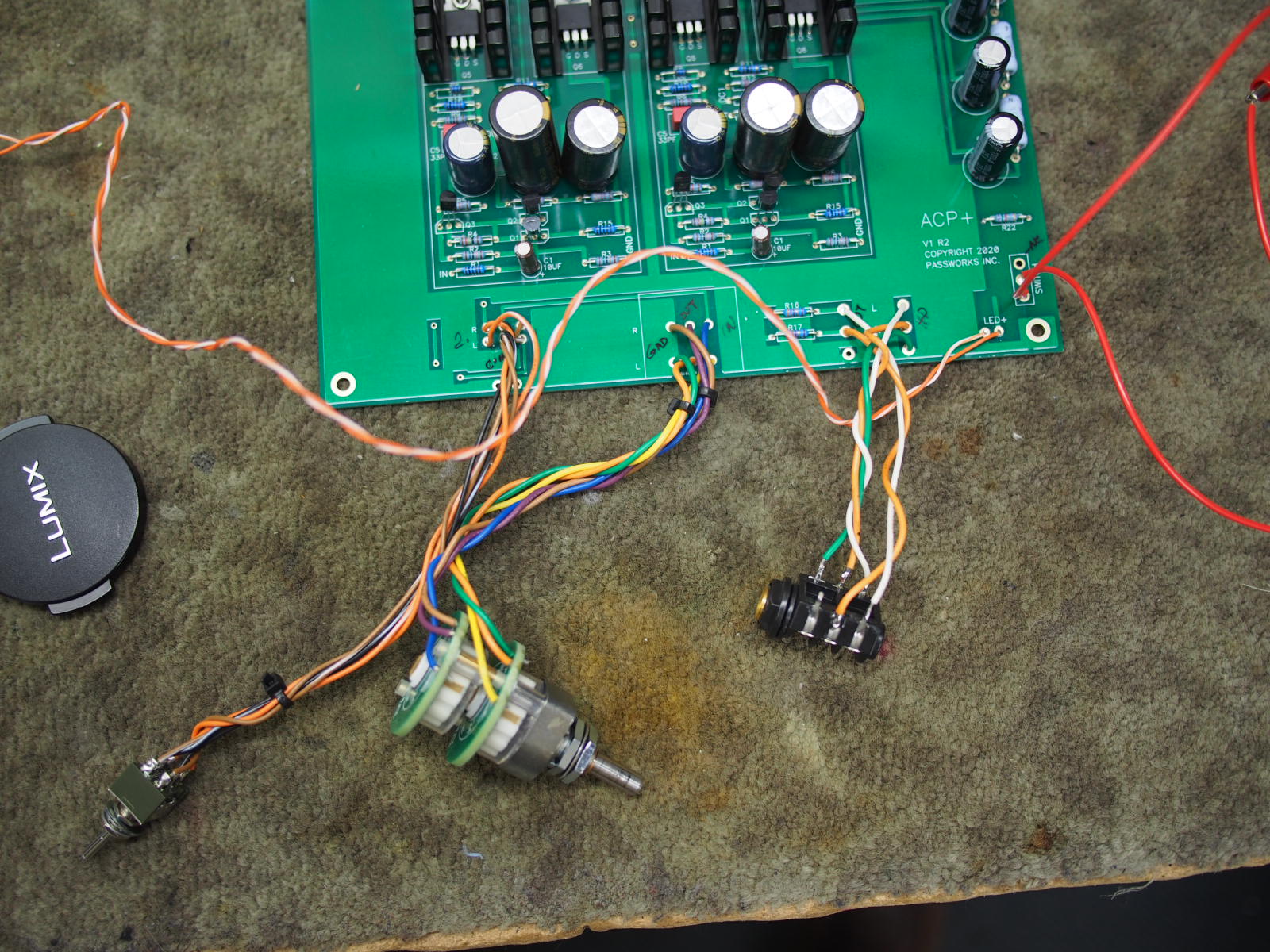

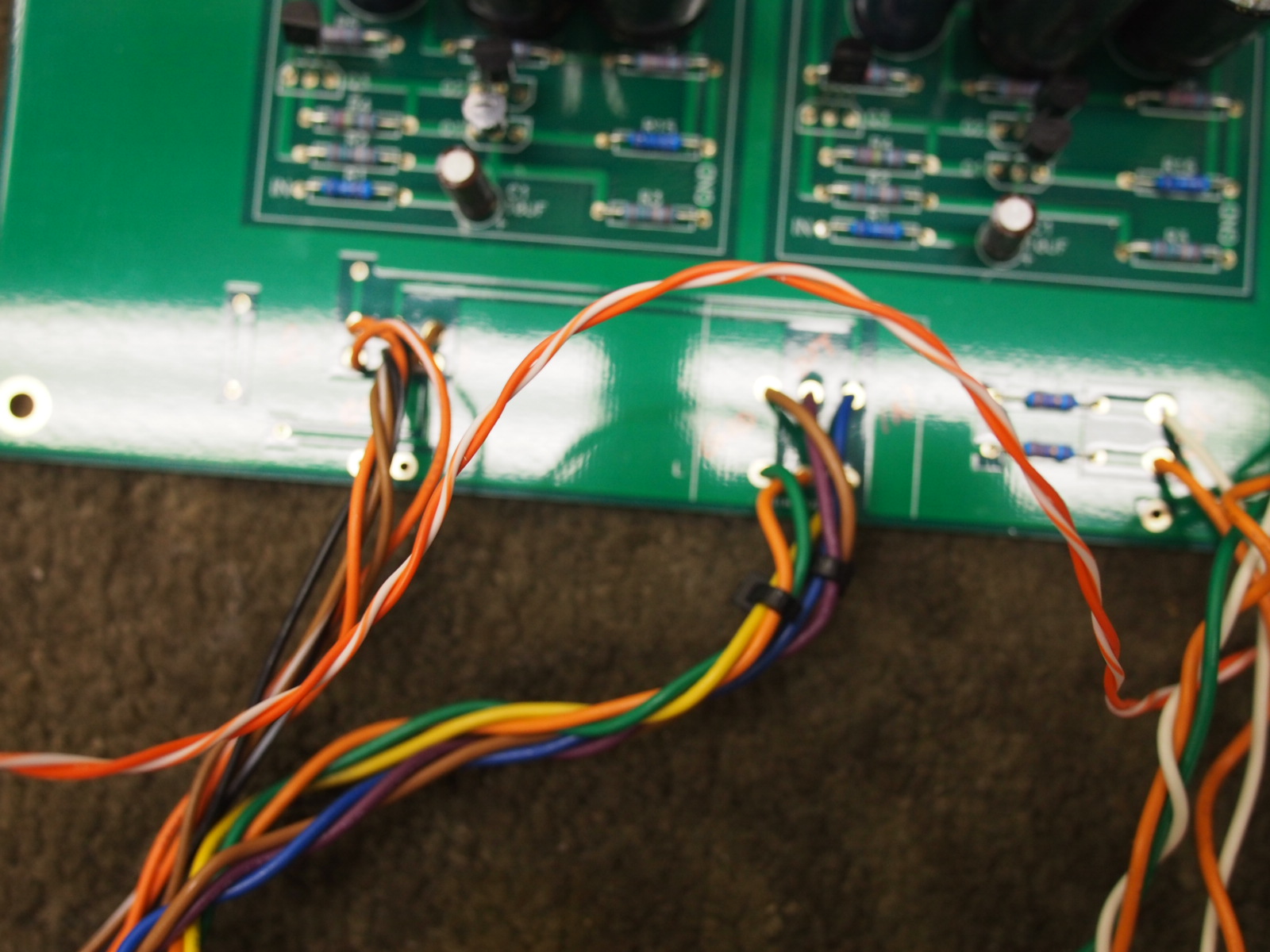

Probelm with ACP+ build:
I'm building my second ACP+ to use as a preamp (first was headphone amp).
The right channel works fine but the left channel has not output. Here are some voltages:
Q5 - Gate = 23 L - 16 R (working channel)
Q5 - Drain = 23 L - 23 R
Q5 - Source = 19 L - 12 R
Q6 - Gate = 4.0 L - 4.6 R
Q6 - Drain = 19 L - 10.6 R
Q6 - Source = 2.5mV L - 2.5mV R
Attached is a photo. I've looked carefully but can't see any component installed incorrectly and I don't see any bad solder joints, but I could be missing the forest for the trees...
Any suggestions of what to check would be appreciated. I'm sure it's stupid error.

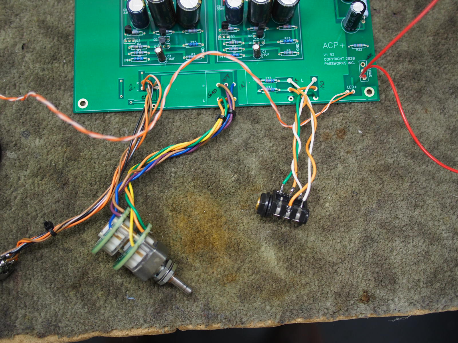

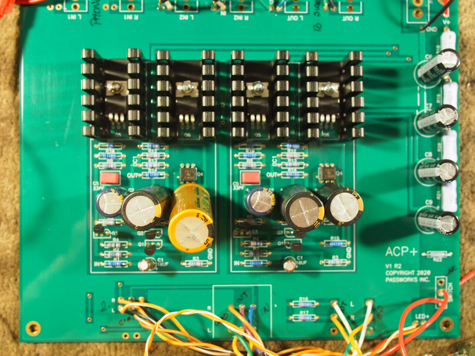

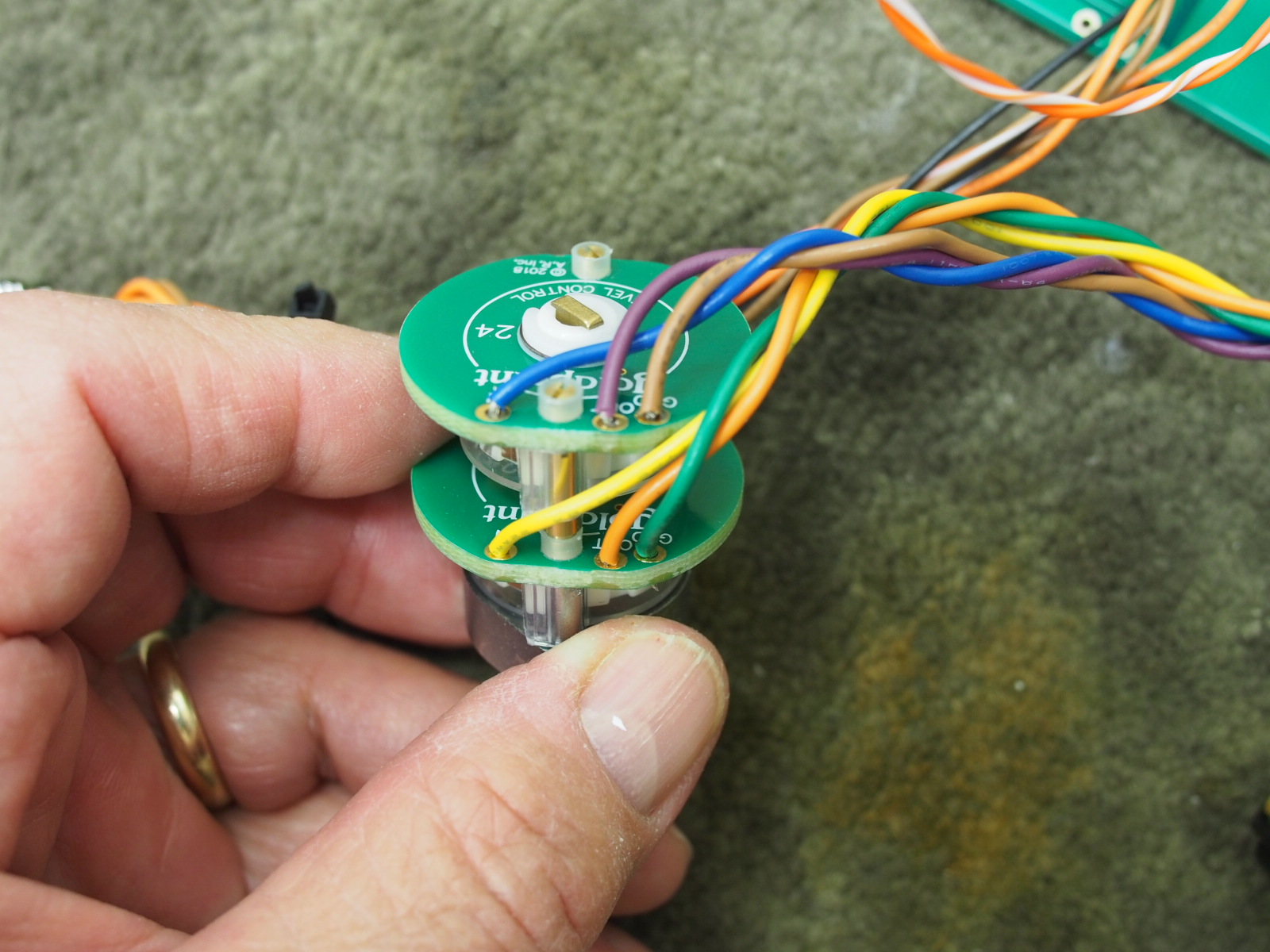

It does make sense that I would have made a wiring error. I'll go back through it. Here's a few photos
