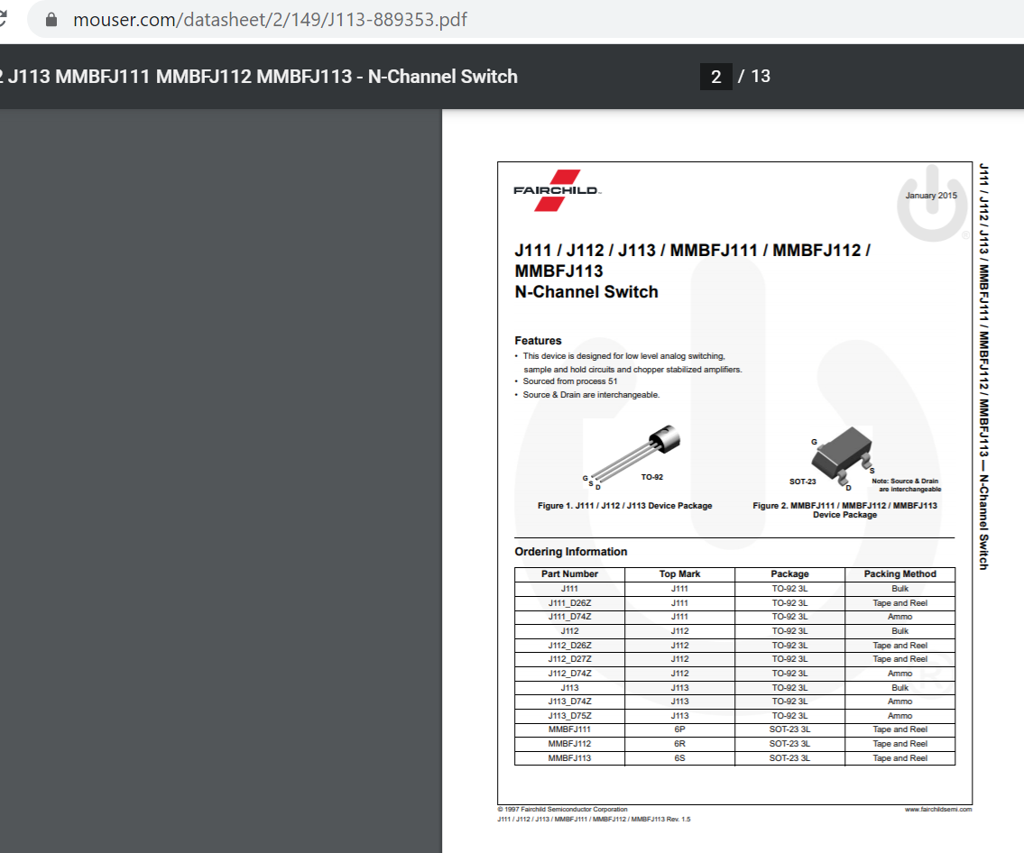

It looks like you have the pins reversed:
Check the On Semiconductor website for the latest Rev 3 version of the J113 data sheet. It shows different pin order and is the same pin order that the illustration from Mouser shows. It appears the data sheet at the On Semiconductor site is not correct?

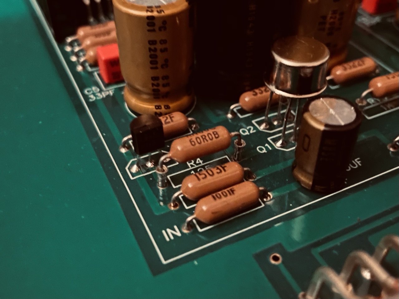

Dneu2011 - where did you buy your J113s? The color of the ink on the identification markings looks different than on the ones I have. I bought mine from Mouser a couple of months ago and the markings on mine are a faint white color. The color of the markings on yours looks much darker. Could just be the lighting in the photo though. Just wondering if yours are genuine.
I used the same circuit as you did to match mine without frying any J113s.
Just to clarify, I used the same pin out that Ben Mah used of DSG and not the GSD listed on the Mouser an On Semiconductor sites.

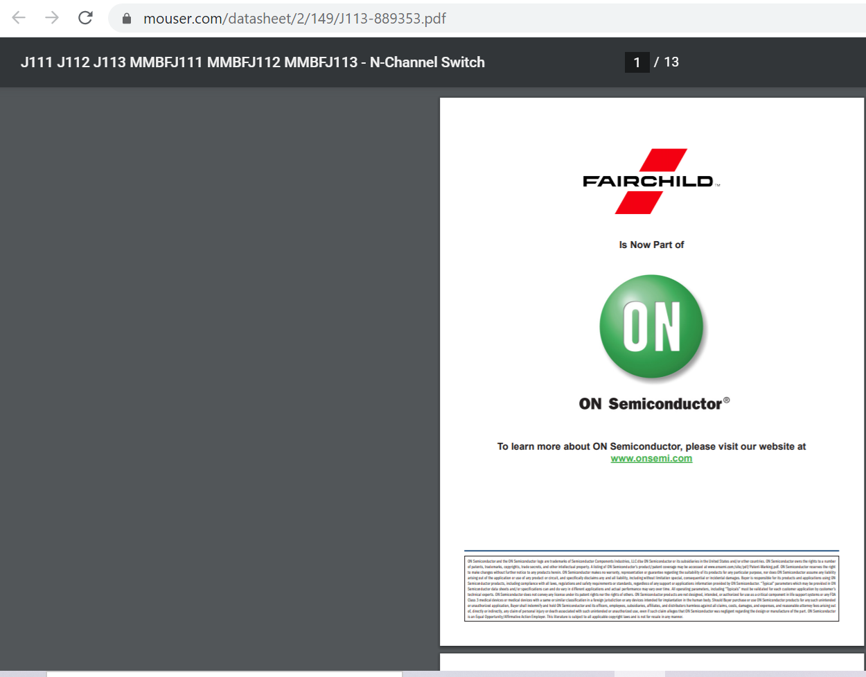

The info that I posted was from Mouser for a Fairchild part. Apparently Fairchild is now part of ON Semiconductor.
Good news. I flipped the J113 and my breadboard was able to correctly measure. I had enough to get two perfectly matched pairs, but I was hoping to get some help determining the best resistor for 10ma.

An ideal approach could be to install the closest J113 pair you have, and then choose a resistor value that gets you just shy of the Idss of your J74’s. For my specific J113 and J74s, I ended up using a 60R at R4
