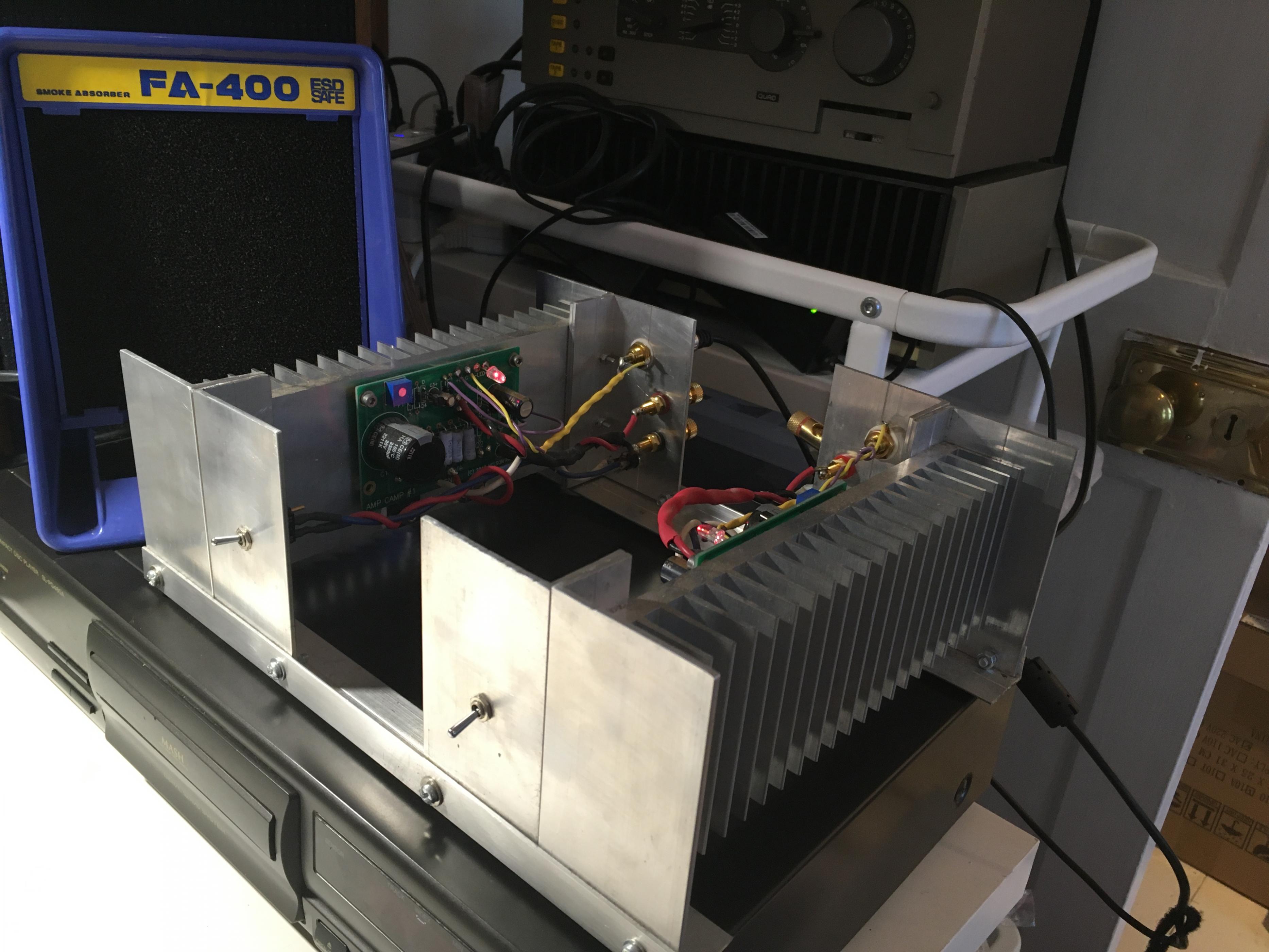

Having just resurrected my ACA from its 8 year rest in a box in the attic and wondering why I put it away it sounds so good driving a pair of Castle Richmond mk1 speakers I’ve just ordered the boards for the ACP and am gathering parts. Do I need a 24v power supply with the centre pin positive if I use the pcb female power connector?
Thx Mike
Attached is a pic of the ACA

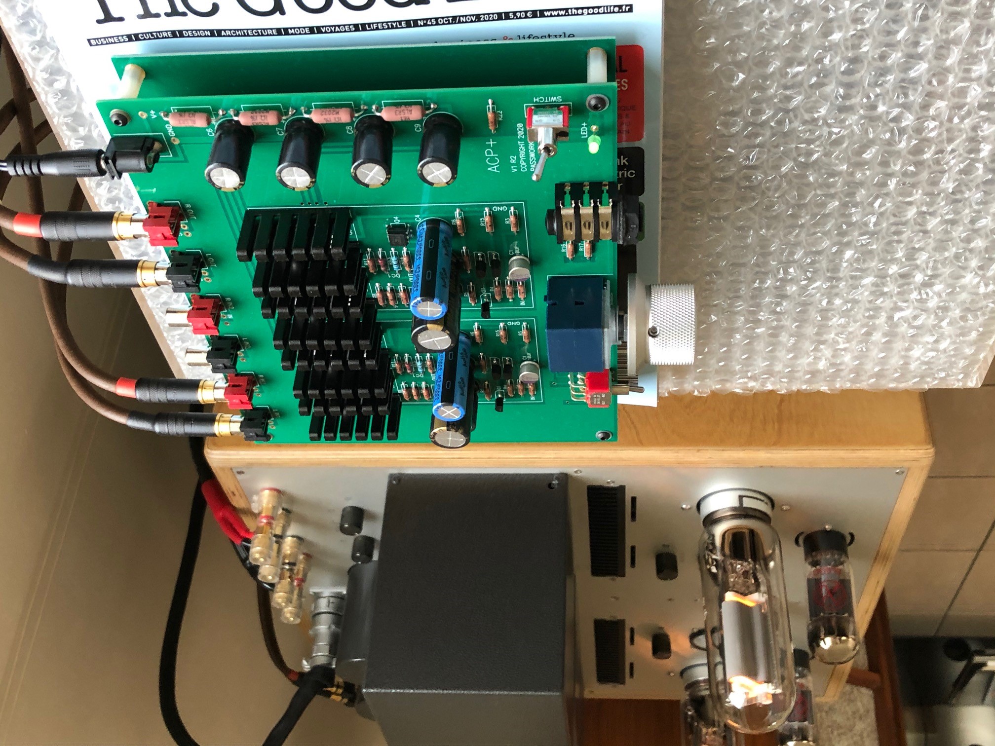

I'm building my second ACP+ to use as a preamp (first was headphone amp).
The right channel works fine but the left channel has not output. Here are some voltages:
Q5 - Gate = 23 L - 16 R (working channel)
Q5 - Drain = 23 L - 23 R
Q5 - Source = 19 L - 12 R
Q6 - Gate = 4.0 L - 4.6 R
Q6 - Drain = 19 L - 10.6 R
Q6 - Source = 2.5mV L - 2.5mV R
Attached is a photo. I've looked carefully but can't see any component installed incorrectly and I don't see any bad solder joints, but I could be missing the forest for the trees...
Any suggestions of what to check would be appreciated. I'm sure it's stupid error.
Besides the suggestions from 6L6, I noticed that you have different C3s on each channel but I cannot see their values. They do appear to be in the right polarity, so unlikely the cause but why did you use different types?
Thx Mike
Answering my own question looking at the data sheet for the recommended supply it is centre pin positive.

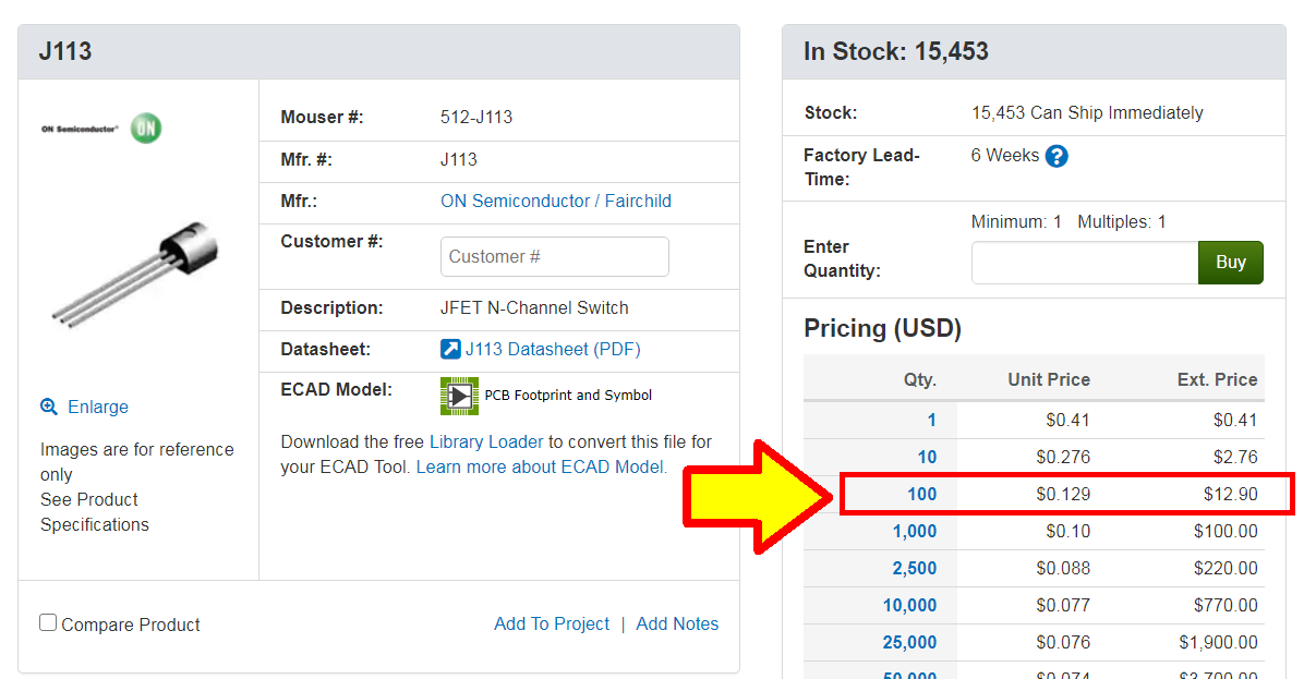

Since Mouser shipping to my address costs $7.99, whether I spend $1 on parts, or $50 on parts... I choose to spend $12.90 on J113 devices. But that's just me. I'll just put the rest in a parts drawer in my TO-92-devices parts cabinet.

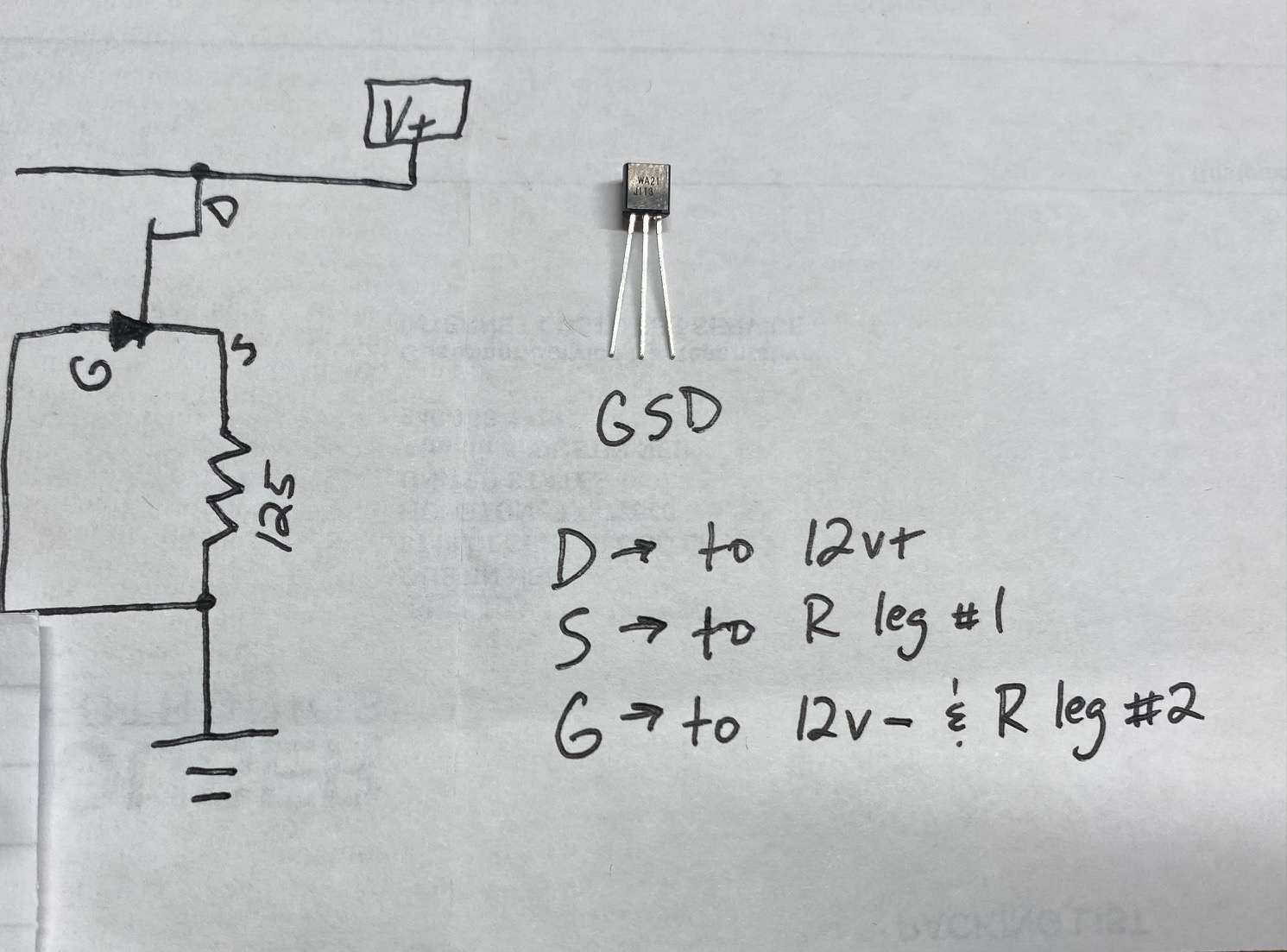

Hey everyone. I just received my parts for my ACP today and decided to test and match J113's while I wait on the boards.
I made myself a small testing breadboard with 125 ohm resistor, 12V battery, and measured across the resistor for 1.25V. Unfortunately, the design I am trying fried two JFETs.
The picture shown is the same schematic in Post #491 and I wrote out where each leg on the JFET "should" go in the schematic. Anyone see something wrong with how I wrote this up and the orientation of the legs of the JFET?
