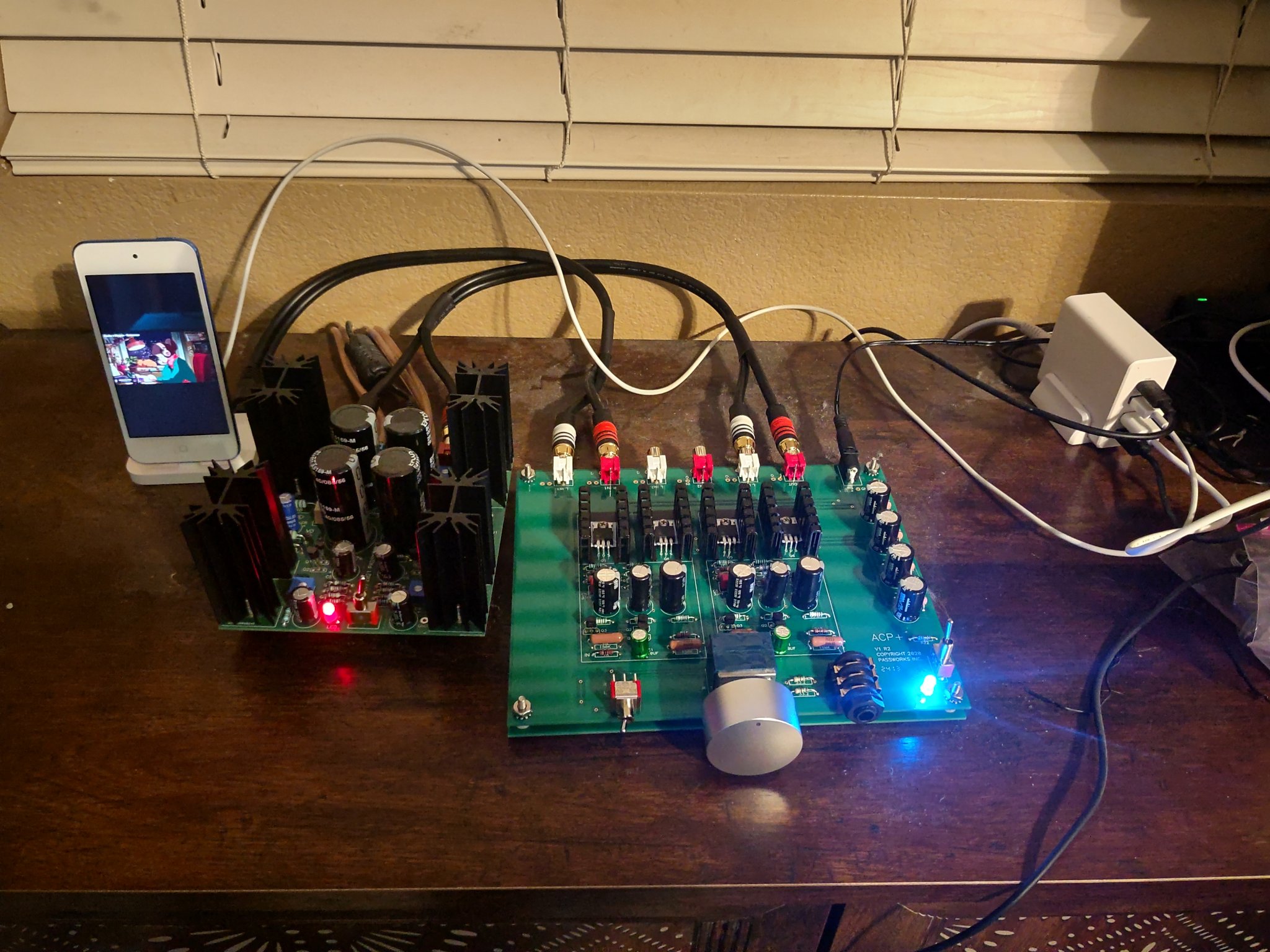

Going to build this now, and I have some questions. I kept thinking when I was planning to put this thing together that this was a phono preamp, and I guess this is a newbie mistake.
1. Can this be used as a phono preamp?
2. If not, is there a specific project here I should build that goes with these, or should I go with the one suggested by the manufacturer? (The manufacturer allows you to purchase it as either part of the unit, or in a separate housing. http://www.uturnaudio.com )
I already built the ACA mini and have been using it with an old iPod to act as a media server of sorts with a pair of sony bookend speakers.

The ACP+ Headphone Amp / Linestage does not have a phono preamp.
Here's a phono preamp available in the store:
https://diyaudiostore.com/products/pearl-3-phono-preamplifier
That one I'll need to research to ensure I'm ready to handle it.
https://www.diyaudio.com/community/threads/pearl-3-burning-amp-2023.404054/
The 1st post has a few links, a .pdf, and a video or two. Read/view them all. It’s one of the best-supported projects we've ever done.
Thanks, I did find all that. To be honest, I guess I'm more worried about the shelf space. It looks huge! (Or at least, looks huge if used in the recommended chassis pair.) I still need to leave room for the player itself. Anyone got a picture next to the ACA+ for size reference? Would it be safe to stack one of these on top of each chassis or would that cause any audio issues?
What I might have to do is just use the manufacturer one for now until I figure out my space issues. It can always be disabled.

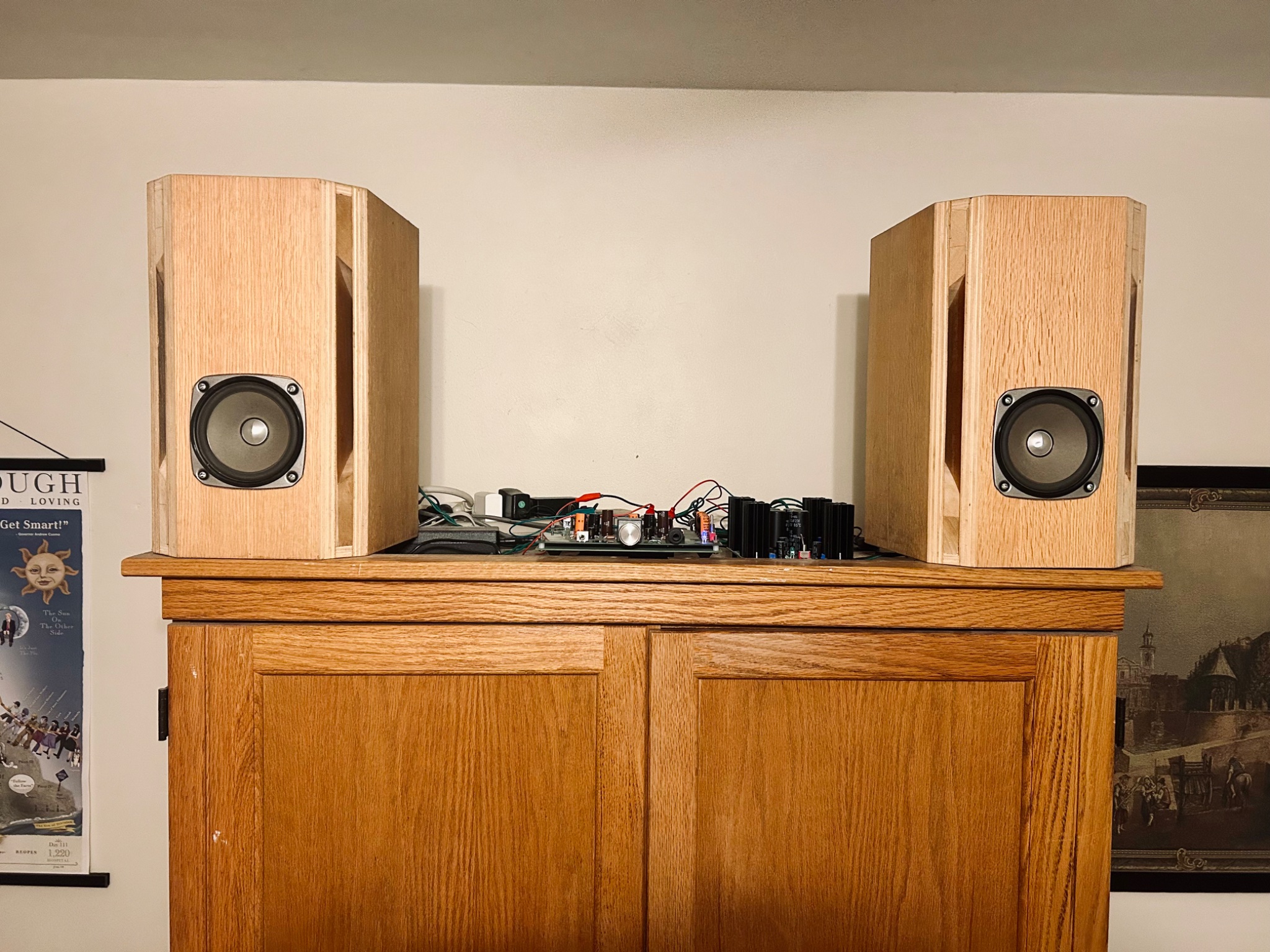

Use case proven. Barely breaking 60dB, sounds just right.
Have room to get louder, so it’s not nearly clipping.
These are Fostex FF125WK, listed as 89 dB/W(m). Half a Watt on tap with the ACP+ works fine for my modest sized bedroom. I am typically not a loud listener to begin with.
Very cool! One of these days I'm going to hook mine up directly to my 99/ dB/W speakers just to see how it sounds.
I think you would be surprised. I’m loving this. Very enjoyable. The usual marvels of good fullrange drivers apply here. And since I EQ these for the listening position with DSP (within piCorePlayer), the end result is just to my liking. No lack of detail, airyness, or bass from the ACP+. It’s spooky good.

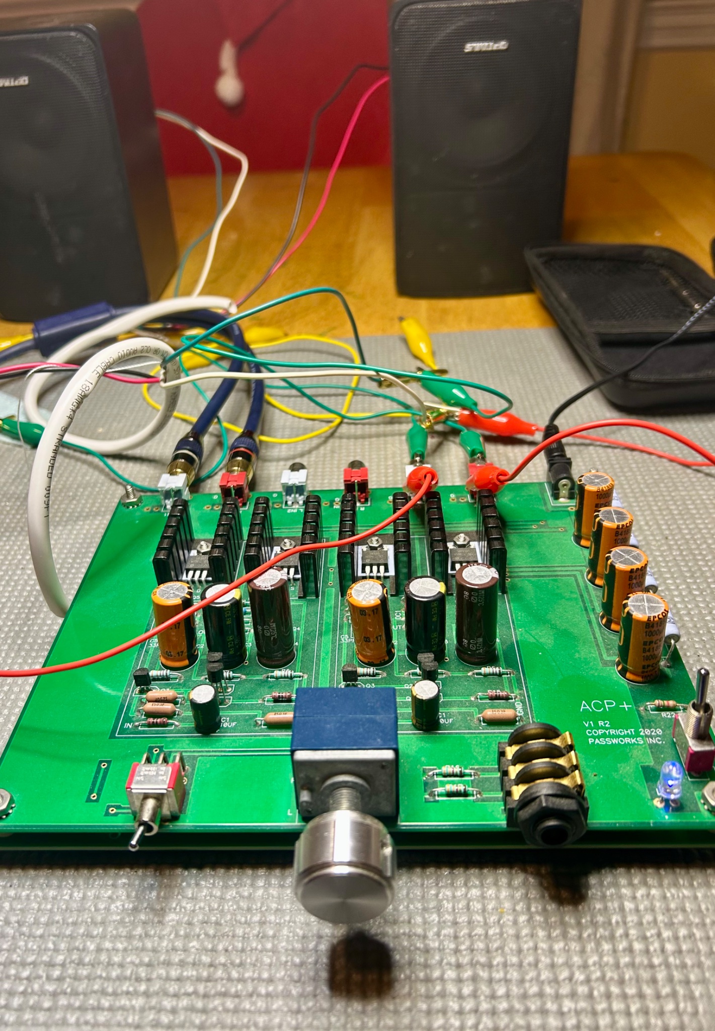

All it takes is four little alligator leads. There’s enough on the positive pin at the back of the board mount RCA to connect the signal, and the ground outside barrel is enough to grab onto. Clip the other end to whatever speaker cable terminations you have.
