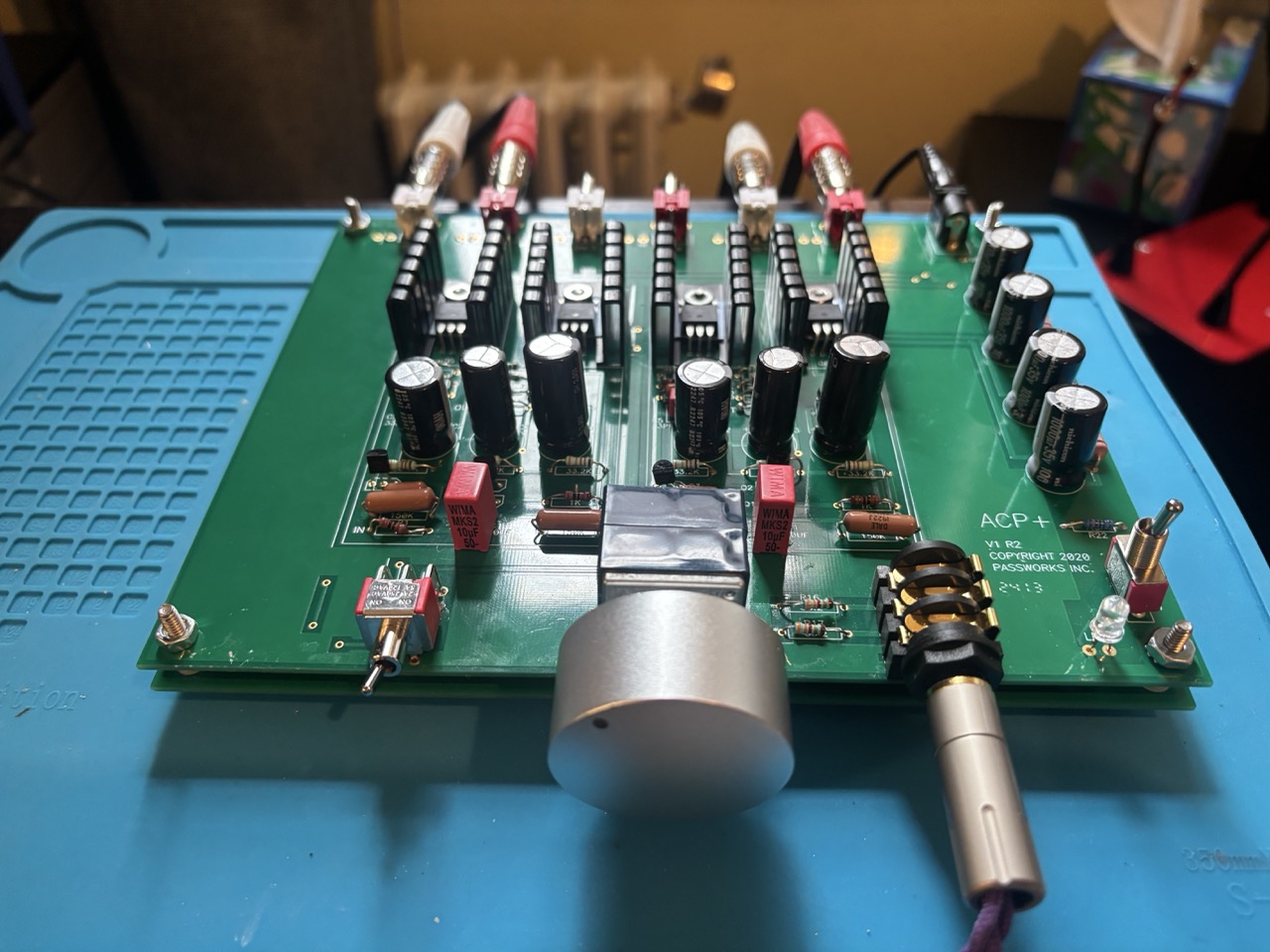

Well, I finally got this built. Worked first time and sounds fantastic though my old 6000HD Sennheiser headphones. Thank you Nelson and all the helpers on this thread!
First mod is away!
First impressions: definitely bassier and fuller, I like it
(Don't judge my amateurish soldering please)

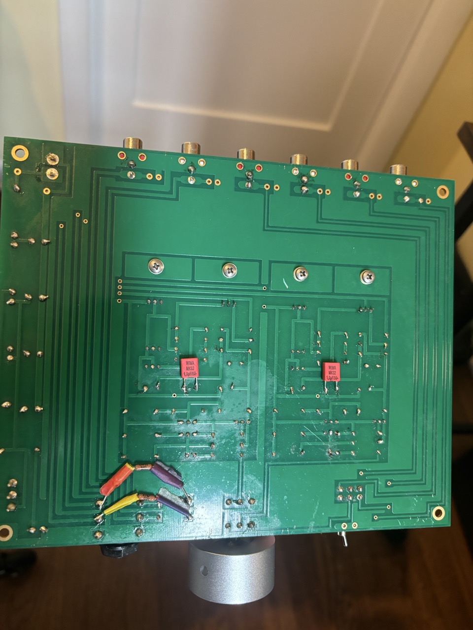

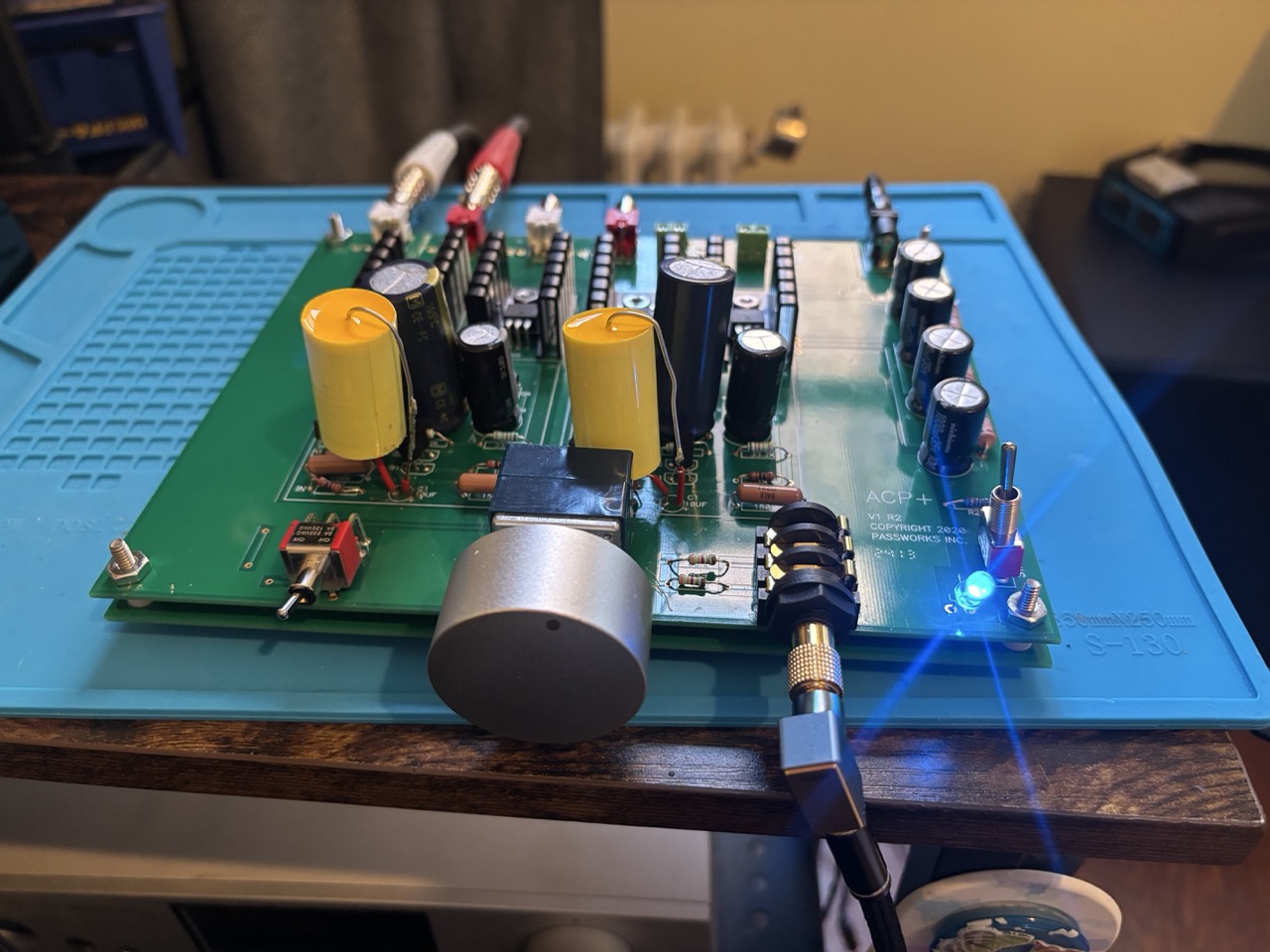

Second mod away!
Replaced the input caps with 10uF film caps and did a 1u film bypass on the output caps.
Oh, I also switched to a Jameco linear power supply which I think improved things.
This is a major improvement, the sound is much smoother and clearer, the ACP is finally starting to give my Aune S17 Pro a run for its money.

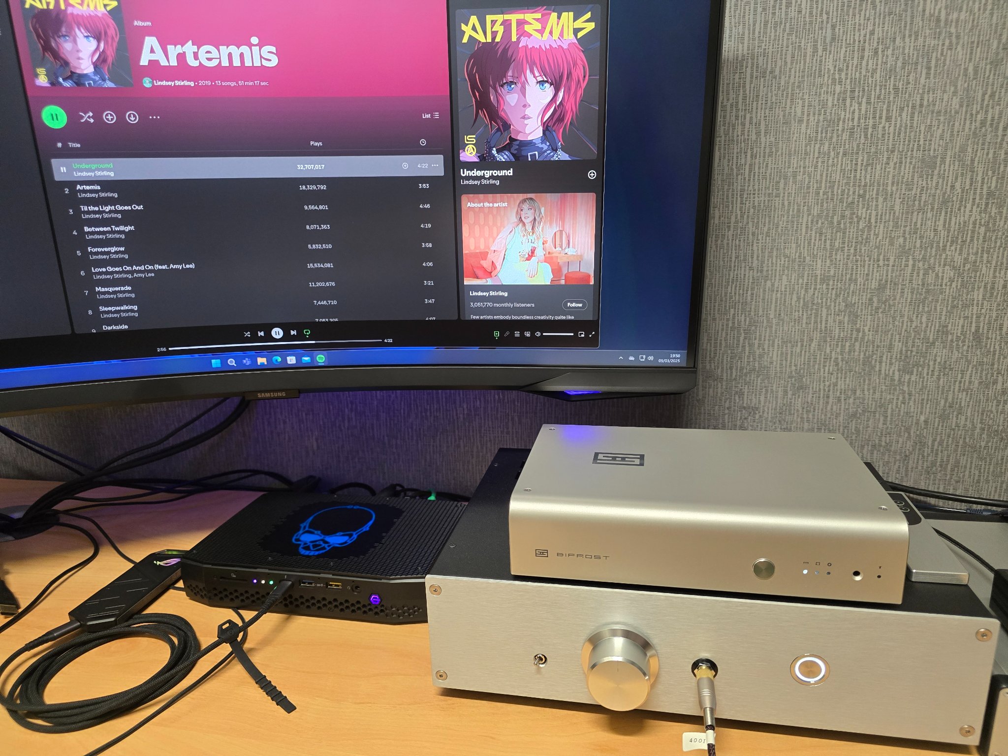

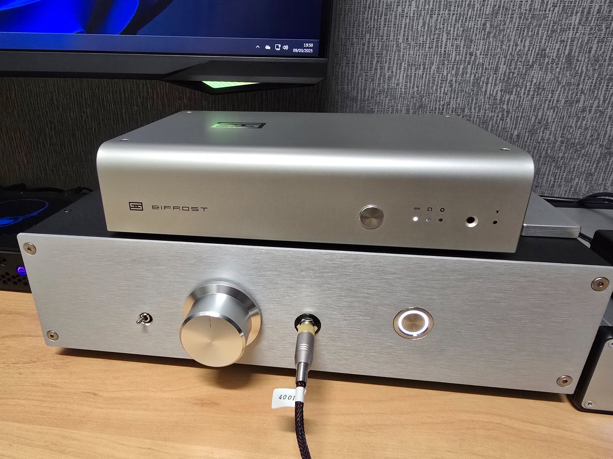

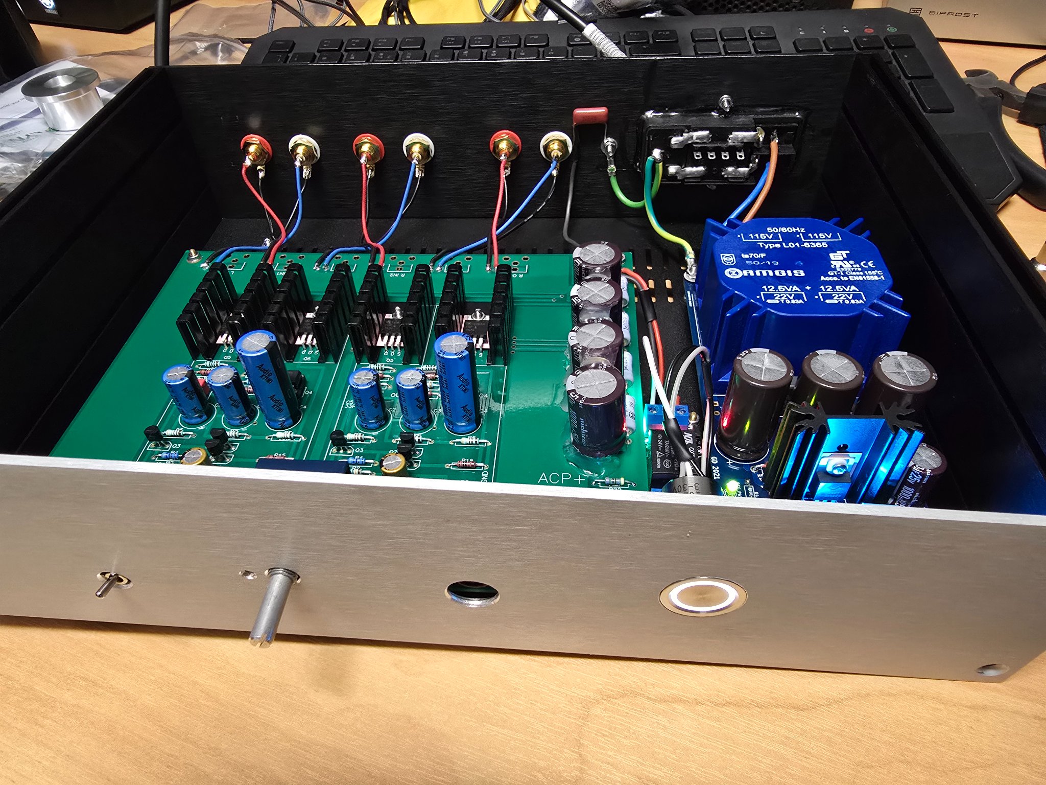

Finally finished after having the boards and components stored away for over 2 years! Sounds bloody marvellous!

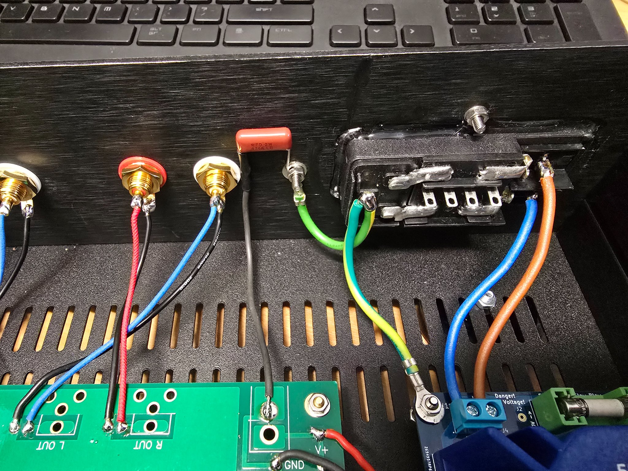

A few thoughts:
1. I see a ground wire connected to the stand-off/screw at the left side of the power supply board and to the safety ground at the IEC socket on the back panel. I am not familiar with the power supply board. Is the stand-off/screw connected to power supply ground? Or is the wire to connect the chassis bottom panel to safety ground? With an anodized chassis care should be taken to make sure all chassis panels behave as one electrically. That may require removing anodization at various spots to electrically connect all of the panels.
2. The power supply ground should be connected to safety ground, either directly or through a ground loop breaker, if it is not already connected.
2. I see what looks like an 0.47uf film capacitor connecting the ACP+ board Ground to the safety ground. What is the purpose of this capacitor? Is it for RFI control? If it is for RFI control, my understanding is that an 1nf ceramic, not film, capacitor is appropriate.

- Noise reduction: By bypassing high-frequency noise, the capacitor helps to create a cleaner and quieter audio signal.
- EMI mitigation: By routing high-frequency noise to earth, the capacitor can help prevent electromagnetic interference (EMI) from being radiated or conducted from the audio equipment.
- Safety: In some cases, a capacitor can help to isolate the audio ground from the earth ground, preventing potential safety hazards if a fault occurs.

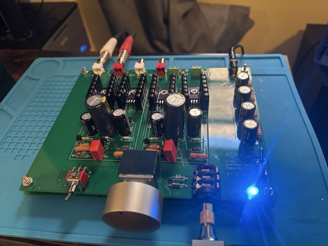

Third mod away!
Someone earlier in this thread said they put big 3900 uF Panasonic caps in (https://www.mouser.com/ProductDetail/667-EEU-FC1V392) for the output caps. It's think they sound better but if there's a difference it's small and it's hard to tell exactly because I can't properly a/b.
The same poster also somehow put in these enormous input caps:
But I can't fit them on the board! Seems like they'd have to be stuck above the resistors which seems like a bad idea. An audio engineer friend of mine suggested I could glue them to the sides of the board and run wires from the leads, but that seems a bit much. I think I might just buy the axial versions instead and try those.

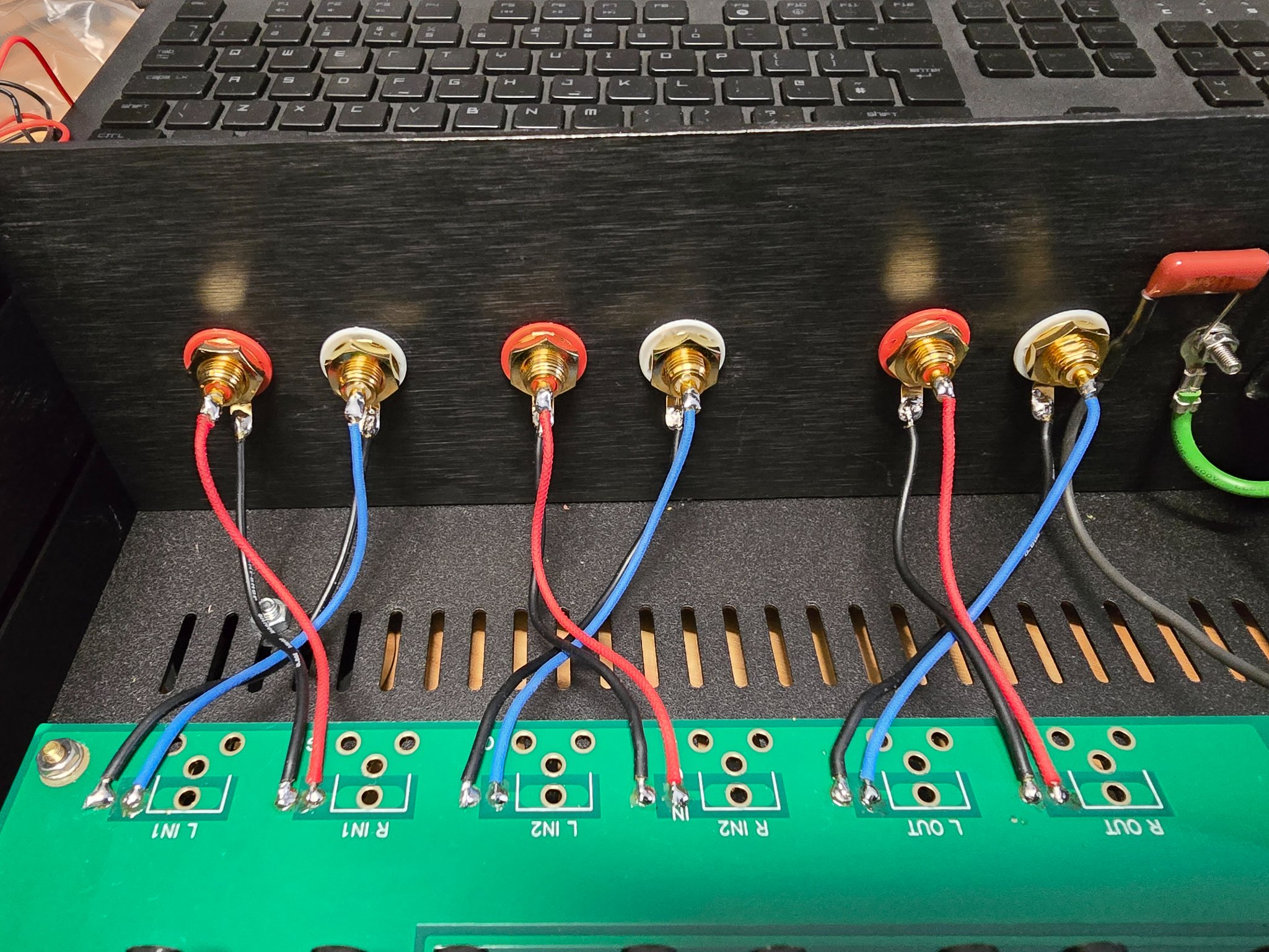

Oh, you can see above I also replaced the output RCA jacks with screw terminals (nice that the board provides extra holes that can be used for that). This is because I want to have two sets of outputs in my final build. For which I also just got the Galaxy case. Also the parts for the power supply came--I'm building an AMB Sigma11 for it. I'm going to put that into a separate chassis so that I can use it for other things if I want to. Will post more as I progress.

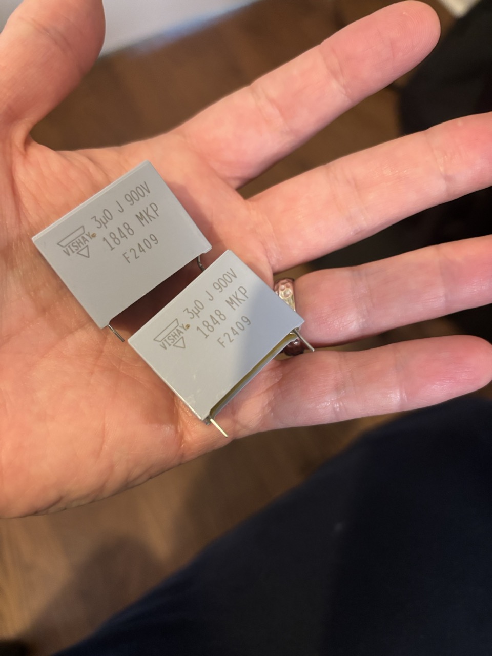

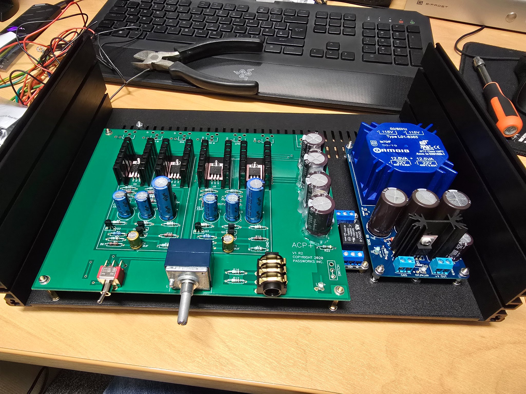

Fourth Mod:
These are the axial versions (more or less) of the big film capacitors I couldn't fit before. And even with these the legs wouldn't fit in the holes! So I had to take a bit of wire, solder it to the capacitor legs and then solder THOSE to the board. The result is a bit janky and there's clearly a cold joint somewhere on the left capacitor because if I push it a little the left channel goes out. Still there's a definite sonic improvement imo.
Still waiting for the larger chassis. Meanwhile, still building the power supply.
