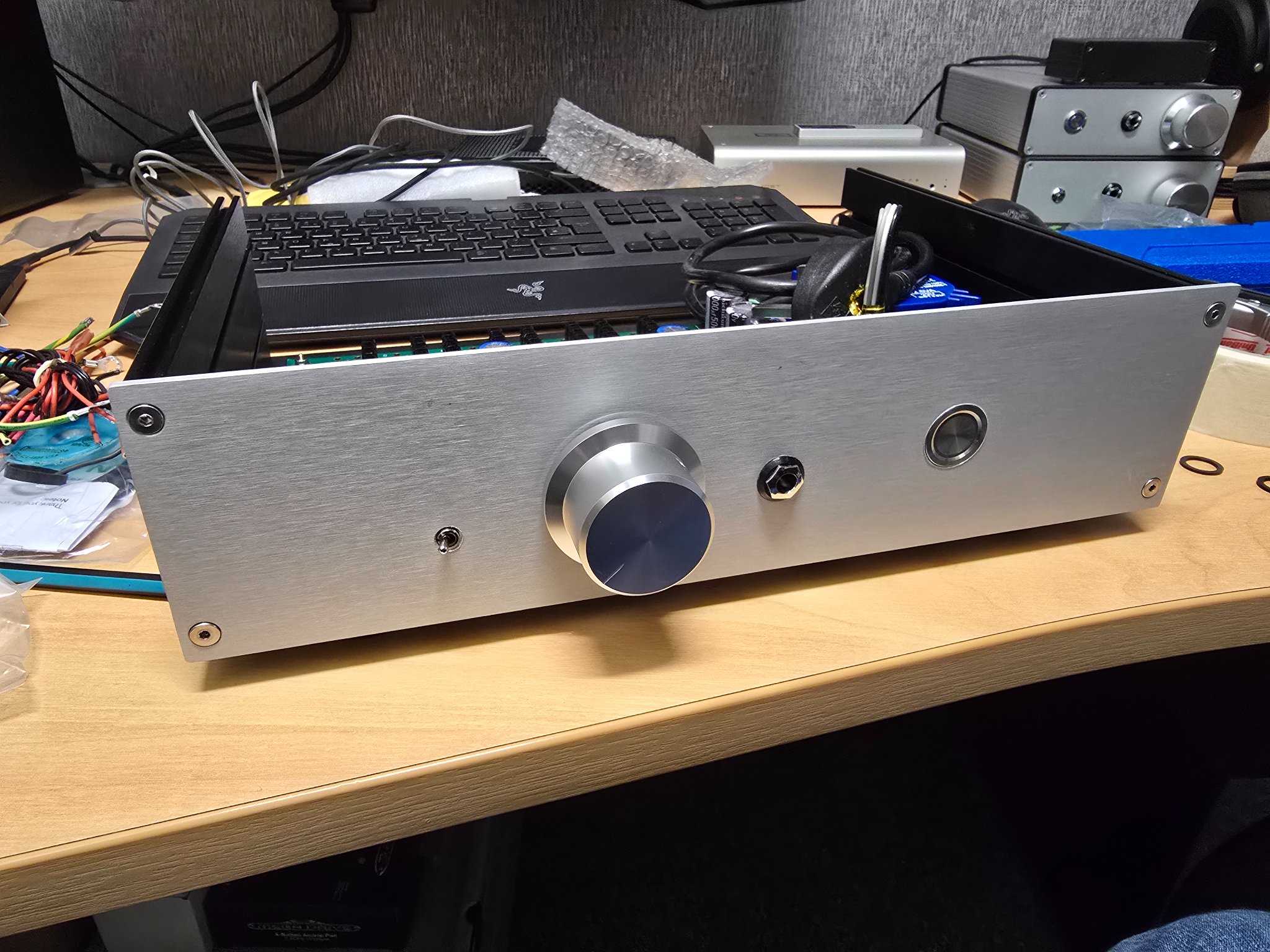

I know it's probably old news now but I have taken a step back from projects the last few years and the parts just sat in a cupboard. I have finally started building my ACA+ into a Galaxy enclosure and I'll be using one of my Artemis PSUs to provide clean power to it. There is also a small relay board mounted as I will be using a piezo switch with white LED ring for the power on and off function.
A few pics attached. 😊

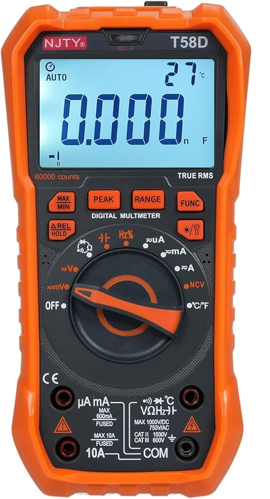

I just bought a similar one to this and while it's not the best built in my collection, it is extremely handy and has very nice features!I gave a presentation at Burning Amp 2024 a few weeks ago, in which I recommended this multimeter. It's a handheld (battery powered) meter whose display has 4.5 digits, basic accuracy is 0.1%, and it'll measure 0.1 millivolts and below. A very nice value IMHO and a good fit for the topic of my little talk: transistor matching.
Hoping this is helpful.
(oh and well it's stupid cheap so I figured why not)

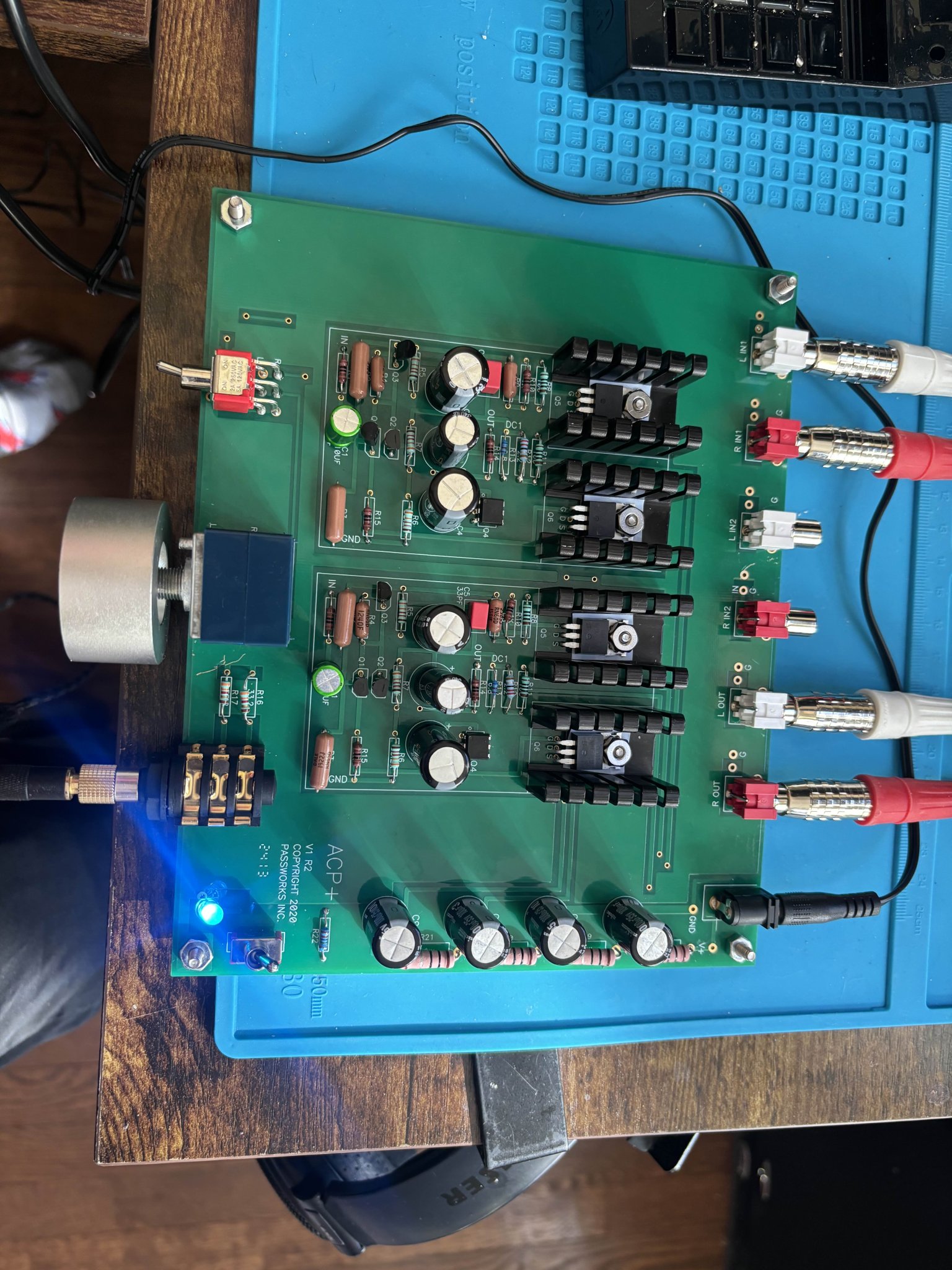

Built one of these as my first DIY audio project (having only taught myself to solder a few weeks ago) and while it won't win any prizes for solder or assembly I'm delighted to report it worked as soon as I plugged it in with no issues!
The only issue I had was that the nuts that came with it didn't fit the screws on the outside of the board (it's possible I mixed up the nuts for the two boards and the nuts for the MOSFETs, but the nuts don't look like they'd fit those either), so I had to go to the hardware store and buy some different nuts. But they seem to work fine. (The hardware store also didn't have the k-lock nuts that come with the kit so I just used regular nuts, hopefully that won't cause any kind of problem.)
Probably going to be digging into this thread about mods in the future and it seems like a better power supply might be a good follow up project, but for now I'm just listening and enjoying...
