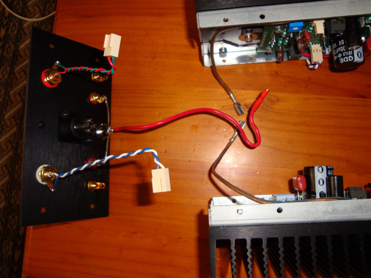

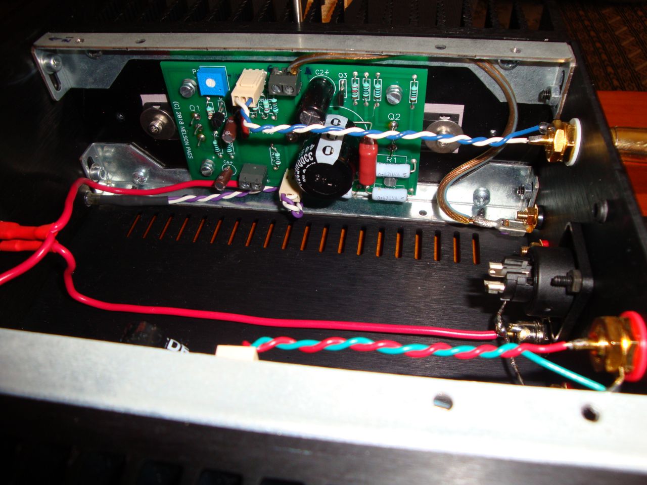

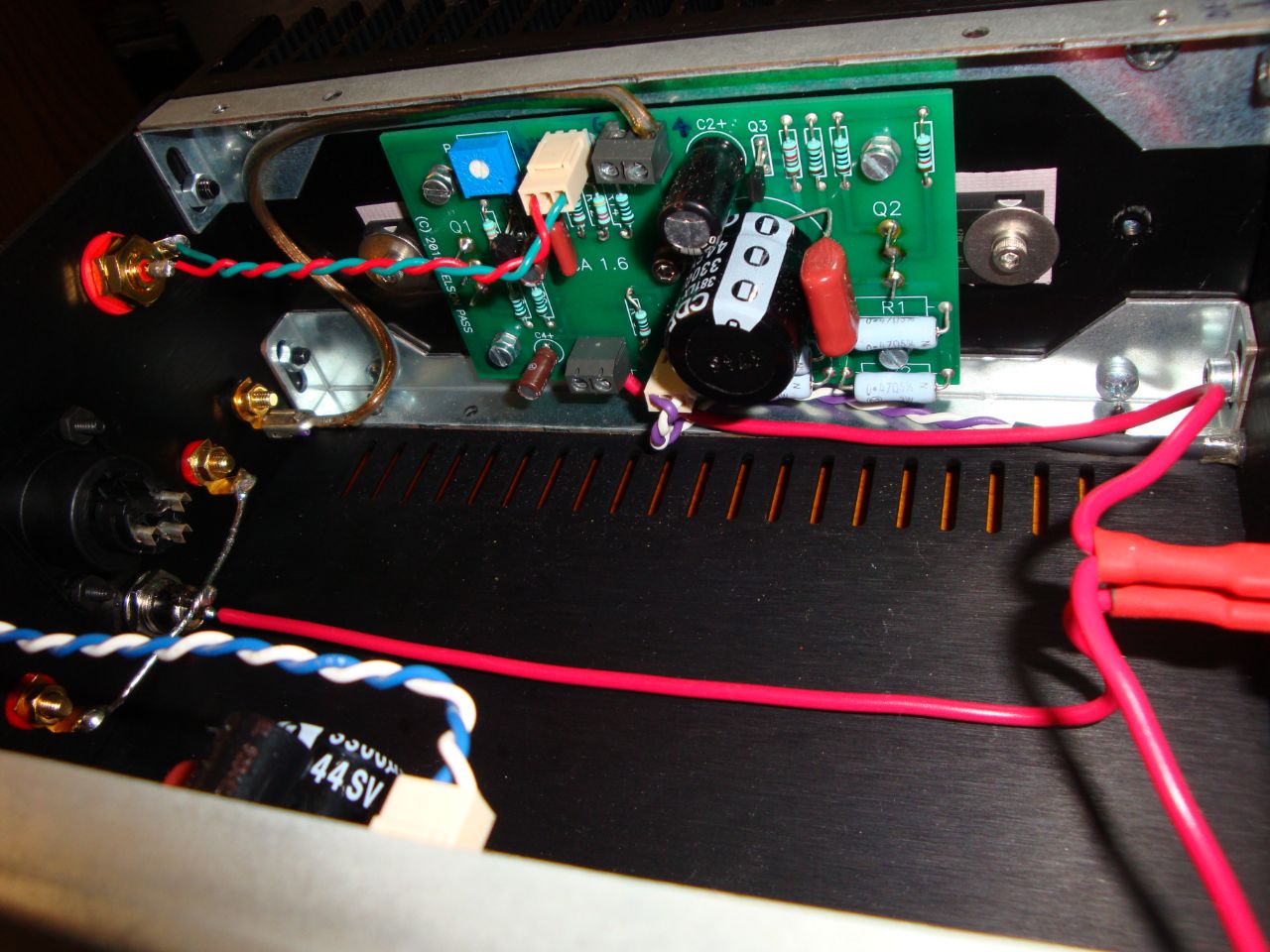

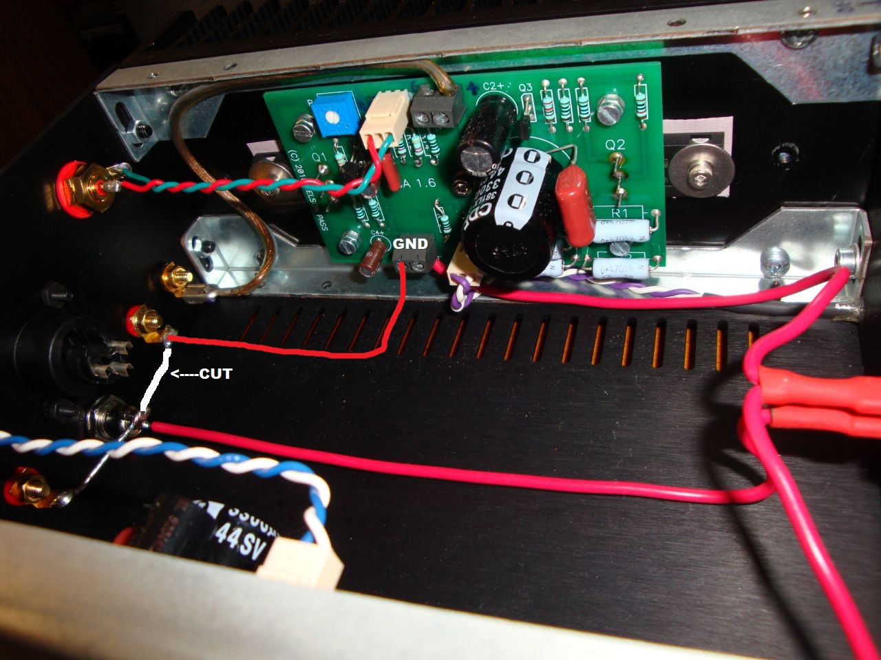

Very neat work. Particularly like the versatility of un-plugging everything. My amp would need serious dissoldering to dissasemble it. Yours look really clean!
question: didn't I read somewhere standoffs are now nylon? those in my kits are brass 😕
Some kits have nylon standoffs, some brass. There are pros and cons for either: nylon insulates but it's arguably easier to damage the thread. Brass is "sturdy". It's a subjective personal preference if you prefer one or the other so consider whatever you got in your kit as a learning experience with that type. You can use either, but I think we'll go back to "sturdy" brass.

That is a very neat build, congratulations.
I like the simplified wiring using the chassis as 0 volt/GND.
One thing I would change though, I would have separate wires from the red terminals to either the GND (or +OUT). That way the 24 volt supply currents and output currents do no use the same path and interfere. That is after all what you have done for the input sockets.

I finished my ACA 1.6 two weeks ago and are very happy with it. I have ordered two ACA 1.6 and the last one will arrive when they start to send out the 2.nd batch. The reason for ordering two ACA is I want to run them as mono - one for each channel using the XLR connector. But I do have a questions regarding the switch on the back.... right now I am running the ACA as stereo ( only got one for now ) and flipping the switch do not give any change when playing music. Is that switch only to be used when running two ACA 1.6 as mono using the XLR connectors? if so, how about the switch position? Up or down if wired according to the 6L6 gallery of V1.6 photos?
Sorry for asking but this is my first build and it is a complete new world for me!!

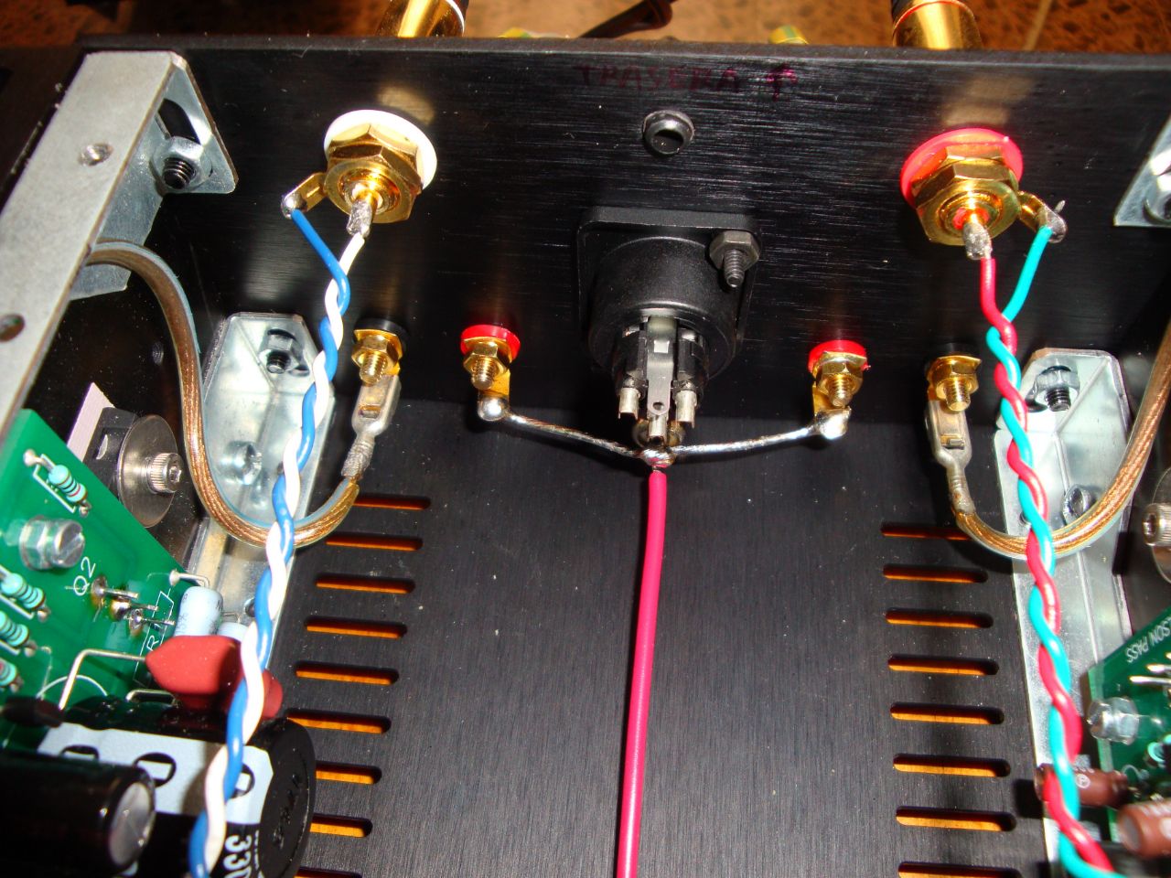

AJL, the ACA 1.6 is, by default, wired to allow either stereo operation via the RCA connectors or mono balanced operation via the XLR connector.
The switch, if built as per 6L6 1.6 photos and videos, is to make the AMP a mono RCA amp, where the output of channel A is fed into the channel B. If wired as the instructions, the up position will be for mono RCA and the down position will be for stereo RCA / mono XLR.
So, for XLR mono, you should put the switch down and use a regular XLR balanced connector (hooked to a balanced signal, of course!).
For testing the effect of the switch, you will need to plug just one RCA (in the instructions the Left channel) and take the speaker outputs from both black terminals.

RafaPolit.... thanks for the answer. A big help....
And switch now tested working, thanks.

Hi Xapu0, I'm Curious I see you bypassed the Caps on the board, what values did you use? Beautiful work 🙂

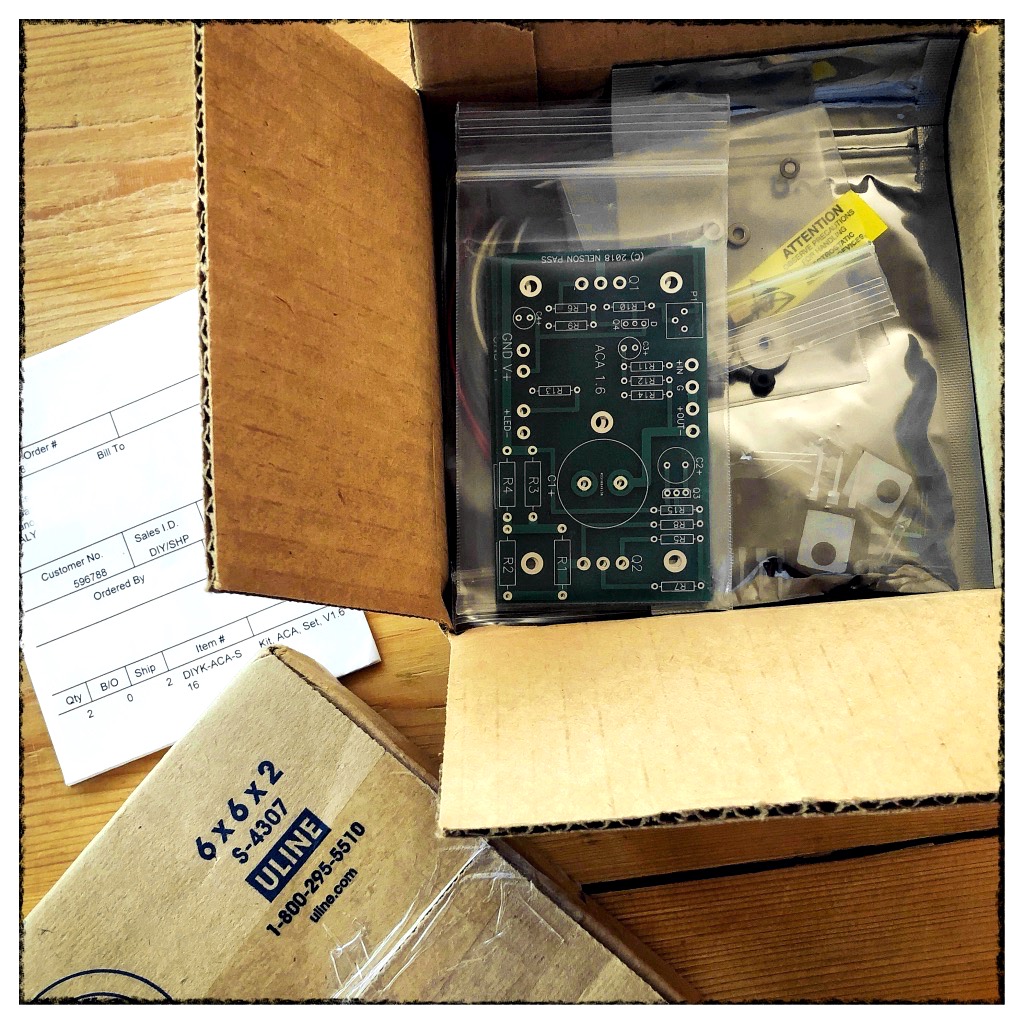

Just completed my v1.6 ACA and wanted to share some details. From a build standpoint, soldering the PCB's was super easy. It took me a bit longer to do the wiring, but I don't have ideal tools for wire stripping and I had to spend a bit of time visually studying the wiring here: aca16
I would note, everything came well packaged, but the top/bottom plates of the ACA had scratches, a minor paint chip or two and areas where the black finish looks like it may have been slightly burnt (this was visible thru the undamaged plastic shrinkwrap). I'm not disappointed though, the faceplate came in flawless condition - this is probably the only part of the amp I'll routinely look at. I purchased the complete kit so it came with the 24v Meanwell power supply. I set initial bias, and after half an hour heat sinks reached almost 50C, and checked again. Bias remained in 11.9-12.1v range.

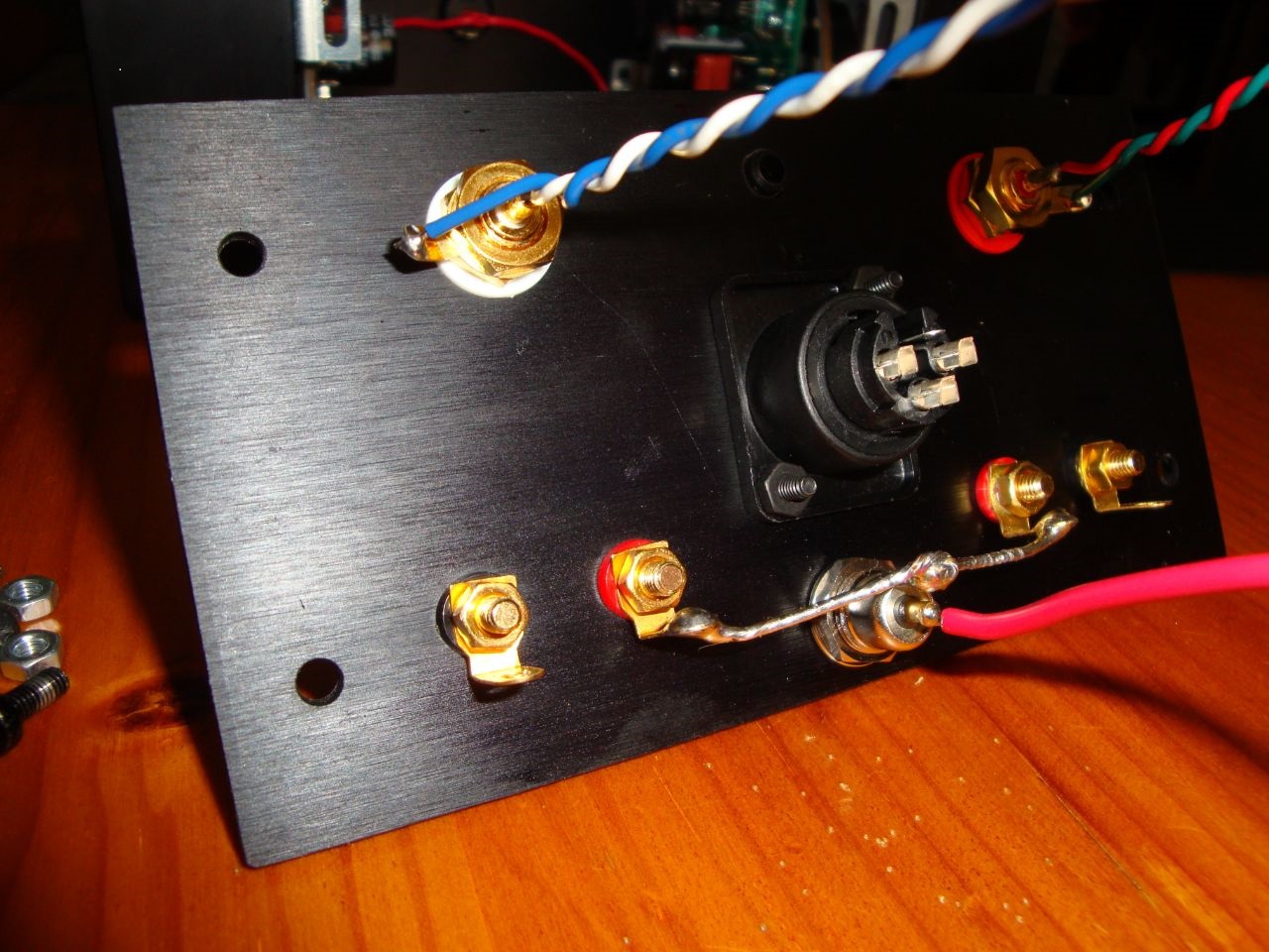

Building my first kit (RCA monoblocks, no power switch) and while the 1.5 directions sufficed for the boards and the chassis, I'm finding the back panel layout and wiring so different, I decided to take a break and write for help.
I have the photos from the upcoming 1.6 guide release, and they help a lot, but I still don't think I'm clear on wiring the stereo mono switch, and exactly how to do the wiring for the no power switch option. There seem to be comments interspersed all around various threads, but it would help to have them all in one place, since many seem to be outdated, or superseded. While there are some comments pertinent to 1.6 in the 1.5 guide, they seem to disappear at the end of the guide when the back panel wiring steps come around. I can try to just wire by copying the 1.6 photos, but I'm not really comfortable with no narrative.
Maybe there's a later 1.5 guide with more info for 1.6?
Also - there are two sets of leds so we can choose color? or am I missing something.

Hey Panoff. I think that, at some point, there's going to be a very clear set of 1.6 instructions for both front switch and no switch.
Right now, the available 1.6 photos are mostly for front switch versions. If you bought without the switch, your best approach (in my humble opinion) is to follow the 1.5 guides.
Everything will be more similar to your setup. The one difference is the PSU chassis connector, which now has only two pins: the center one is +V, the other is ground, so you won't need to bridge the two outer rings.
The other important thing to note is that, in your case, it makes more sense to have the back switch actually be an on / off switch, instead of the RCA mono / stereo switch. For that particular functionality, you can default to the external wire from the speaker output to he RCA input, just as in te 1.5 instructions.
Does this make any sense and you feel confortable with this overview, or would you need further insight into the specifics of the assembly?
