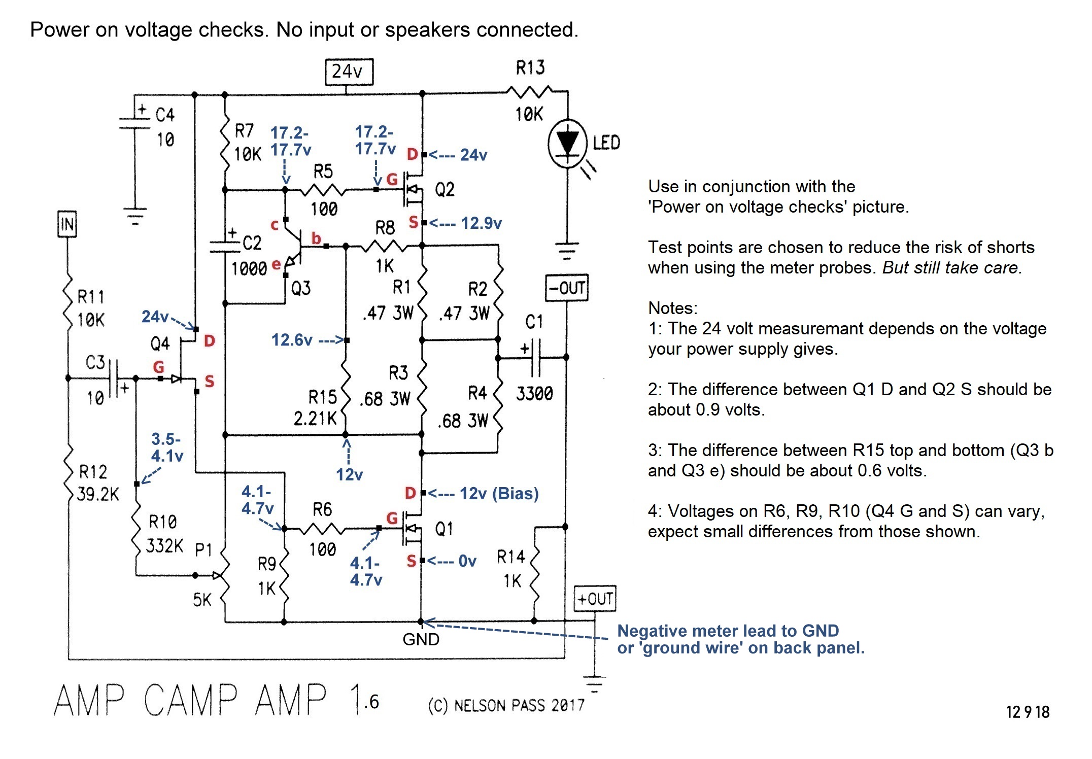

Simple ACA 1.6 Measurement 'guides'
Most people complete their kits with no problems thanks to the excellent build Guides from 6L6.
The few who do have an issue have mis-identified a component or installed it the wrong way round, or have a short from a solder blob or poor installation of the Keratherm shims etc. Even dry joints from inexperience in soldering. Ehy we all had to start some where!

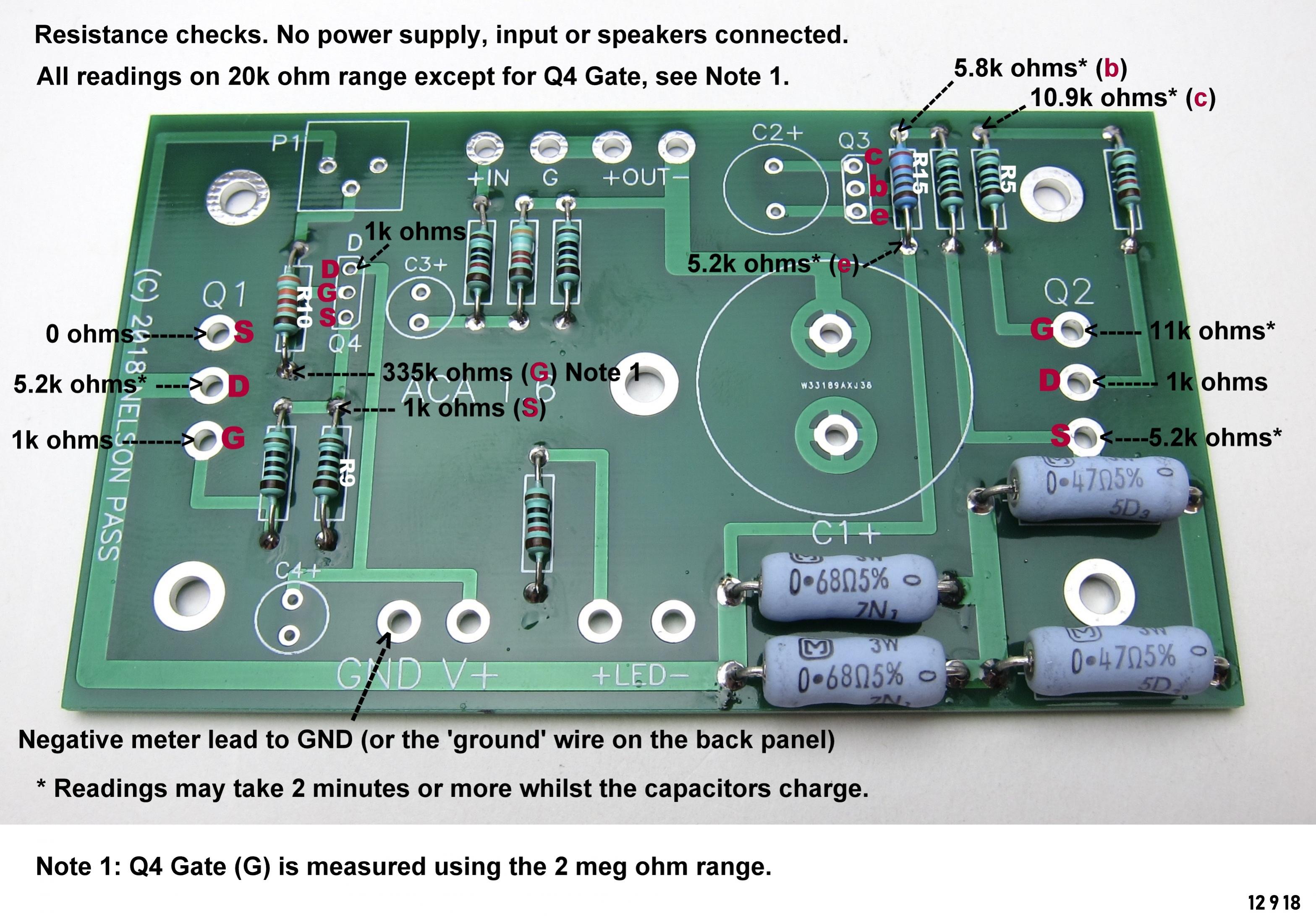

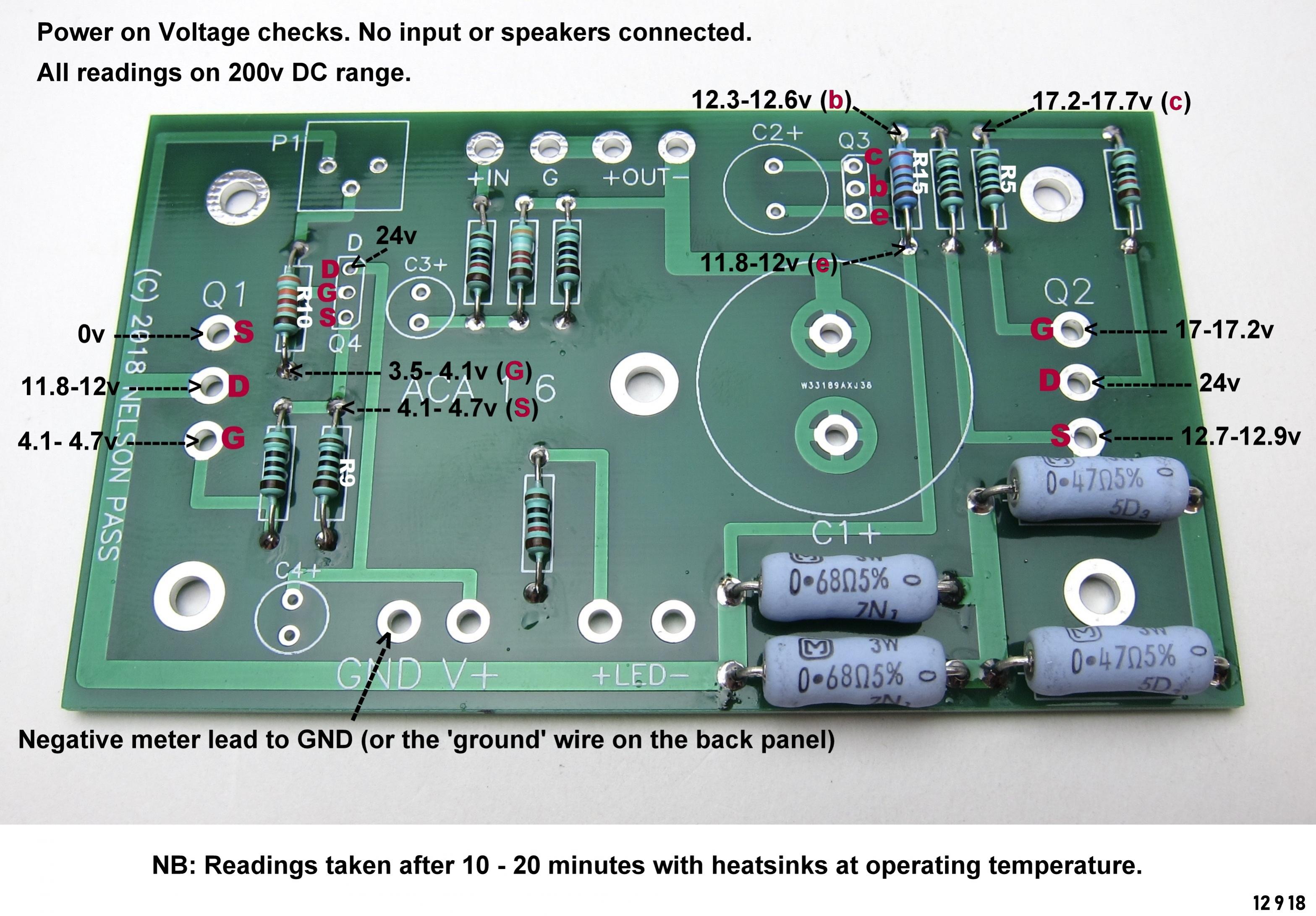

So to help, I wondered if a few simple measurements would be in order. I have followed the ACA thread a while and did not find a single place that gave resistance or voltage checks for working amplifiers.
That made me think, why not consolidate the figures available and list them. Better still do a 'point to the place' picture for the best test points. (Best places so as not to short the probes to anything!) Then show those points on the schematic to aid understanding or help give a builder with a faulty amp some comparisons and a reference for discussion and solution.
The Resistance one is for comparison if you have a fault or you can use it before you apply power for the first time if you want. Just to be sure every thing is as expected and no shorts on the board or to the chassis.
The Voltage checks are for comparison again in the event of a fault. Or as a quick check all is well when doing the 12 volt bias set up.
The schematic adds a little detail as to what certain values have to be, see the notes part.
Please have a look, and let me know any silly errors and make comments as you wish.

OK .... I thought I completed by build. I went to test and set the bias and one side I got dialed into 12v. But the other side I could never move off of a setting between 34-36 volts!
Any thoughts. Remember .... I am a serious noob when it comes to electronics.
Rejterx, is this an ‘auto sensing’ voltmeter? Are you sure it is not changing to mV or something similar?
Are you sure you are measuring the same MOSFET pin?
Rafa.
Rafa.
Rafa.
I've used two meters. Neither is auto sensing and I have used the middle pin. I have checked this several times with each meter.
Mystery solved! I grabbed the wrong power supply .... a 36 volt supply that I use on a tda4798e amp. Oops!
