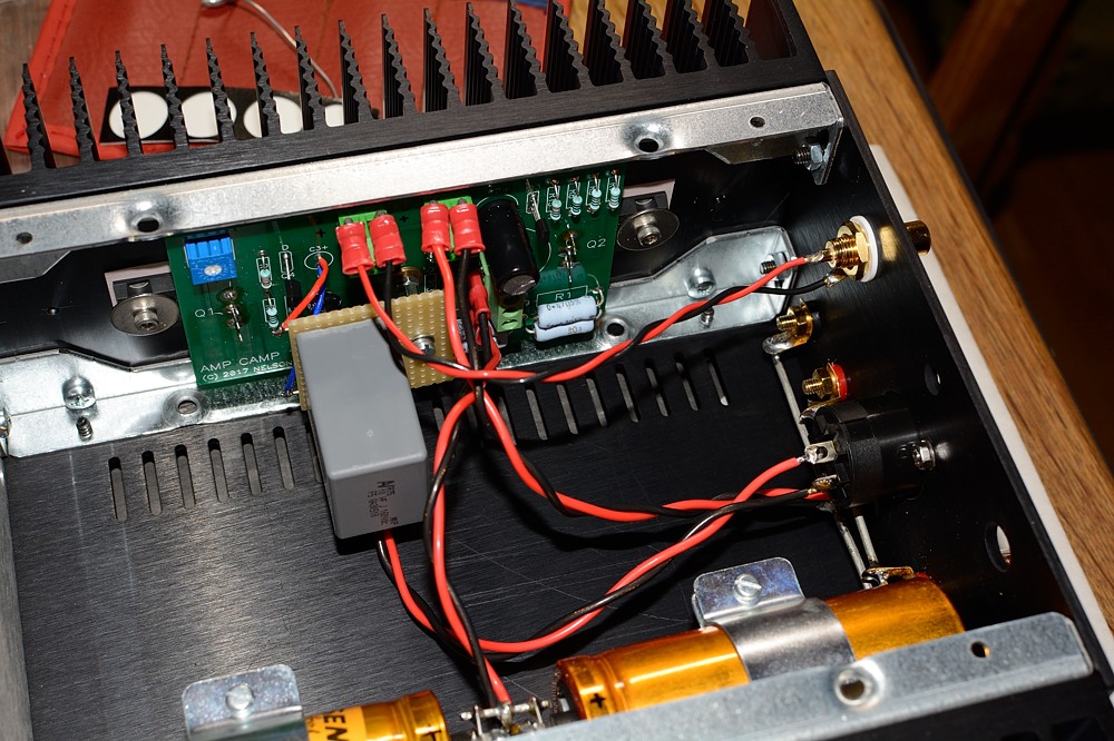

I have an 'implementation' question:
If you place the ON/OFF switch up front, you only need to take the +V cables to the front. The ground cable needs not 'travel' all the way up to the front and back. Yet, on the ACA 1.5 build guide, those two cables are twisted together.
I have read here (there, somewhere else?) that twisting some cables (not sure if V+ and GND, or if In+ and G, or Out + and Out -) may help reduce HUM.
So, first, which pair or pairs are better served by twisting them?
If the +V and GND, should I run a GND cable all the way up to the front for it to be twisted with the interrupted V+? Does it not matter at all?
Thanks for any feedback, best regards,
Rafa.
edit: Also, why should I double the cable width (twist two red cables) from the PSU to the Switch? Is this just to keep double cable impedance before the interruption and then single-cables interrupted V+? Hard to explain, hope it makes sense.

It is most critical to twist wires if you have AC but you will never have a perfect DC so it will always be the better solution to twist DC cables also. The double wires is if you feed both channels then you have same mm2 cables all the way. If you optimize for sound quality you don't implement such a switch. Then you just have your main power switch at the 230VAC side and make wiring inside the amp as simple as possible. I am very satisfied with my result. So something to look forward to......if you make a good implementation……
Twisting/switching both is probably advantageous...? But in my opinion not worth experimenting to find out.
When the next version guide is made, I'll likely only switch the +DC lead for simplicity's sake, and because it was completely fine on the original and 2nd versions.

Not yet. I'm working on it. 😀 The current guide will get you through 75% of the way, and look at post #5075 of the ACA thread for photos showing the biggest differences. The back panel wiring is a bit different is you use the front mounted power switch.
http://www.diyaudio.com/forums/pass-labs/215392-amp-camp-amp-aca-508.html#post5509597

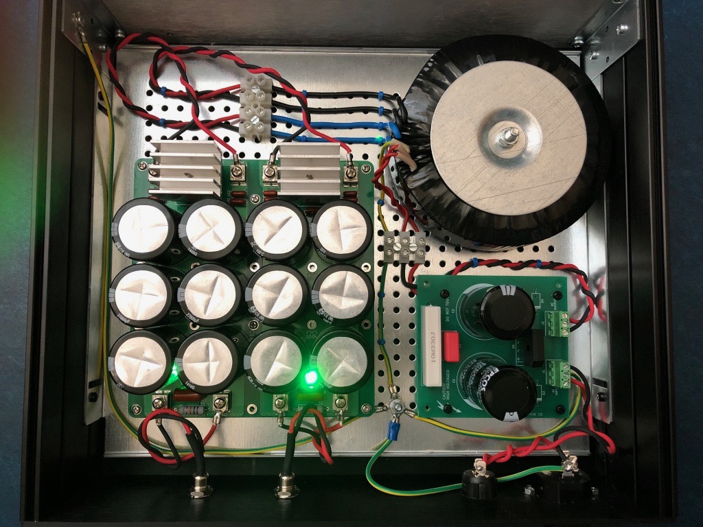

and while waiting for my ACA kits to be delivered... finished assembling(*) a dual rail 24v LPS 🙂
my very first "build" *ever*
(*) using ready-made parts: an Audiophonics' LPS board and an ATL DC blocker. Transformer is a Toroidy 300VA 230 -> x2 18v: Galaxy case by Hi-Fi 2000
Looks really nice! Congrats... I'm sure it makes for great practice in anticipation of the ACA Kits, and it will feed the ACA nicely (I think).

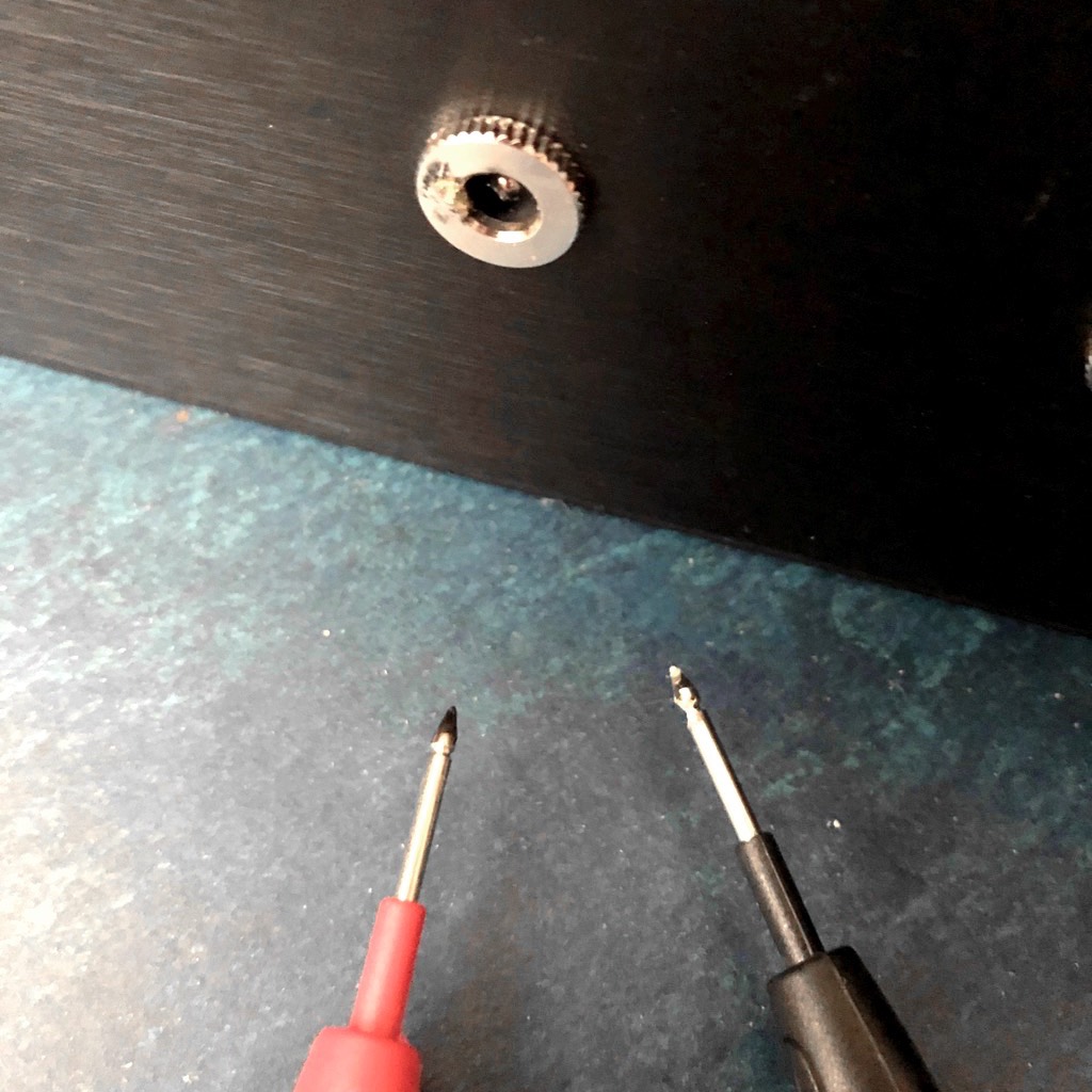

oh... and... while checking voltage at outputs... neg probe slipped and shorted on the + one: feckin' n00bs 🙄
all still working fine, though. just must buy new probes
I guess that's mostly why the ACA Kit is designed to work with an off-the-shelf SMPS, for newbies like us not to blow fuses, burn cables, melt probes or burn down the house! 😱 🙂
Put flex on the probe tips so it is only the outer tip (1 mm) that is visible. Then there will be less chance for shorts. Some probes has already that kind of protection from factory (removeable).
