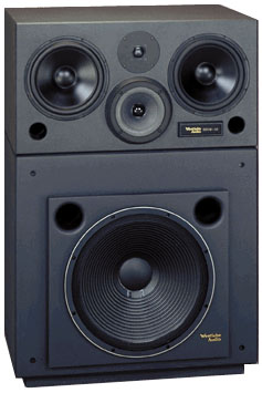

Another "will it work" question here from a noob🙂 I plan to tri-amp these 92db @1m/2.83V Westlake speakers. I'm not too worried about the mid/high channels. The sealed dual 10" woofers for mid bass (55hz-600hz) should be ok too. What worries me is the 18" TAD woofer (26hz-55hz) and its 3 Nominal/2 Minimum impedance. Thanks
Depends on volume desired.
I think you need a little more grunt. The 10” drivers may be okay. The 18” will require some dampening.
