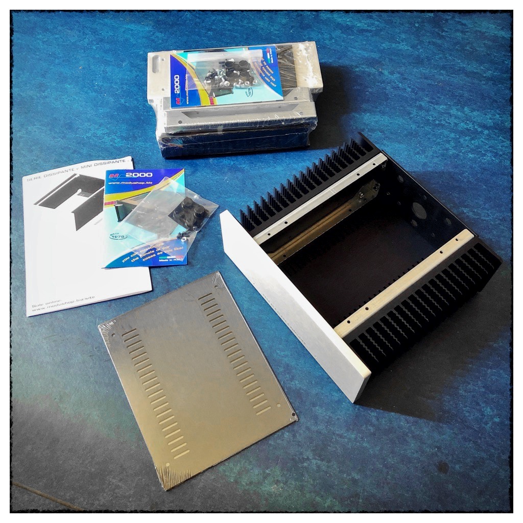

Received my Chassis kit today from Italy, perfectly packed and beautifully made - a very professional job, well done to all concerned for that masterpiece. All we need now is the parts kit from the store towards the end of July.
Thanks for the feedback Gary 🙂 Everything is on track for the parts kit on or before the advertised shipping date of July 31st. Updates here: Amp Camp Amp Kit V1.6 - Pre-Order Status Page – diyAudio Store
No problem Jason. I inspected all panels, no nicks, cuts, burrs or marks anywhere - all I have to do is keep them all like that till built and I will be happy.
Will be happy to receive the parts kit as soon as they are ready to ship out.
