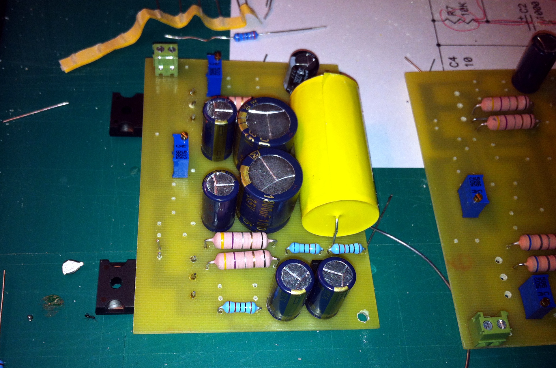

My homemade version of ACA. Single sided PCB, much easier to make that double sided.
PCB specs : 4inch x 2inch, FR4 2oz.
Up and running. Didn't have the 3W resistors so used some .22Ohm/5W to make up the required values.
Sounds awesome !! Absolutely no hiss/hum.
It looks great, and I really like etching one's own PCBs.
One thought, you might move the Rg closer to the FET. This is something I didn't do in my early PCBs and I've gone back and made the changes (jumper and Rg on the FET) to control parasitics.

and mine is up and running, for 22 hours now, no problems just beautiful beguiling sound . . .
I have to now finish the enclosure, but just enjoying the sound too much!! have an external PSU 120 VA toroid, 60 000 uf 20 volts!! I can keep my fingers on the heatsink for about 12 seconds or so!!

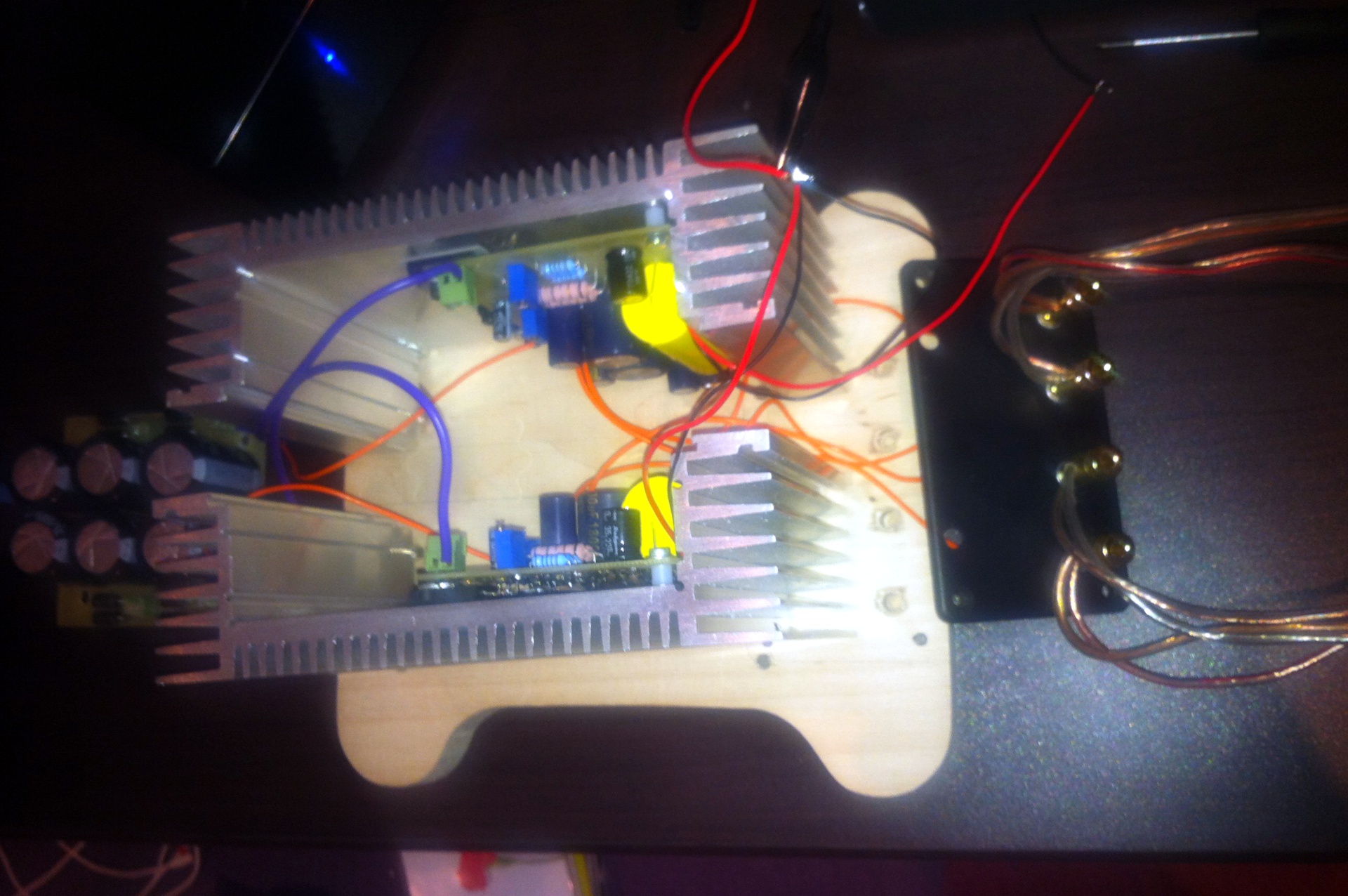

Finally got some time to work on my ACA 🙂
Cool! Where are the case and heatsinks from?
Thanks, buzz! Told ya, don't have spare couple 🙂 I would... will try it MOSFET first. This is just to keep my DIY muscles before some more serious stuff, you know ;-)
Actually, I have one! Is this just a direct drop in replacement? They won't be matched with the MOSFET at all...
Well, again I was saying more about transconductance 🙂 But in general you don't, I agree 🙂

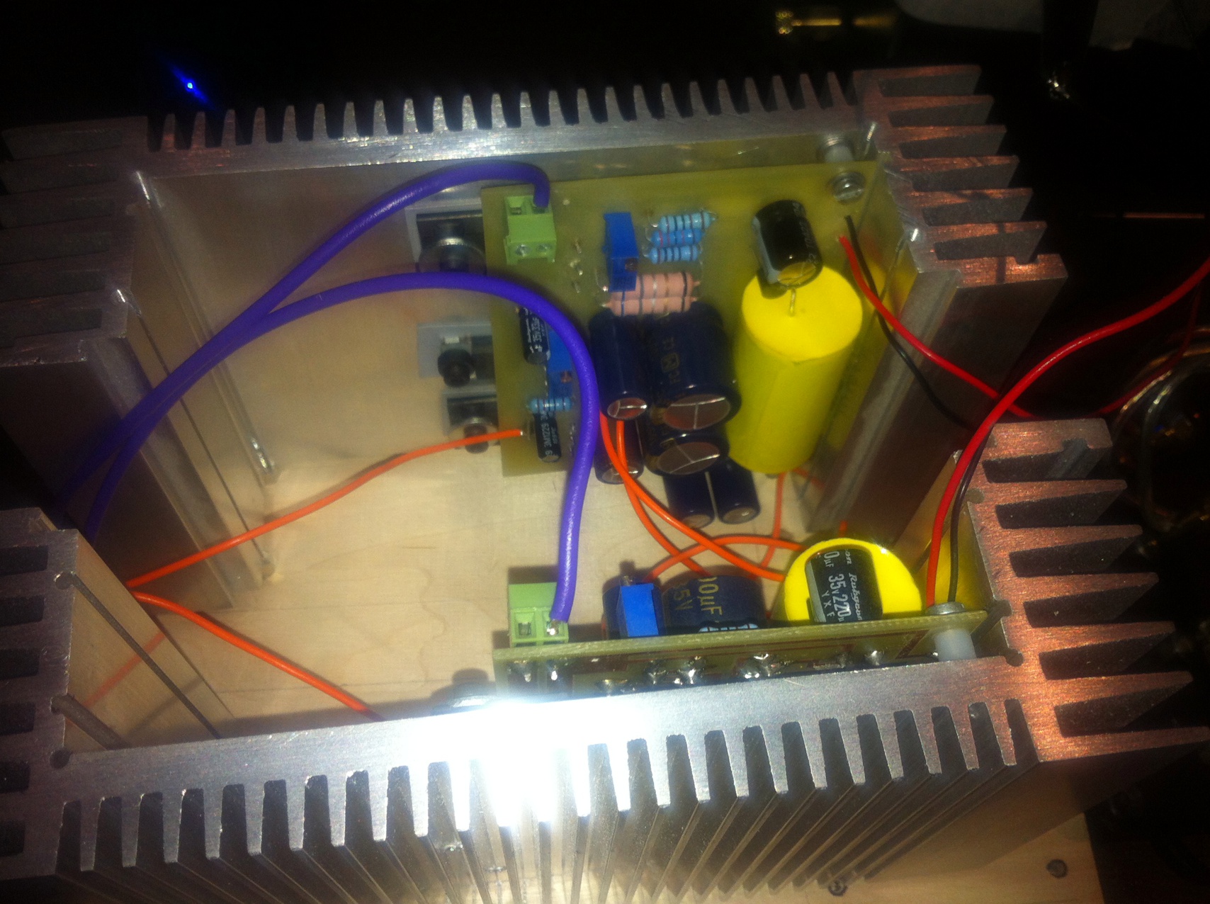

First auditioning! Such a nice amp! Actually I was surprised that I do not need any more power even in my main system! And my speakers are ~90db 🙂

finally i got my aca boards!
if anyone's interested in recycling: i took 2 old g4macminis trashed everything exept alucase and powersupply, gave the thing a new butt and crowned it with old alufins.
voilá
/Users/attilacsete/Desktop/AmpCampAmp/IMG_4856.jpg
/Users/attilacsete/Desktop/AmpCampAmp/IMG_4859.jpg
/Users/attilacsete/Desktop/AmpCampAmp/IMG_4861.jpg
voilá

Some more pictures of finished amp:
