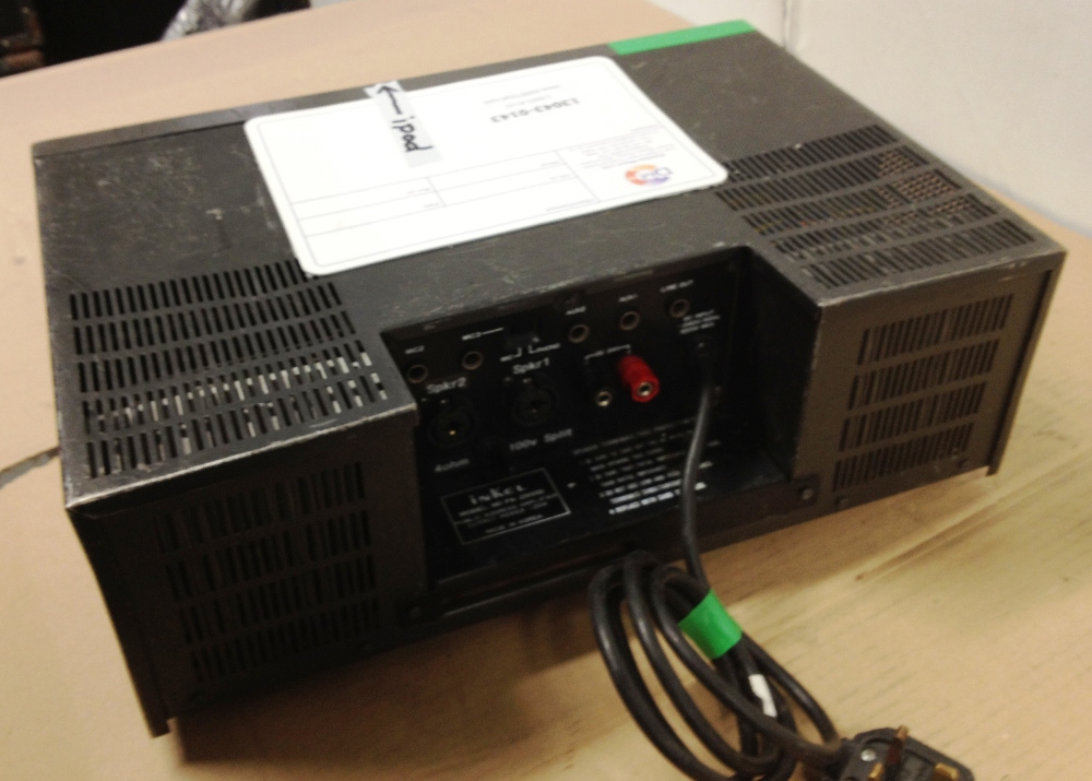

A while back a friend gave me a dead amp and it has a pair of heat sinks with the following dimensions:
H: 120mm
W: 110mm
D: 40mm
Base: 5mm
14 fins per sink.
Base thickness isn't much, but could be increased with a 10mm or so plate lapped / bolted to the sink.

If it gets too hot, increase 4 high power resistance(0.47 and 0.68) would be able to reduce operating current
They are likely just big enough. 🙂 🙂 🙂
Is this with an increase in base thickness?
Thanks for the tip Kivin, the lay-out of the case allows for the fitting of fans if needs be.
