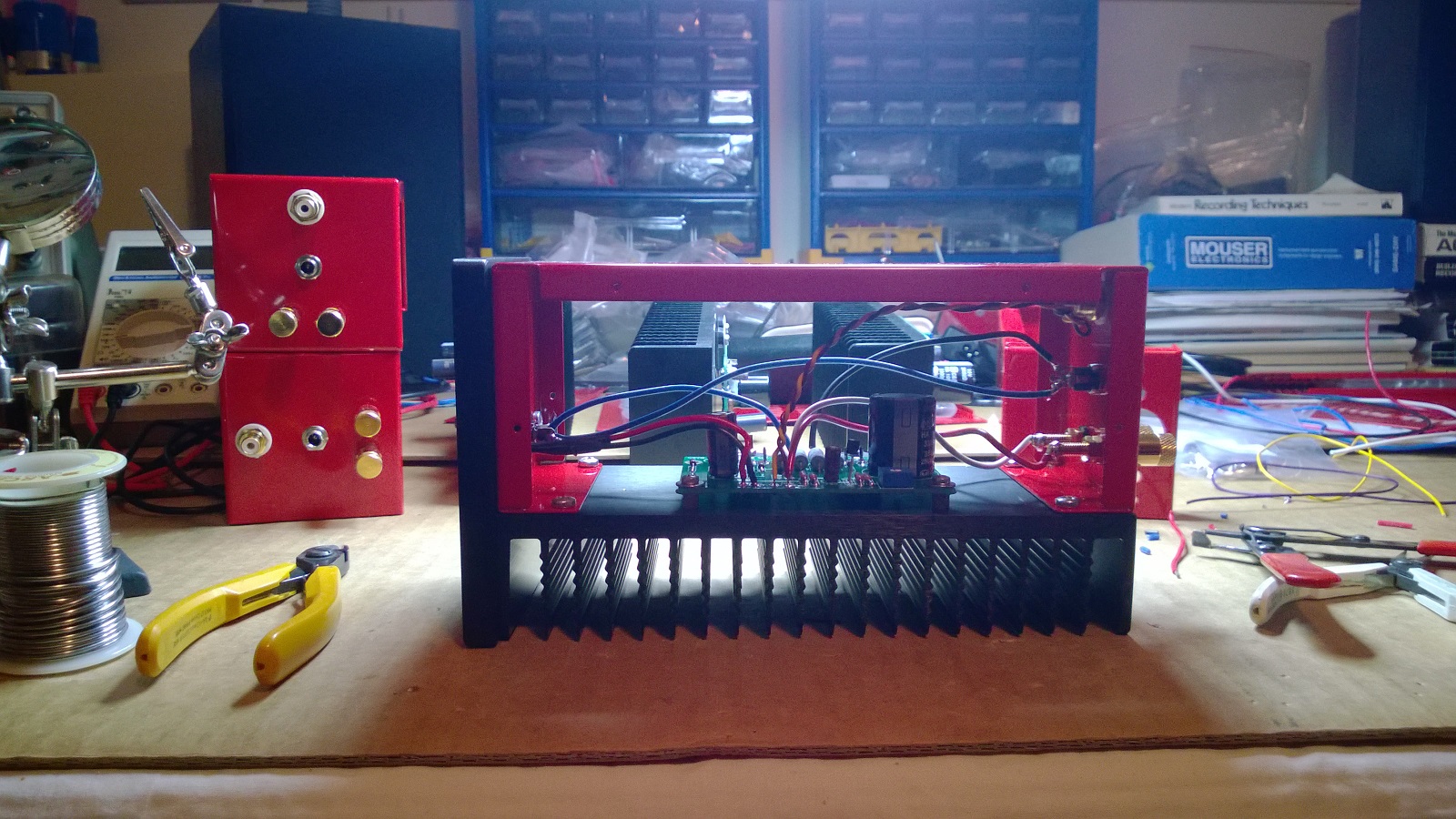

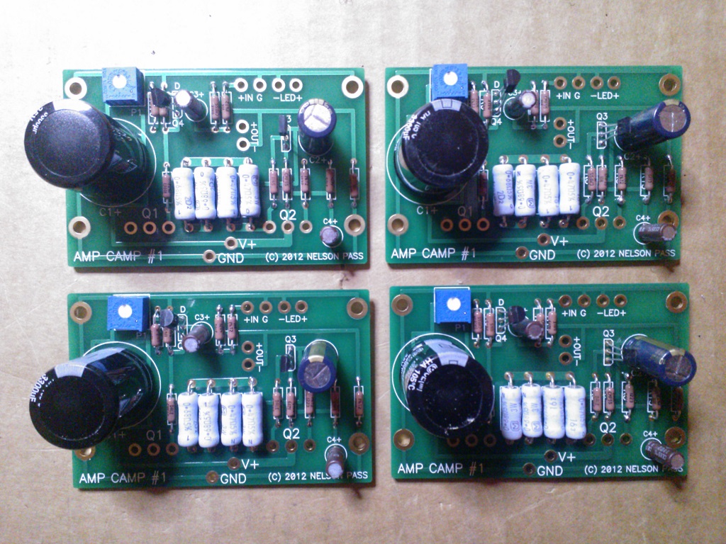

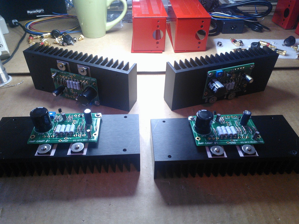

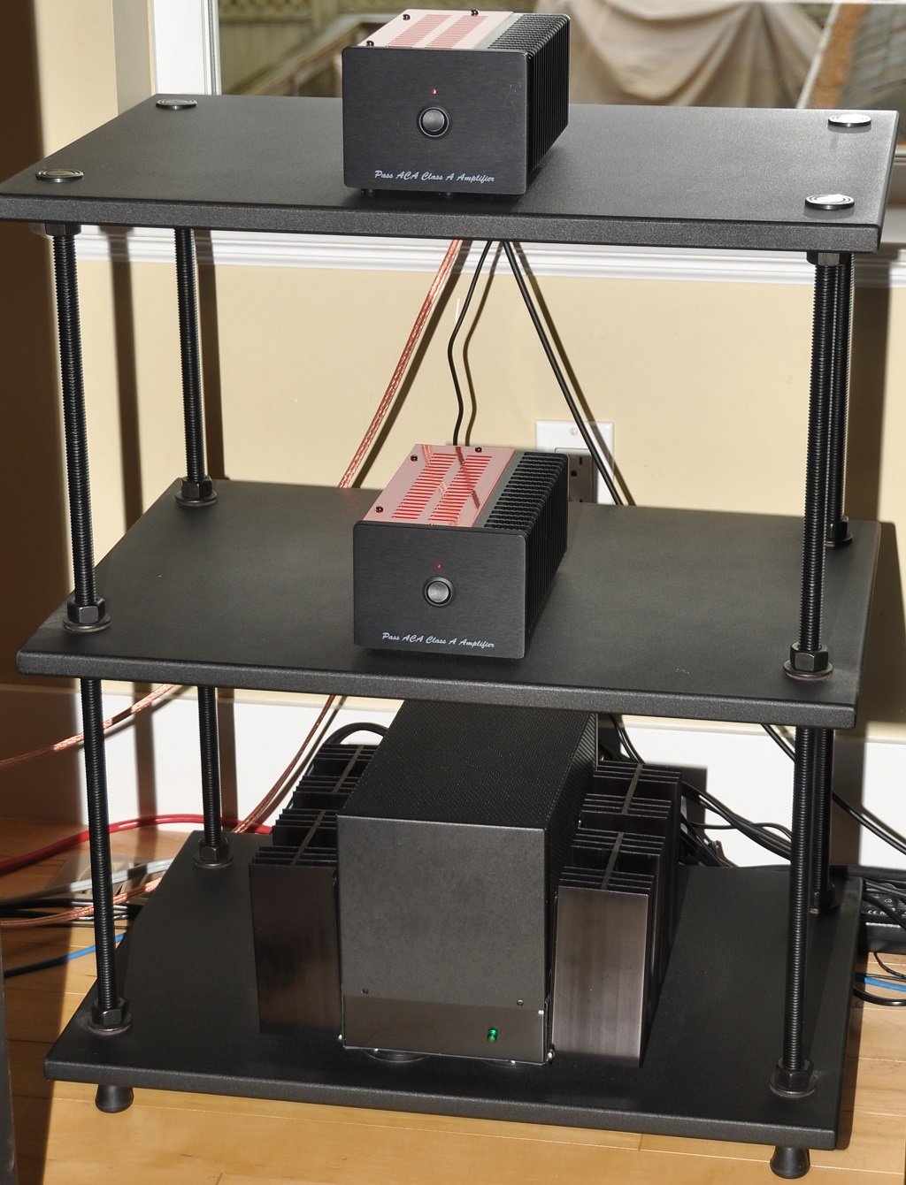

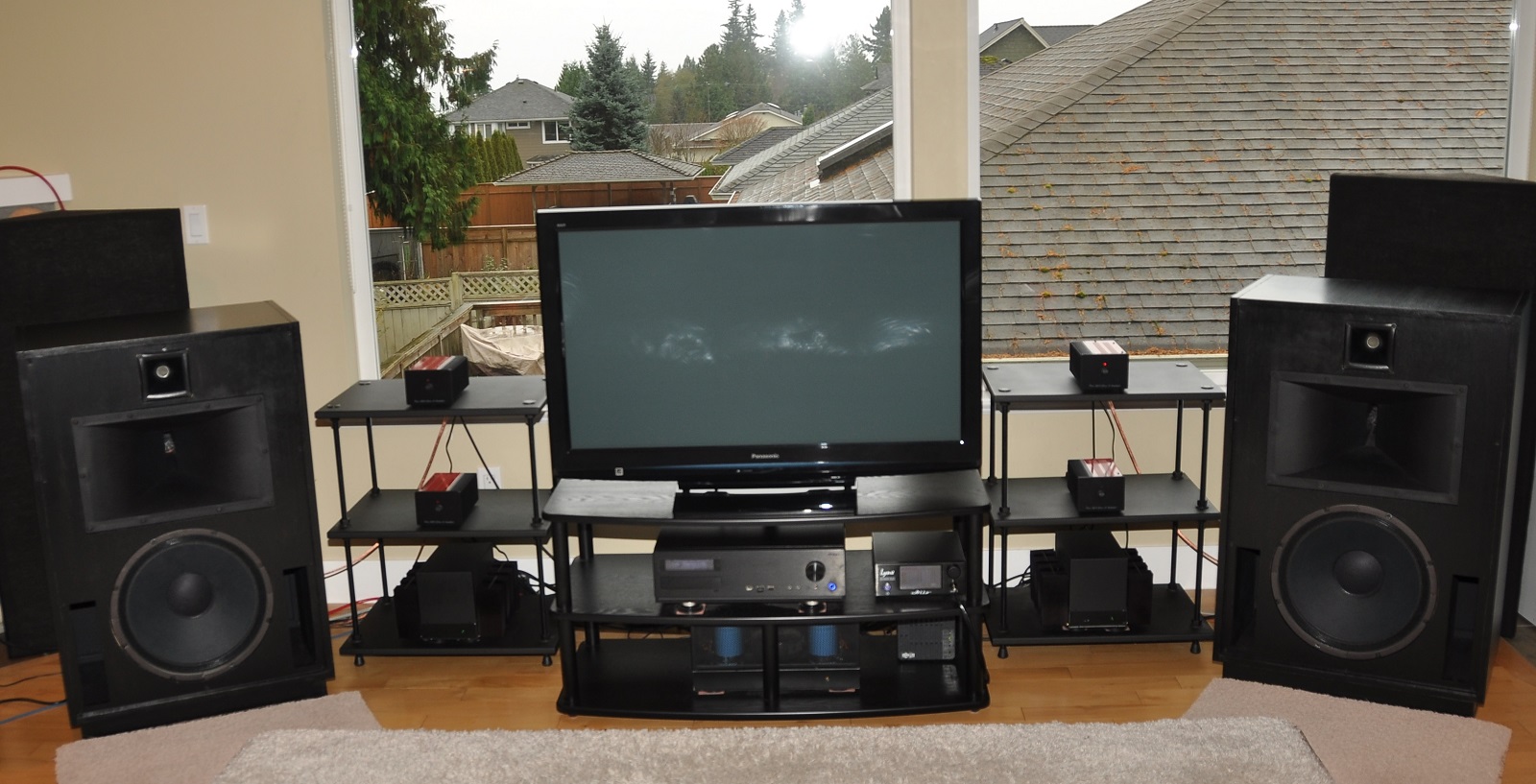

I built 4 ACA kits to drive midrange and treble compression driver/horn combos in a 3 way tri-amped stereo system using an A40 to drive the woofers. If interested in the details and not considered link spam: Advanced Acourate Digital XO Time Alignment Driver Linearization Walkthrough.

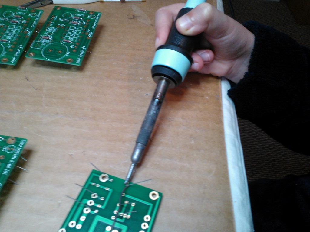

Attached are a few photos of the build and integration into the system. The white knuckles on the soldering iron belong to my 10 year old daughter who, after a quick first time tutorial on two wires, helped solder the boards. She could not believe it was liquid metal.
I have been listening for three weeks and in the last week incorporated the lets bake the amp mod. Highly recommended!
The magic combo of fast transient detail, yet liquid smooth delivery, really sets this amp apart in my opinion. For the price of the kit in the store, represents excellent value. They went together easily and I love the Ferrari red chassis!

Wow! Nice set up. And good on you in getting your kid to solder -- something very important to know later on in life.

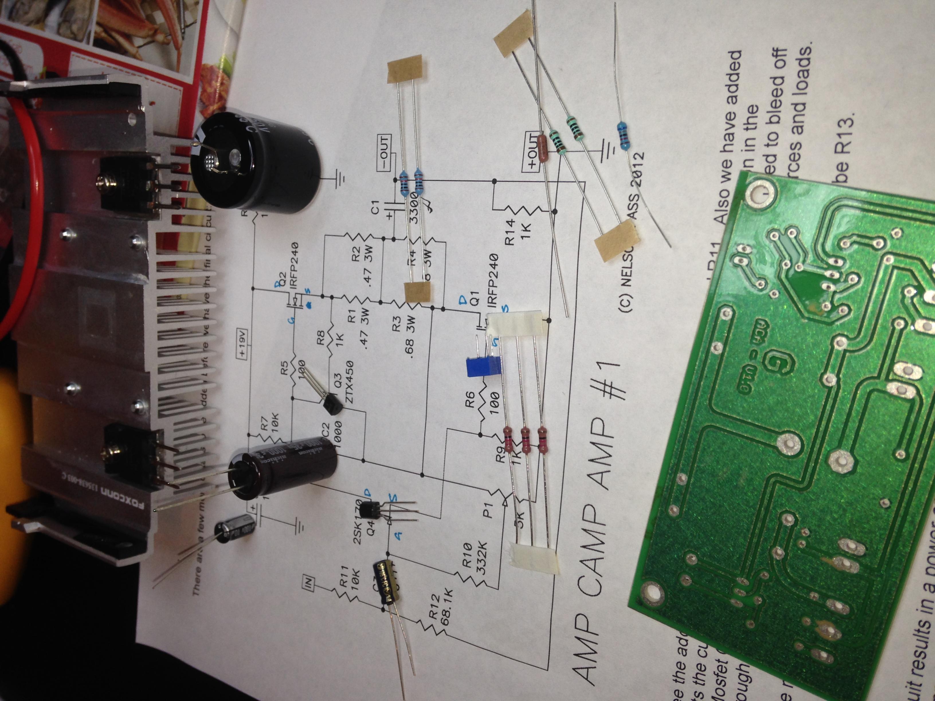

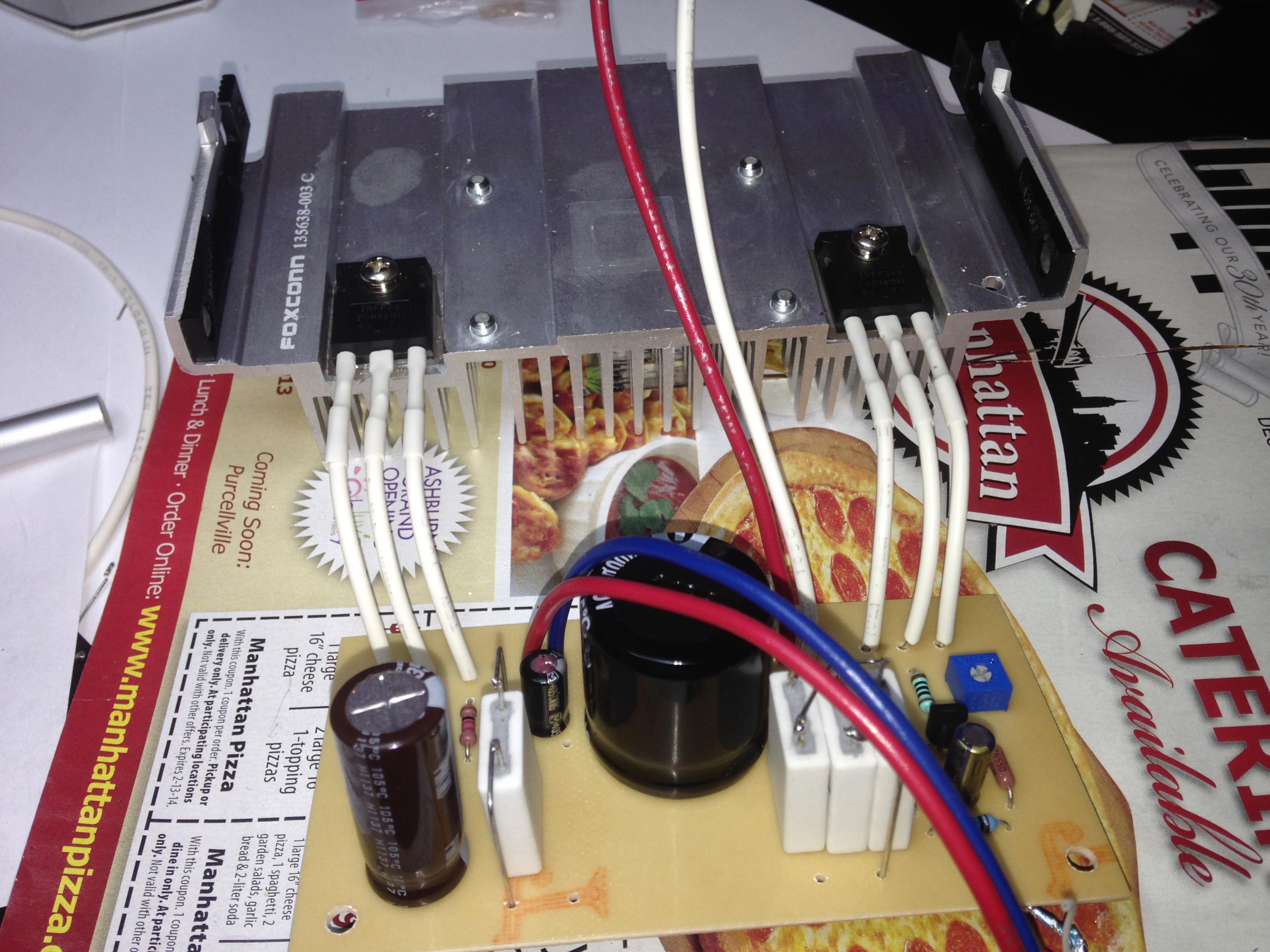

After many months and a needed second set of eyes to notice I wired the switch wrong, the first amp is finished!
Thanks Nelson for helping even us electronically challenged to build amps!

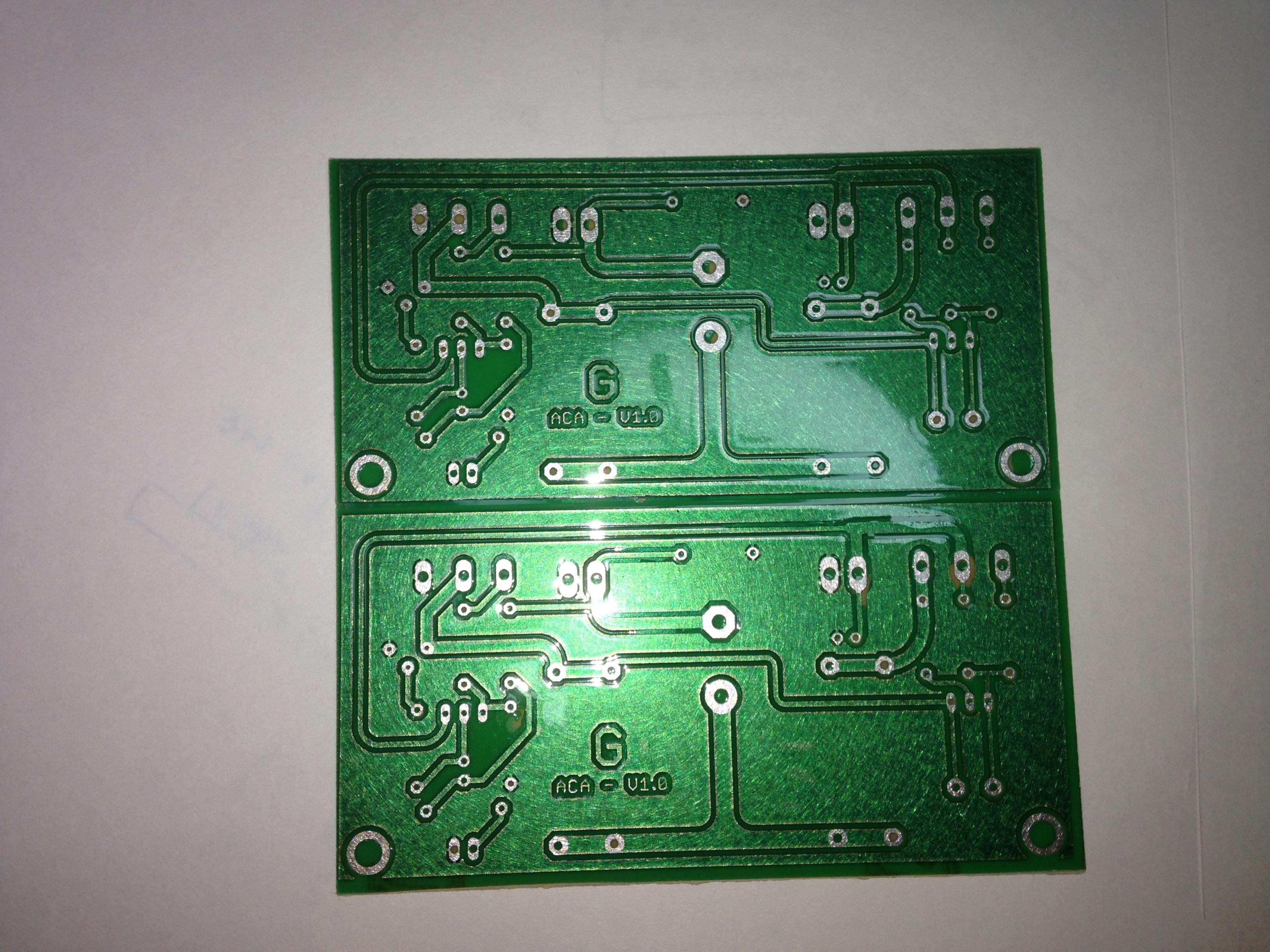

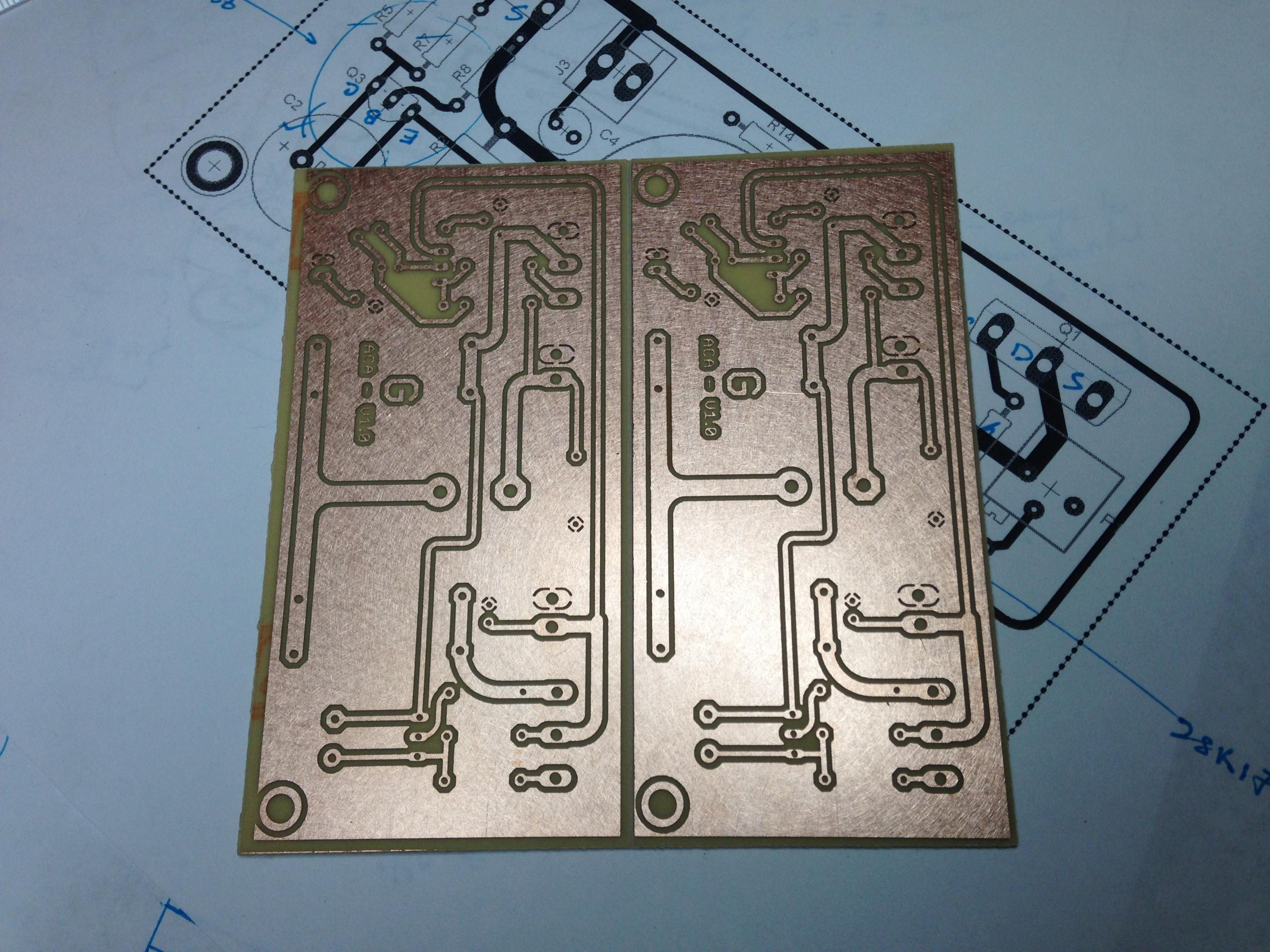

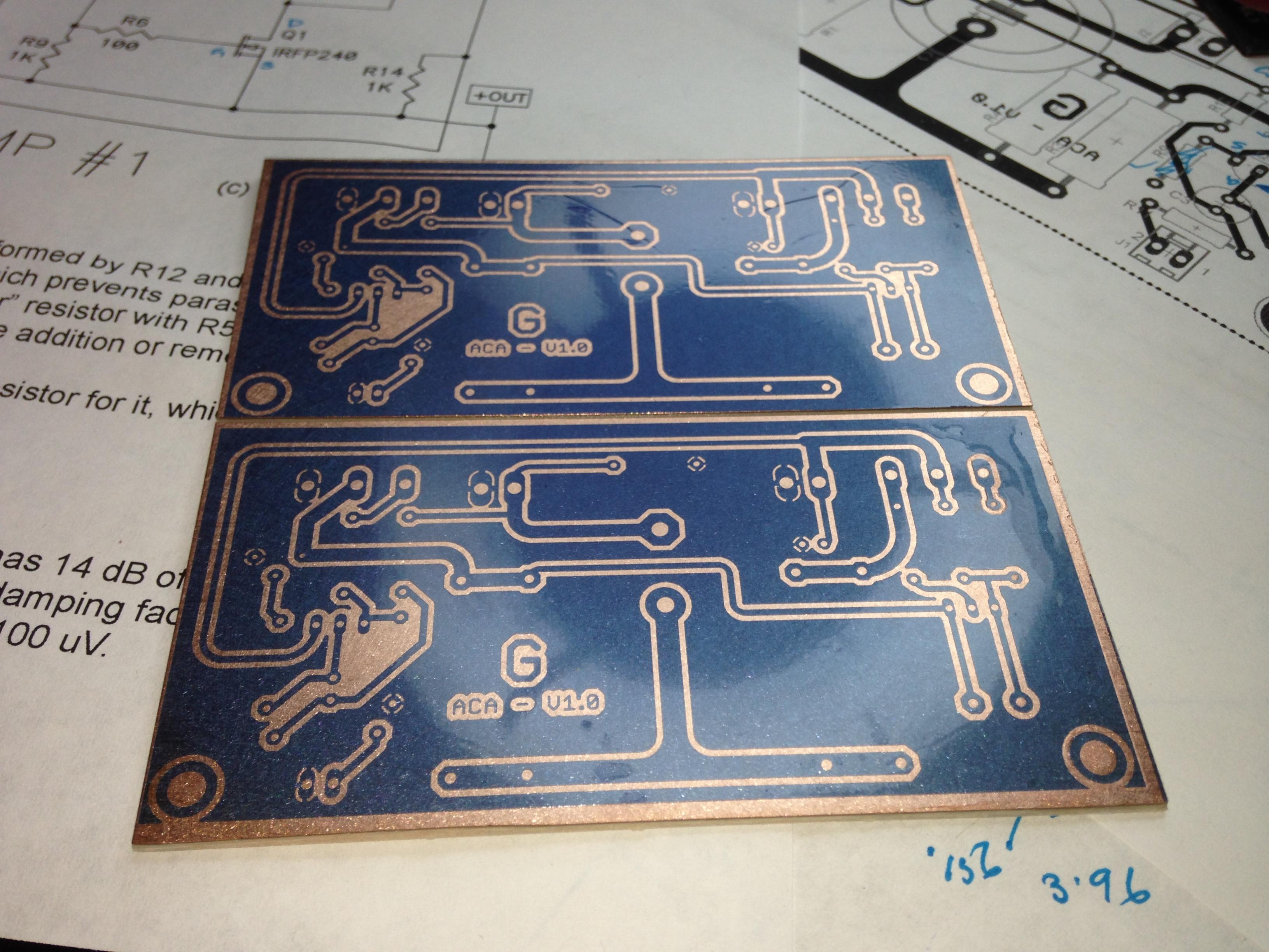

Homemade single sided ACA
My homemade version of ACA. Single sided PCB, much easier to make that double sided.
PCB specs : 4inch x 2inch, FR4 2oz.
PCB's with just the photo laminate on (before etching)
Etched PCBs
With solder mask and all holes drilled.
Getting the parts laid out.
Up and running. Didn't have the 3W resistors so used some .22Ohm/5W to make up the required values.
Sounds awesome !! Absolutely no hiss/hum.
