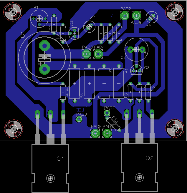

Thanks for PCB, but i prefer the already tested one in practice 😉
to Zen Mod:
The table below gives rough guidelines of how wide to make a trace to handle the current:
0.010" (0.254mm) 0.3 Amps
0.015" (0.381mm) 0.4 Amps
0.020" (0.508mm) 0.7 Amps
0.025" (0.635) 1.0 Amps
0.050" (1.27mm) 2.0 Amps
0.100" (2.54mm) 4.0 Amps
0.150" (3.809mm) 6.0 Amps
0.236" (6mm) out of range 🙂
And that is without soldering (covering) traces with solder.

just slightly
take a look at any of "approved" forum pcb's
in short - gate trace can be narrow
both drain and source traces must be at least 6mm wide
maybe this is better....
Hi Mindutis.
I didn't see your post before my last one.... thanks for the guideline.
but anyway... no trace thinner than 0.050" now. The amp sucks 2 amps @ max power. so this must be fine..

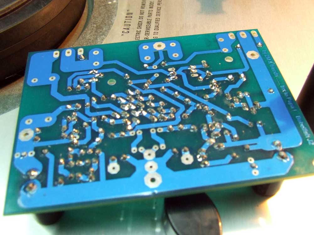

ya see some difference in approach , in enclosed pic ?

flotschi, the pcb looks much better now 😉 Are you gonna try it some time?
Hi mindutis,
I made some little corrections (c1 and R10 dont overlap anymore) and ordered the parts already....
tonight, i will etch a pcb for testing, and next week when the parts arrive i will test it.
