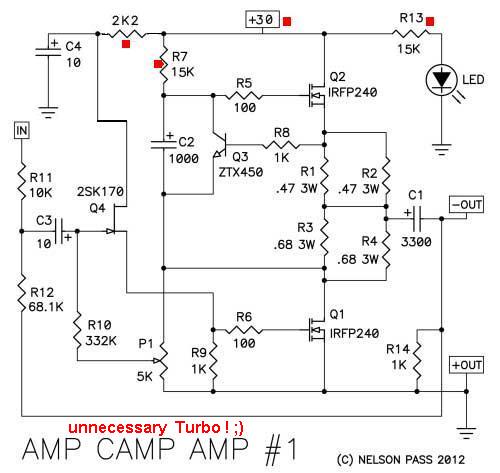

As far as the discrepancy between the Schematics and the PCB here's Papa Pass'
statement:
"As Choky sez, no issue"

What would be the maximum usable supply voltage for the Amp? It looks like the 2SK170 have more ore less the complete supplyvoltage and are the limit...
I have a nice supply that deliveres close to 30V, would it be ok, provided the caps are 35V or higher and heatsink is larger...?

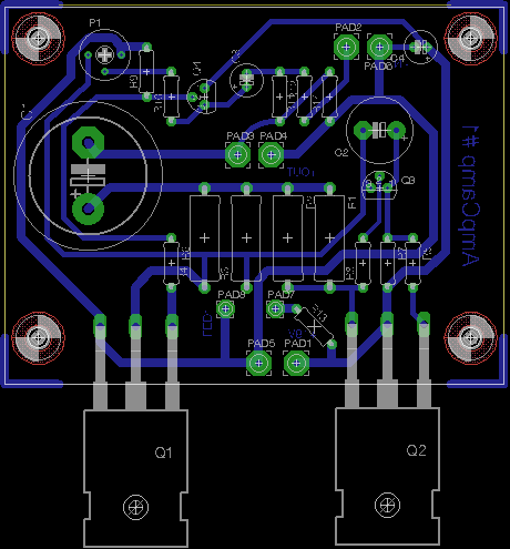

Despite the fact that there will be pcbs in the store, has anyone routed a one-sided pcb?
I would like to etch them myself.

changes in red
are you sure it will work .......... ?

is this a one-sided or two-sided layout?

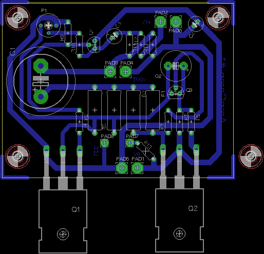

Awesome, i am getting a heatsink today, hopefully. And i am on the line for PCBs, but if its single sided, etching myself is a good option too.
Here you go for self etching....
single sided ; no wire brigde....
public name of pcb is "land of many fuses"
several important traces are to tiny
thank your for your feedback!
is this better?
just slightly
take a look at any of "approved" forum pcb's
in short - gate trace can be narrow
both drain and source traces must be at least 6mm wide
