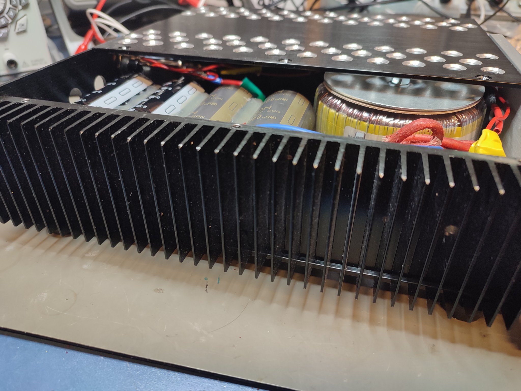

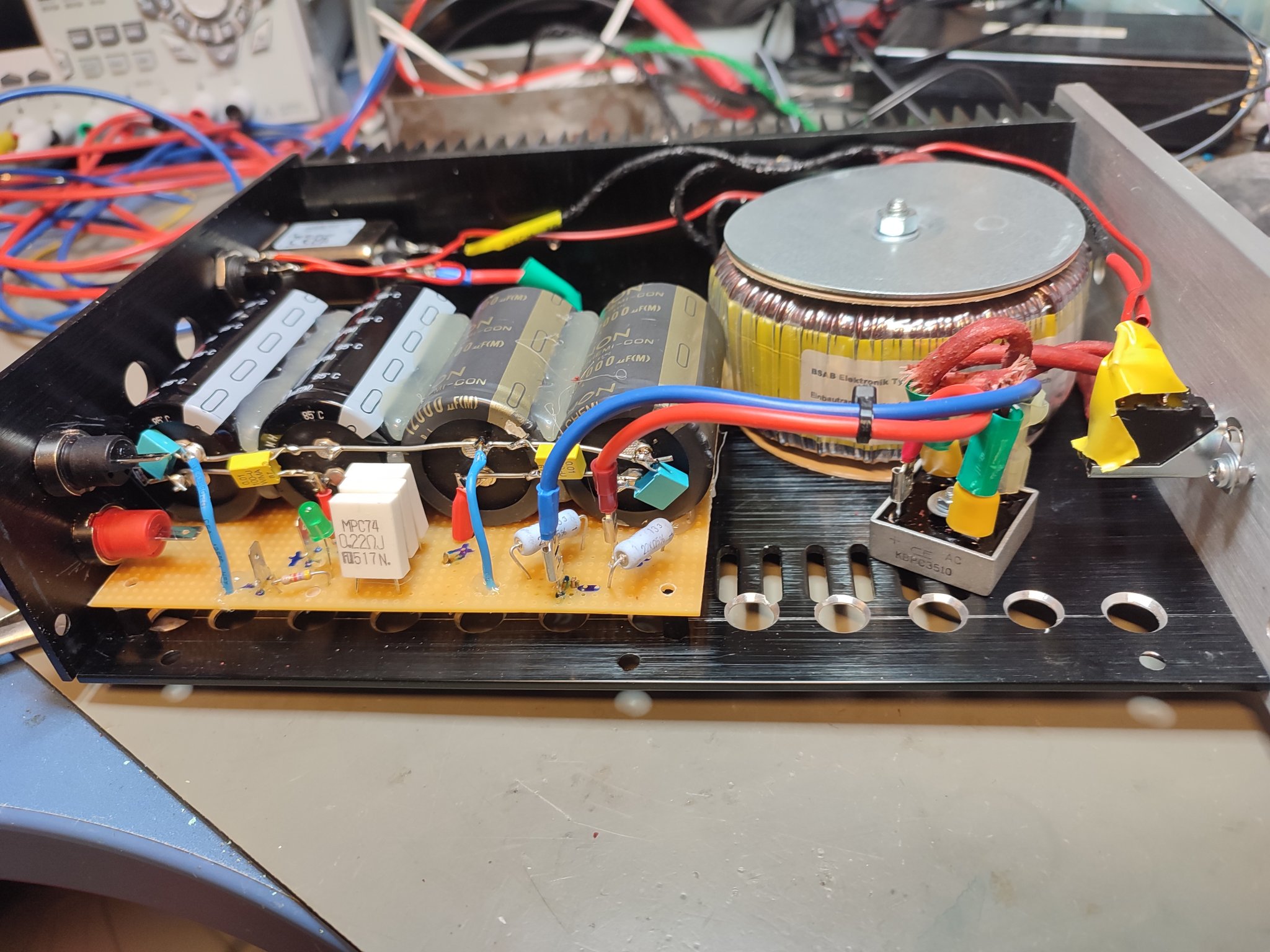

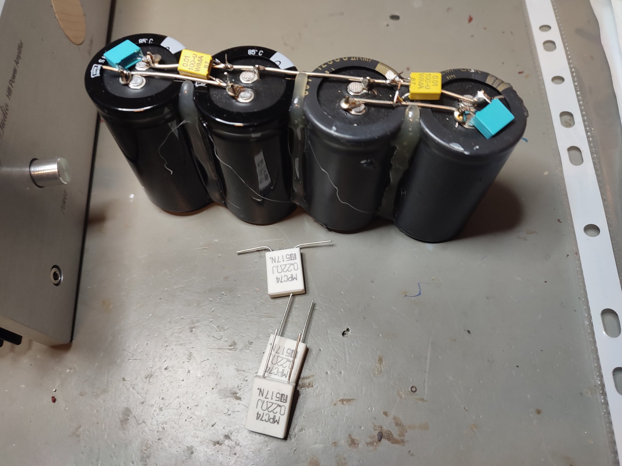

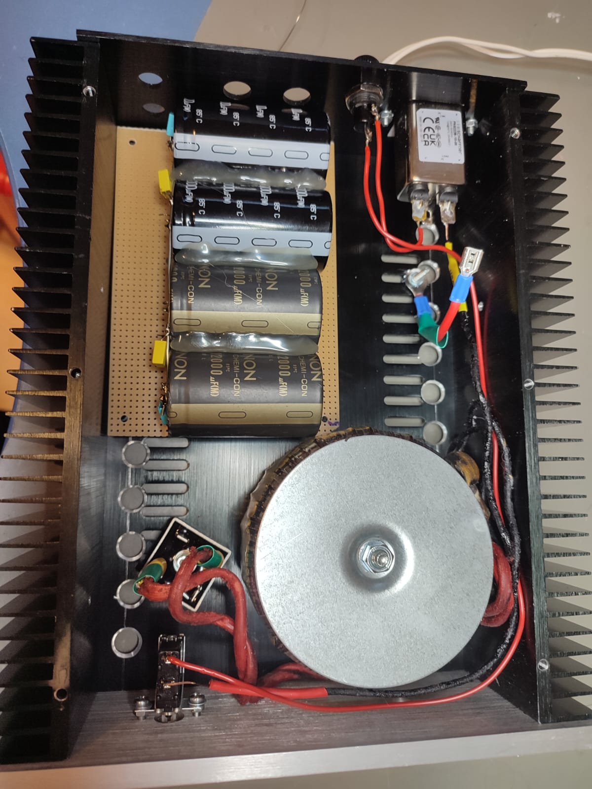

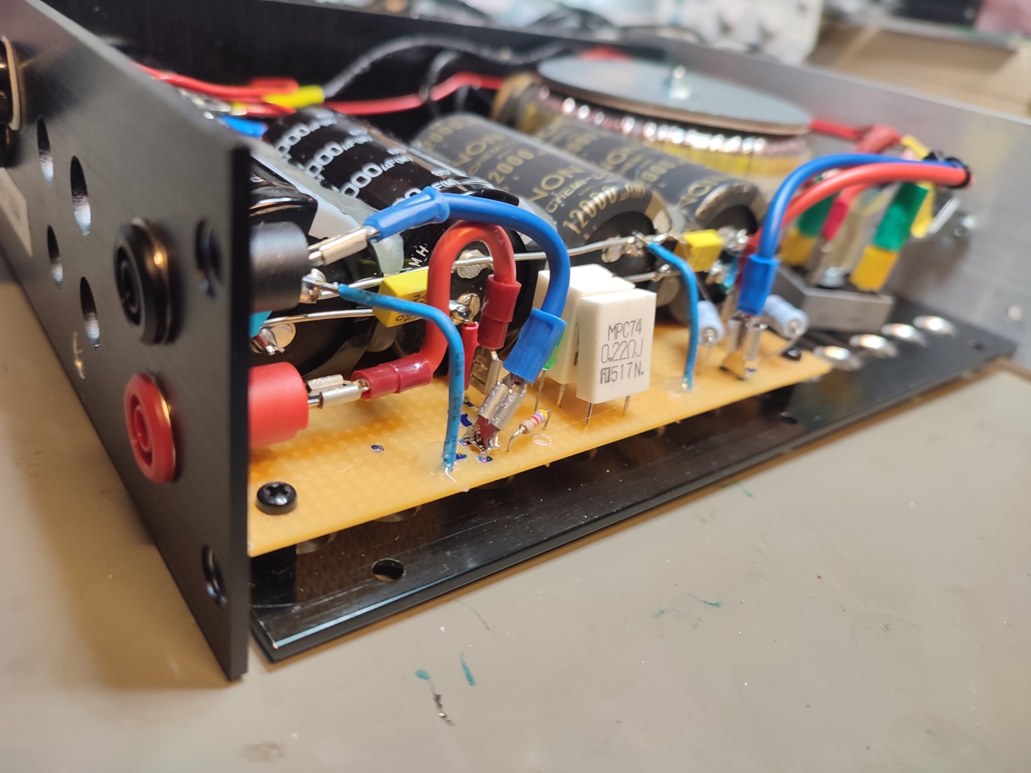

in post 11916 i implement the ACA amp boards in a Apple G3.
here:
now the empty ACA housing (very small- just 60mm high) has to be a linear power supply with the given Trafo 160VA 18VAC one Winding with 8,88A.
CRC and caps what i got and have.
trafo- rectifier - CRC (on board, changeable) - output
CRC 2x12mF / 3x0,22R / 2x33mF
2x 22k Bleeder resistor and a green led
no load 24,61Volts
under load with 5 amps --> 20,80Volt
holly *%§"§ it is very small and compact..never did this before😳

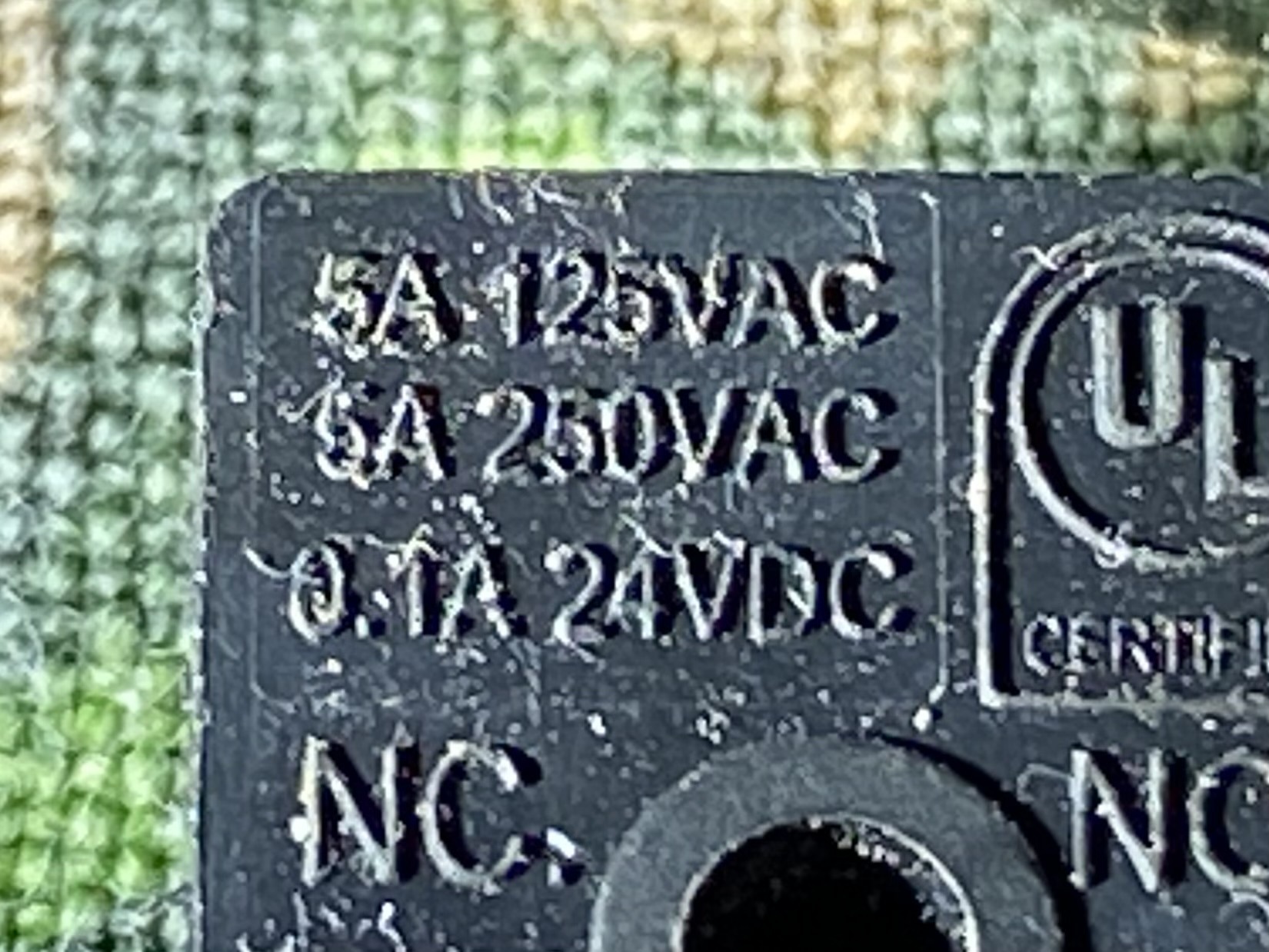

Hi, I'm looking for advice on a replacement switch for this kit. I understand that the original switch is rated: 6A @ 125 VAC, 3A @ 250 VAC. How important is it to keep to those values? Would a rated 3A @ 250 VAC/5A @ 125VAC work fine too? Sorry if this is a stupid question.
The micro switch I'm using for my latest ACA build is rated for 6A @ 125VAC, 5A @ 250VAC, but only 0.1A @ 24VDC. A toggle switch or rocker switch will be more robust than a micro switch, but you might want to check your switch's DCV rating.
How can this be? I mean, is there an electrical explantation for a switch being rated like many Watts (Volt times Ampere) in AC, but very lowly in DC?rated for 6A @ 125VAC, 5A @ 250VAC, but only 0.1A @ 24VDC
Upon closer inspection it looks like 5/5/.1 . It does seem strange, but there it is. My only guess is that the switch relies on relatively light spring tension to make and break contact, and there is a greater propensity to arc/fuse with DC current than with AC. But a factor of 50 does seem extreme. Even with the 5A rating, I wouldn't be comfortable using this switch for mains voltage. I'm using ut to activate a 24V relay.
https://www.mouser.com/blog/which-switch-who-cares-if-its-ac-or-dcHow can this be? I mean, is there an electrical explantation for a switch being rated like many Watts (Volt times Ampere) in AC, but very lowly in DC?
Thanks to you…In the future, the next time you wonder whether the difference between the AC and DC rating on a switch really matters, you can positively say yes and you’ll know why!
