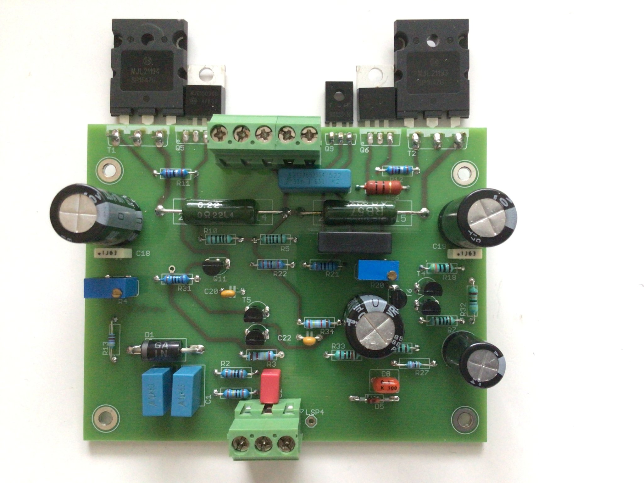

I have attached pictures of my assembly. You will immediatel note that the parts soldered to the board are elevated off the board. After watching many youtube videos of the build a couple recomended doing that. I have no idea why or even if it is a valid idea.
I am open criticism and suggestions.
Easy one first. Lifting parts is often done for ventilation around the part. Apart from the power FET's the ACA runs cold but what you have done will cause no problems at all.

The soldering on the FET's looks a bit flaky tbh :) Use a hot iron with a decent sized tip and apply solder and the iron together to make a large clean shiny joint. If I was building an ACAS I would solder both sides of the board. If the iron is hot and a good size you need only a couple of seconds per joint. Any more can overheat the parts.

A floating (not well soldered) gate pin on a FET could cause a drifting voltage.
Reactions: 1 users
I have moved forward with a little success. I re-soldered all points with a much larger blunt solder tip. Thanks for bringing that up. I had been using a sharp small tip thinking that the close quarters would require. It makes sense that a large tip maintains more heat as the joint heats up.

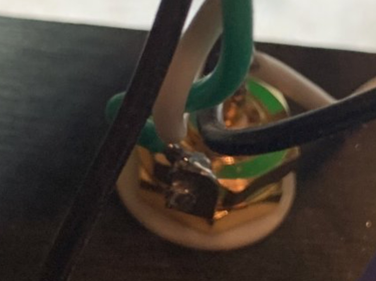

Anyway, all the tests were much better. Adjusting the DC balance went good. Indicating 12V with virtual no drift that I had seen before. The other 3 checks were as specified which wasn't the case before. The last note, input socket center pin continuity to one end of R11, with the meter set to 200k, the right channel reads 0 while the left reads 36 on one side of R11 and 52 on the other side
That is to say it appears that you have R11 connected with the green wire to the ground or shield side of the jack.. may be an optical illusion. And that would mean the white lead is on the center conductor. AKA the look to be reversed.

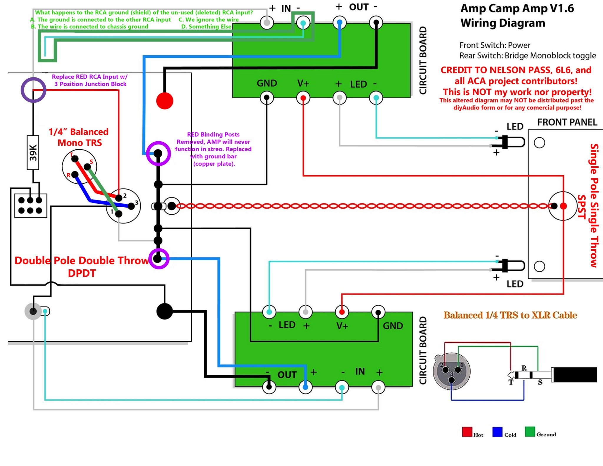

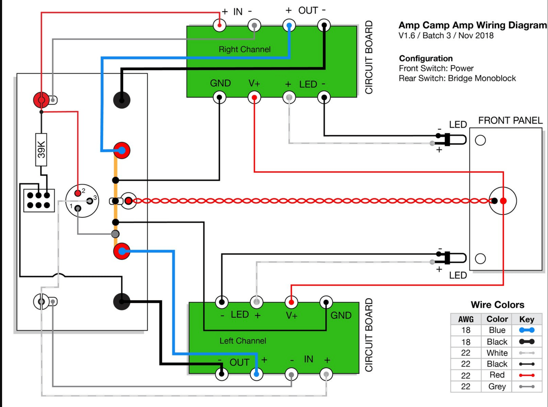

Hello everyone! :) I'm building two ACA monoblocks with a friend. The goal is to have a single-ended input (white/black RCA jack per build guide), XLR as standard, AND balanced mono TRS spliced into the XLR on the back panel (per his request, I've informed him I don't think it will work as he intends but he is insistent, and I am curious).
To accomplish this, I've done three things:
1. REMOVED the red RCA jack, replacing it with a 3-position junction block.
2. REMOVED both red binding posts, as the amplifier will never function in stereo operation. Instead, a ground bus links all previous connections together (I replaced one [1] black binding post with a red binding post in my modified wiring diagram)
3. ADDED a TRS jack with the pin-out in the bottom right of the diagram. T=> pin 2 ; R=> pin 3; S=> pin 1

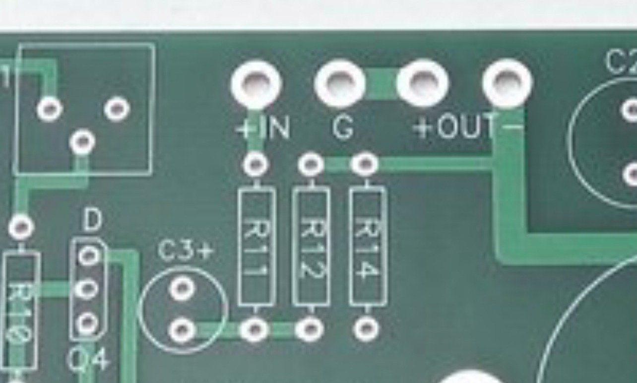

However, I have a problem with my Schematic; what happens with the RED (now deleted) RCA shield wire coming from the negative input of that amplifier board? I have made a big green box around this wire in my Schematic, with Jeopardy-style questions above it :LOL:
Do we:
A. Split the shield wire of our single-ended input to both amplifier boards
B. Connect the negative input of one board to the power supply ground
C. Ignore it. Pretend it never happened, never install one. And move on
D. Something Else?
Please point out any flaws you see or questions you have! All help and advice is appreciated!
(Following v1.6 Schematic as I prefer two-position rear switch DOWN=XLR; UP=SINGLE-ENDED MONO. Open to any recommendations on switches)
Purple circles represent deleted connectors, instead junctions are used.

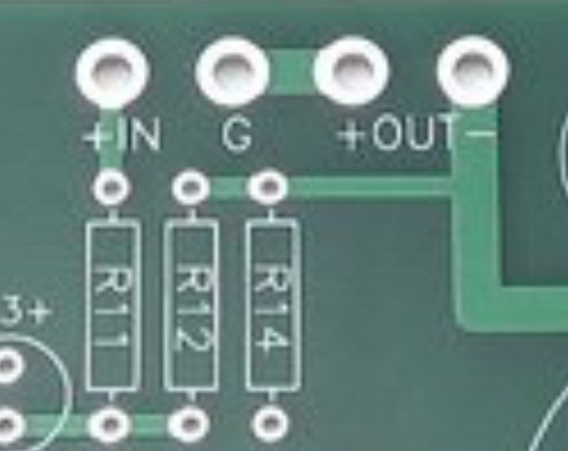

At circuit board, note the (+ out) and G (your wire in question) are parallel. If you measure the dangling wire right now to your ground bus. You’ll find it is already connected to the ground bus. But keep the pair twisted to your new connection: and connect the lead you took off to the bus as close to the new connection as you can to aid with noise cancellation.
