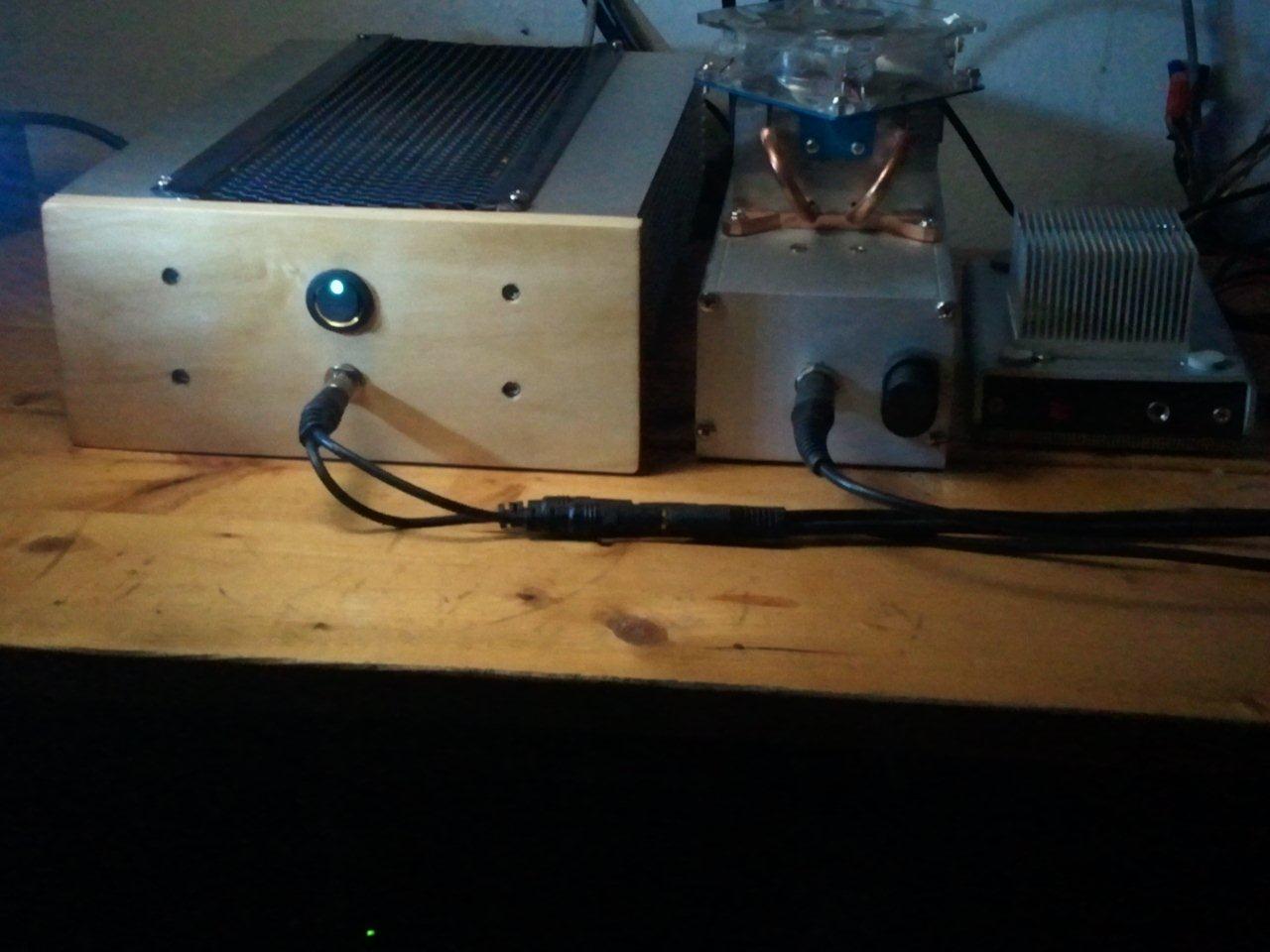

I wasn't much liking forced air cooling, it is always a good cooling option. One of the designs I had in mind was making a dual heat sink fins inward bolted with two flat plates into a square tunnel and a quiet fan running half speed pulling air from front to back.
It isn't the quietest option, but it makes the footprint smaller and forced cooling is efficient.

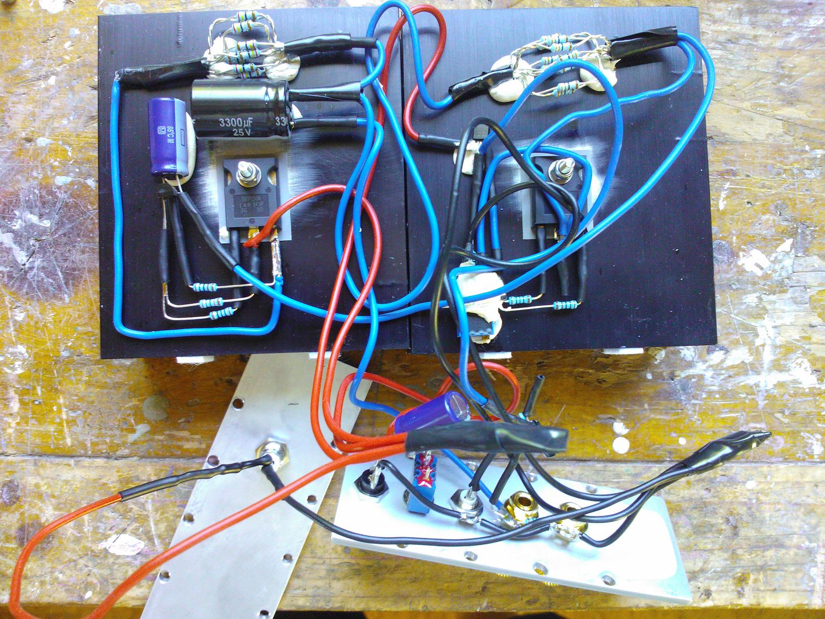

ps IRF520
ps IRF520
Nichoch not sure what you are asking but will try...
First off I want to state that my join date here was before I made a cmoy or anything else...
( don't just go by what i say🙂 many others here do know what they are doing....
The ACA works great, I have made 5 so far, it is my main headphone amp. The F5 does sound better but do not
like leaving it on all day or using that much power... am working on a smaller F5 with IRF520/9520's
With the speakers I have tried,,, Warfedale The F5 is leaps and bounds better.....
I have Fostex orthodynamic headphones rated at 3 watts....they need some power. So this amp seemed right to me.
the positive outputs are common with power supply ground and each other--- so tie them together not the negative outputs.....for normally wired headphone jacks.
Loudthud has done a lot with other mosfets here and recomended I try the IRF520... So that is what is in the little one on right.. it works well even on 12v but I plan to try higher voltages and raise the bias a bit....to find the sweet spot..

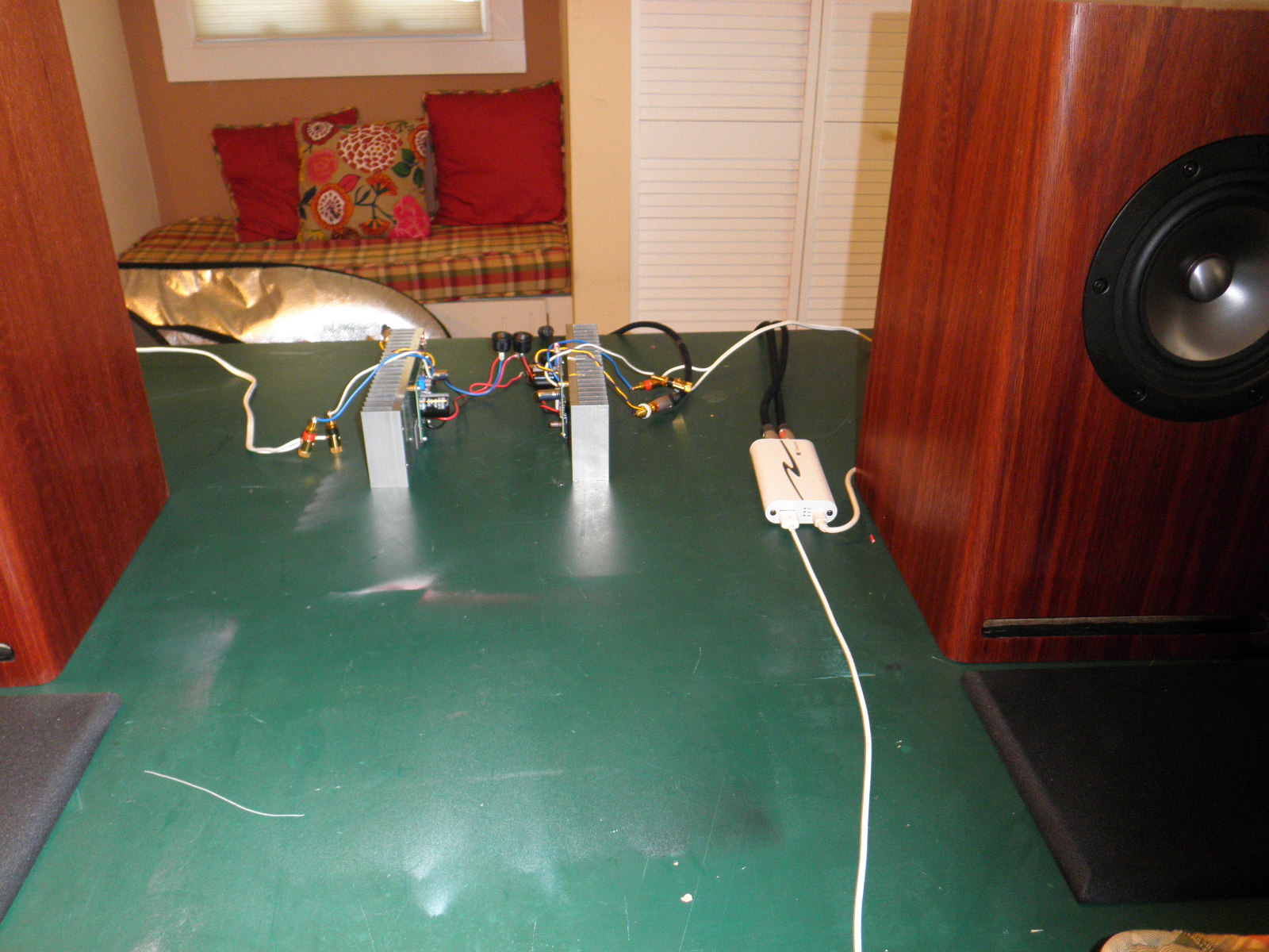

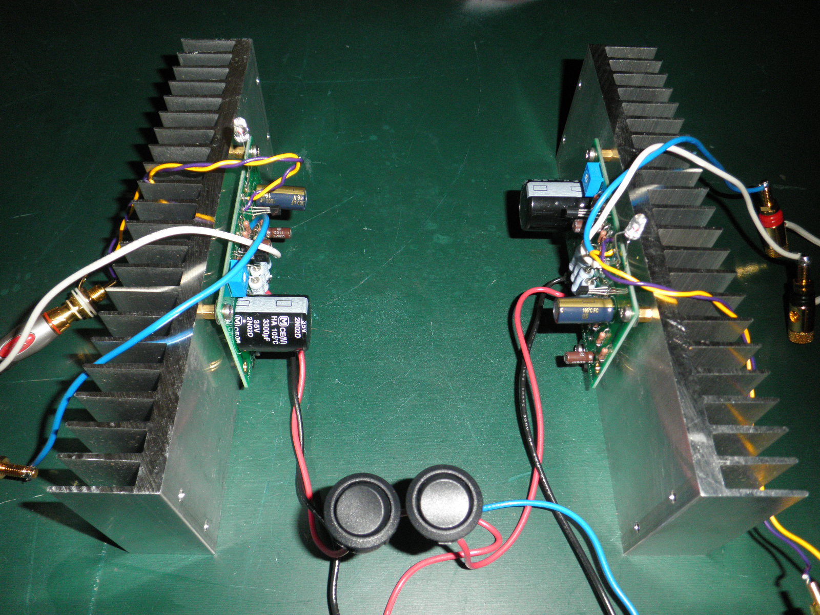

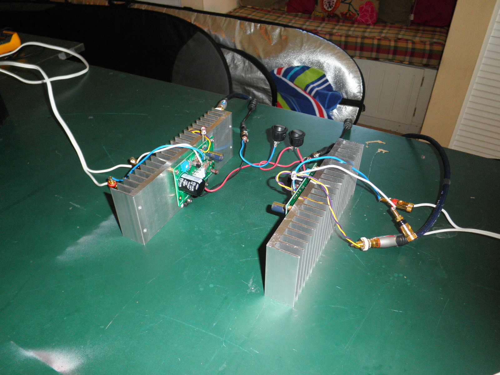

...just assembled AmpCampAmps last night. Thanks to NP, NBrock, Jason and fellow DIYers for design, papers, photo-instructions, kit and chassis ideas.....all superb! They are very easy to build, great sounding and quiet as a church mouse.
I'll finish a bloodwood chassis by the end of the summer and post finished photos then. For now, the amps and a plank of wood....

Mario - what speakers are we seeing your your photos above? They look like full-range. I'm looking for a very nice pair of full range speakers to go with an F4 or F5 with a DCB1 build. I'm thinking about Fostex 8", Mark Audio, TangBand 8", or Audio Nirvana. I haven't decided yet...

Those are MarkAudio Alpair 10.2 in a TwinsAudio cab that I re-finished with veneer. They sound very nicely detailed with plenty of low end....especially so with the ACA. Madisound will soon carry the new MA A10.3 as well as a new A10P FYI.
The real surprise came when I first powered-up the amp after assembly. On advise, I hooked up some basic cheap Pioneer 2-way (SP-BS41-LR) as they're very robust and probably can't be blown up by most any amp. The combination was incredible for what these speakers are.....the best I've ever heard them.
But for detailed listening, its the MAs hands down. I think, depending upon your listening preferences, that you really can't go wrong with either the Alpairs or the less expensive CHR's from MA.

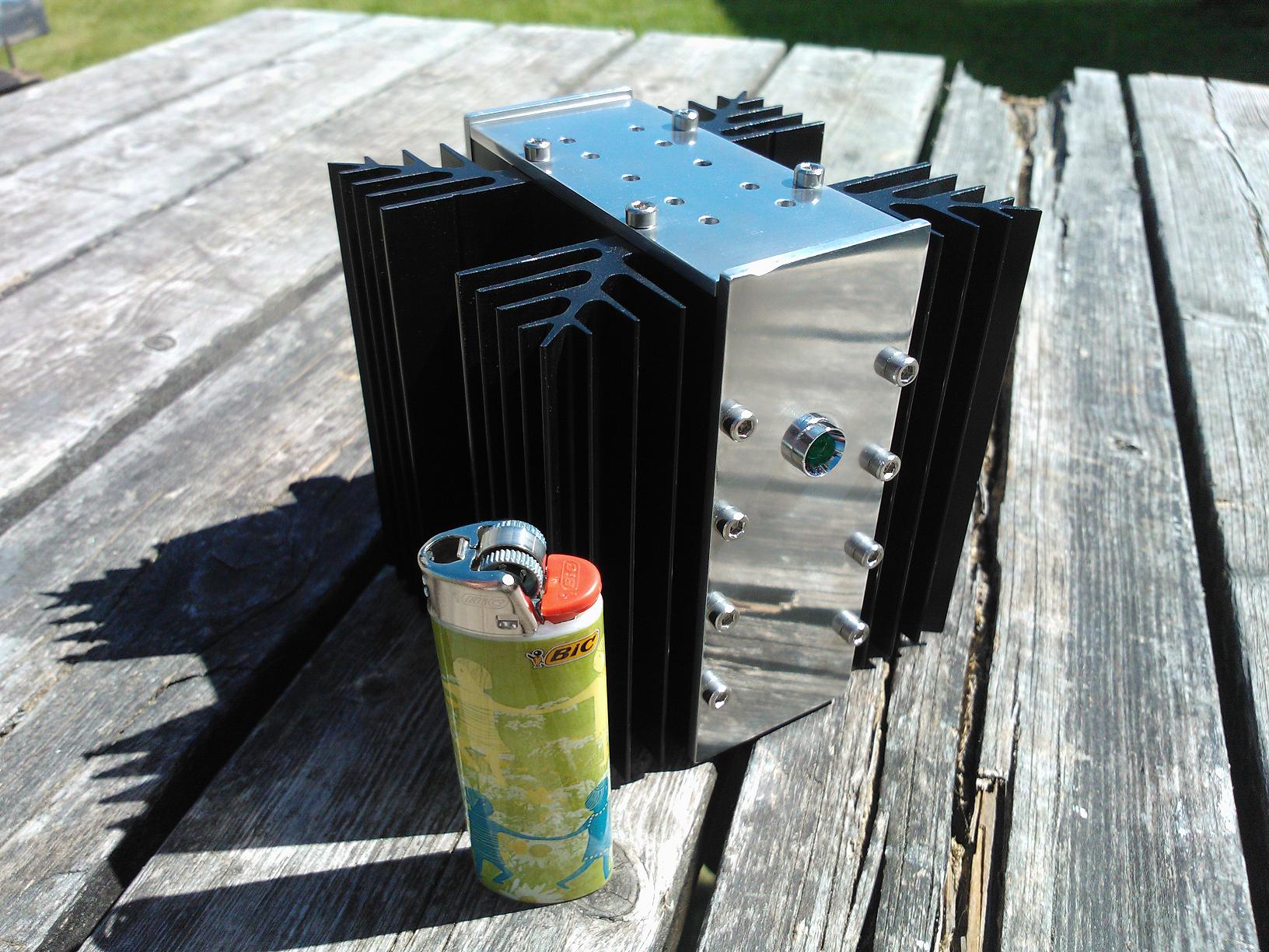

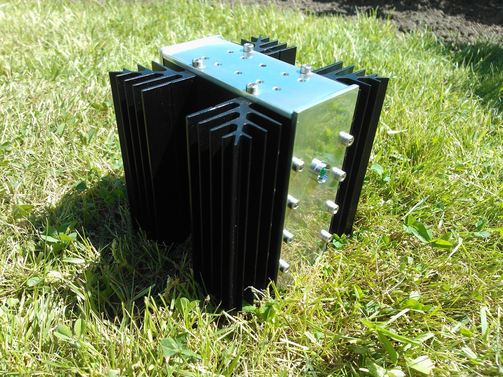

Almost one year have gone by since I built my version of the ACA. Today I finished the last bits on one of the monoblocks and feel it´s worthy of showing to the community.
As can be seen, it has been built without any PCB and the components are held together by the mosfets and some "chewing gum" like adhesive. The construction consists of two 1,5 K/W heatsinks and some aluminum flat bar, held togheter by 20 screws (all drilled by hand). It can also be seen that I could not find big enough bias resistors so I just put 10 smaller resistors in parallell.
The amplifier is about 10 cm square but manages to produce a lot of good music for its size. 😎
