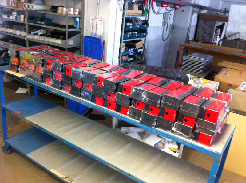

The chassis have now finished production and be shipped by Air on Monday or Tuesday directly to the USA. When they arrive at the warehouse they'll go straight out to everone that has pre-ordered first.
Thanks everyone for their support over the last year on making this happen. It's been a fun and rewarding journey and I can't wait to see pictures of finished kits in place in various systems. I'll post some more hi-res pictures of the final chassis as soon as I have them.
You can pre-order the chassis until they've all been accounted for.
