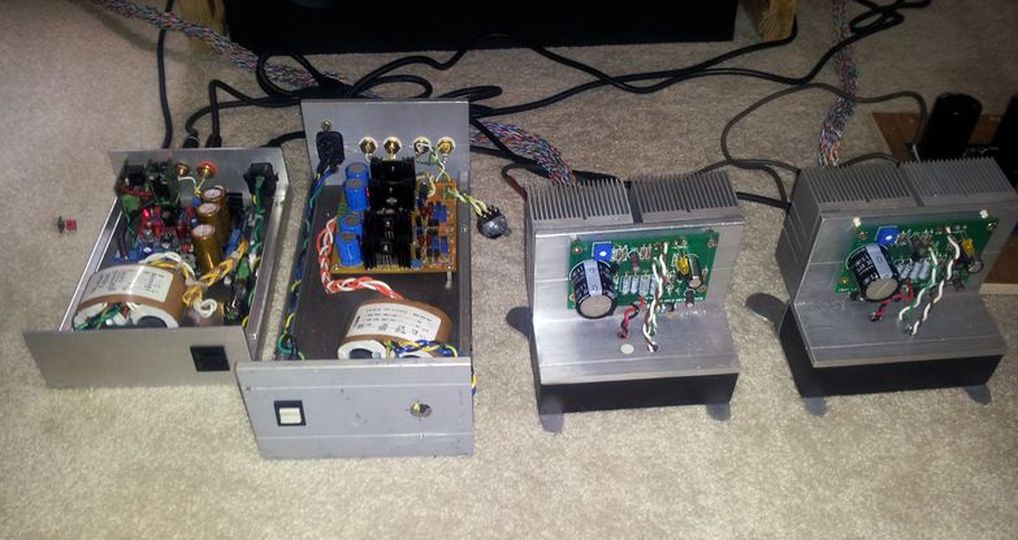

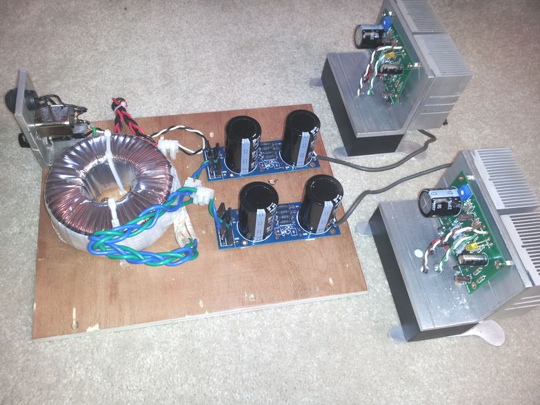

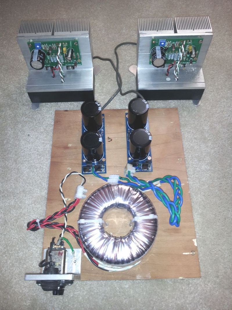

Let me just add that a dual mono configuration is also a possibility. This uses the Peter Daniels PS boards and an Antek AN-2215 toroid that produces 20.5 Vdc. That's a little high but sounds really good. One could put everything in one chassis or do separates with short power leads. This build uses PC CPU coolers but one or two of the standard heatsinks could be used. HeatsinksUSA has many profiles.
Sorry for the mess - too many projects going at the same time.😱

Thanks, My impression is an increase in the general body/fullness and a slightly more engulfing image... both depth and width of stage. Not a lot but a definite improvement over the bricks.

Thanks for the added details, Bob! Curious, your impressions of a more robust power supply for the ACA mirror the impressions of those who have built a larger power supply for their DCB1 preamp. I feel a "Tim the Toolman Taylor" moment coming on: More Power!

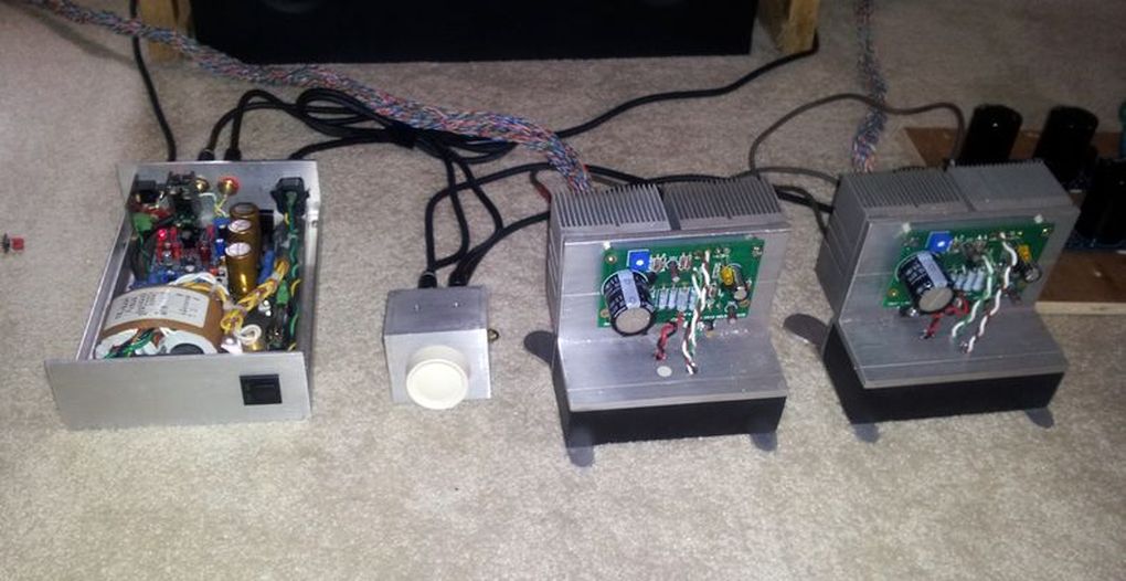

Finally got around to using something other than computer/Walkman for volume control. The first pic is a shielded box containing an Alps Blue Pot. It sounds delicious but only offers attenuation. Completely sufficient for most systems IMO.
Being a big band jazz fan/player, I like a little more SPL than that, so I hooked up a J-Fet preamp. It has more gain than I need but also sounds clean and clear. If I'm reading the power transistor spec sheet properly, which I could easily be mistaken, the high temp theoretically can go to 150 C. (TJ = Operating Junction and Storage 55 - 150 C). Can someone with more experience report what a reasonable, practical temp ceiling is. Probally will never go there but it would be nice to know.

I wouldn't worry much about those IRFP240 devices, they are virtually indestructible. The data sheet shows the de-rating curve for them:
My Aleph-X amp runs them at less than 2A bias each with a case temp that is less than 60c. This is well within the safe operating area. I don't think you can run an ACA high enough that they would break a sweat😀

Thanks Eric. I don't do "Head Bangin" levels but i'ts nice to know there is adequate capacity for some good boost.

There really isn't a hard-and-fast maximum power dissipation figure for the 240 devices as this is dependent upon the size of heat sink. Dissipating more power means needing a bigger sink and to some extent, larger sinks "compensate" for greater power dissipation by keeping things cooler- though there are limits.
I ran some numbers through WuffWaff's spreadsheet that he developed for the Aleph-X amp. With 20v rails and 2A bias per device (40w dissipation per device) with each device mounted on a 1.0c/w sink, you would have junction temp of about 100c and a sink temperature of about 65c - this is about as high as you would want to take it. You would have a maximum power dissipation figure per device of about 53w, so you're coming pretty close by running them at 40w each.
If you then double the size of your heat sink (0.5c/w per device), this brings the junction temp down to about 85c and sink temp down to closer to 45c - this is much more sane. With cooler temps, the "danger zone" of power dissipation becomes more like 77w per device, (instead of the previous 53w) so at 40w per device, they can breathe a little more easily on a larger sink.

That tells me, though adequate with attenuation, my little PC CPU coolers are close to max capacity. If I continue to use the ACAs with a gain device I'll bump up to something more substantial. When my devices read ~ 52 C the heatsinks are ~38. They are hot to the touch but don't burn the fingers. I suspect the very thin fins are helping in the current configuration, but I understand the advantage of using more metal mass.
Don't know how far I'll push these as they weren't designed for high sound levels, but thanks for your replies and useful information.

Bob, for a rough approximation, divide your thermal rise by the power dissipation and that will provide you with the c/w rating of your current sinks.
