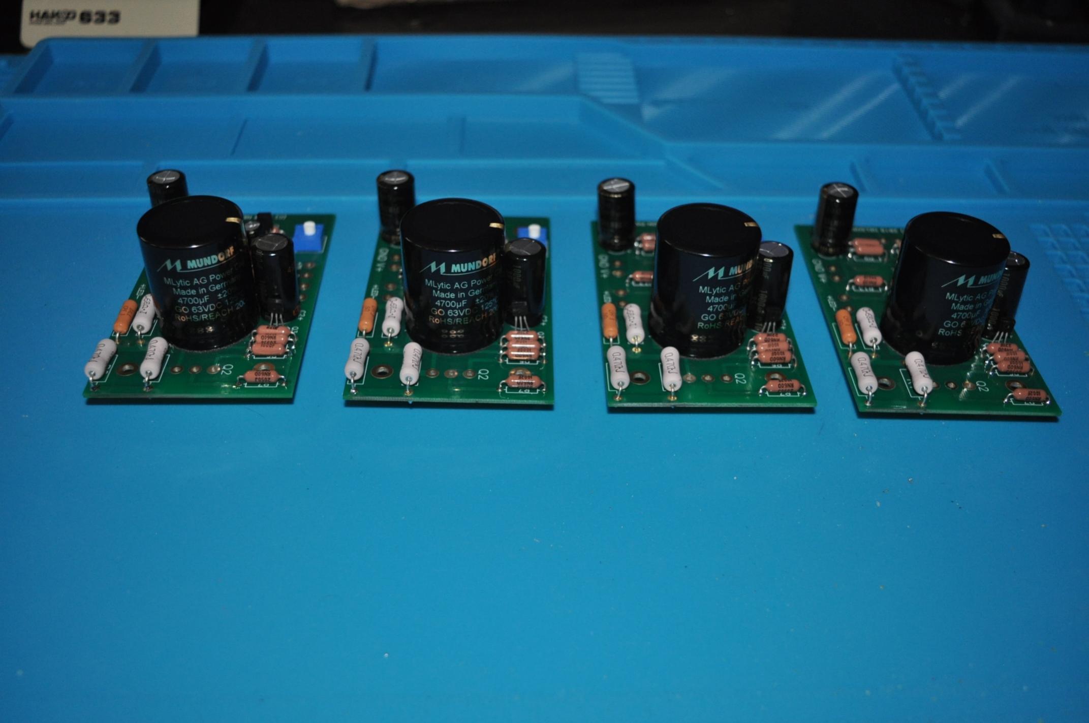

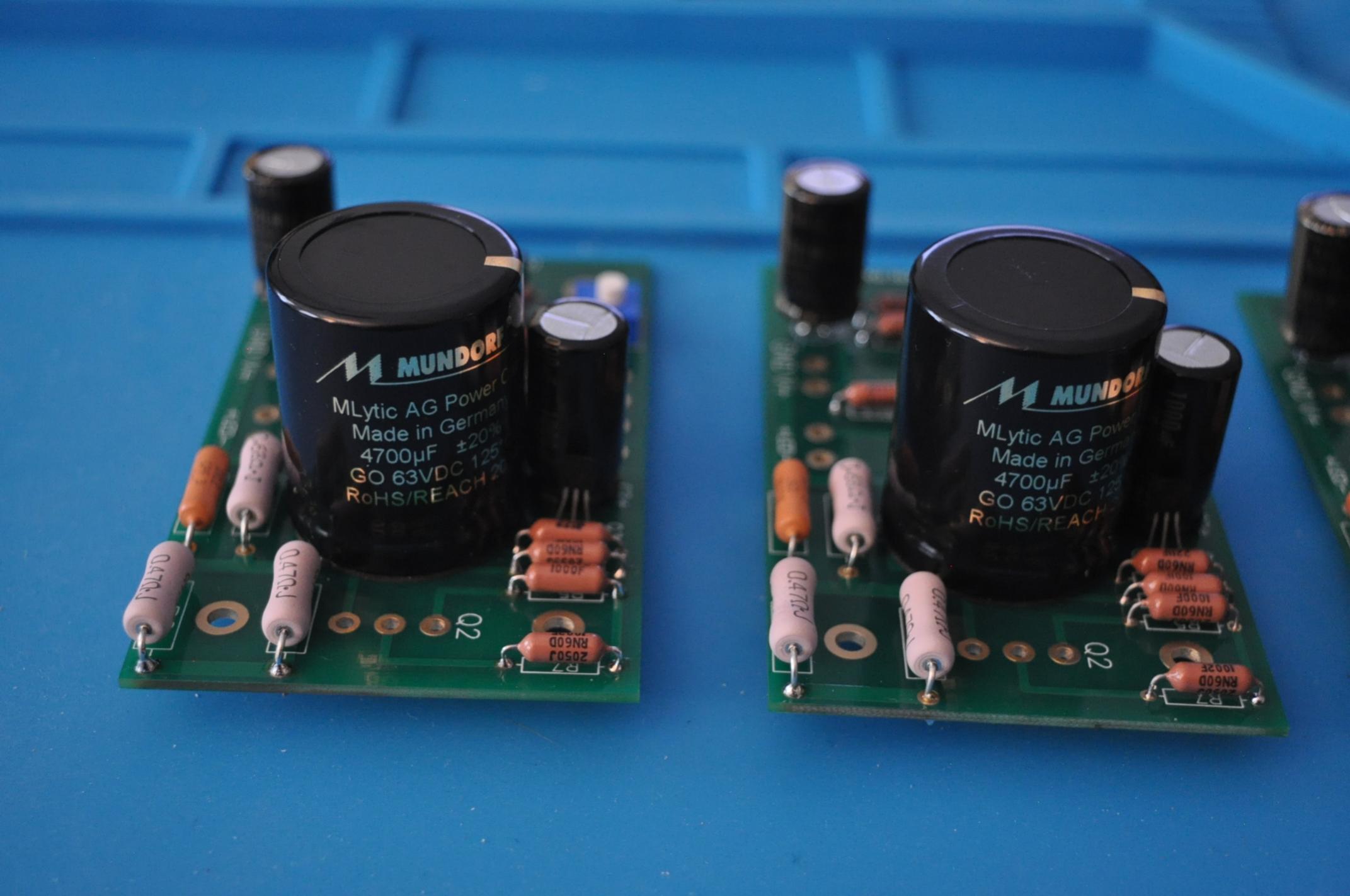

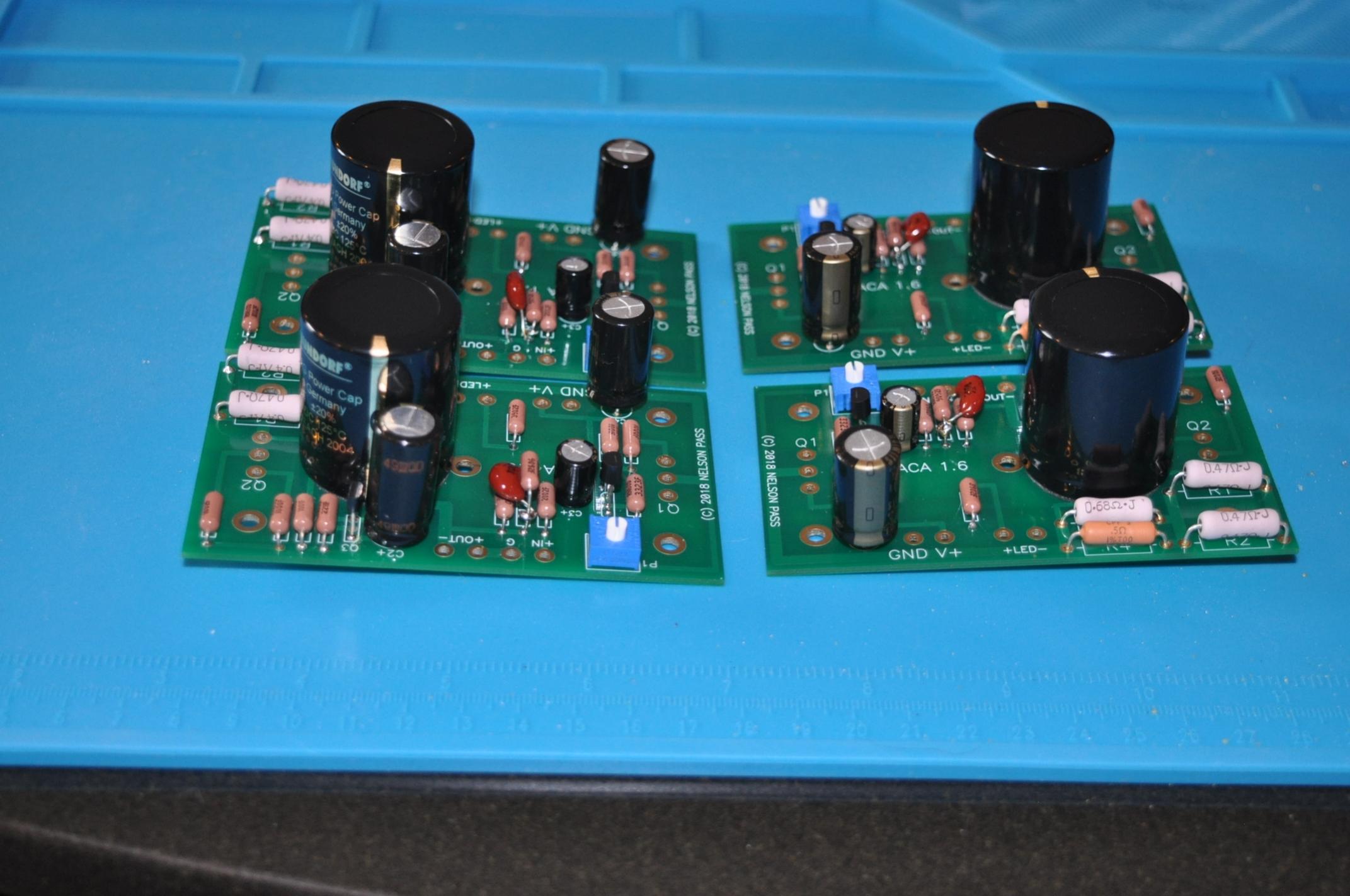

New ACA Build
Here are some photos the new build so far. I am using the part values suggested by Tungsten Audio. I have not implemented R16 - yet. I have not decided if I should increase the power supply past 24VDC. I picked up some IRFP140N transistors that I may try for Q1 & Q2 instead of the IRFP240. I have no idea what impact that will have on sound quality.
I welcome all recommendations to help make this latest build the best it can be.
