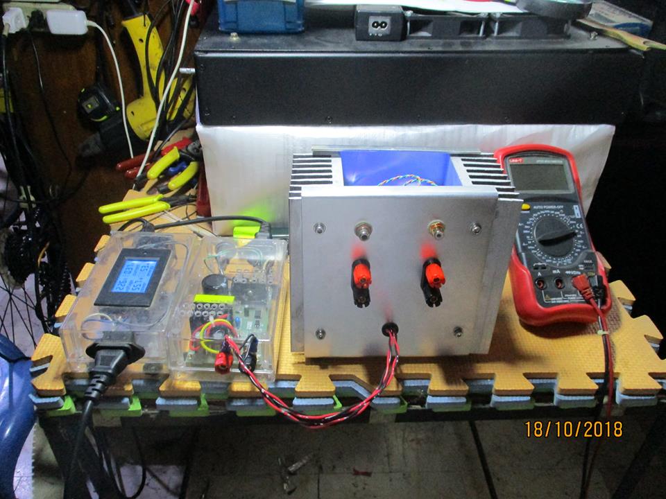

welcome, i post based on actual experience and what i was telling all along is that this ACA amp will work the first time if you got construction right....
i too have my share of failures with other builds, but never with this one...
an open mind surely helped me.... not be too dismissive of what you do not understand...
were it not for this pandemic, we could have built more than a hundred of these boards in Manila.....
Nelson Pass came up with a winner here, single ended design, class A, what is not to like?
i built a 48v version of this ACA, bridged, and i am very happy with the results....
the design was culled from inputs coming from Zen Mod and other members here...
board layout was done in the middle east by filipino engineers, and board fabricated in china.....
it has become my reference amp for now....until i can find another one that sounded better to my ears...
