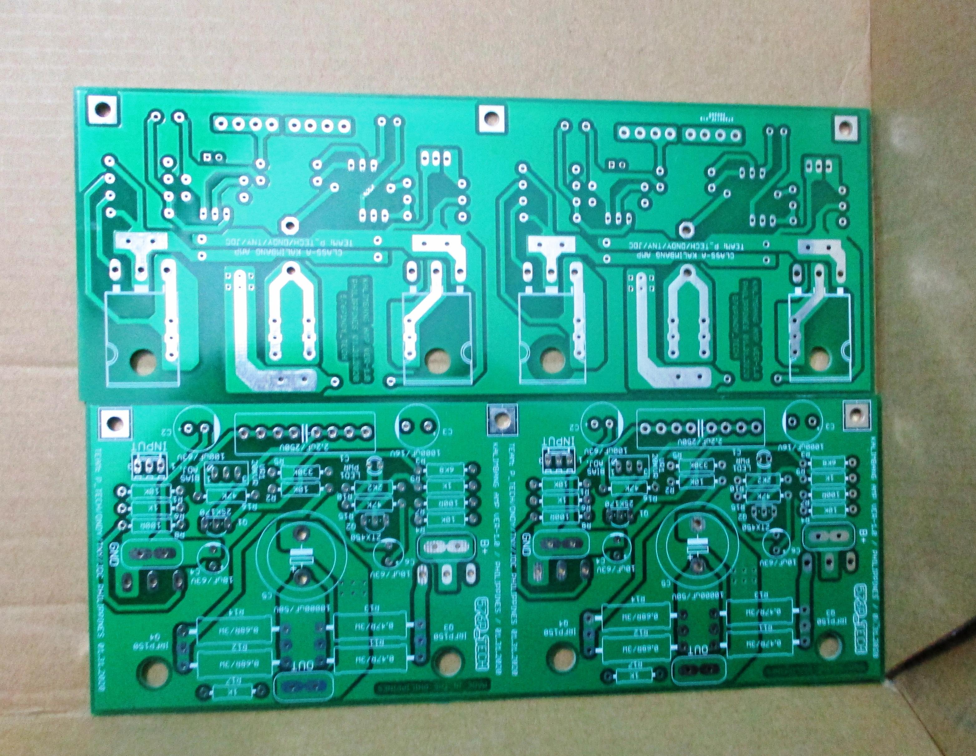

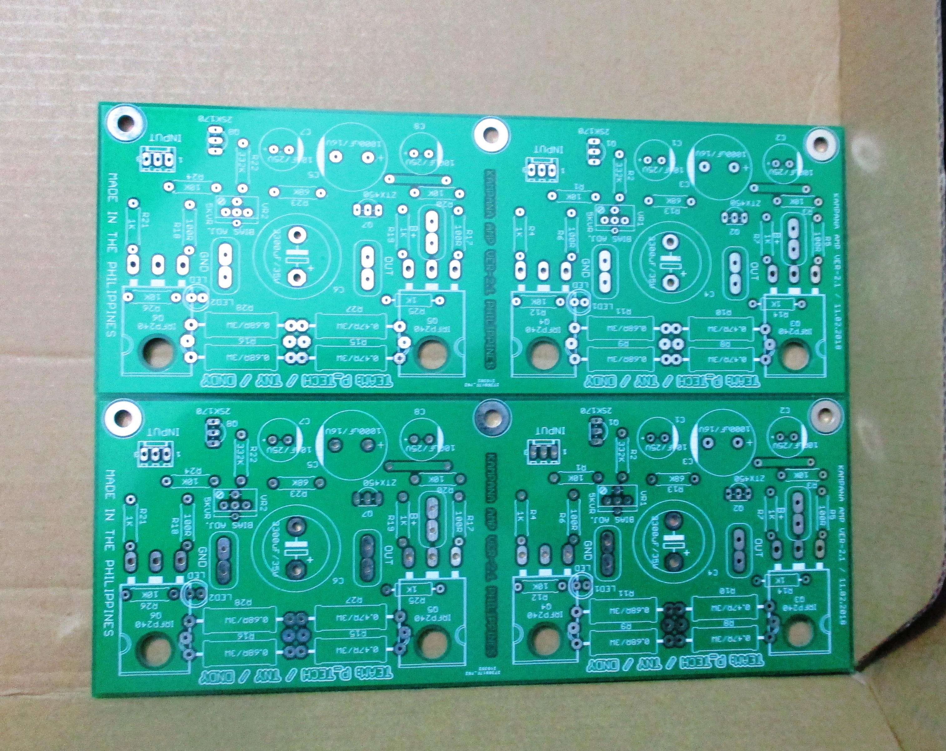

2 in 1 boards for ACA and 48v single channel boards....
these boards are made for our build ins and teach ins and is not for sale outside of the Philippines...
