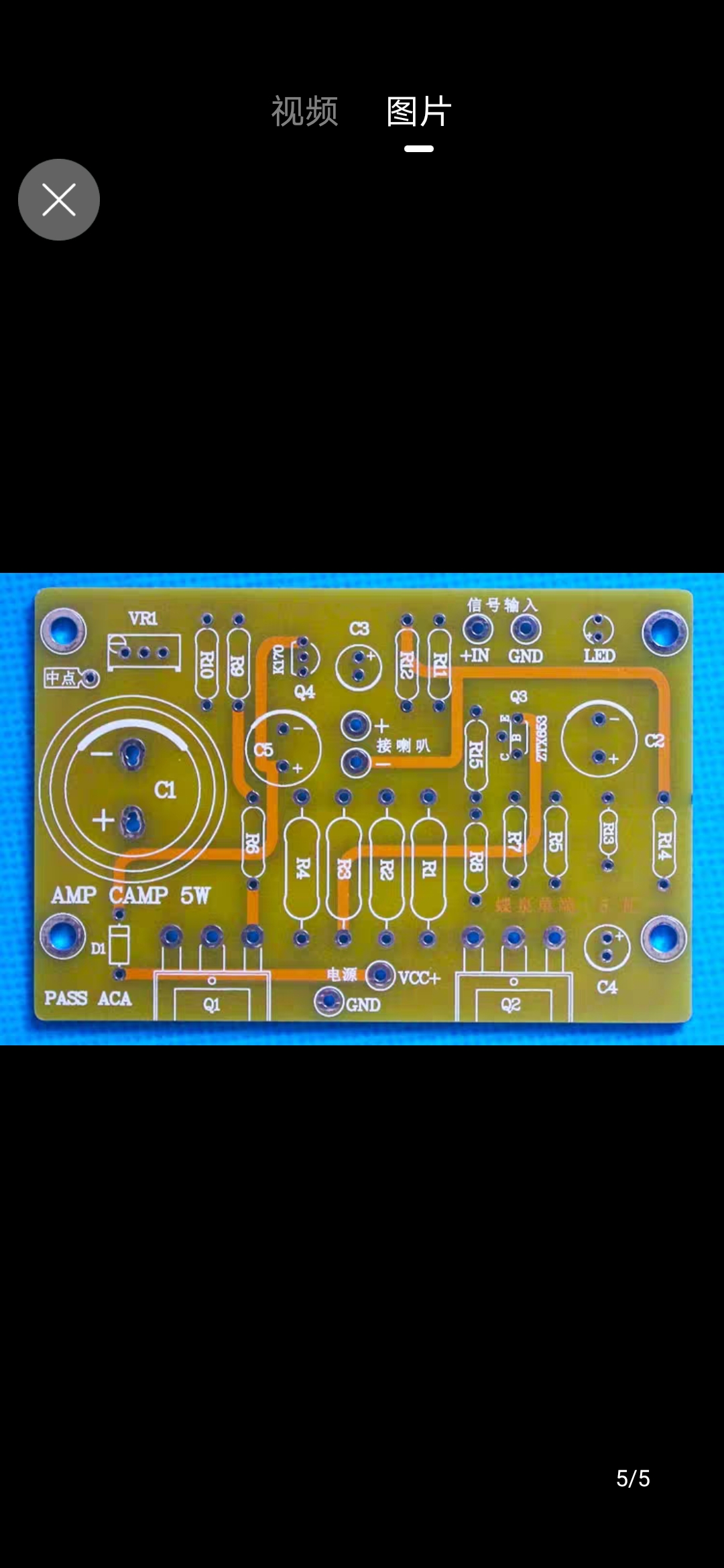

Is there any difference with this clone and the original ACA?

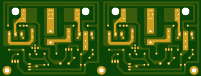

Might be a trick of the light / perspective but the traces of the who-knows-where-it-comes-from? board may not be as wide as the shop version:
mlJULs3AJ6mME4ed.full
Hopefully, it conforms to the Nelson Pass schematic .. but which version? You'll have to do the homework on that one I'd expect.
Personal opinion, the store boards look "pro" to my eye. The board thickness might be different. So, durability and the ability to tolerate noob punishment from excess soldering heat could be a case of YMMV. Dunno .. all guess work really.
From a functional perspective, the store board is designed to fit the UMS layout. So if you get your chassis from the store and pick UMS heatsinks, then the board will bolt straight in without you needing to do a drill and tap job.
If you're getting your heatsink from another source, then it's a moot point.
Those particular clone boards have added two components that are not on the current shop version. D1 and C5 are used to filter the power going to Q4. One could replace D1 with a 200Ω to 499Ω resistor, and use a suitable Alu organic polymer capacitor for C5. Which you prefer may depend on the layout of the output transistors, Q1 and Q2.

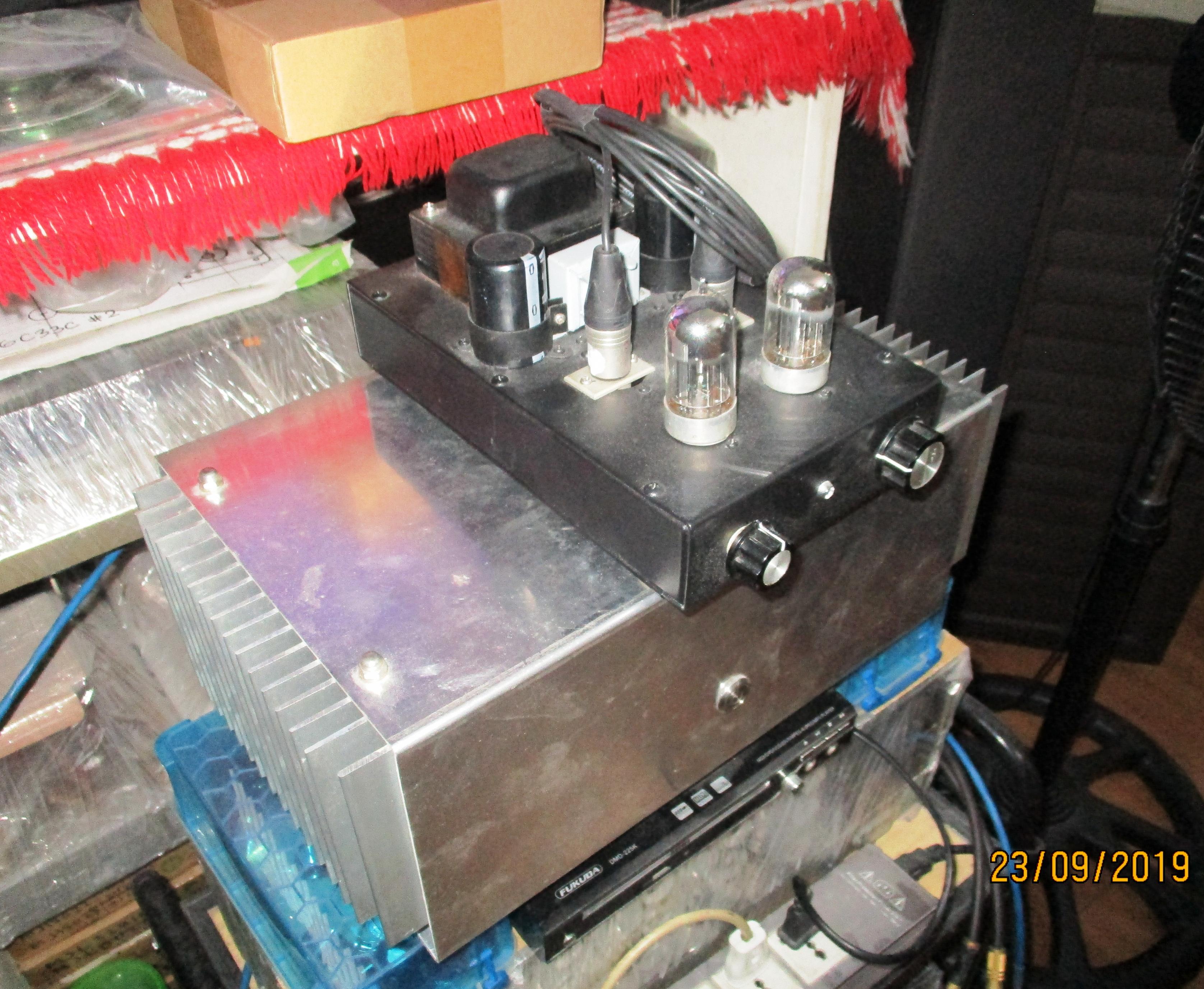

I am using a 6922-based Aikido preamp with lots of gain!
What's your room size?
The ACA will be honoured and delighted to do that! According to kjfaudio the TS parameters are broadly similar to the Alpair 10.3 drivers. I powered FHXLs with 10.3 drivers with my ACA and the combination was stunning. I used a preamp with some gain, which helps the ACA a lot.
So if I maintain D1, all I need is replace c5 to polymer cap?

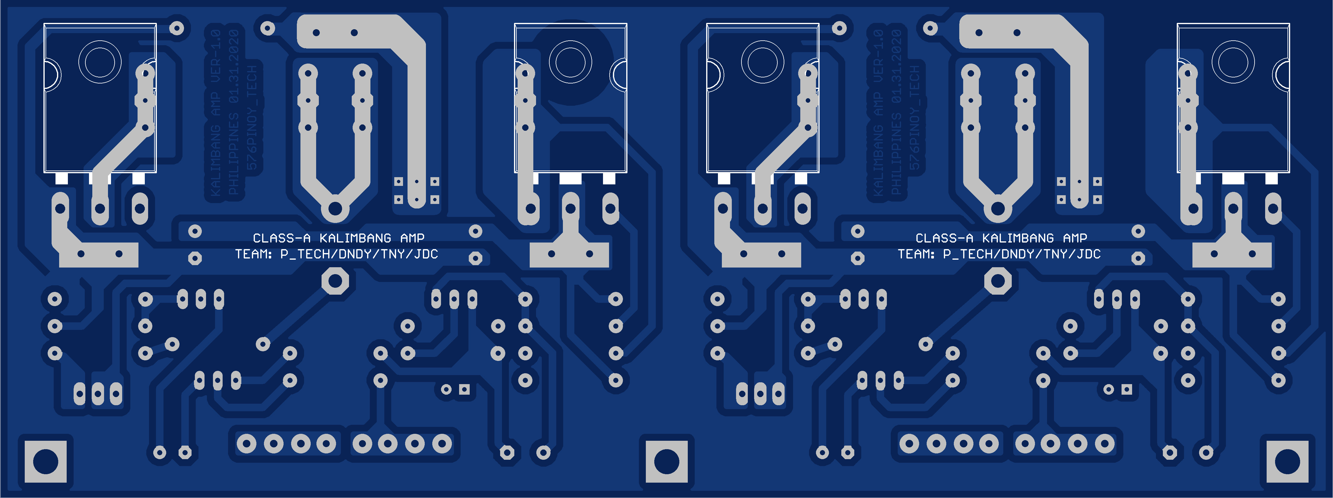

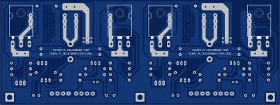

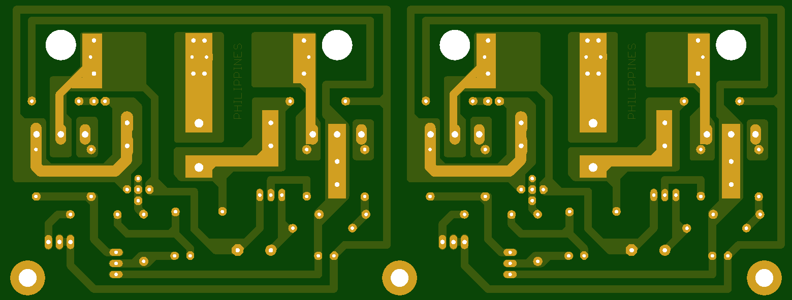

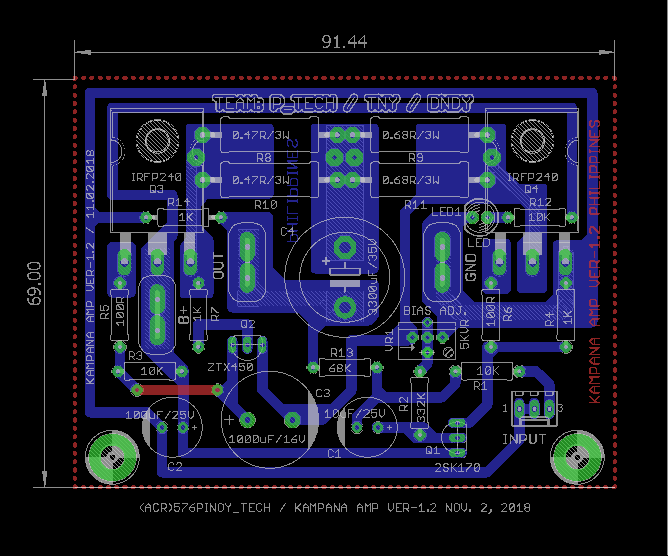

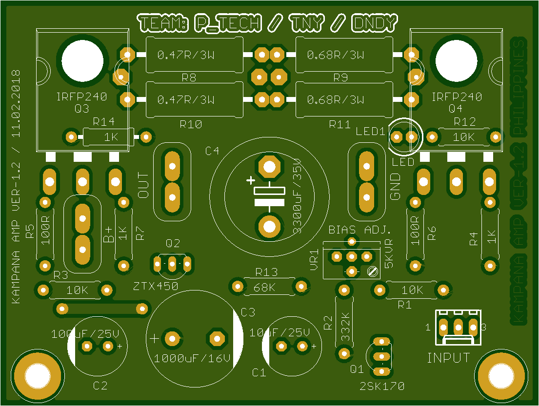

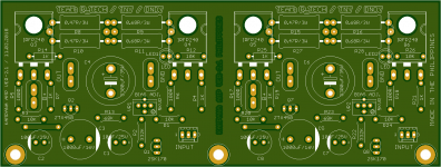

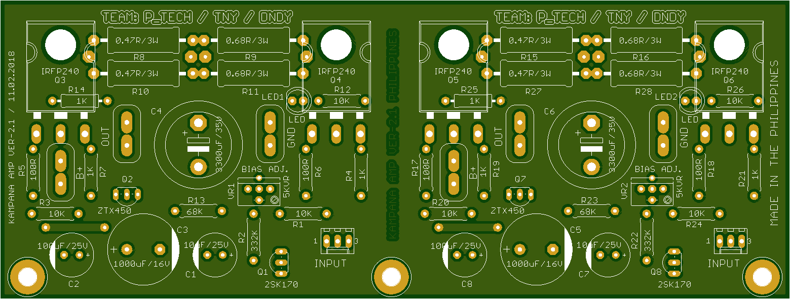

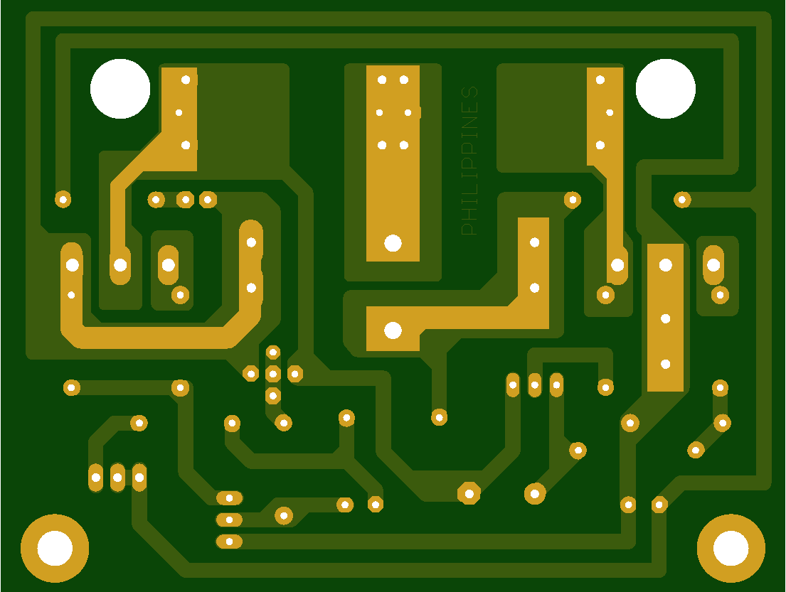

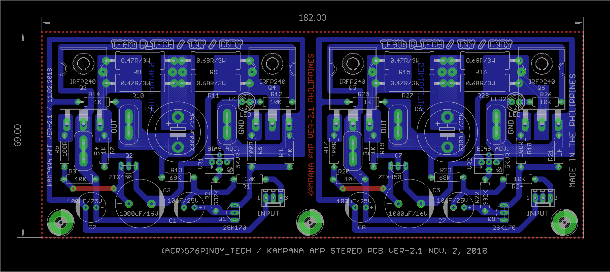

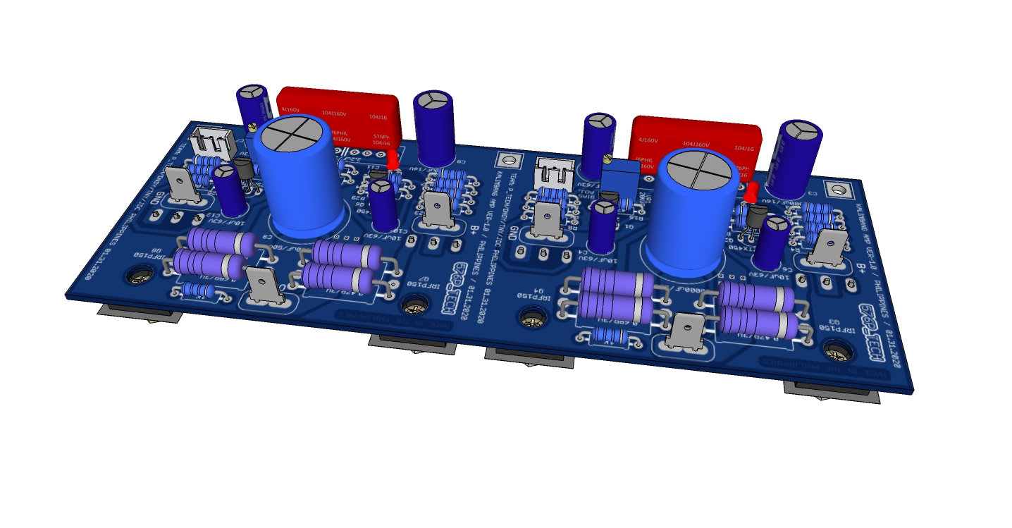

our ACA boards used the fr4 and double sided with thru hole vias....no, we are not selling them for commercial profit, but use them n build fests that we have organized, about 70 channels of these amps were built by our participants....we even have the 48volt dc version....

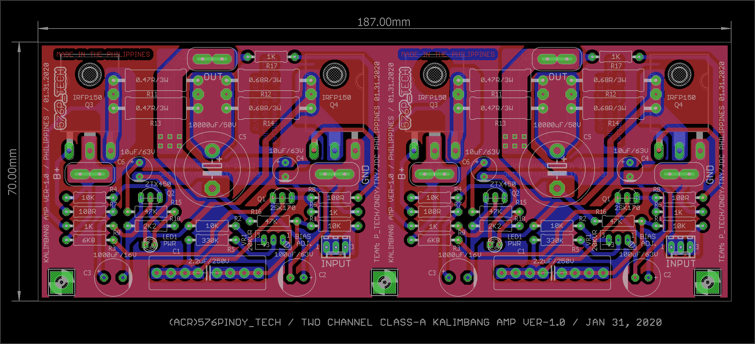

yes the 2 in 1 board is convenient to use when bridging....our boardshave printed component values on the pc board....

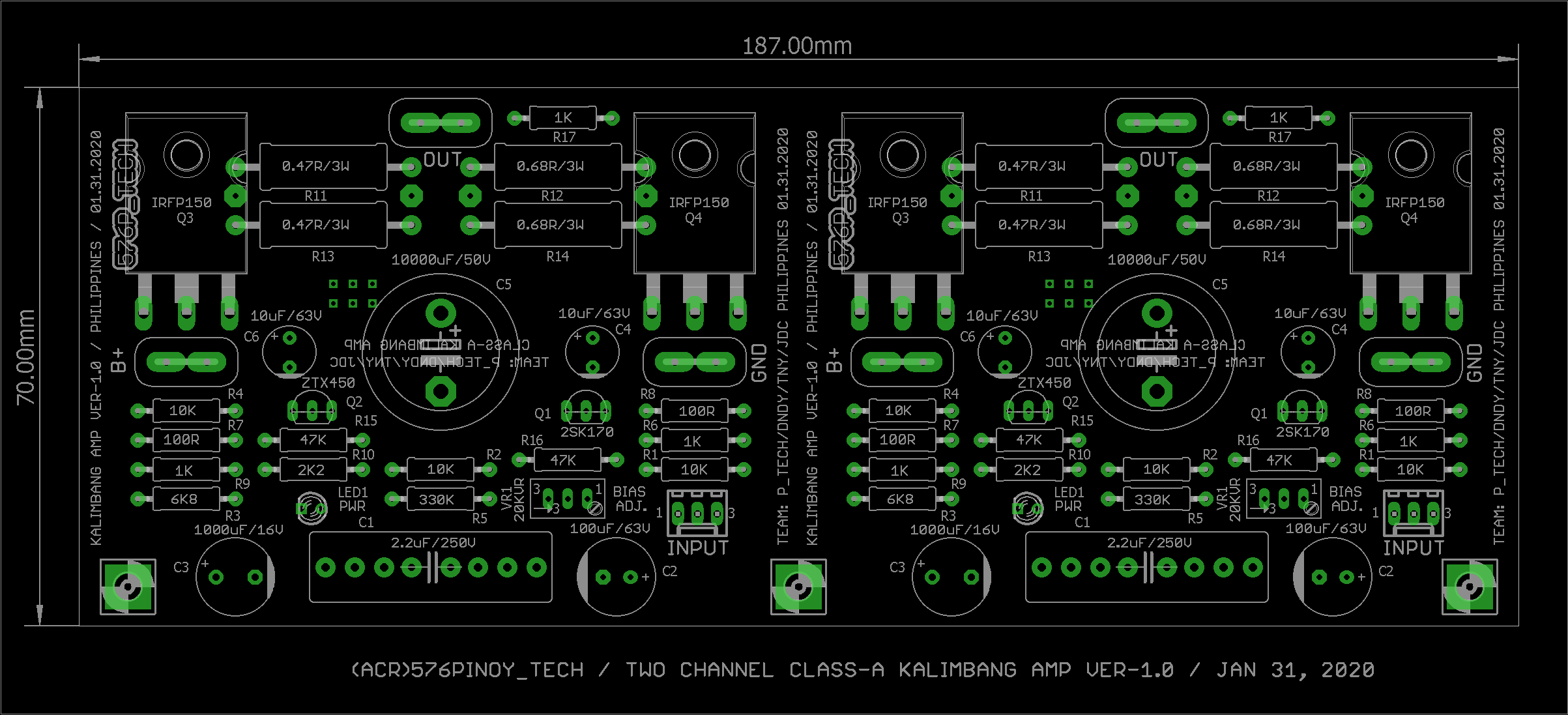

btw, here is our 48 volt version of the ACA, too bad the covid 19 pandemic prevents us from holding a build fest in Manila...
