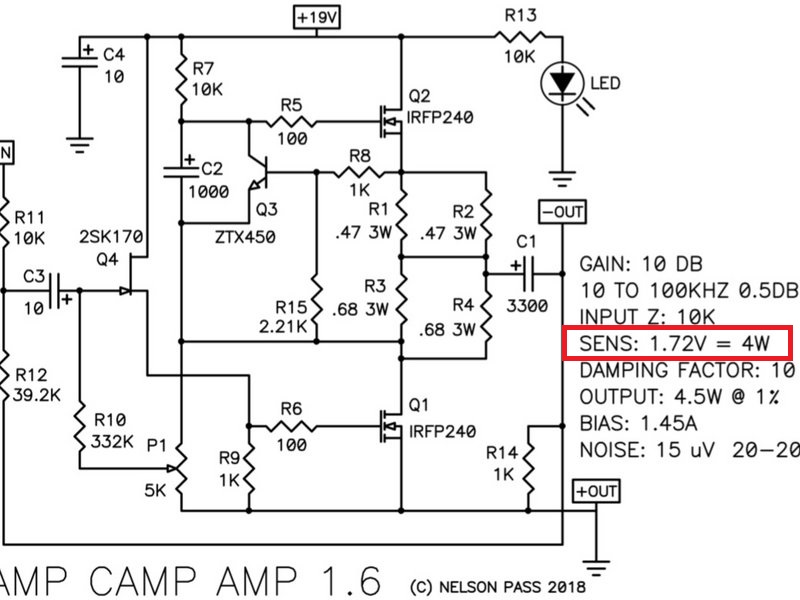

(Q1) What signal lever ACA needs to give me the full 8W that it is capable to? Am I asking here about the Input Sensitivity of ACA to get the max output?
(Q2) What is the output level of the MacBook Pro or iPhone X that could be my initial source of Spotify music? Would it be enough for ACA?
Spec is 1.7 volts gets you 4 watts, figure.
No idea, but iphones and the like do not reach 0.5 volts.

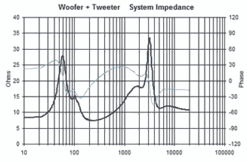

Thanks. What is the source of the graph, please? I know the speakers are not the best, but that is something that I could easily build while waiting for the ACA.

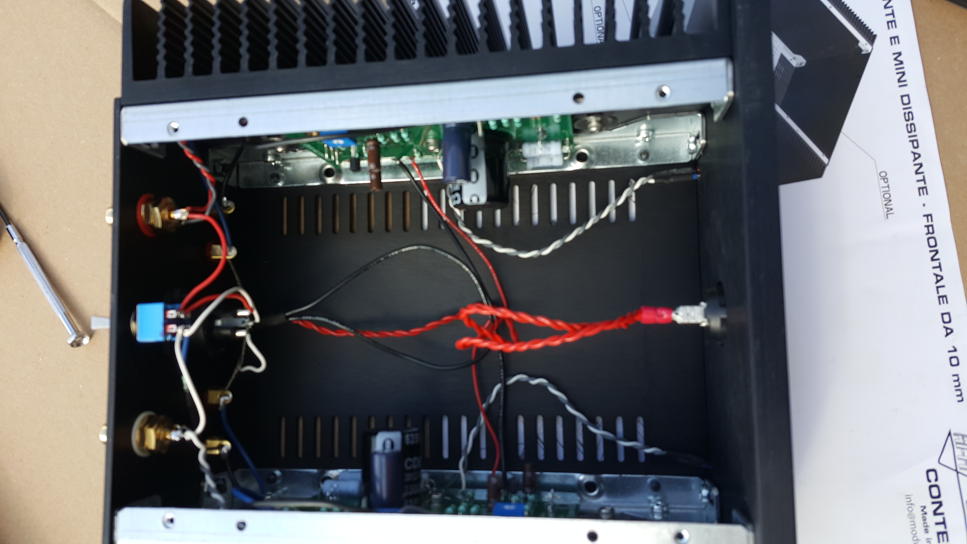

Just finished my build. Took the weekend because I work slowly. Lots of fun and a simple, straightforward build. Thanks everyone!
Powered up with that beautiful sound and was making music on the first test.
Only two tricky points:
DC balancing. A very small turn would send the measurement shoot off 1-2 volts, it took a while to find 10V on both sides.
Chassis. Its beautiful, but really hard to get everything to align. Yes, I know, leave all screws loose until all the parts are on--- but it is a little awkward trying to tighten up the interior screws once the top and bottom covers are in place 🙂.
Got it done and am a happy (amp) camper.

I'm sure Alan4411 is correct, though I couldn't find any spec on input levels (only checked the DIY store technical specifications sectionAmp Camp Amp – diyAudio Store and the original thread/article Amp Camp Amp #1 ).
We know if your input signal is only 0.5 volts (ie a smartphone) the amp is fine, if not as loud as one might like.
What happens if the input signal is closer to 10V? Is that going to blow anything? Or will I only see really bad clipping?
I ask because my Eurorack sequencer operates at +/- 10V (the standard for such systems), and I'd like to connect it to my amp.
Yes, when I get the linestage built, I'll route everything through that, but the linestage is still in its parts bag and I want to play now!

Spec is on the circuit diagram See enclosed.I'm sure Alan4411 is correct, though I couldn't find any spec on input levels (only checked the DIY store technical specifications section.
I know nothing of the 'sequencer'. Is the output full all the time or can you turn it down? Ie have a volume or gain control? If in doubt, do not connect it. If you cannot 'turn it down' it will just clip very badly...
Just one more thing, if you are using the 24 volt smps (comes with the v1.6 and v1.8 kits) the 'bias' is set at 12 volts, not 10 volts.
Doff! I should have thought to check there, yes of course it is. Thank you
Yes, the sequencer has an output gain control, which would remember to set properly most of the time--- I'd just be really sad if I forgot once and fried my amp.
From what you tell me, it would not damage the amp, it would just sound bad. I can live with that

@planet10
It came from the Overnight sensation document i downloaded from Meniscus. I have had experience with this design, it is OK, but were outperformed by a set of EL70s ina similar size box and smoked them in a larger box. It was at a diyFEST and Bob ended up selling out of EL70s shortly after that. The impedance of a good FR is also more appropriate for a high Rout.
They are 8 ohms.
Nominal 8Ω, as can be seen from the actual impedance a much wilder ride.
