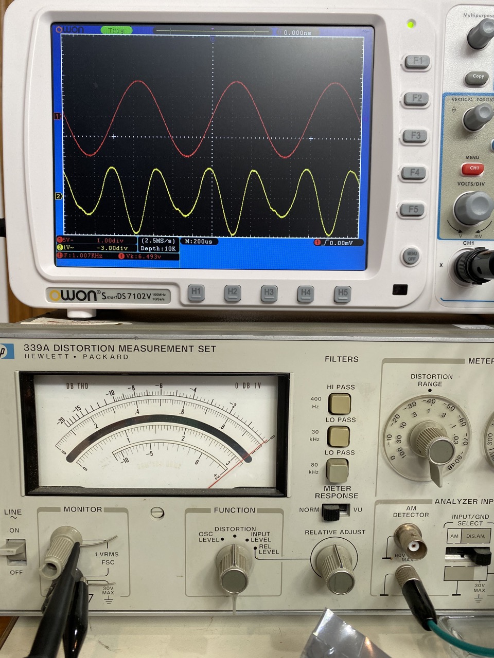

A while back I did a basic distortion measurement on one of my original modified ACAs to see how it performed. The amp was in standard stereo mode, using the original 24V kit SMPS. Using my HP339A analyzer, I turned up the input signal until the THD reached 1%, and observed 6.493 Vrms, which happens to correspond to 5.27 Watts into the 8.0 Ohm resistive load that I used. The residual distortion signal shows primarily 2nd order harmonic, with some 3rd present as well. Nothing to indicate the excessive amount of distortion present in the sample that produced the controversial SINAD measurements.how does it measure if it is with the tungsten mod in premium parts i wonder. haha
maybe it gets better ?
The modifications changed the feedback network and the output current sensing resistors, in addition to using some higher quality components. Quiescent current was measured at about 1.54 Amps. Details are in the "ACA With Premium Parts" thread.

Nelson's original plots showed this amp's technical profile not much differently at all than the recent test. So no surprise. This amp needs careful application to load and system gain structure.
Surely a more representative result for the usual application of an ACA. Even though most people with easy speakers would use it at an even lower output voltage most of the time. For 86dBSPL at 2M distance a 90dB 8Ω speaker pair would ask for 2.83V. Not to go about horns now.
*85dBSPL is the maximum long term safe exposure limit. 90dB is lawn mower not recommended for more than 8 hours use.
