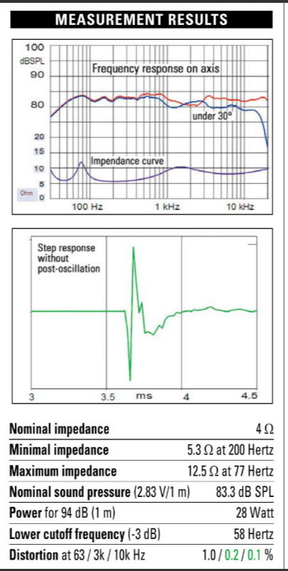

What I remember from the review was that the amp could barely play at a normal listen level connected to 86 dB speakers?
How is the impedance curve of these speakers?
It was this part of the review which I found strange and I said to myself either the amp is defective or preamp was not able to deliver a significant signal to drive ACA to clipping?

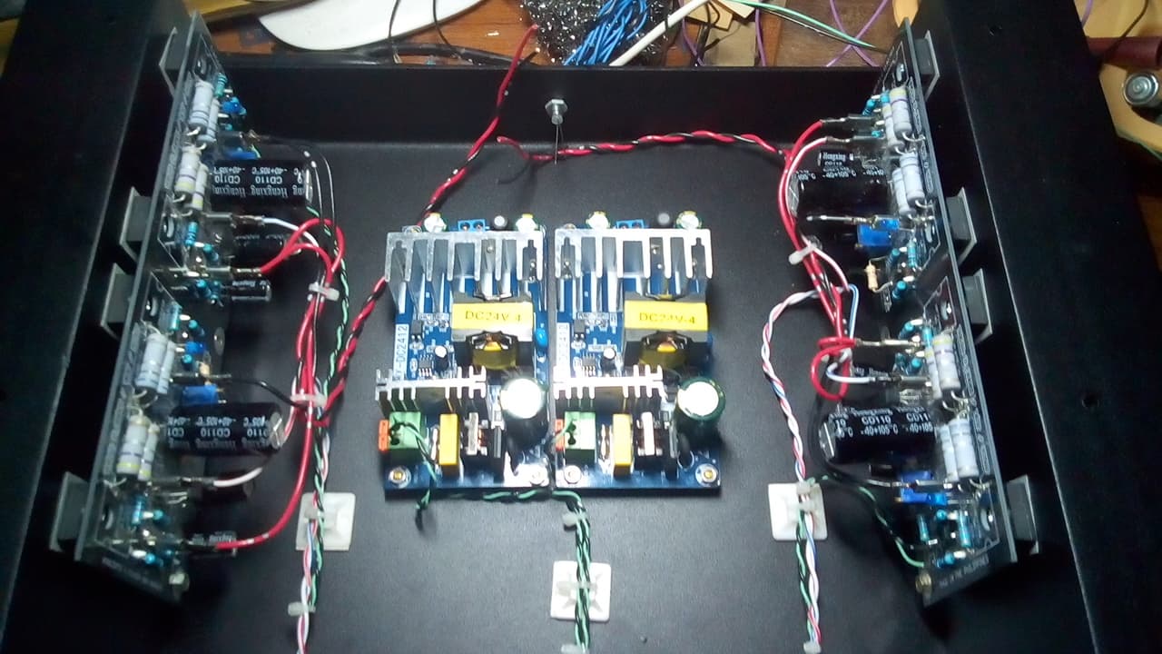

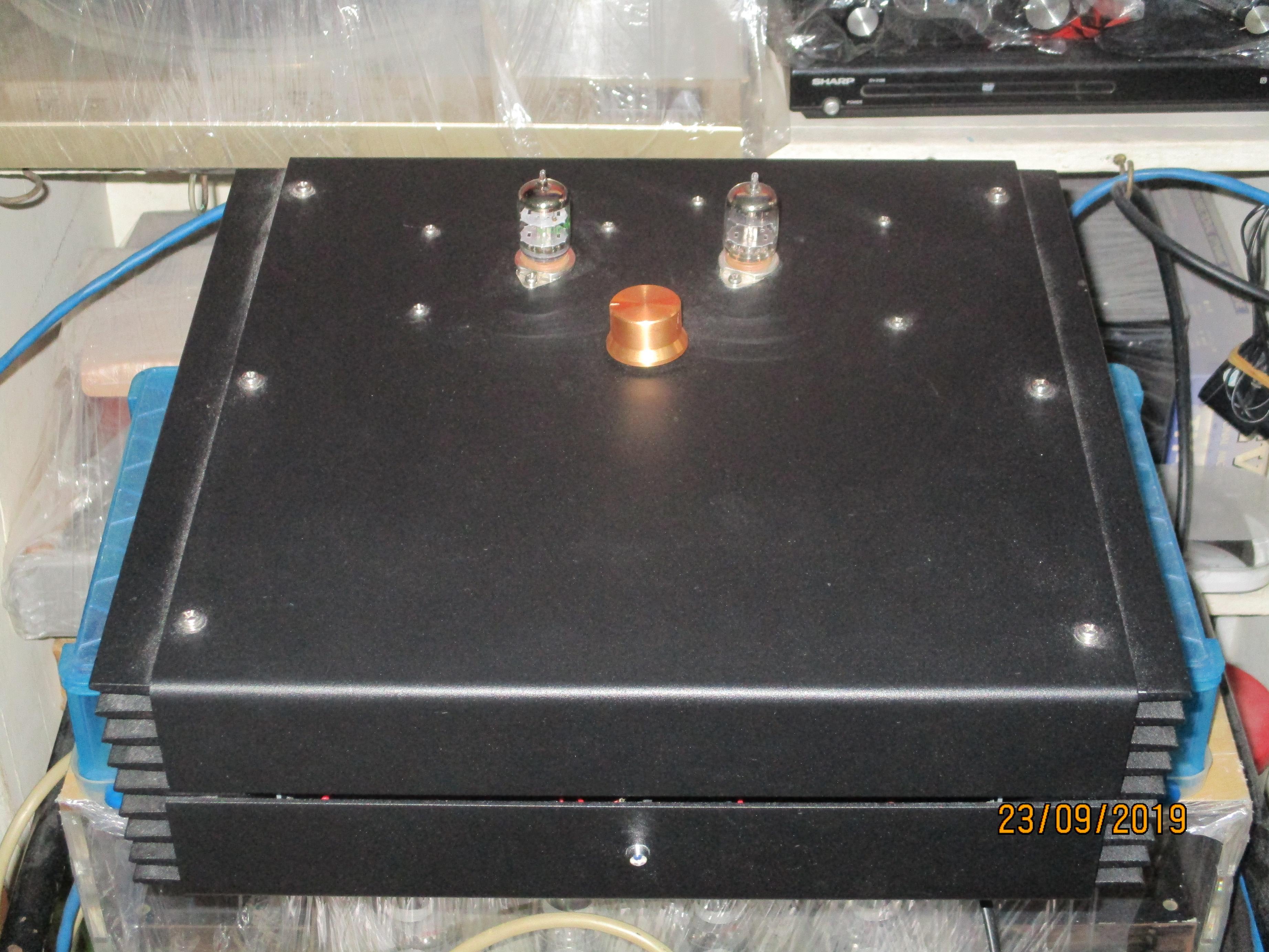

i have such an amp, a bridged ACA that is going to display at a local audio show this weekend...
i reduced the ACA gain to about 3, then used a 6BC4 line stage ahead of the ACA...
