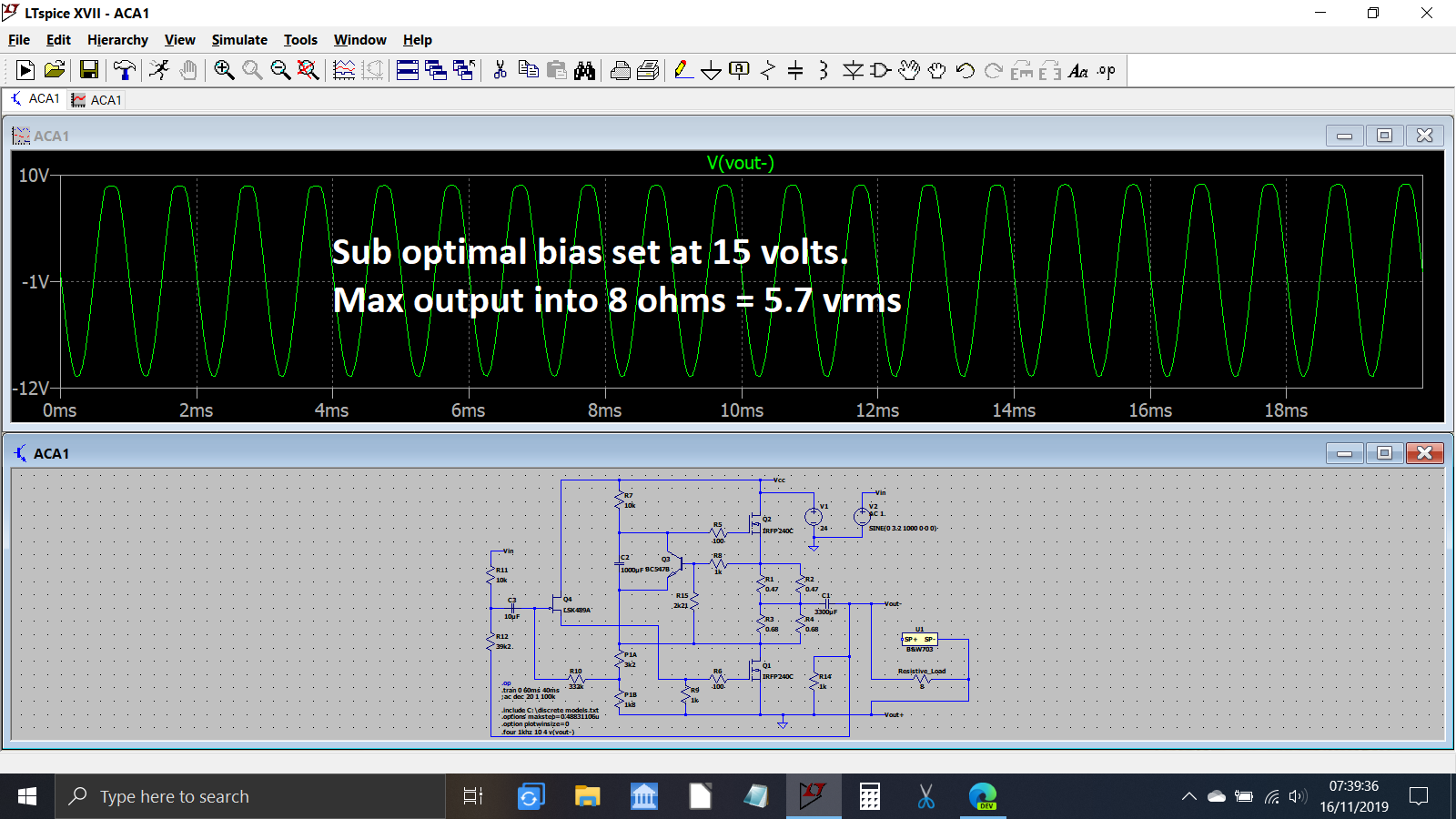

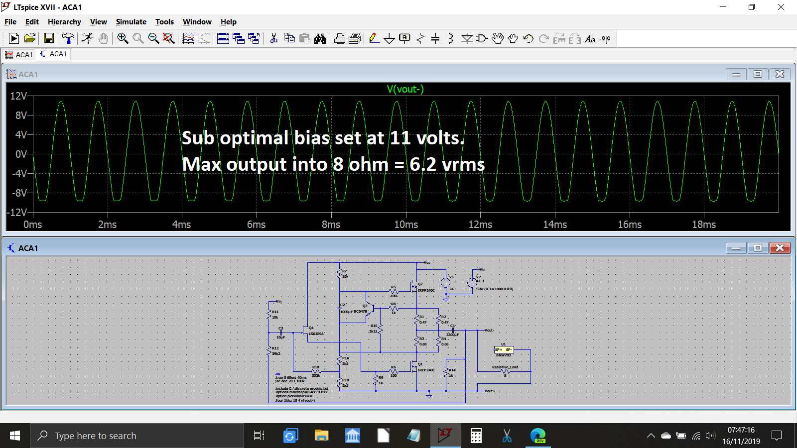

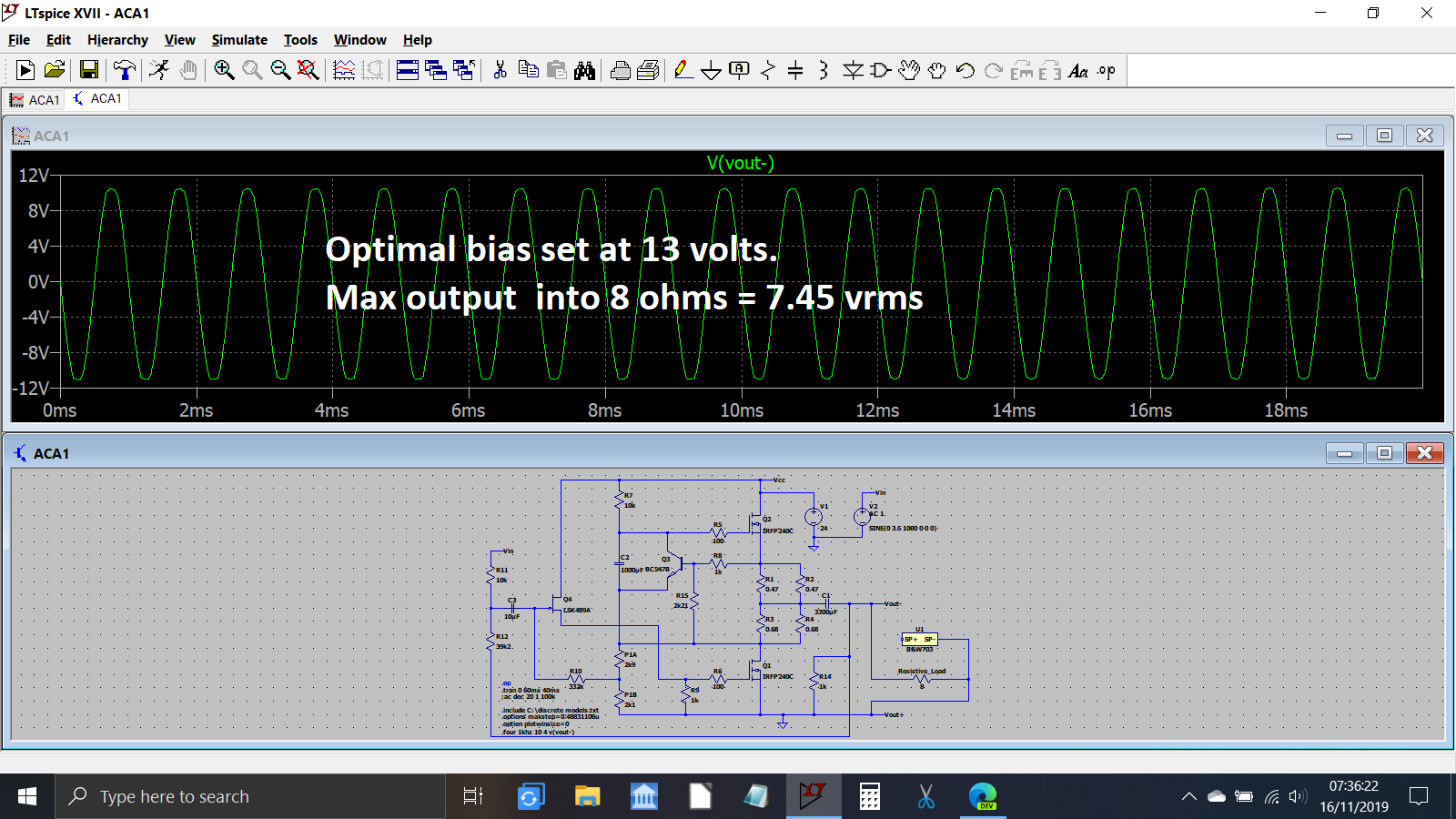

Here is the sim under 3 different bias conditions. Power output in each case is 6.9 wrms, 4 wrms and 4.8 wrms respectively. 24 volt rail assumed in all three cases. The output was reduced slightly from clipping in order to get the undistorted output level.

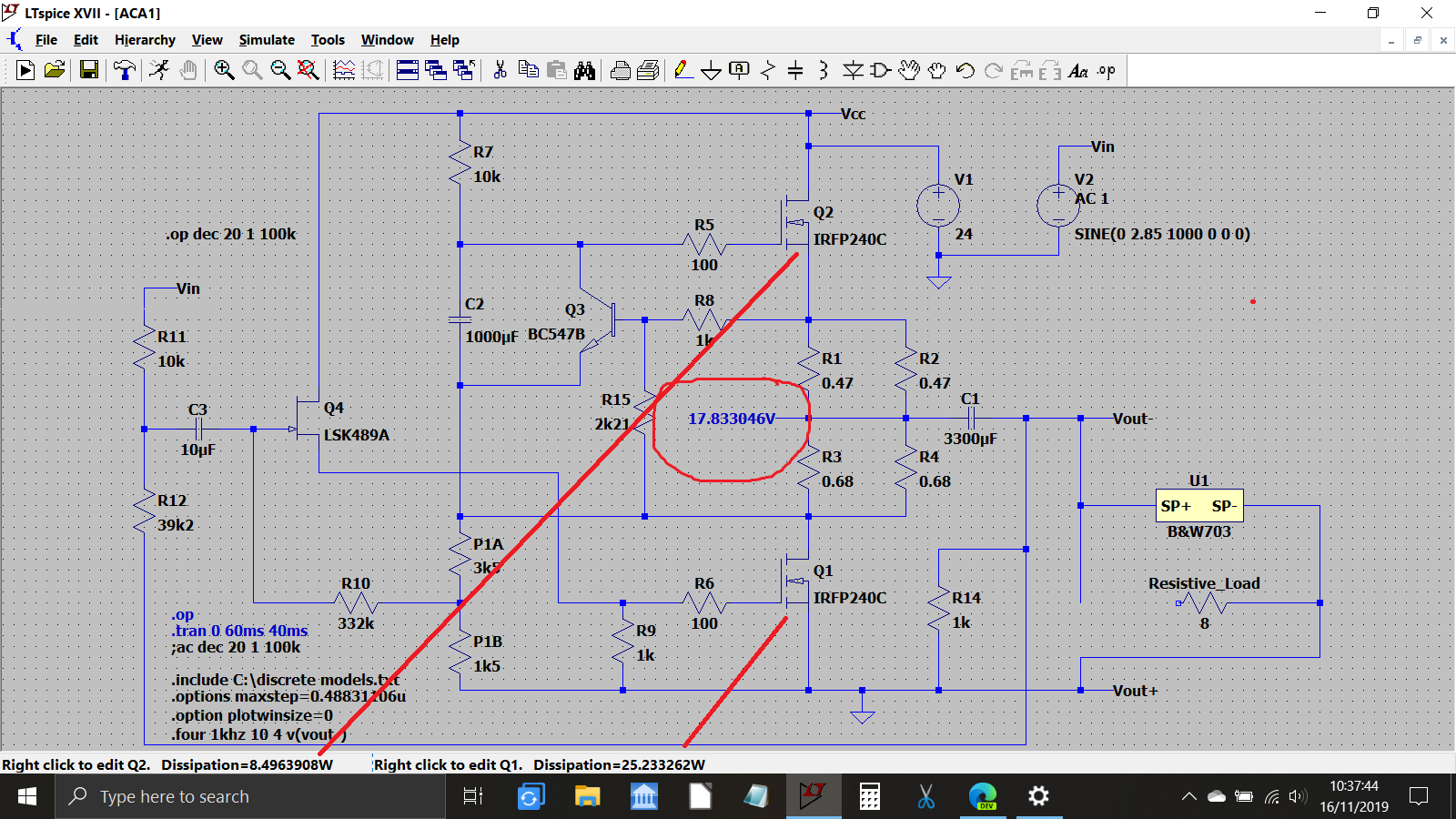

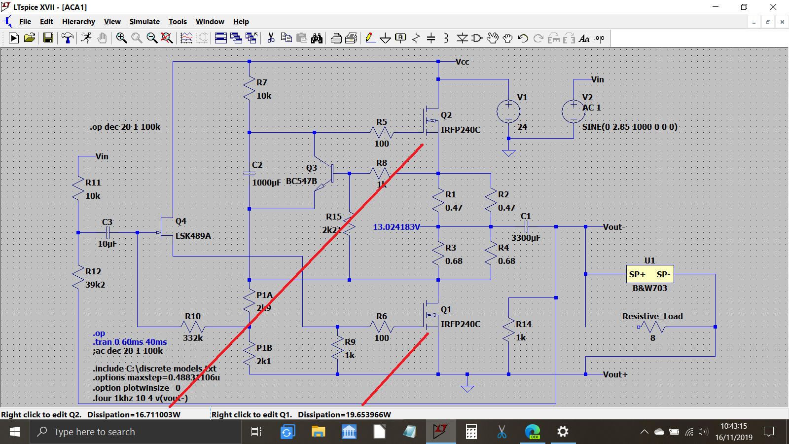

Look at the total combined dissipation for the two output transistors in these two examples of differing 'bias' settings and you will see that when added together the results are similar, despite the second example have a big difference between the individual dissipation of the two devices.
The first image shows optimal midpoint voltage and the second is way out at almost 18 volts.
(the reason the numbers don't agree exactly is because the ACA does not its quiescent current constant in the face of altering the midpoint voltage, if it did then the results would be identical)
