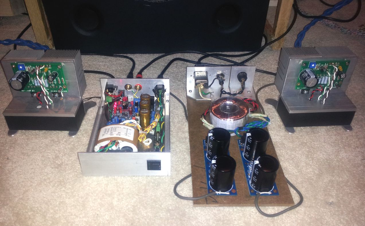

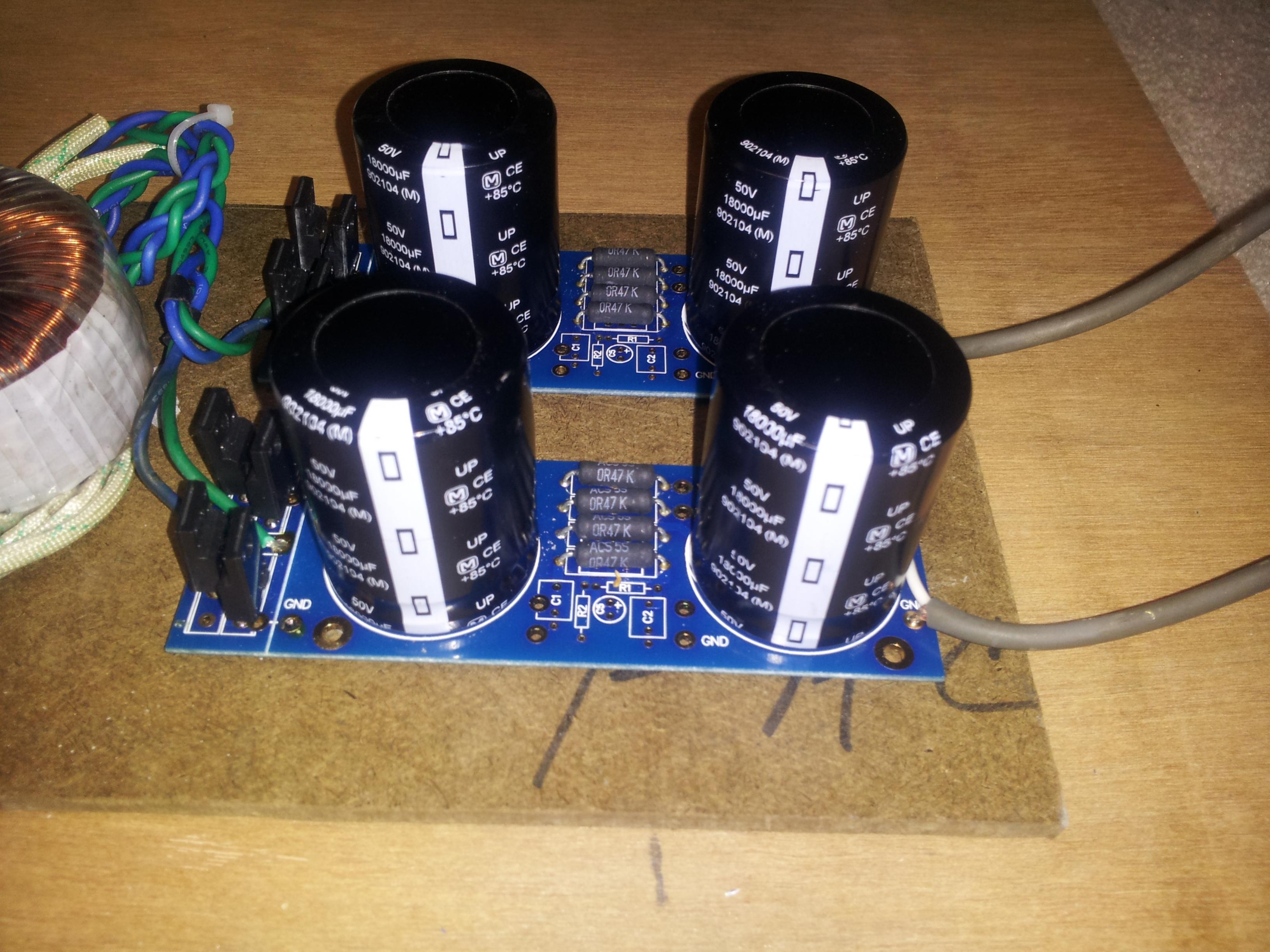

Way, way back - 6L6 suggested a Peter Daniels Universal PS board as a match for the ACA. I finally go them stuffed and working yesterday. The sound quality is great and I perceive more and cleaner bass as well as improved dynamics.
Kudos Mr. Pass

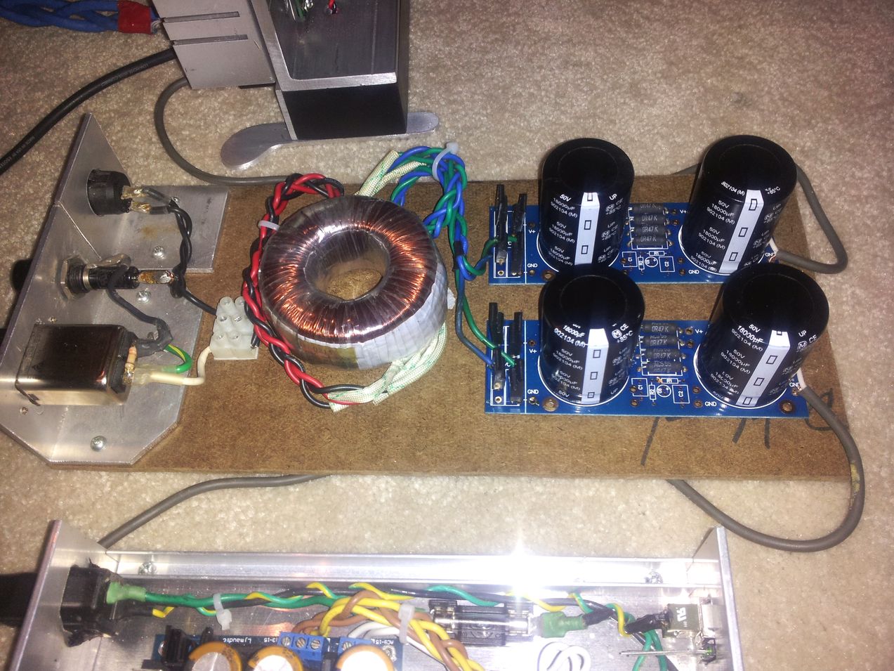

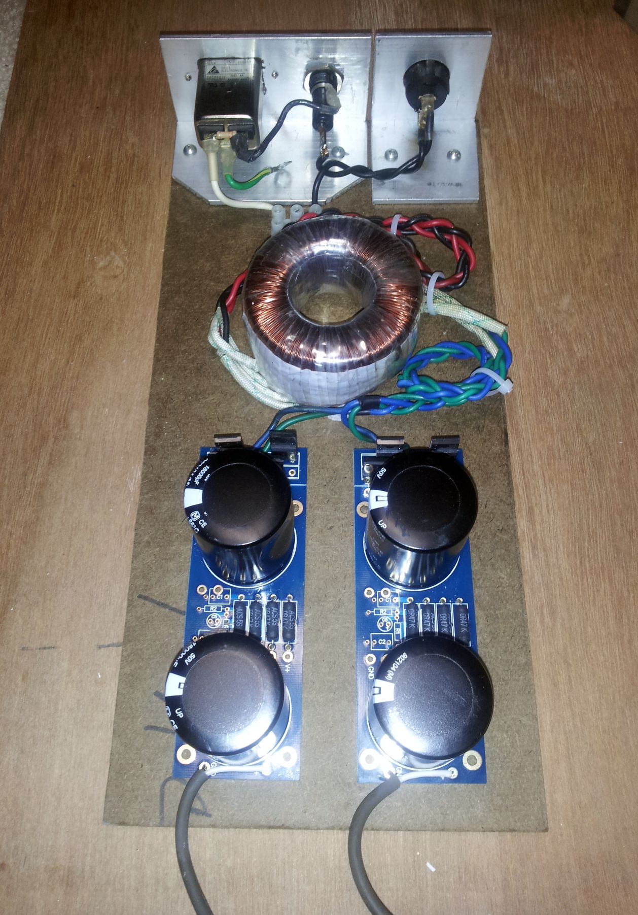

The only glitch is a very warm transformer at max volume, which I haven't experienced over in the chip amp world. My first guess is the toroid isn't big enough but I'll take the advice of the experts.🙂
Antek AN-0215 25VA 0.8Amp
ApexJr 18,000 uF 50V Caps
Arcol 5W 0.47 ohm resistors

iirc, the psu should provide 2.2A per channel when running at 19 volts.
I see yours isn't quite 19v but it still seems undersized.

25VA ???????? 😱 I'm surprised it hasn't melted the tape off it yet!!! That's seriously undersized, you need something closer to 150-200VA.
The laptop PSU used are probably 60-90W output, each. You will need 1 transformer that can supply both channels, so 150-200VA (VA are basically equal to W)

"Papa" Pass says :"There are literally tons of surplus supplies available for this purpose, providing regulated 19 volts DC at more than 2 amps or so....."
The most recent ones we supplied in the store are rated 4.7A at 19v. so in theory one could handle 2 ch. which would be cheaper, but we DIYers like to be sure! And having 2 PSU's adds features envisioned by Nelson: Monoblocks with individual and remote power supplies!
So from the article 100VA should work for the 2 ch. but I'd go 150 for a shared power supply..
