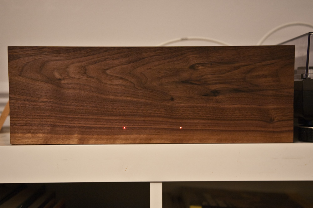

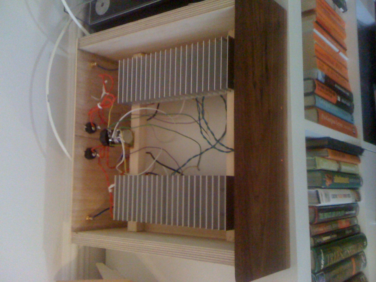

All wooded construction. Walnut front, 18mm ply sides, 5mm ply back panel. Ventilated metal top still to come. Will have a matching 180w hifimediy bass amp and B1.miniDSP pre amp soon
Volume control is inside as this will be a power amp for hi effeciency 109db/w/m horns and need some gain adjustment but wanted to keep the front clean.
heatsinks upwards causes no issues
still have the damn turn off thump
