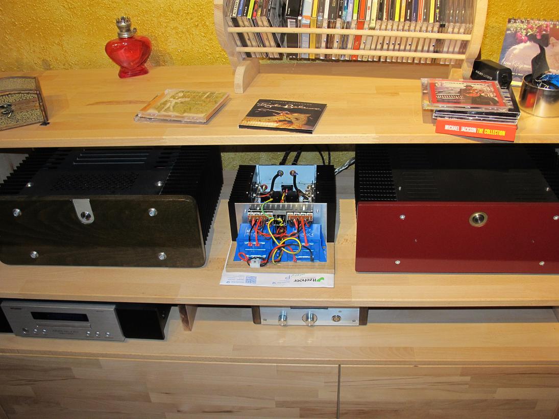

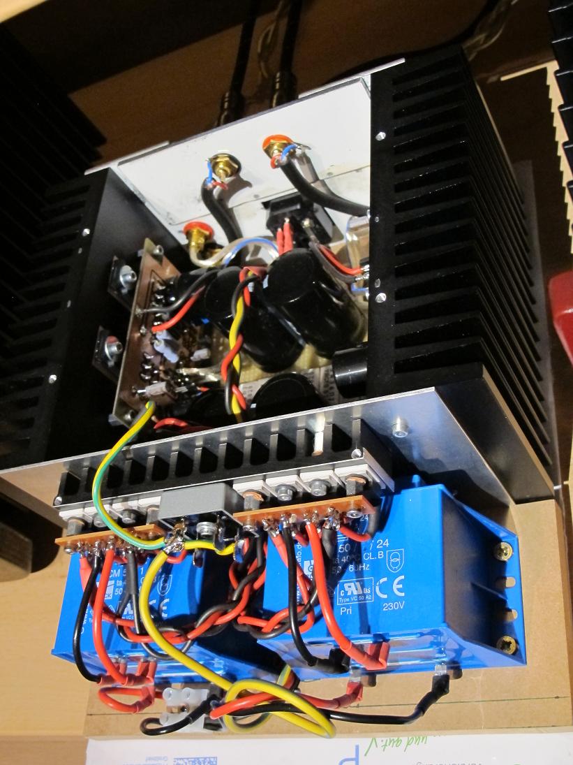

Some Pics with the big brothers the F5, J and the B1 as Pre

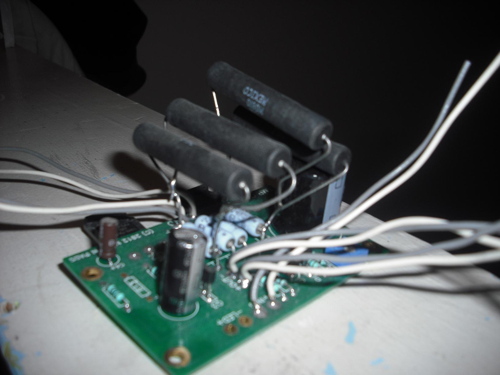

My new table heater, first side, first own class A experience in mono:
http://www.abload.de/img/acarunningxlqu3.jpg
Sounds very clean and round. Can't wait to listen to it in stereo.
Thank you Mr. Pass
And thank you once again for the layout Rudi!
