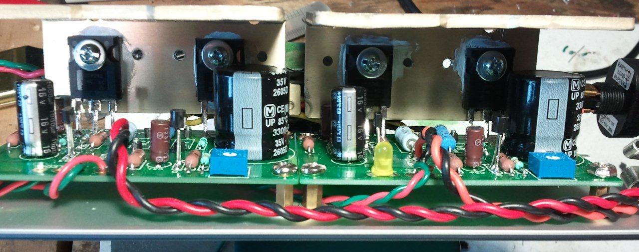

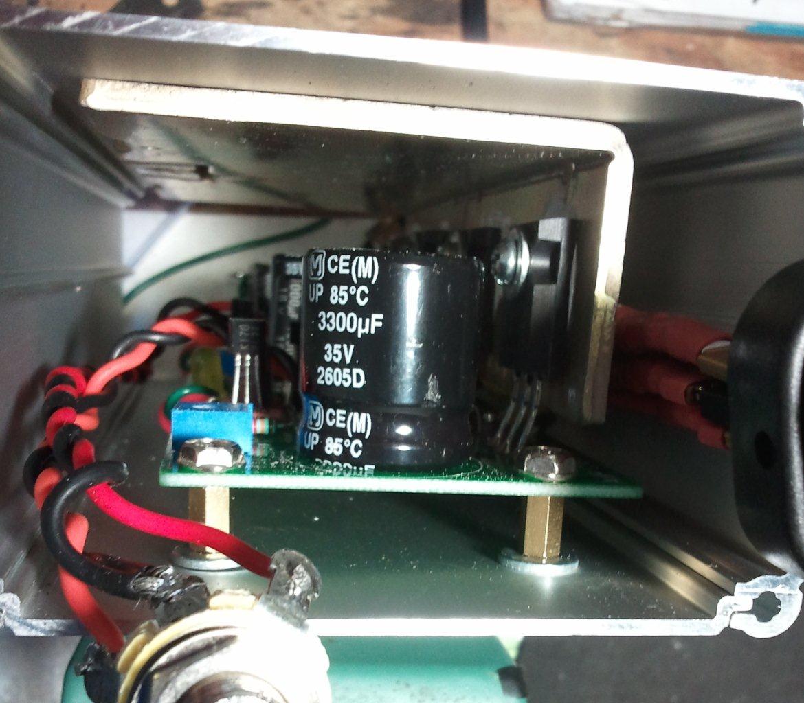

I used a Hammond Manufacturing 1455ZT2201 case..
and from LoudThud's recommendation, left off R1 and R3 to cut the current in half,
lower heat and power requirements. As its for headphones. I did use sockets so the
resistors can be added later..
I need to add cooling vents as it is a sealed case, and Plan to put a 80W CPU cooler on top.
internal case temp is 101F as of now...
