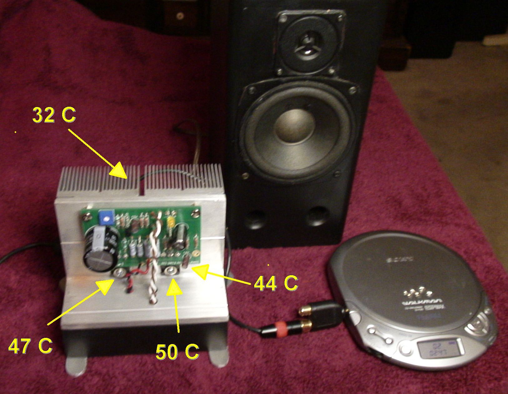

BTW: Has anyone pointed a laser thermometer at the ACA when in full operation?
Using an 8x3" heatsink similar to the one in the diy store, I found that it runs pretty hot. It was 48 deg C on the chip and around 35 deg on the sink after about a couple of hours. Wonder what it will be like in the summer. I would suggest using a bigger sink for this.

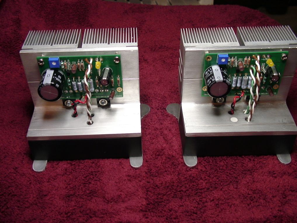

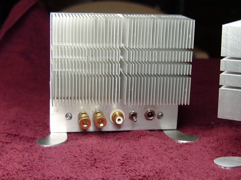

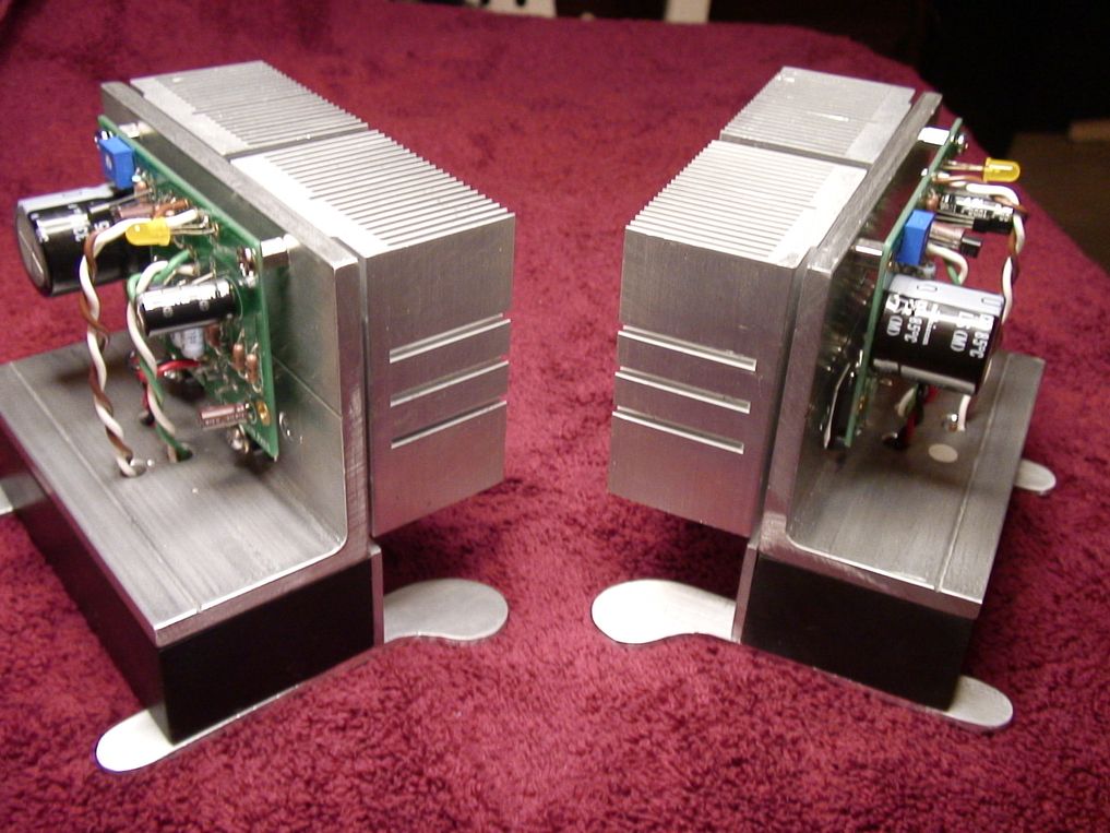

Built a chassis or stand (your choice) from pieces from other projects. Using four CPU coolers and the bulk of the aluminum angle the temp stays just above room temperature.

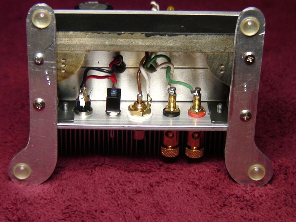

The power transistors are insulated with heat transfer tape instead of mica and seem to work as required. I'll keep my eye on them.
The level is very low, but high quality with my test speakers and the amps being fed with a Walkman. After safety burn-in bigger speakers and a pre will be tested.
Still have to devise a cover - maybe plexiglass - and some nice wood trim.

Not necesarily a problem. It is meant to transfer its heat to fins. Probablt will not improve it any. 50C is ok, just at top of the range.
The heat sinks have a copper plug similar to the one in the photo, but it is raised just enough to prevent the full face to contact. I'll break that down in hopes the fins become more efficient.
You don't have to break it down, just make sure the interface between the angle bracket and copper needs to be as smooth as possible and have a bit of heatsink grease on the interface. That will increase the heatsink efficiency and likely take the case temp down.
Thanks guys, but I guess I used the wrong words. By "break down" I meant removing the one or two mils from the copper plug, not removing it. That would add the full surface of the aluminum part of the heat sink.
I use a series of emery papers glued to a piece of granite, ending with 1600 grit so the contact surfaces are almost mirror like when finished. The copper plug does have Arctic Silver applied now, but I'll eventually use the full face. For subsequent projects I do have access to a surface grinder but this one was small enough to do by hand.

Maybe a little trivial, but do you feel a compound like the white grease might be more effective than the CPU stuff I'm using. I'm aware there are proponents of both, but personally haven't noticed a lot of difference in the computer cooling projects. I'm going to order some mica pads to replace the heat transfer tape and can add what's recommended to the order.
