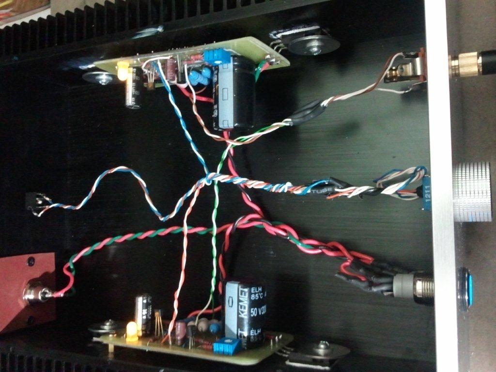

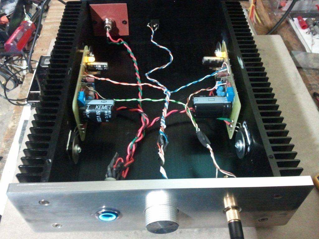

Nice, neat and tidy. Can''t quite tell from the photos, but are you using four switching power supplies for the biamped setup? The second to last picture with the white cables looks like something different could have been used.
As I mentioned earlier I considered four Amp Camps with the 200 VA toroid just installed in my build. The modules are small enough to fit all four in one reasonably sized case.
We tried 4 as well as using 2 and splitting between each pair. For me I think the jury was out on the benefits of the extra PSU. The bi-amping was a clear winner though and gave a lot more headroom. With 91db speakers (both small and large) it sounded crystal clear at a healthy listening volume.

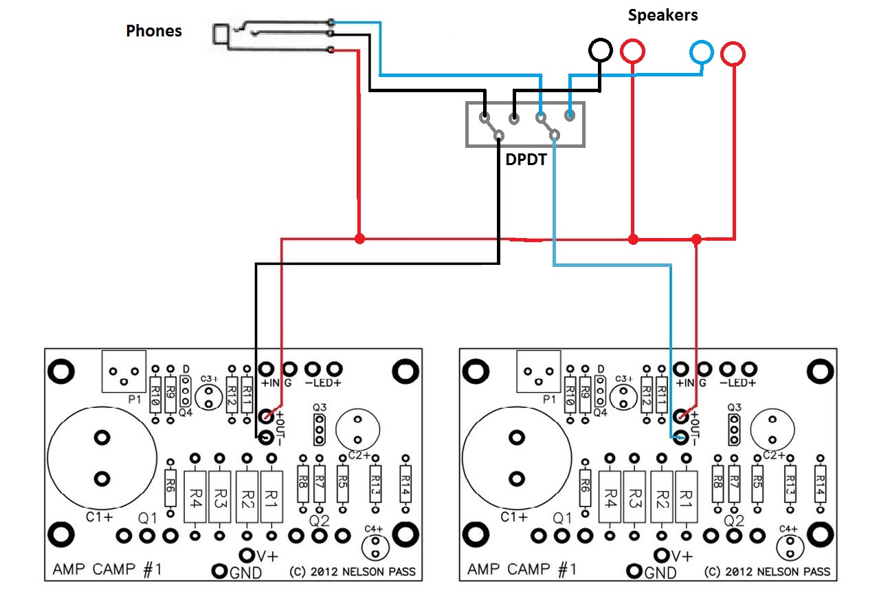

Congo5, Do you have any photos of your setup for the ACAs with earphones? Are you using a balanced set/converter?
I do not have any thing balenced... amps, Sources, or Phones.
Since the ACA is an inverting amp, the outputs marked + are common between channels.
So that becomes headphone common or -
the – out are used for R and L out.
This could be connected to your board or binding posts.
A DPDT Switch between speakers/headphone jack would be nice.
Yes the signal to my phones is inverted but neither my head nor the phones seem to mind.
I hope that is clear ?
How's this ? Corrections welcomed :wrench:
yup that looks right.
on the schematic the + outputs are connected to power supply ground so I reversed the colors and
used red for board out -
and black for out +
but colors don't matter as electrons are color blind;)
your red will still be speaker + on your drawing
on the headphone jack the tip is left channel
